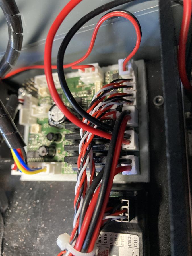

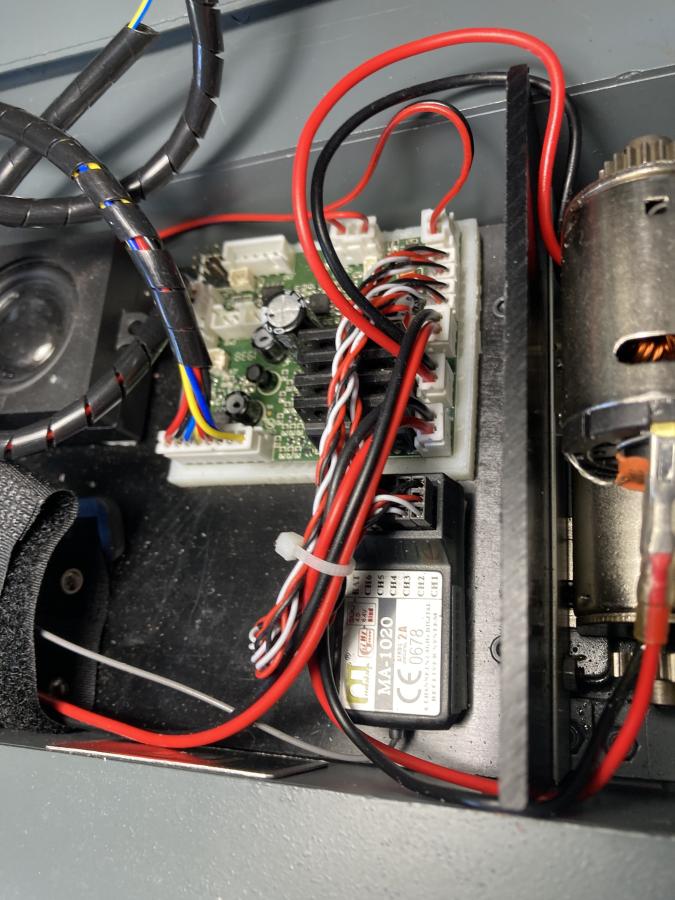

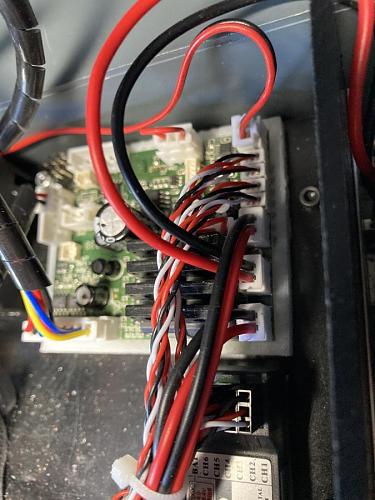

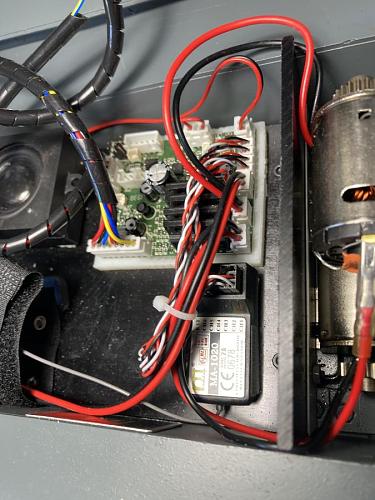

    EZ. Congrats on Mato. I have the Tiger and it's a favorite. However, Mato is a brand you either love or hate. There are a few of us here that have Mato so I imagine they will chime in with more help. I opened mine and took a few pics. Not sure if they are much help. I do not have a wiring diagram and have contacted Mato for one. Their customer support reminds me of an ex that only talks to you when they want your money. I generally use youtube in particular Stanlley at RC Legion. He is a great guy and rc enthusiast. Good luck and keep us posted. Click image for larger version  Name:	image_67211777.jpg Views:	0 Size:	94.0 KB ID:	365230Click image for larger version  Name:	image_67228161.jpg Views:	0 Size:	85.3 KB ID:	365231

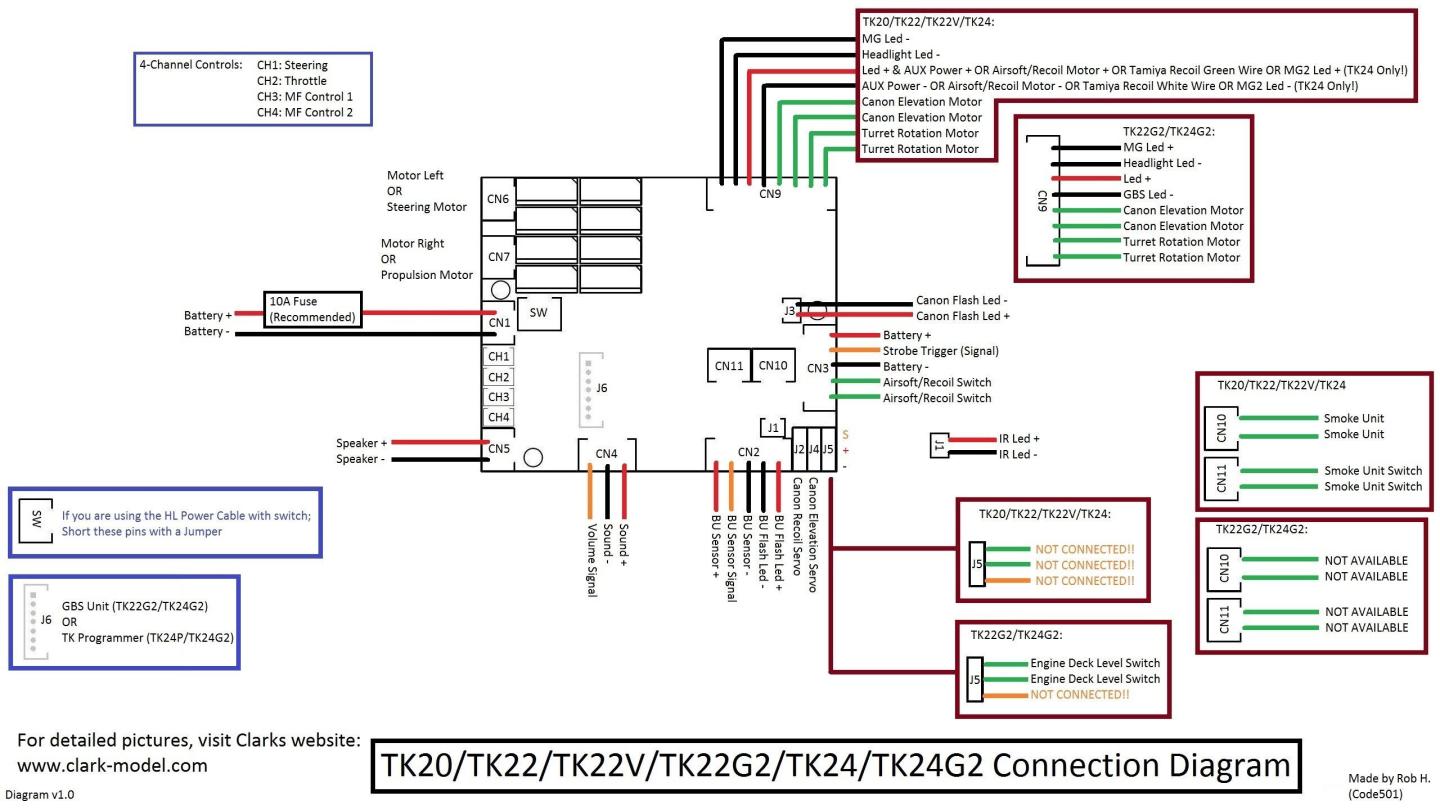

      MATO uses Clark TK22 MFU's, and the wiring schematic for those boards are all over the internet.
