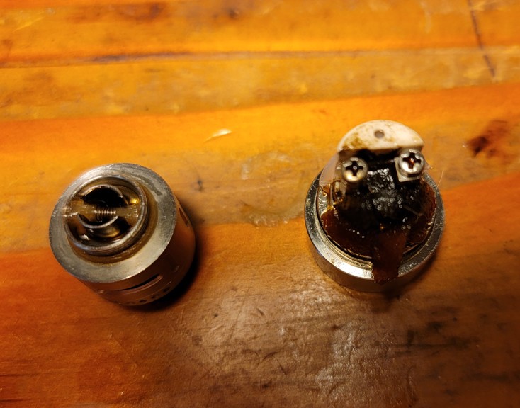

                          Delta 19, its interesting you bring up vaping. As for myself, I have been vaping for well over 11 years.
                          Click image for larger version  Name:	20230101_104215.jpg Views:	0 Size:	162.1 KB ID:	365621
                          My dedicated "Vape station" where I build coils for RDA's,RBA's, tanks etc, etc.
                          Click image for larger version  Name:	20230101_104238.jpg Views:	0 Size:	184.5 KB ID:	365622
                          As Im sure you know, A coil doesnt "Swim" in oil. Meaning its NEVER submerged in oil. If it were, then the atomization of a liquid to a vapor would NEVER happen.
                          The coil head on ALL vaping devices are designed to keep the coil saturated, but never drowned as we can see in these 2 pics of a tank coil head, and a RDA coil deck:

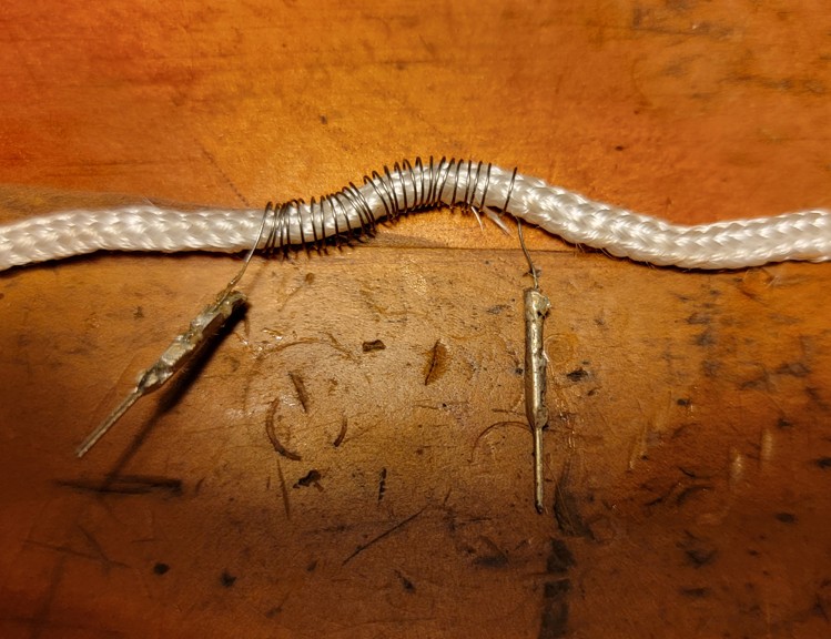

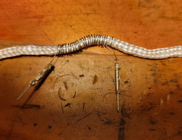

                          Building replacement coils for Tank heaters is relatively easy, IF you have Kanthal & Silica rope on hand.
                          Click image for larger version  Name:	20230101_104357.jpg Views:	0 Size:	113.0 KB ID:	365624
                          Of course, getting the Ohm load correct is important for getting maximun heat, thus creating a cloud....and not buning out the circut on the MFU...which I have done.
                          As Old Wolf pointed out, its far more catastrophic to have too little, then too much. Too much, and you get no vapor, too little and you burn your coil out AND catch your cotton on fire which leads to all sorts of mayhem.
