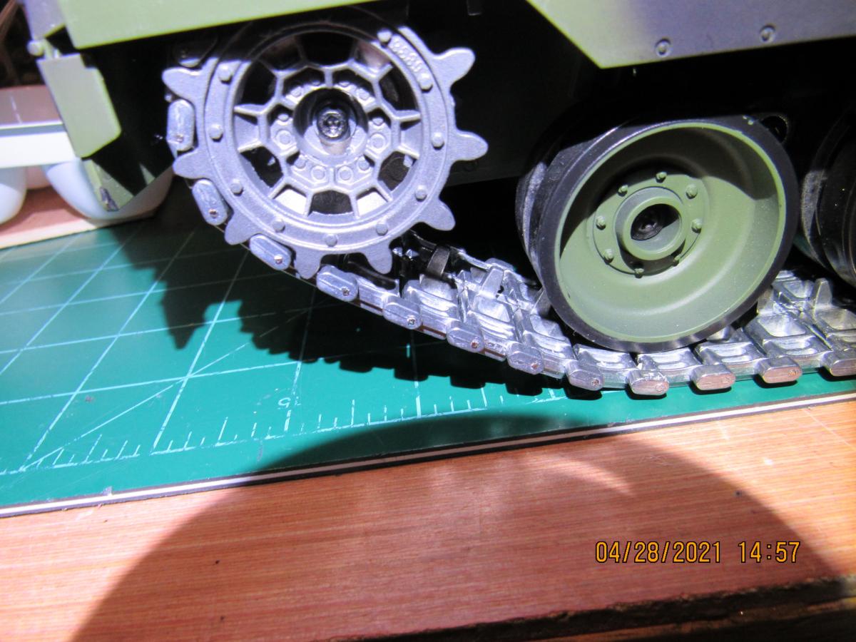

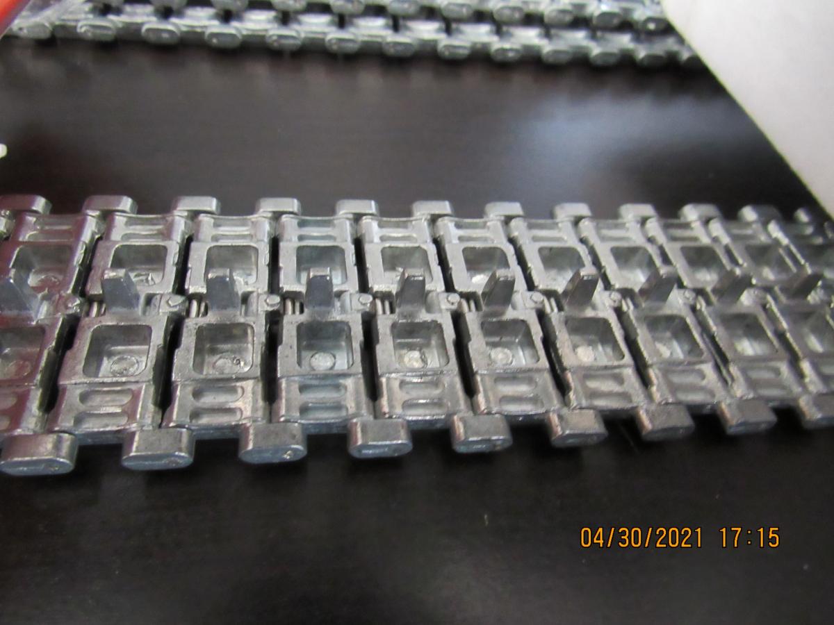

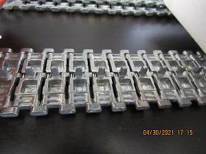

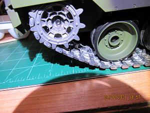

                Other than being ugly and unrealistic both in static and running mode, the HL metal track is cheap and reasonably strong, durable. I use it on my 2005 HL snow leopard (US Army Pershing). Here are the hollows that packs dirt onto the sprocket. The HL metal track is quite heavy and the hollows were casted onto the track to reduce weight. The dirt packing is not a HL concern since HL states explicitly that their tanks were designed to run on smooth, indoor surface only.
                Click image for larger version  Name:	IMG_4989.jpg Views:	0 Size:	102.9 KB ID:	391930 Click image for larger version  Name:	IMG_4986.jpg Views:	0 Size:	133.2 KB ID:	391931
                My solution is to buy a 1"x1/8" hard rubber strip from Amazon and cut 300 plus small pieces to fill the dirt packing hollows. It works very well to avoid de-tracking. RichJohnson used 3D printing to make those small fillers and save a lot of cutting. I use CA glue to hold the rubber pieces in place. Some other forum members fill the hollow with silicone rubber and said it works very well too. However, the HL metal track with rubber filler still looks and runs unrealistically due to the single pin and open pin design.
                Click image for larger version  Name:	IMG_5122.jpg Views:	0 Size:	194.3 KB ID:	391955
                For the HL German Leopard 2A6, I use the Tamiya nylon track. It is the cheapest overall, strong and worryfree of detracking.

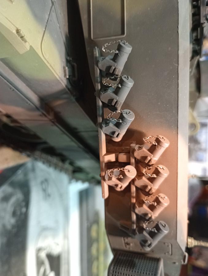

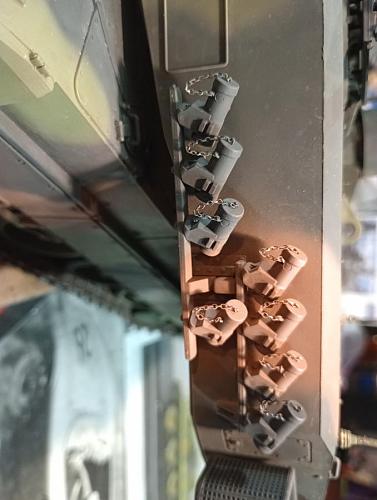

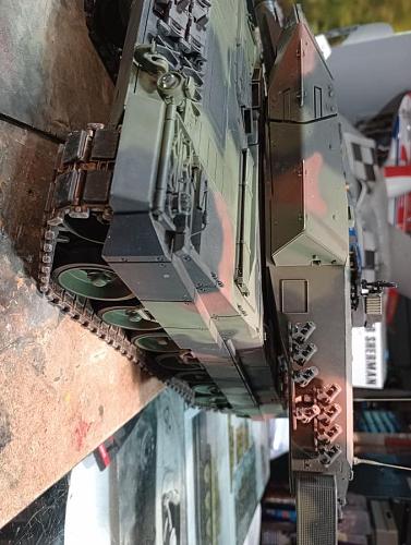

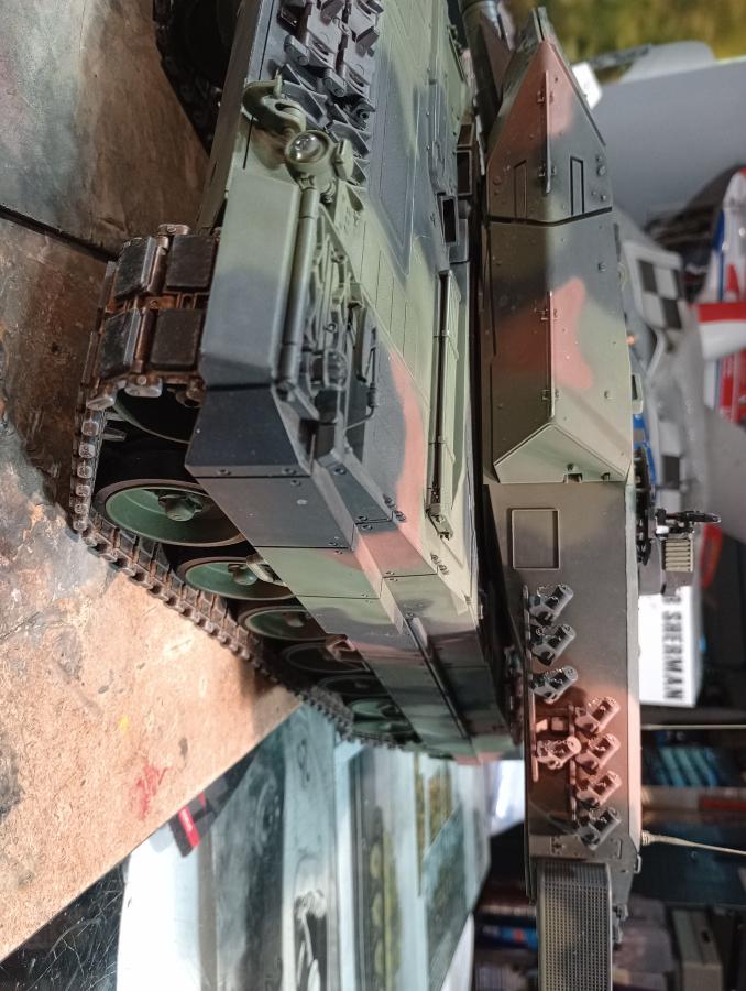

                                    Just made these smoke discharger cap chains from a tiny necklace same size as the Tamiya Leopard 2 model. Turned out ok. Took a bit of time.
                                    VR
                                    • FullySemiAutomatic
                                      • Jan 2024
                                      • 42
                                      #38
                                      Originally posted by Vintage Racer
ID:	396861 Click image for larger version
                                      VR
                                      That looks cool. Not sure if you saw, but the "caps" on the smoke dischargers should be black:

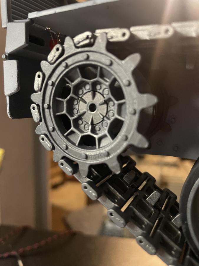

                                        I just received my leopard pro and it’s unreal. So beautiful this thing.
                                        But I have a problem. How did heng long expect us to remove the sprockets after installing the sprocket caps? There’s really no way to pull it out once you install it. I want to install bearings. Help.
                                        im guessing I can drill out the cap hole enough to fit my 2.5mm hex driver. But I’ll wait for an answer first. Don’t wanna screw anything up.
                                        • SoCalBobS
                                          • 2774
                                          • Southern California
                                          #40
                                          Hmm, those are tough. Maybe drill and tap it just barely enough to screw in a bolt? Personally, for my rough and tumble tanks, I leave the sprocket bolts exposed> I know I'll be removing the sprockets for maintenance and adjustment quite often.
