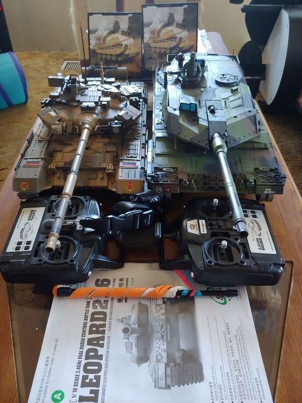

    Well I guess I'm hooked into this hobby after I got the T90 and now I'm leaning towards purchasing the HL German Leopard 2A6 Professional Edition as my next tank.
    Would like you'alls opinion on this tank and any photos/modifications/upgrades you have made on yours. Let your fingers type away.

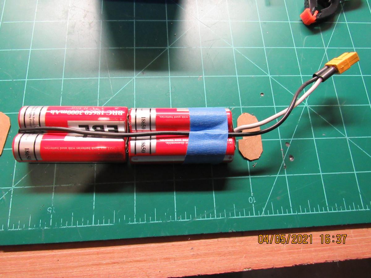

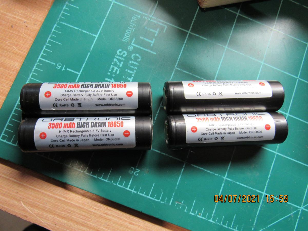

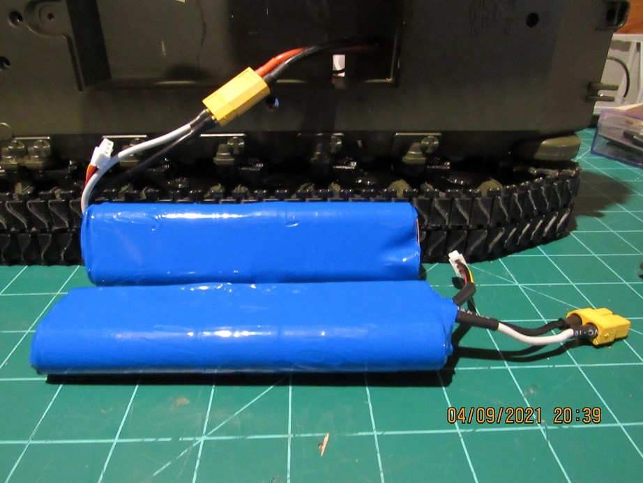

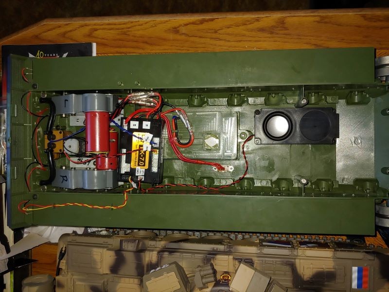

    1. It comes with the HL Li-Ion 2S pack which I measured at 800 mAh even it was rated by HL as 1800. I replaced it with a 2S2P Li-Ion with 4 imported ICR18650 cells. This pack measured 5600 mAh and last much longer than the HL pack. I also have some pack using EBL18650 that measured 4500 mAh. I like Li-Ion pack for it long storage time and staying about 8 volts over half of the use cycle.
    Click image for larger version  Name:	IMG_4958.jpg Views:	0 Size:	121.0 KB ID:	366310Click image for larger version  Name:	IMG_4956.jpg Views:	0 Size:	126.5 KB ID:	366311Click image for larger version  Name:	IMG_4961.jpg Views:	0 Size:	161.9 KB ID:	366312

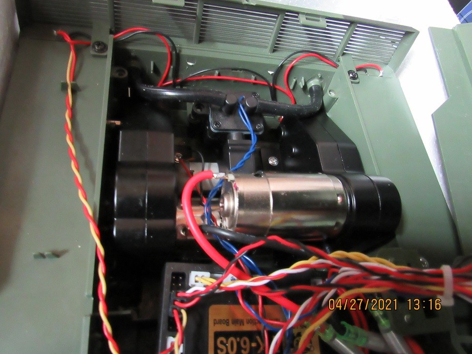

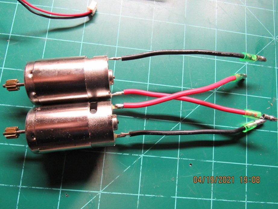

    2. The HL grey 380 is a low grade Mubachi knockoff. I replaced it with MxFans390 which is similar to the HL Red390, but runs faster at 30000 rpm.
    Click image for larger version  Name:	IMG_4969.jpg Views:	0 Size:	187.0 KB ID:	366313

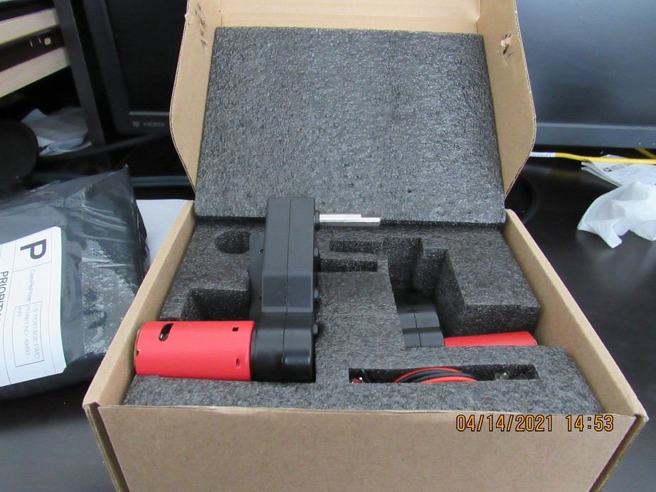

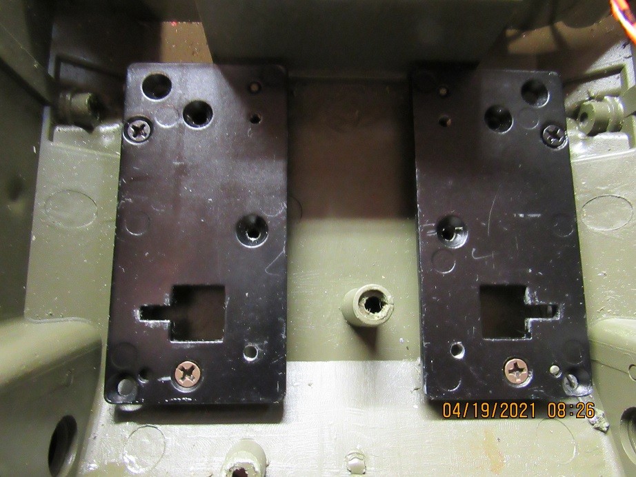

    3. The sleeve bearing of the HL steel gearbox creates a lot of vibration and noise. I replaced it with the Heng Xin gearbox.
    Click image for larger version  Name:	IMG_4962.jpg Views:	0 Size:	198.4 KB ID:	366318Click image for larger version  Name:	IMG_4963.jpg Views:	0 Size:	160.8 KB ID:	366319Click image for larger version  Name:	IMG_4968.jpg Views:	0 Size:	162.5 KB ID:	366317Click image for larger version  Name:	IMG_4980.jpg Views:	0 Size:	154.0 KB ID:	366316

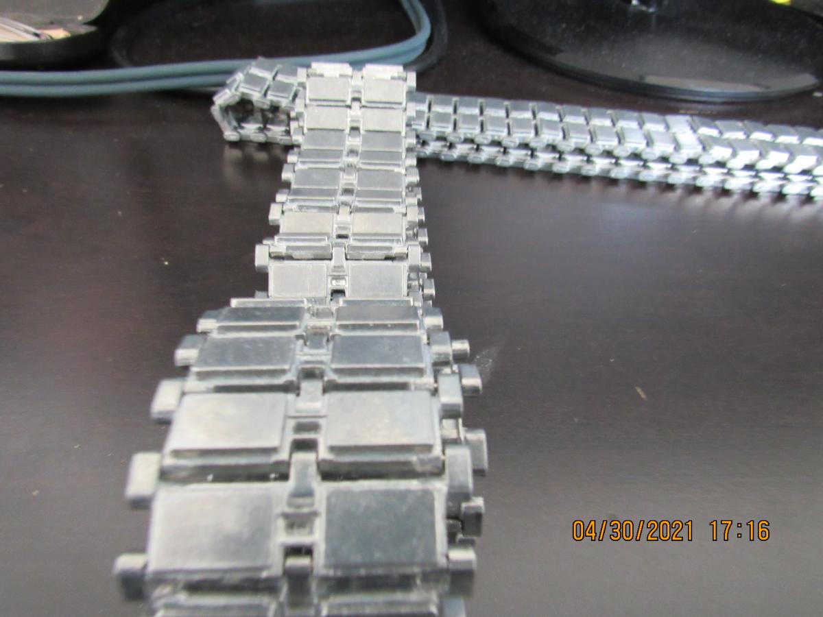

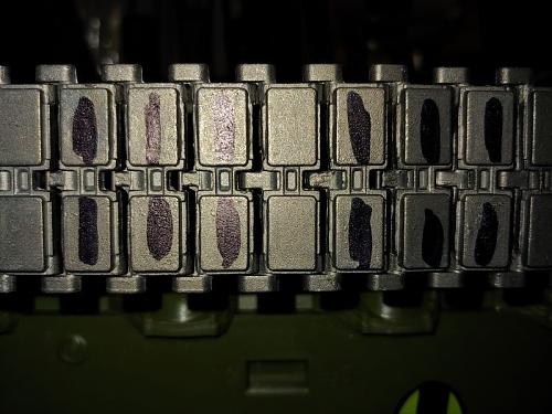

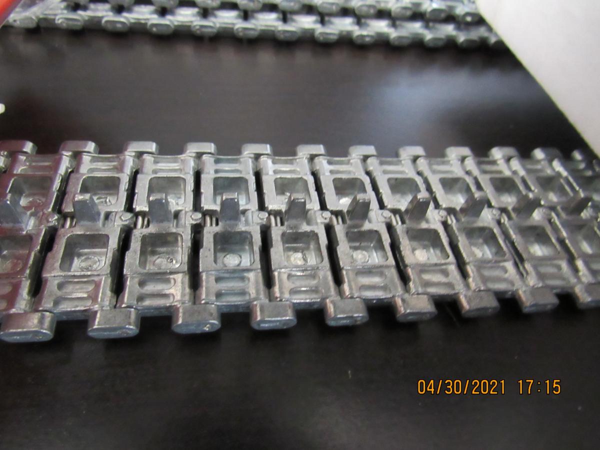

    4. The HL metal track is a robust track. The hollow on the track and the single pin design make it look unrealistic in running. I replaced it with a Tamiya track.
    Click image for larger version  Name:	IMG_4990.jpg Views:	0 Size:	87.6 KB ID:	366320Click image for larger version  Name:	IMG_4989.jpg Views:	0 Size:	102.9 KB ID:	366321
    All the upgrades can be completed in half a day. I wasted most of the metal parts that come with the PRO version. It would make more sense to start with a plastic version if I know better.

      Where did you purchase the MaxFans390 and the HENGXIN TH16749 gearbox assembly? I searched Google, but could not find either item.
      • keilau
        • Mar 2021
        • 1849
        • Windy City
        Originally posted by cmdrcody
        Where did you purchase the MxFans390 and the HENGXIN TH16749 gearbox assembly? I searched Google, but could not find either item.
        Amazon.com: Mxfans 7.2V-8.4V 21000RPM 390 Iron and Copper Electric Brush Motor with Wire for RC1:16 RC1:18 Model Car : Toys & Games​
        or
        390 Brushed Motor w/Fan For RC 1/18 Wltoys A959 A969 A979 K929 757290277383 | eBay​
        I got mine at Amazon.
        For the gearbox, search for Heng Long HL59 gearbox and select the lowest price ball bearing one. I like the Heng Xin design. Be warned that changing the motor on Heng Xin is a bit more tricky than other open frame gearboxes.
        • tank_me
          • Feb 2022
          • 1211
          Just remember that the HL59 means High/Low motor mounting with 59mm shaft length. There are also ML (mid/low) and 49mm shaft lengths. Some tanks need the lower motors and shorter shafts or lower motors with the longer shafts so make sure you buy the right gearbox type for your tank if it's not a Heng Long Leopard. For example the T72 needs to use the ML59 gearboxes as the HL59 won't fit under the rear deck.

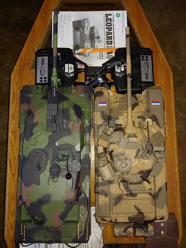

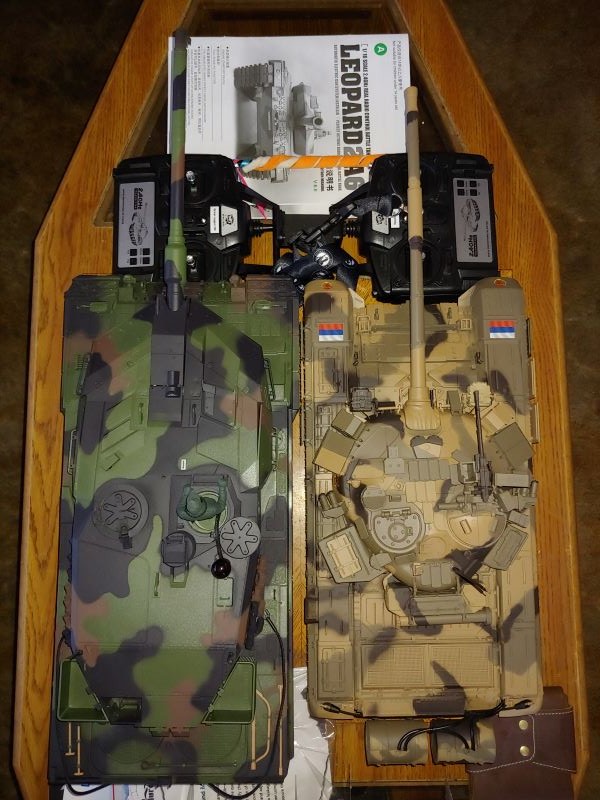

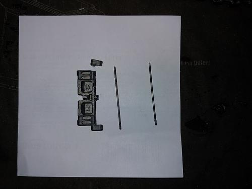

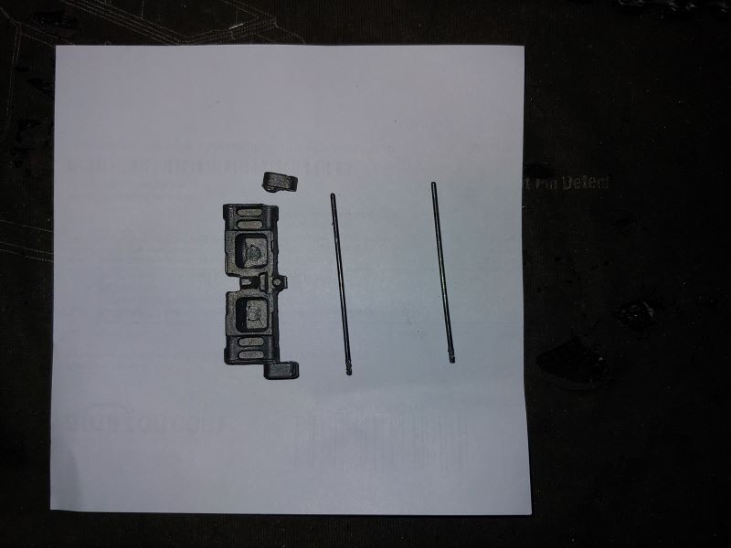

                          Well, my Heng Long German Leopard 2A6 Professional Edition arrived today from Motion RC and I'm quite totally bummed out. Pulling it out of the styrofoam packing the right metal track had a broken link and was busted apart. After taking a very close look at all the entire metal track links, I found 26 defectively cast metal links on the left side and 19 on the right side including the one broken metal track link.
                          Will know more about this issue next Monday after Motion RC opens back up and customer service tells me how they are going to handle this.

                            First time I hear such massive defect from a HL cast. It is disheartening.
                            I posted my problem with an early age zinc alloy cast metal tank for my Pershing. But that was more than 10 years ago. My experience with 2 HL metal tracks were mixed. Poor in appearance, but strong in construction. I hope that HL did not change supplier that use poor quality cast material

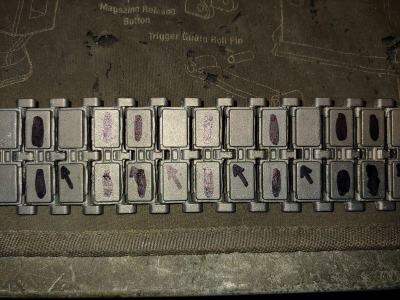

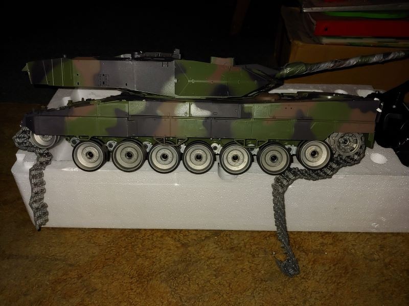

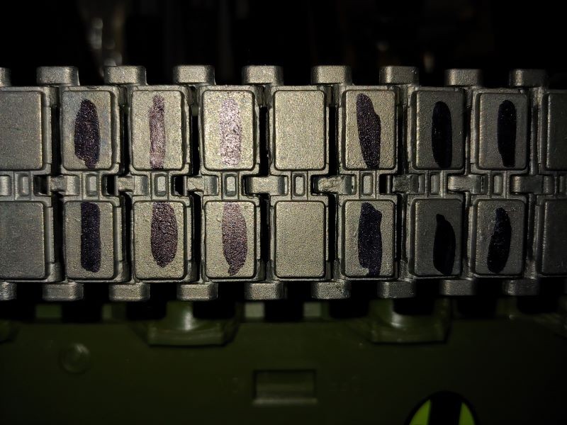

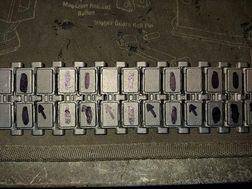

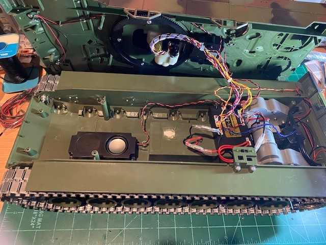

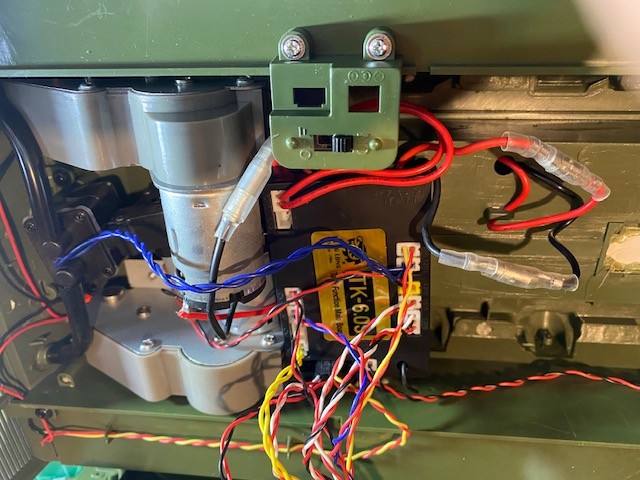

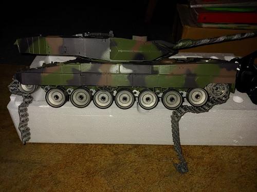

                              Well, I finished up the Leopard 2A6 while I'm waiting for Motion RC to make a decision on what they're going to do about getting the defective metal track links issue cleared up. already thing about the Taigen or MatoMart metal tracks as replacing the HL type. Taigen's warehouse is only 80 miles from me in Brooksville, FL so I could be up and running quickly, but the MatoMart tracks would take two weeks before I had them in hand.
                              So, while I'm in limbo on this tank, I decided to make some upgrades while I'm waiting. Replaced the OEM motors with 390s, relocated the battery switch from the very stupid OEM location (have to leave the turret turned to access switch) and did the magnet install to be able to have easy access for cleaning or whatever other upgrades I may be doing int the future. So here it sets next to my T90 until everything is resolved.
ID:	367166Click image for larger version
ID:	367167Click image for larger version

                                Whether you get the replacement metal track or not, per Rubicon99 the best track for the German Leopard 2A6 is the Tamiya track. Incidentally, it is also the cheapest aftermarket option if you order it from AAF Tank Museum PX.
                                I use it on my Leopard and never bookback.

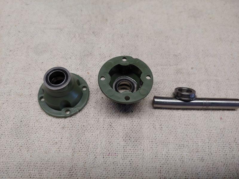

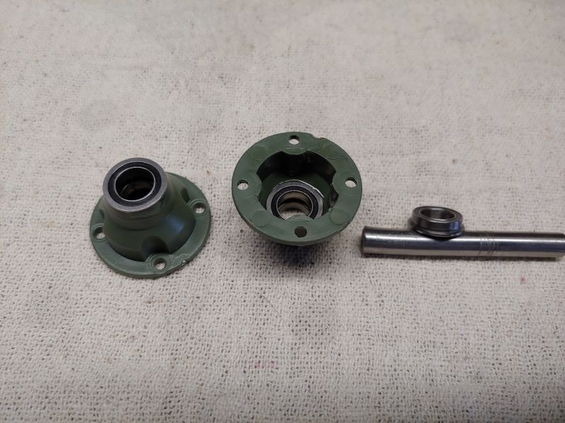

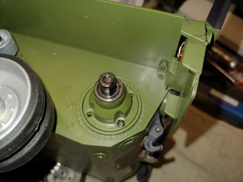

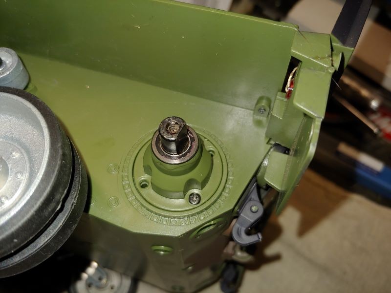

                                  The drive axle bearings arrived today. Got them installed. Have both inner and outer bearings now on the drive axle hub. Still no decision from MotionRC on the metal track links issue.
ID:	367276Click image for larger version
