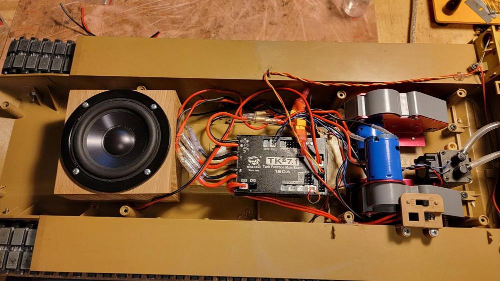

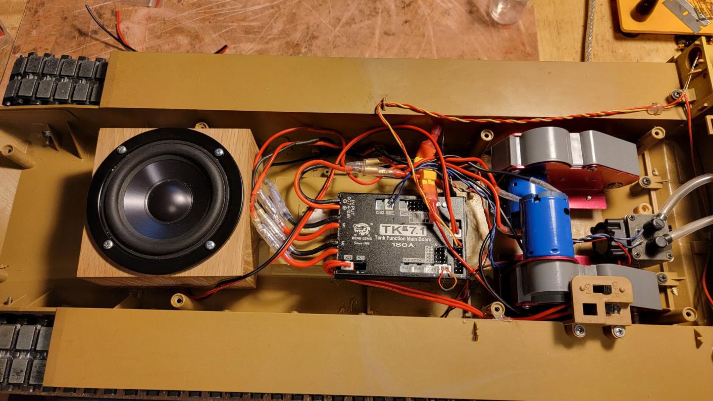

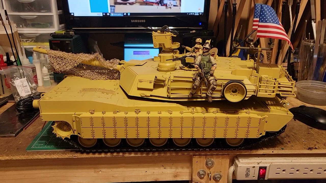

            DSA90-8 in the Abrams Click image for larger version  Name:	20221217_013214.jpg Views:	0 Size:	160.5 KB ID:	368663
            • #7
              Really awesome !Where did you get the soldiers?

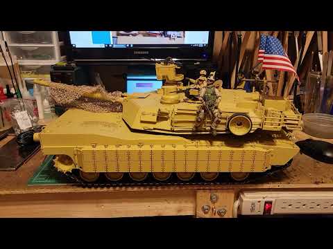

                Some are cheap, others not so. I paint them, but I admit I suck at it....
                Click image for larger version  Name:	20230129_084157.jpg Views:	0 Size:	187.9 KB ID:	368736

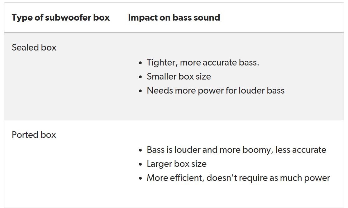

                          A ported ( or sealed) speaker enclosure has nothing to do with a speakers ability to play low bass frequencies. The free air resonance (fs) of the driver along with the rest of the observed Thiele-Small Parameters accounts for how low of a frequency response a given driver will go. In a RC tank where space is at a premium, a sealed enclosure is the best choice. One other reason why the Dayton speakers do well is the size of the voice coil. Its not going to blow out with any tank board. Its a shame I dont have my sine wave generator & spectrum analyzer anymore as it would prove my point. Don't confuse Hz & Db......

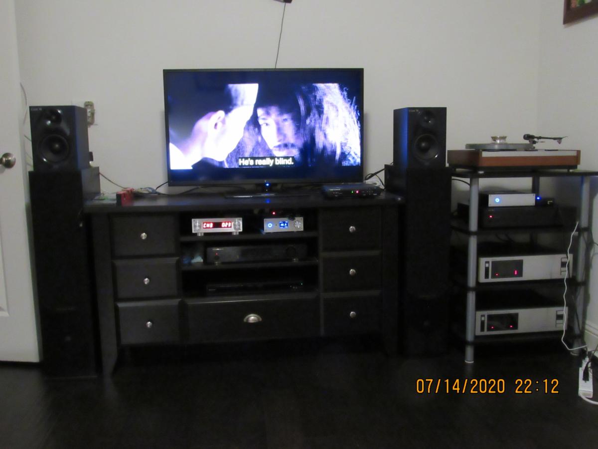

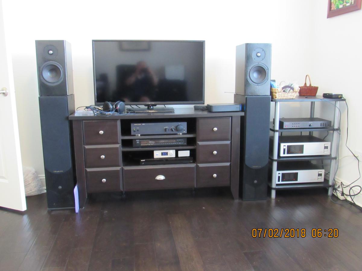

                            Click image for larger version  Name:	IMG_4729.jpg Views:	0 Size:	82.2 KB ID:	369013Click image for larger version  Name:	IMG_4910.jpg Views:	0 Size:	68.7 KB ID:	369014
                            It is a different kind of fun.​ Been there, done that. My home system evolved with time when I built. You will not get Audio Research type quality and will not save money compared to buying mass market audio gears from Japan. Only the satisfaction of building your own.
