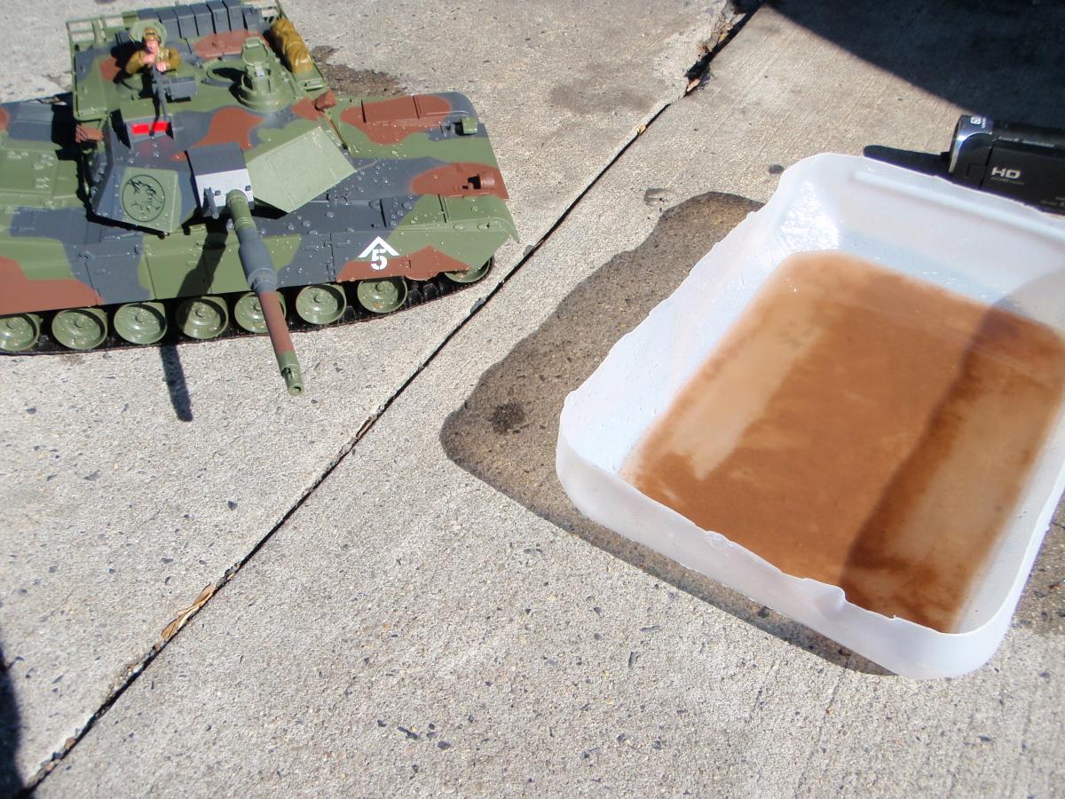

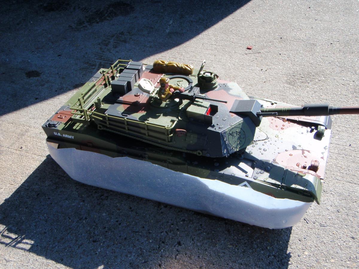

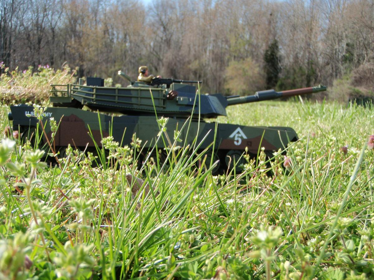

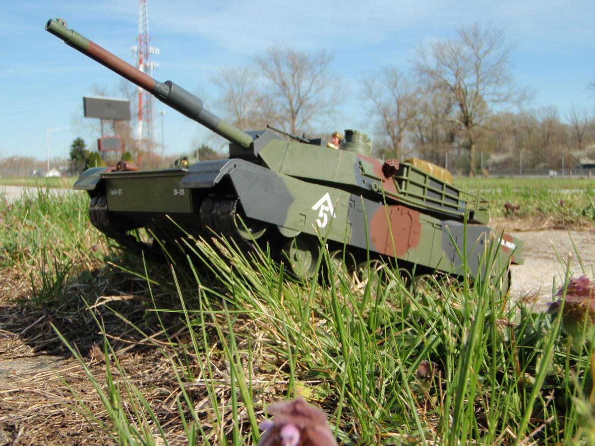

                            Hello again,
                            I'm answering to your question from your new thread:
                            Your only chance is, beside discovering a trim function in the user manual, to open the vehicle up and grease/oil the whole drivetrain parts.
                            Checking the wire connections thorougly comes to mind as well.
                            Also check for an equal track tension.
                            Good luck with your courageous project approach!
                            I started my tanker career many moons ago with an "upper toy grade tank" as well.
                            Couldn't afford any hobby grade tanks at that time.
                            Not even the HL tanks, which where really cheap before they upped their game, quality wise.
                            Click image for larger version  Name:	P4104045.jpg Views:	0 Size:	189.7 KB ID:	370271
                            Track wash :)
                            Click image for larger version  Name:	P4104033.jpg Views:	0 Size:	185.7 KB ID:	370272
                            Click image for larger version  Name:	P4104035.jpg Views:	0 Size:	208.8 KB ID:	370273Click image for larger version  Name:	P4104057.jpg Views:	0 Size:	217.6 KB ID:	370274
                            Long story short.
                            I got a lot of fun out of thi​s tank, because my main goal was to test and try my camera equipment.
                            Even a toy tank wil teach you how to get great photos or video scenes.
                            Get a real hobby grade tank once you are done with your experiment!
                            CCC
