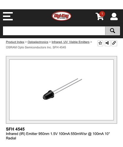

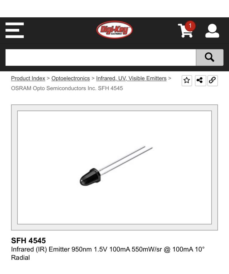

      HP= High Power
      Do you need it? Only if you intend on battling at distances greater then 50 feet in bright sunlight.
      The stock HL bulbs is actually pretty good when new, but they tend to loose performance as they age. This drop off in performance can be gradual or rapid.
      There are a number of places to acquire HP bulbs. Everyone has their favorite place. This is where I buy mine from. Click image for larger version  Name:	149635A5-D75B-4AB9-8EA3-3FB9EF8CF273.jpg Views:	0 Size:	46.8 KB ID:	381236

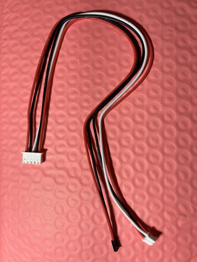

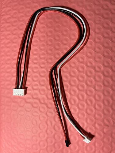

                I've found the color of the plastic matters a great deal; black works well but most other colors are all transparent to some degree. Also we got dedicated HL wire harnesses for the receivers now thanks to Saeree Tang Manisuta from the LA club =). If any of yall have specific improvements you'd like to see or things you'd like me to try changing on the receivers, send them my way! We're currently in the progress of designing model specific receiver mounts so they'll be easier to install on the hatches and won't force players to aim artificially high above the tank for hits.

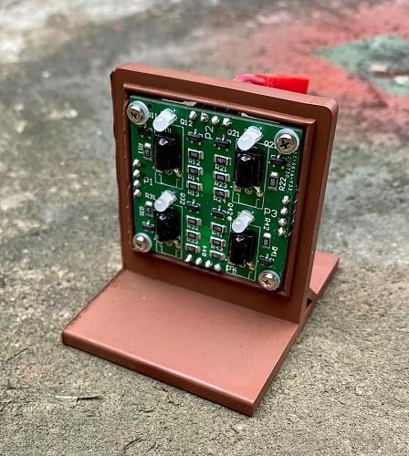

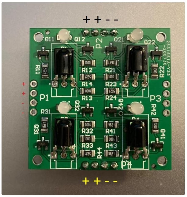

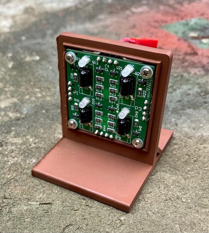

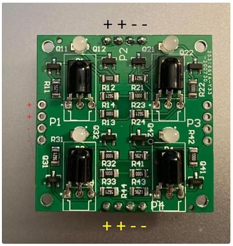

                  LegoDEI is selling his Modular IR Target on Etsy. For a while it was absent. It's a great tool for checking range and aim when you replace or upgrade your IR LED bulbs. Put it 50' feet away then adjust your tank distance until you determine the range. Also good for checking beam spread.
Name:	IR target 1.jpg
                  My friend designed a 3D printed frame for it. It's on Thingiverse, called RC Tank Target Holder, #4841064. It's a free file, just don't start selling prints for profit.
