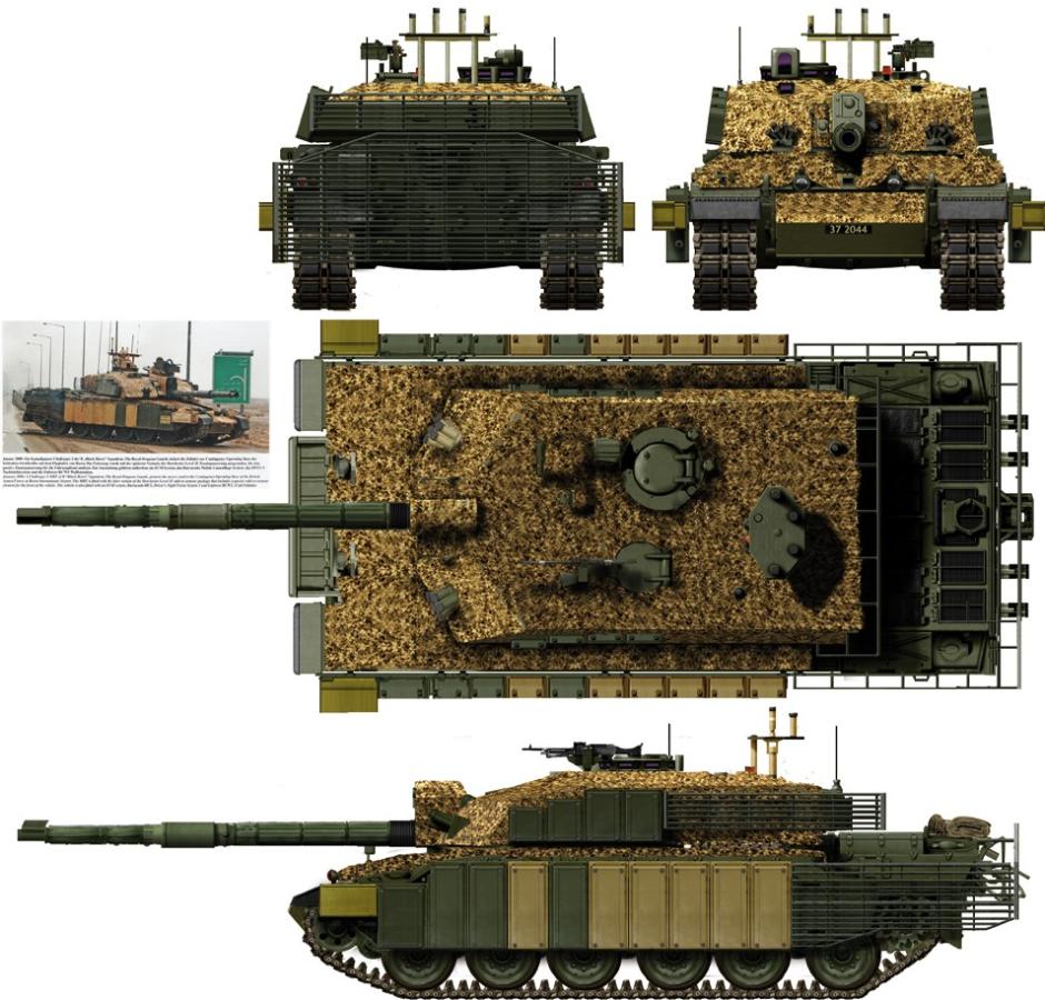

                                Ok, damit, since I posted the Leopard pics and clips, I keep getting "Challenges" to add one to the stable. So Rubicon, what's its main flaw? Now, if you still have one, here's something for JVMConcepts to work on for you.
                                  Click image for larger version  Name:	Clhallenger2-BlackHorse-RoyalDragoons-Dorchesterw.jpg Views:	0 Size:	131.7 KB ID:	374091
                                  Bob yes JVM3Dconcepts has all those a parts plus more designed just not printed. They are holding off until I acquire a new test bed one for finishing fitment checks. My current Challengers I don't want to change the looks of right now. They are more less shelf queens these days.
                                  The Challenger 2 is overall a good tank and by far the best cross country tank of the modern designs. It has a few issues though.
                                  The sprockets are to narrow for either Abrams or Leopard 2 aftermarket tracks and need spacers to run the track(currently there are no Challenger specific aftermarket tracks made they are either Abrams or Leopard with spacer mod needed). The simple more effective solution is to swap over to Abram sprockets. The best and most reliable tracks to run on the Challenger are the Tamiya Leopard 2 tracks.
                                  Next it needs drive shaft support bearings badly. Without them it easily looses tracks off the sprockets even with the new adjustable idlers keeping the track tight.
                                  Regardless with bearings, Abrams sprockets and Tamiya tracks the Challenger needs to be driven with thought and planning. When done so it is a excellent tank. It is not a tank that is good for a beginner which of course you are not.
                                  Oh lastly it's a HUGE tank. The largest 1/16 HL makes.
