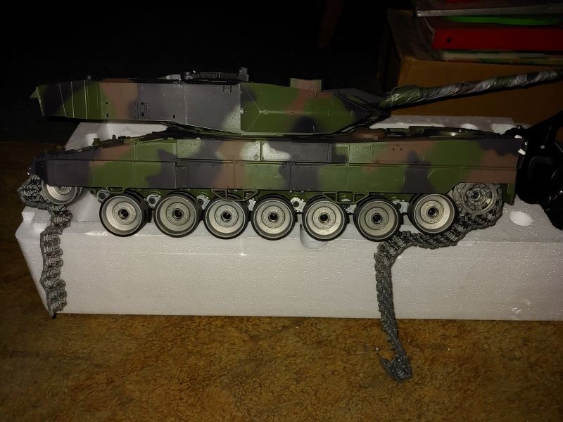

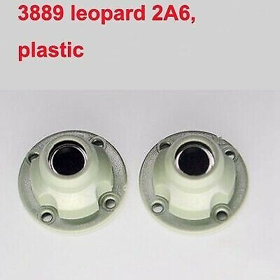

    I got the all metal tracked version, with the rubber feet in the track links. A positive for this version is the presence of ball bearings in all wheels.
    My error, the drive axle support bearings I ordered from eBay, but still coming from China. The seller is "daclover".

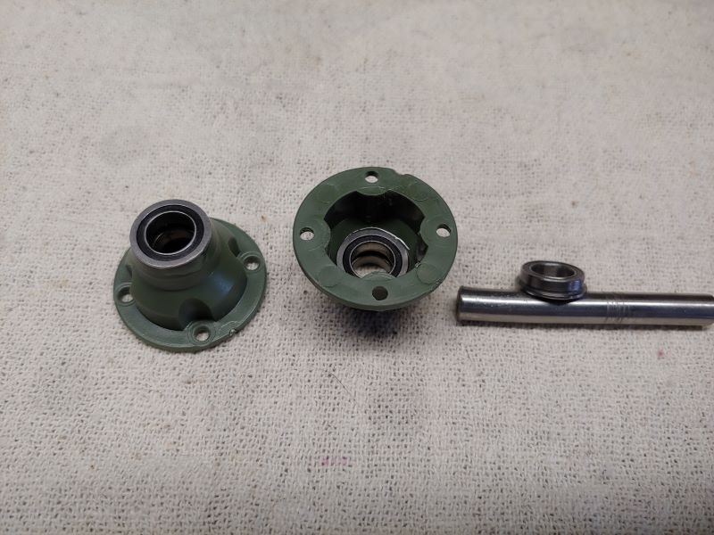

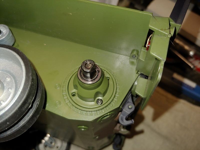

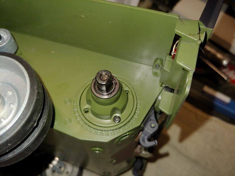

      This is how my HL Leopard 2A6 Pro version (All metal tracks) Arrived.
      And I installed 8 x 12 x 3.5 sealed flanged drive shaft bearings in the original plastic hubs. Two bearings in each plastic hub - one inside & one outside. Each held in place by a light layer of two-part epoxy.
      Click image for larger version  Name:	0113231520.jpg Views:	0 Size:	102.3 KB ID:	374131Click image for larger version  Name:	0113231552a.jpg Views:	0 Size:	89.8 KB ID:	374132Click image for larger version  Name:	0113231613_HDR.jpg Views:	0 Size:	43.5 KB ID:	374133Click image for larger version  Name:	0116231448a.jpg Views:	0 Size:	112.8 KB ID:	374134Click image for larger version  Name:	0116231650_HDR.jpg Views:	0 Size:	73.3 KB ID:	374135
