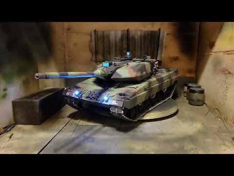

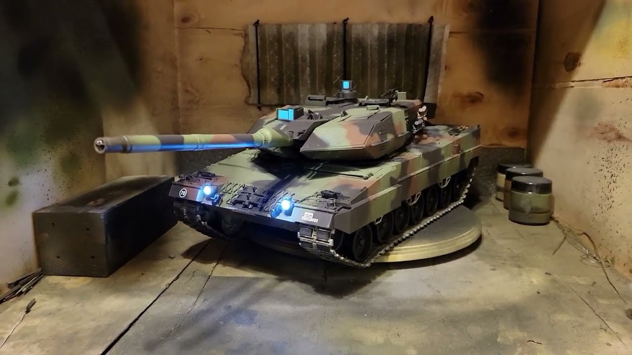

                        You tube video was very good on showing that install. So good, I decided to order two of those cannon smoke/flash units from the Ebay site provided by "Zippersnapper". I'll put one of them in my Leopard 2A6!
                        Speaking of Leopard. Not finished as a few more upgrade parts working through customs but Servo Recoil installed along with Barrel Smoke & Flash. This ones running the Canshuo TK26 system
