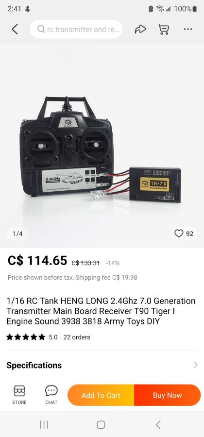

                Not really, mato mart in canada tells you what your gonna get, toucan hobby in the US does too, as does ozarmor and aliexpress.
                Sure in the first few months of its release stores just sold what ever but that was over a year ago and things have changed. Click image for larger version

                    Toucan didn't list the sound when I got my T34-85 on Amazon and Motion doesn't list it when I got them direct for my 3 other tanks that should sound like a Tiger.
