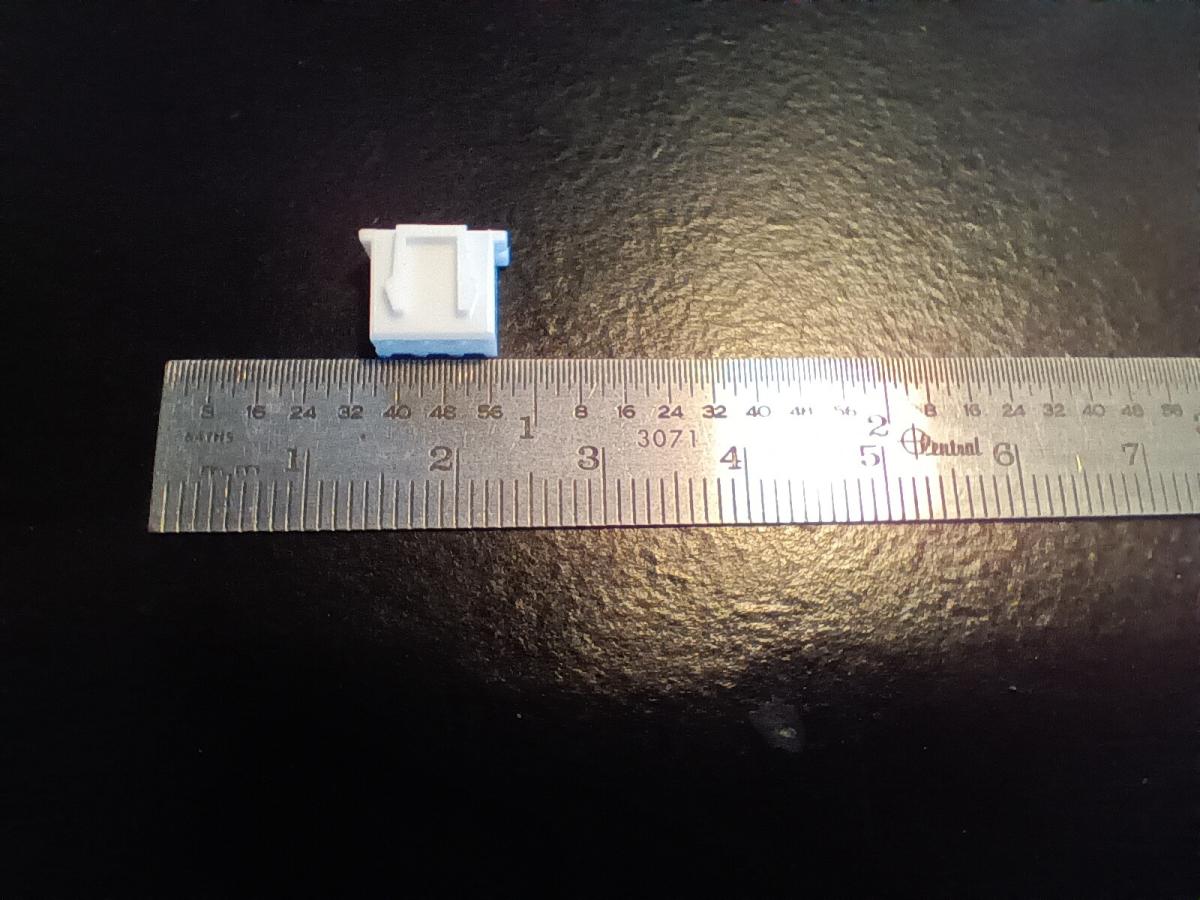

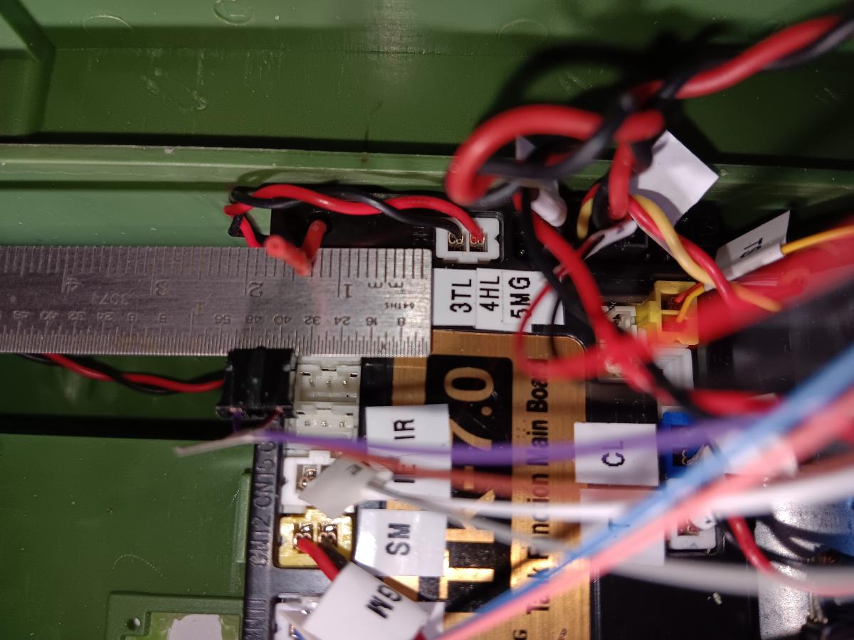

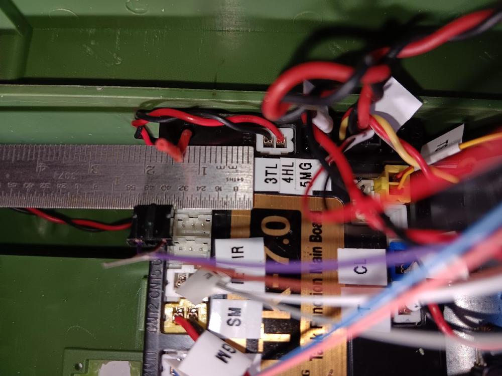

No. That is the size of all the 2-pin JST female connectors. The 3-pin JST female connector that fits into the CN16 port of the TK-7.0 board is the same width as the JST-XL 2-pin female plug. First photo is of IE female plug on 7.0 board. You can see there is only one narrow guide slot in the male receptacle and is only 18/64ths wide.

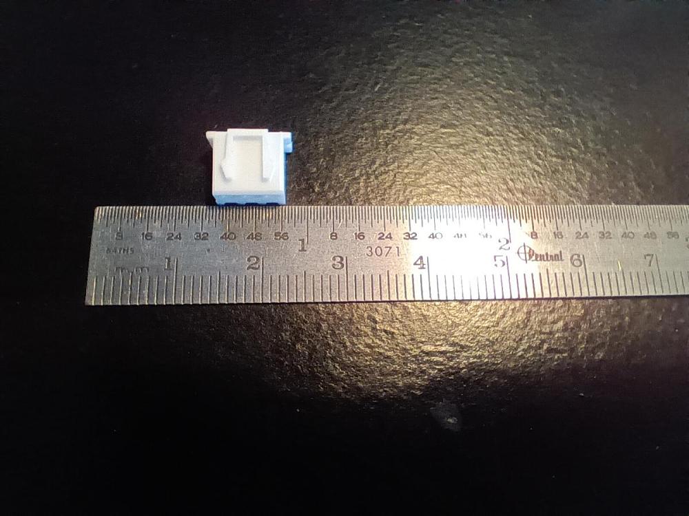

The second photo is of a JST-XL 3-pin female plug that has two guide slots and is 21/64ths wide.
After further research and taking/comparing measurements of JST connectors, the Infrared Receiver female plug to the 7.0 & 7.1 boards is a JST-PH style connection. The first and third pins are exactly 4mm center to center and there is a single guide lug on them.Comment
