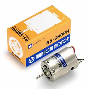

          It sounds like a pair of defective 390 red motors to me. Heng Long use knock-off 380 series motors with less than ideal quality control. Usually, the red 390 runs much cooler than the blue 380 or the stock grey 380 because the 390 has built in cooling fan inside the case.

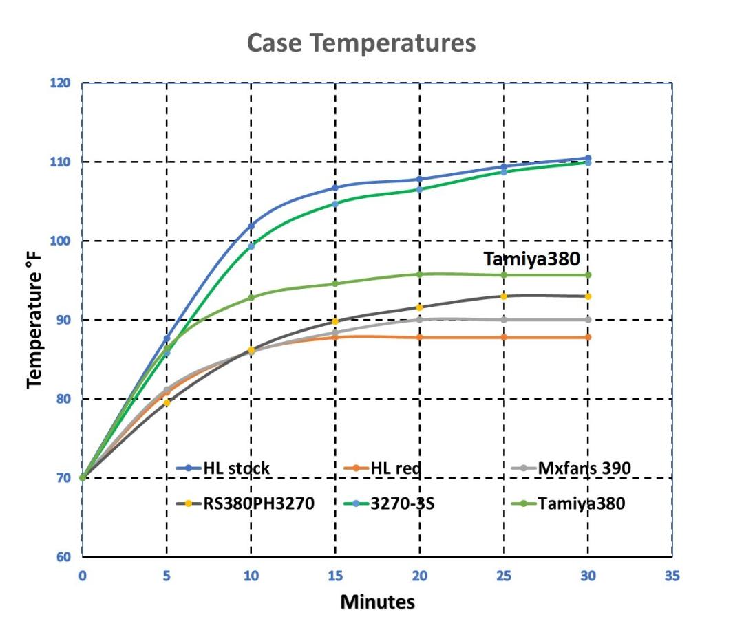

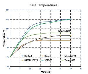

          I have tested a few 380 and 390 motors. The chart below shows typical temperature rises about ambient in a Heng Long tank driving metal tracks. The Tamiya380 is a bonafile Mubachi RS-380PH motor. You can get them from Tamiya Parts mail order store cheaper than the Heng Long blue 380 or red 390. If you want the extra speed, 390 motor is the only way to go.
          Click image for larger version  Name:	380-390casetemp_pershing.jpg Views:	0 Size:	86.1 KB ID:	375657

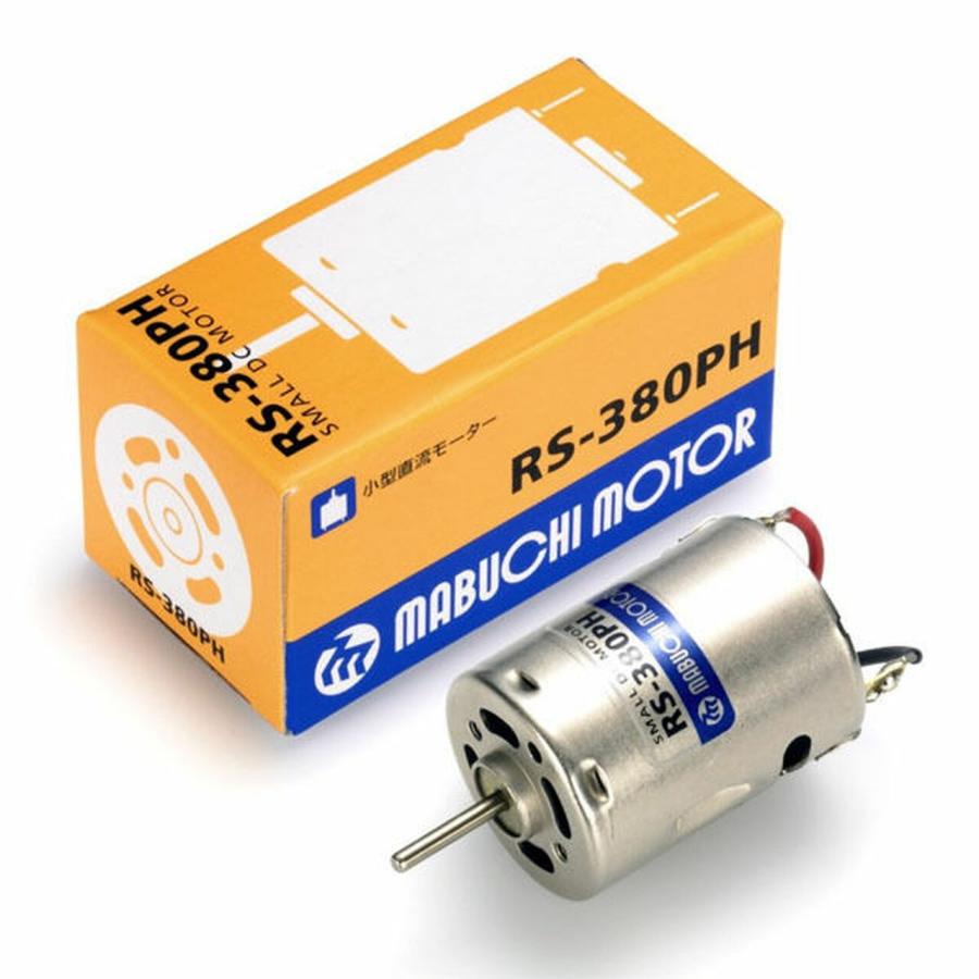

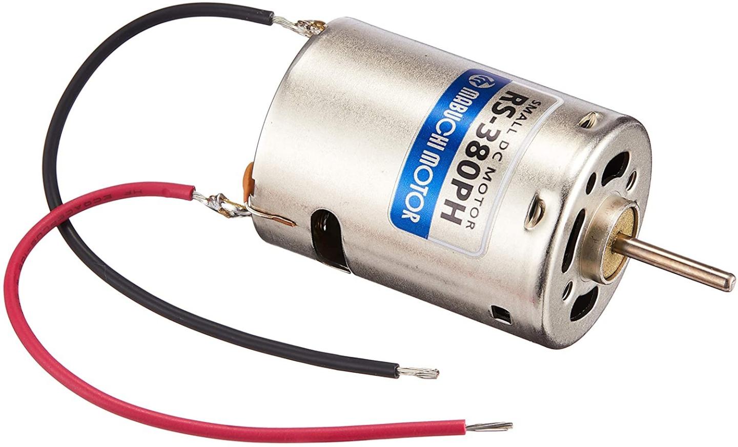

          The genuine Mubachi/Tamiya 380 motor runs cooler because it uses high quality ball bearings. Lower bearing friction means lower motor temperature. I suspect all their parts are made to tighter tolerances too. The only inconvenience wtih the Tamiya motor is that you have to buy and press fit the 10-teeth gear. Heng Long red is NOT the only option for 390 motor. I use a pair of MaxFans390 bought at Amazon with good results. Same comment about the gear.
          Click image for larger version  Name:	mabuchi_rs380ph-tamiya.jpg Views:	0 Size:	115.6 KB ID:	375659Click image for larger version  Name:	mabuchi_rs380ph-tamiya-2.jpg Views:	0 Size:	62.4 KB ID:	375658

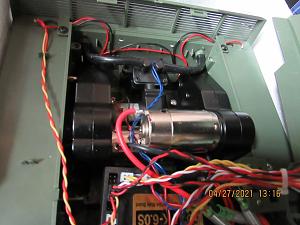

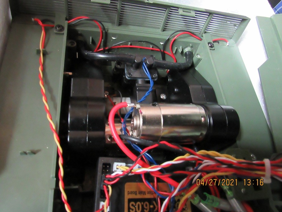

          Have you contact Toucan Hobby yet? I was very impressed with their customer service. You can open the top of your Abrams and show how hot the red motor gets with a non-contact thermometer.
