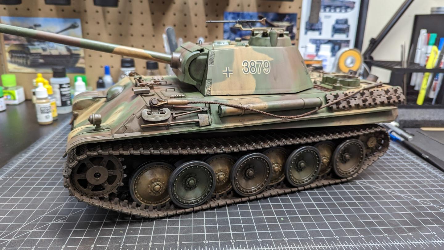

    Best Matte Clear Coat for Running Tanks Outside

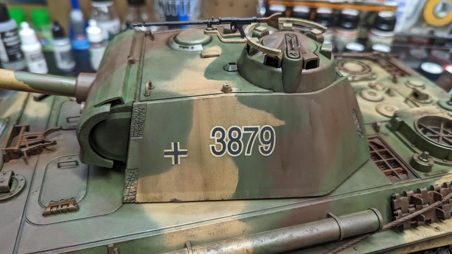

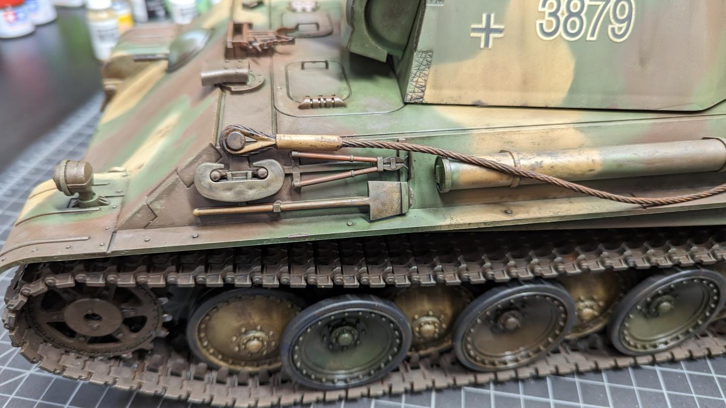

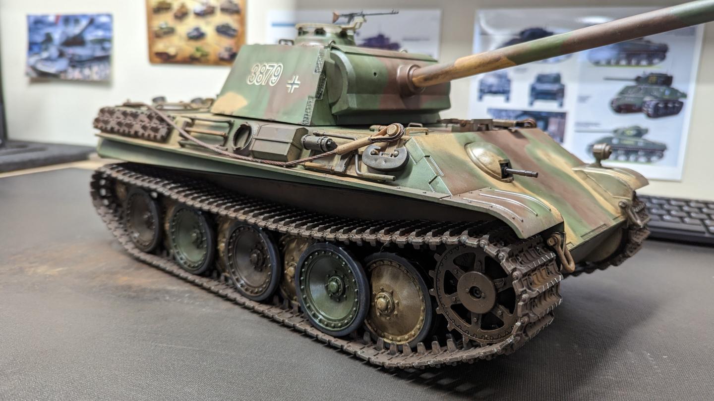

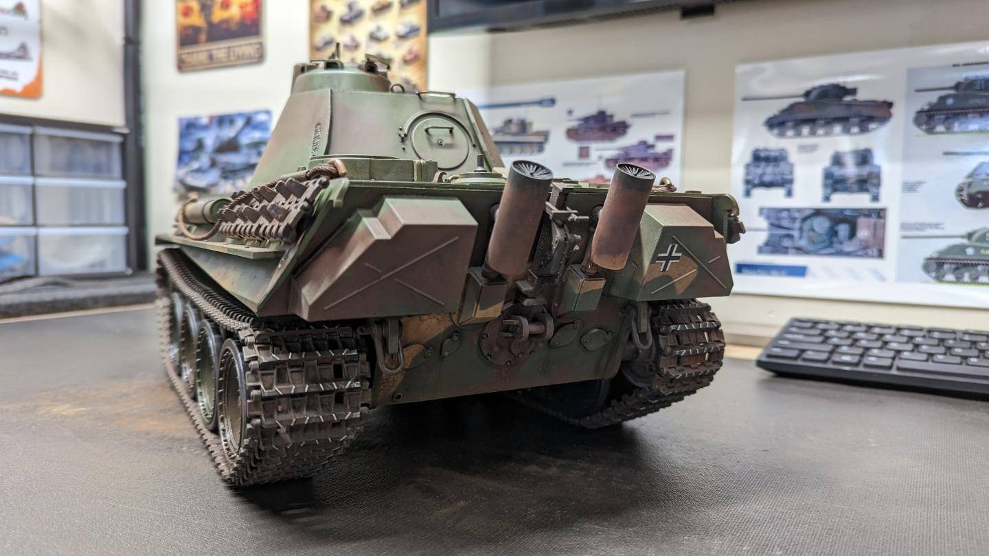

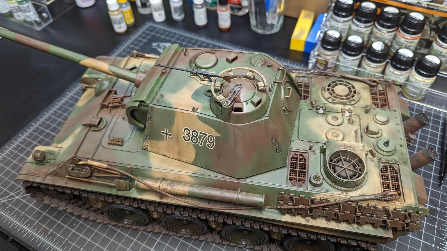

    Hey Guys,
    I'm about to wrap up painting and weathering my new Heng Long Panther G Tank and would like to see what people are using to lock in their work and protect the tank from water when taking the tank outside for a little more realistic weathering, mud and fun !
    Thanks in advance,
    Brad

      Before you weathered the tank did you fully test run it outdoors? HL Panthers and Tigers are notorious for loosing tracks even on modest outdoor terrain. Muddy or damp soil will cause even bigger issues with the Panthers tracks and is not advisable. Real dried mud looks great but unfortunately getting it on a Panthers tracks and road wheels is not worth the price in headaches doing so.
      The dull coats above tend to not be totally flat and lean more towards semi gloss. If you can find a dull coat flat that for an airbrush you would be better served if a "dead" flat is what you are looking for.

        Thanks Rubicon,
        I have run the tank quite a bit and have had no issues with tracks so far, even after full disassemble and re-assemble. I will certainly heed your warning from above and don't plan on heavy mud use but again want to lock in and protect my hard work from water. I can also confirm your statement about the Rust -Oleum paint mentioned above and the matte I tried on the bottom of the tank was Semi at best which is why I am looking for alternatives.

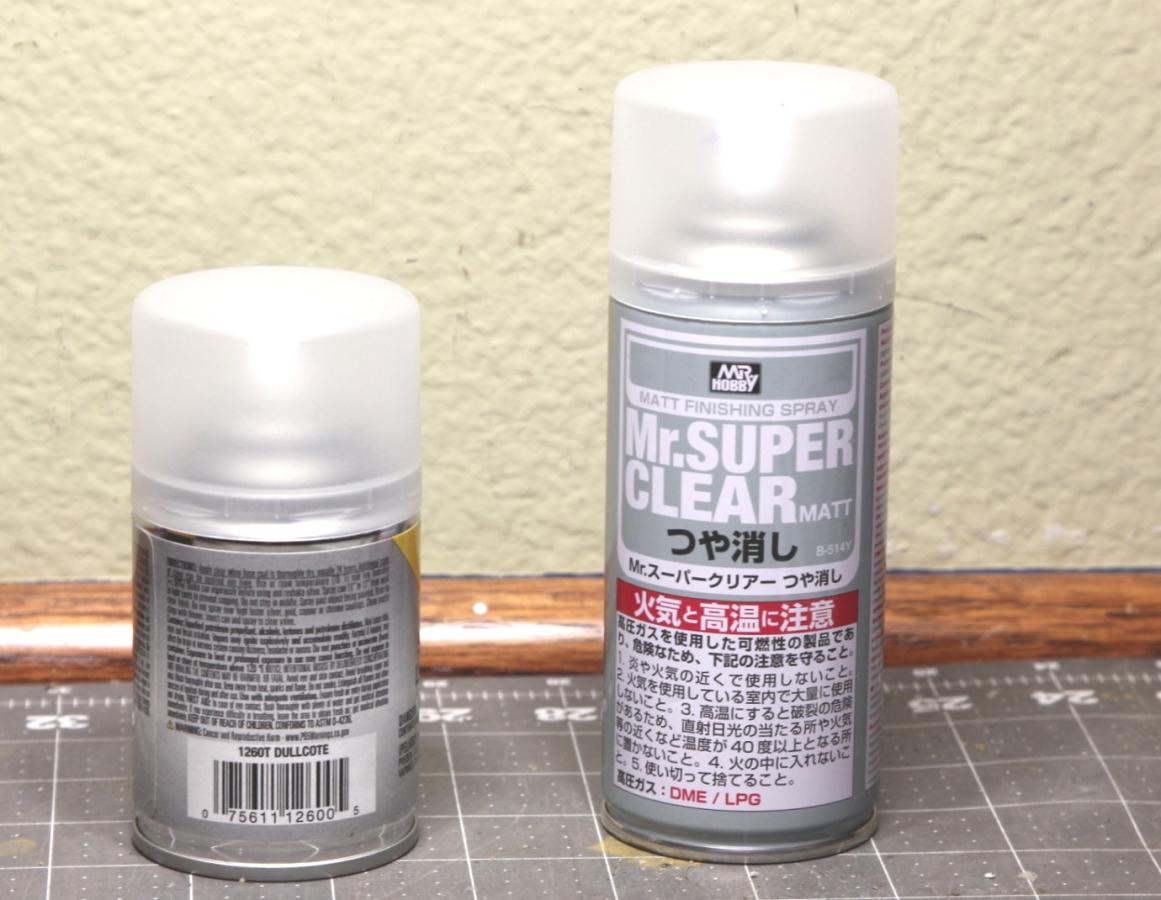

            I also used Testors dullcote and Mr. Super Clear matt on my tanks.

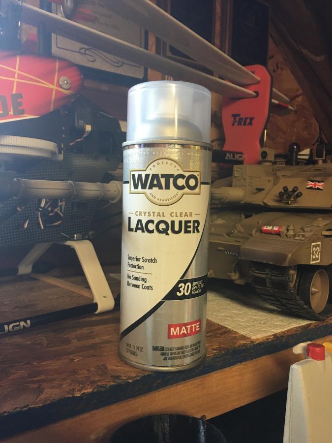

                      Here’s what I use. Love it and how you can respray over it…

                        Quick Shine seems to be the replacement for Future/Pledge used by many car modelers.

                          Thanks Evan ! Does this actually dry matte like it says or is it more gloss ?
                            • 5392
                            Totally matte, looks great.

                              Thanks Evan, I will give this a shot then ! BTW, Are you in the Charlotte area by chance ?
