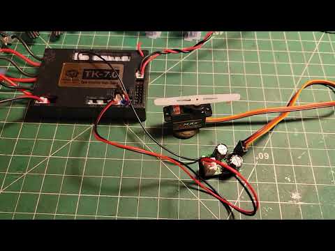

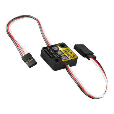

      Actually, it can be done with 6.0 & 7.0 MFU's....if you dont mind waiting for this cheap part to arrive from Germany
      You may be saying to yourself "That servo isnt traveling very far"...Thats becasue the PWM signal is rather short on this servo signal converter and or the signal used on the MFU. If more barrel retraction is wanted, then another $20 must be spent on a servo travel tuner...

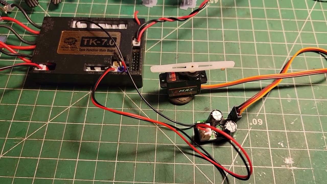

              Port CN6 is what triggers the SOUND.....only. Port CN10 is of course where the motor is hooked up to.
              When converting to servo recoil, its important to put a jumper in port CN6 so the triggering of the sound is instant, which of course is the whole reason why we convert over to servo driven recoil-so the cannon shot happens exactly as the barrel starts to retract, not an hour later waiting for the motor/spring to wind up.
              Port CN6 functions the same across ALL henglong MFU's as well as Canshuo MFU's

                  Confused.
                  "The cannon recoils when the BB fires" --Yes, but with the sound having allot of delay when using the stock motor driven system.
                  "So, there is nothing wrong with using CN6 to trigger the recoil motor" Port CN6 does not trigger the motor. ONLY the sound. The motor, is a motor. Meaning it has to have a relatively LONG press of the button so the motor can spin & compress the spring. A short stroking does not allow a full wind up. It can be seen in my video.Port CN6 Only senses the closing of the circut (the contact pins on the BB unit).
                  "If I have a recoil servo connected to CH1" If you have a Channel 1 on your receiver, then your running a 6.1(s) or a 7.1 MFU, which of course is ideal from a Henglong perspective and no need whatsoever to concern oneself with Port CN6 with the exception of putting a jumper in. If you hook up a servo to Channel 1, NOTHING will happen without the jumper in place.
                  I can hear the cannon sound with CN6 open" That is incorrect. What your hearing is the motor spooling up the spring. Not the sound of the cannon shot.

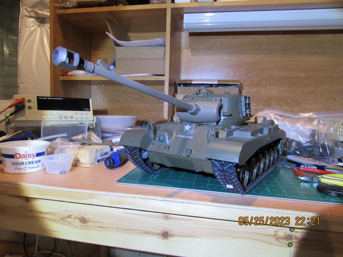

                        My 6.0 7.0 Metal Recoil Barrel BB Unit For 1/16 Henglong 3838 M26 Pershing RC Tank is here. No more excuse for not having one to test. The new barrel is about 1.5-2" longer than the stock barrel, making it more realistic looking already. It may be a few days before I can start this. I am working on the metal upgrade of the Tongde M60A1. This is only a hobby so I work deliberately slow to avoid mistakes. Waiting for metal part paint to dry also takes time.
                        When I asked Toucan about the recoil motor:
                        New message from: toucanhobbyqn5 (795)
                        Hi,
                        This is not a JST connector, it is a XS 2.54 connector. It can be connected to the CN6.
                        If it isn’t match it, could you please send me some pictures of your mainboard and the plugs?
                        Sincerely,
                        Maki
                        Stay tuned for the test results.

                            Post #12 have the link to the unit that I purchased. Unfortunately, my 2005 HL 3838 Snow Leopard has a turret that doesn't match the new recoil cannon. The external turret shape is ok, but the cut out etc changed enough to not to fit. I am looking to purchase a newer Pershing turret now.
                            Anyone has a surplus Pershing turret to donate? I will pay shipping.

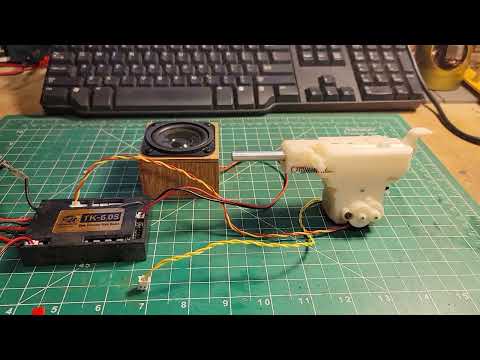

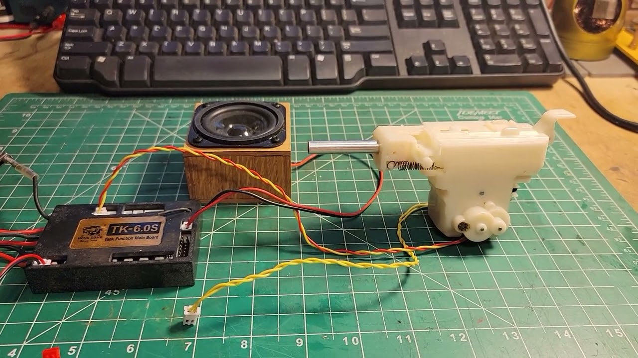

                              I hooked up the HL metal barrel recoil unit to the TK-6.0S MB, BB shooting to CN10 and recoil motor to CN6. It fires and recoils as it should. 3 cheers!! I feel that the return spring is a little stiff, but the recoil action looks very realistic.
                              HL have complete metal barrel recoil BB shooting unit for several tank models at $40-50. It should be a popular upgrade. If your tank is a newer model and already has telescopic barrel, you may be able to use the universal recoil BB unit which sells for about $20. I hope to test one in the near future.
                              I did the recoil test with the unit just free standing on top of the Pershing lower chassis.

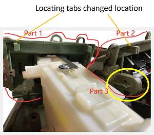

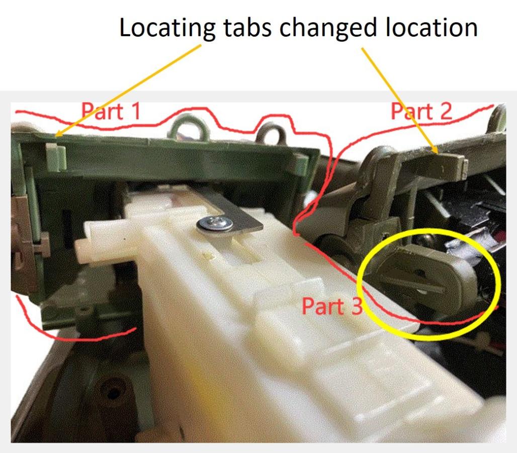

                                  I installed the Heng Long Metal barrel recoil BB shooting unit for the M26 Pershing and M4A3 Sherman and like them. It is a simple motor activated barrel retract and return. It does not simulate the scaled momentum, recoil speed nor rebound damping. The recoil kit's time scale is completely off. It is a much welcome simple solution substitute for the tank body shaping recoil.
