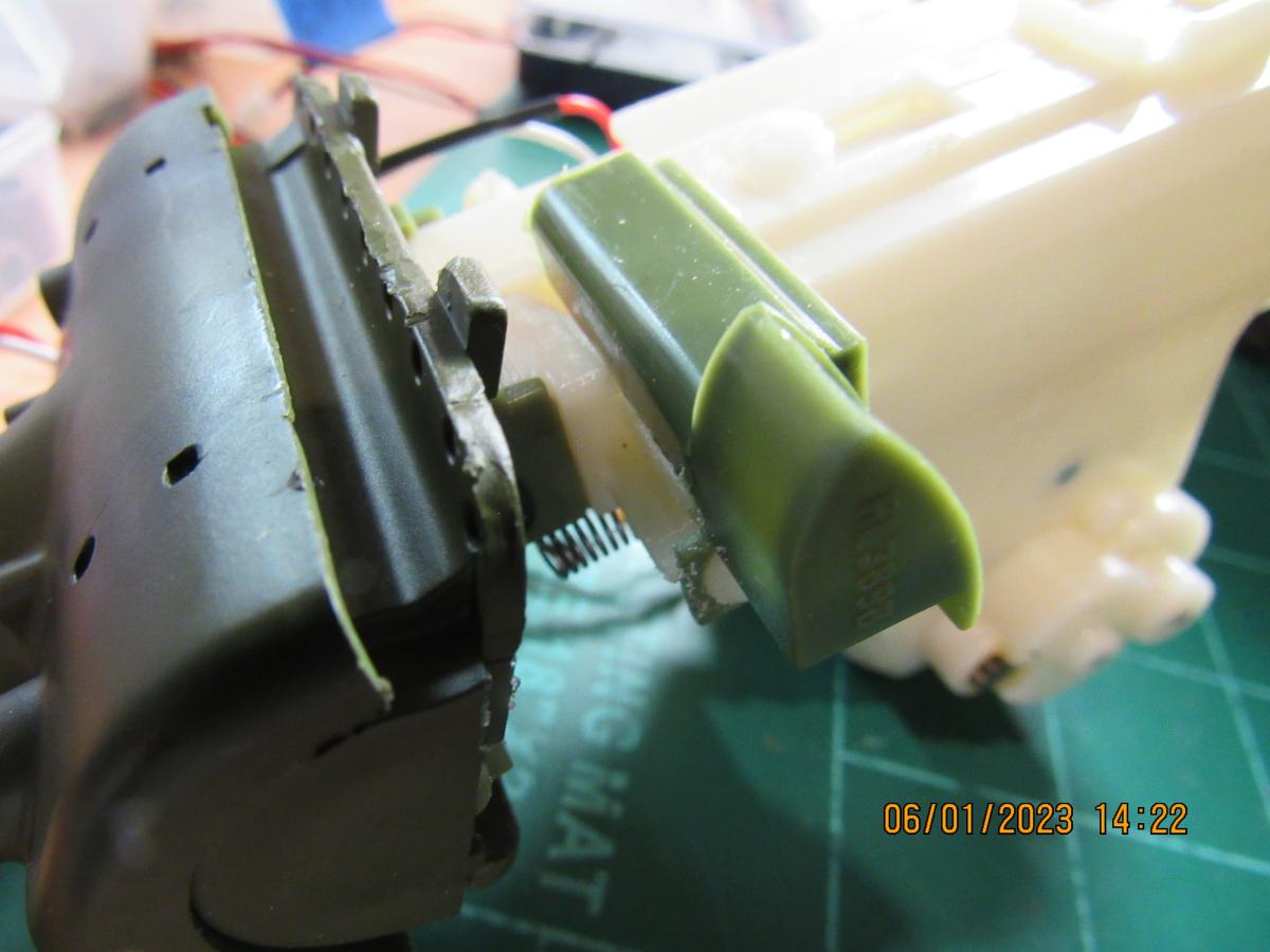

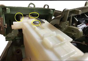

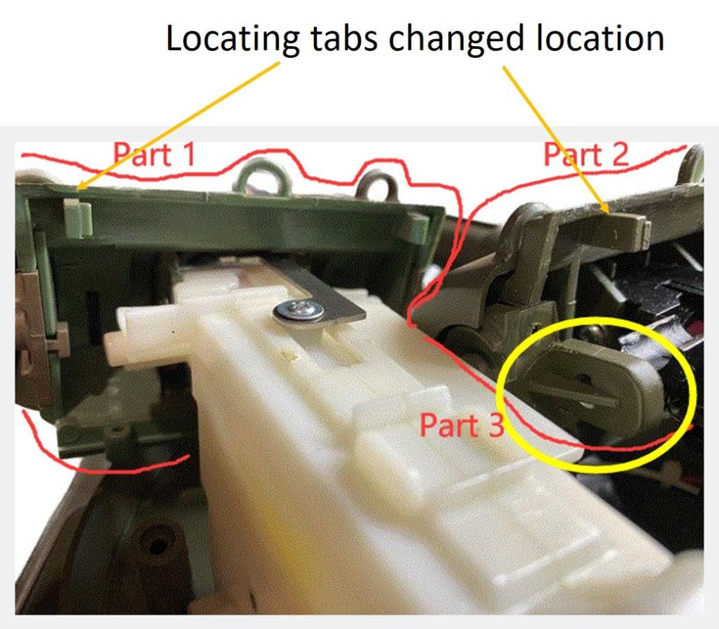

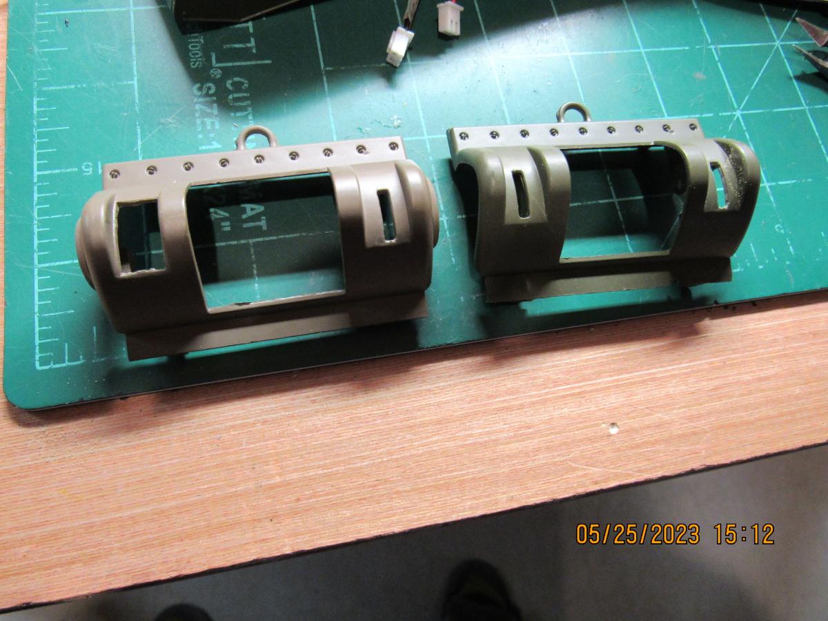

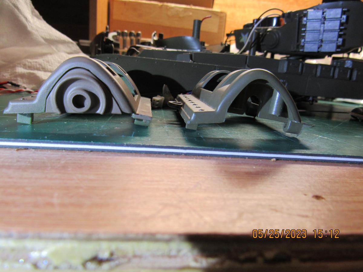

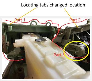

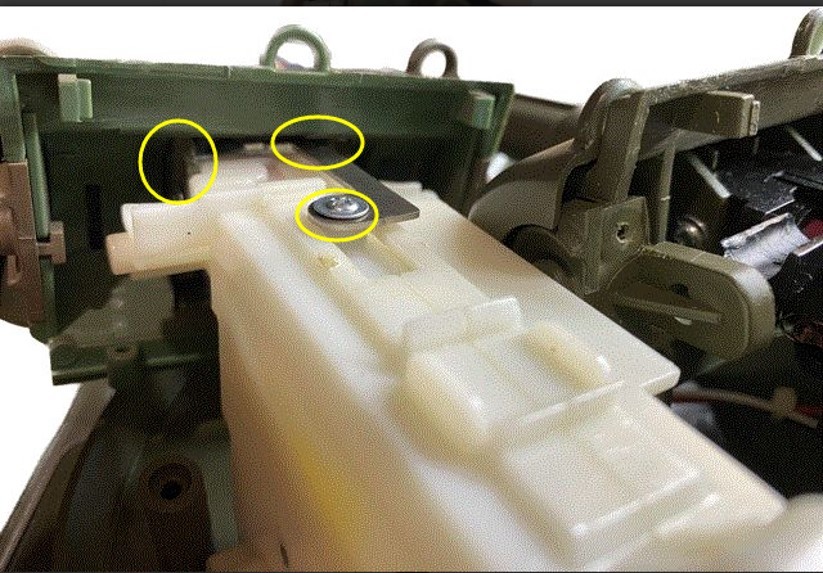

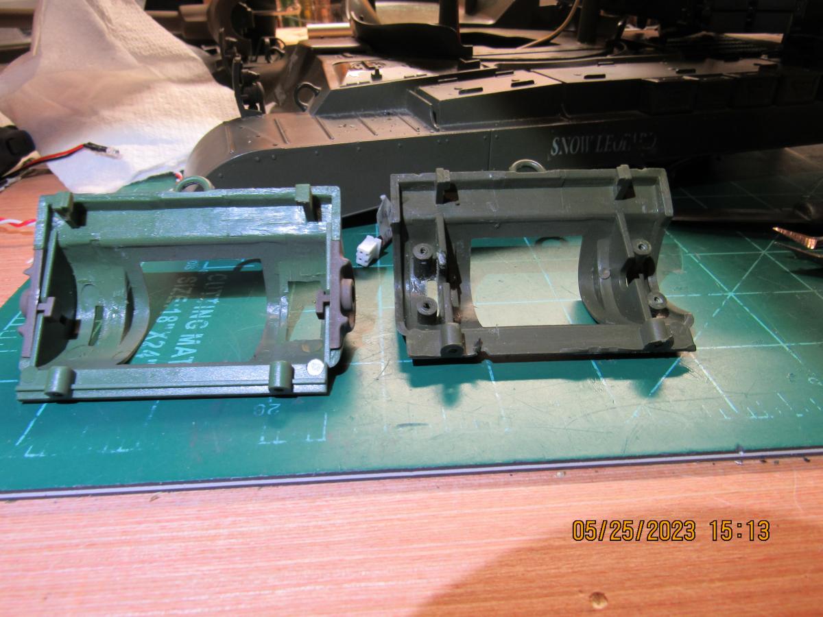

    The picture shows that the locating pins on the mounting plate changed location making the new mantle not compatible with the turret.
    Click image for larger version  Name:	recoil_cannon.jpg Views:	0 Size:	132.0 KB ID:	378340 Click image for larger version

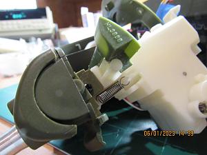

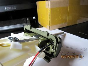

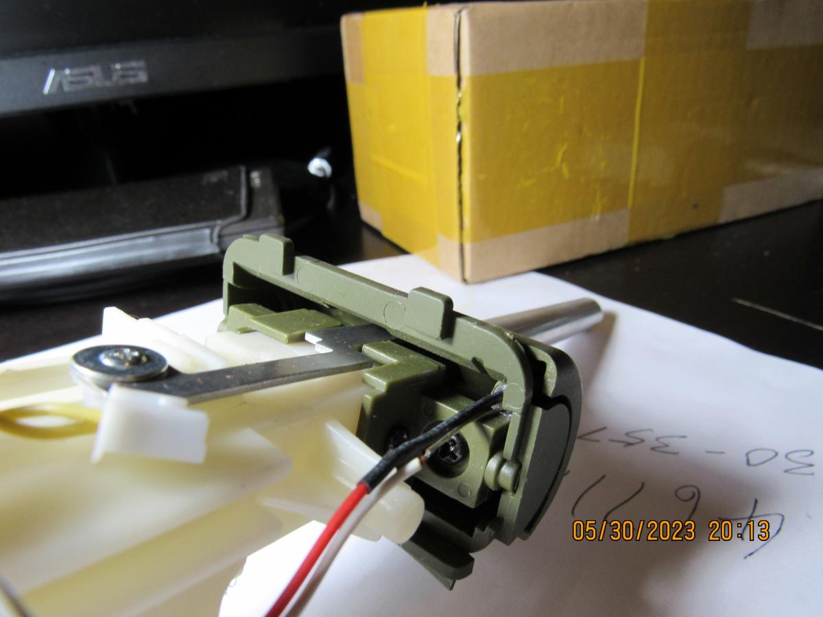

    I swapped in Part 2 and Part 3 from the old tank to replace Part 1 in the recoil kit. Removing the BB unit from the mantle is simple. 2 screw for the old tank and 3 screws for the new. Give Heng Long credit for keeping the BB unit screw holes location unchanged for 18 years. Mounting the BB unit to mantle with the old mounting plate is easy. But combining the mounting plate with the turret is not. In the pictures below, new on the left and old on the right.
    Click image for larger version  Name:	IMG_5173.jpg Views:	0 Size:	131.6 KB ID:	378343Click image for larger version  Name:	IMG_5175.jpg Views:	0 Size:	129.7 KB ID:	378342Click image for larger version  Name:	IMG_5174.jpg Views:	0 Size:	104.7 KB ID:	378341
    The recoil BB unit is bulkier in general and the recoil linkage on top interfere with the turret. The old mantle used 5mm LED diode, but the new mantle has a tall tube to slide a 3mm LED diode in. I removed material from the new namtle and the old turret by trial and error. I don't want to move too fast. Once the interferences were removed, the mounting plate clicked on the turret giving a perfect fit again. The Metal Barrel Recoil BB shooting unit works with TK-6.0S without any electrical modification. Just connect the recoil motor to CN6. The old turret with the new barrel moves like it used to. I paid slightly over $40 for the recoil BB kit and it is a very good investment.
    If you have a very old Pershing like I do, the upgrade is not recommended because it requires too many try and fit steps. If you have a newer version of Pershing, the "metal barrel recoil BB shooting unit" kit should fit as is and is highly recommended.​

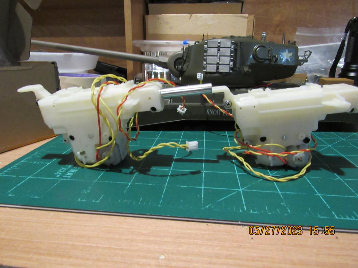

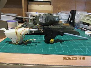

      I have purchased a metal recoil BB unit for the Pershing and one for the Sherman. They are $40-50. I also purchased 2 generic recoil BB unit and one non-recoil BB unit.

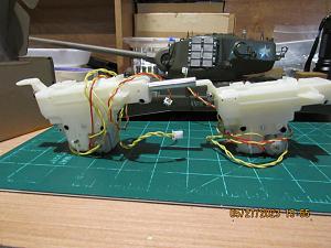

      The picture below shows the old vs the new BB unit, just the BB shooting part.
      Click image for larger version  Name:	IMG_5177.jpg Views:	0 Size:	123.7 KB ID:	378355
      The old BB unit on the right has a long thick wall aluminum tube​ that fits inside the plastic barrel. The new recoil BB unit has a short thin wall aluminum tube that the barrel rides on. The new barrel consists of a plastic outer tube and an aluminum inner tube. The old unit has only one motor for BB shooting. The new unit has a recoil motor in addition to the BB shooting motor.
      I also purchase three generic BB shooting units, two with recoil and one without.
      Click image for larger version  Name:	IMG_5178.jpg Views:	0 Size:	112.4 KB ID:	378356
      It is interesting to notice that both generic units have 2 motors and one is for recoil. The only different is the missing short aluminum tube. The hole at the front of the recoil BB unit is smaller to accept the thin wall barrel riding tube. The hole at the non-recoil unit has the diameter to accept the old thick wall tube, but reduces to the new thin wall tube diameter half way in. I hope to try the recoil BB unit on the Tongde M60A1 and a HL Leopard 2A6.
      The old BB tube is 8.3 mm OD and 6.16 mm ID. The new recoil tube is 7.4 mm OD and 5.84 mm ID. Now, where I can find a piece of the thin wall aluminum tube to convert the non-recoil to a recoil BB unit?

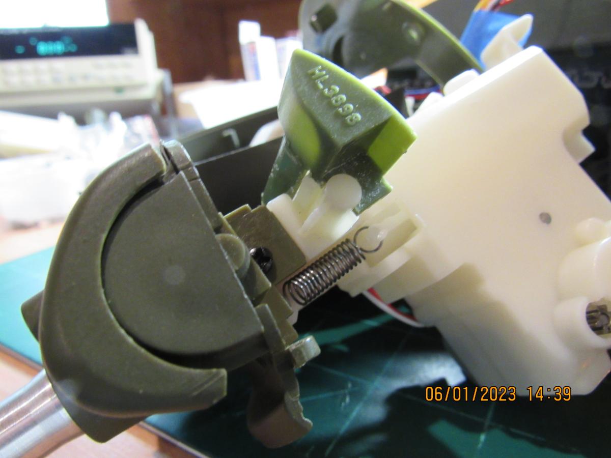

          I looked at the recoil unit more closely. It translates the recoil motor rotation to the barrel linear pull back by a L-shape arm. The rocker portion of the L-shape linkage is very short. If I replace it with a longer rocker arm, will the recoil motor still be powerful enough to pull the barrel? How much longer the rocker arm needs to be? I may build a simple test rig using the generic recoil BB unit. in an assembled turret, the recoil pulling motion is invisible from outside. I have a few servo arms that I can borrow from my spare part bin for the testing.
          For those who have implemented a servo recoil, can I see a picture of your barrel pulling linkage? Much, much appreciated.
          • keilau
            • Mar 2021
            • 1841
            • Windy City
            My idea of using a longer rocker arm does not work. The HL recoil motor already translates into linear motion. It pulls a plunger backward for about half a cm which is how far the recoil barrel will travel. I tested the HL generic recoil BB unit on the Tongde M60A1 and it works smoothly. With the guide from Rubicon99 post, I should be able to implement barrel recoil on the TD M60 easily.

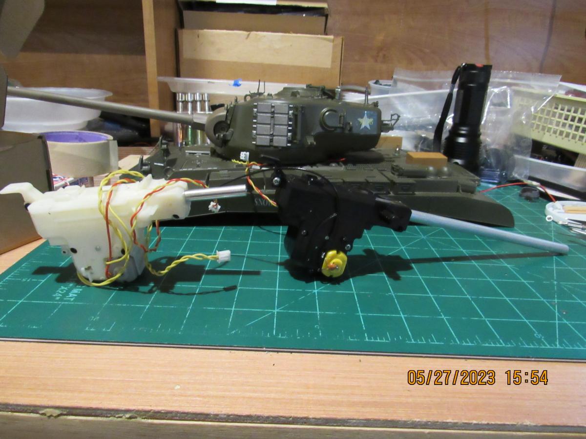

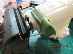

                After all the trouble I had matching a new mantle to an old turret on a Pershing. The Sherman should be a cake walk, right? I received the metal barrel recoil BB shooting unit for 3898 Sherman Tuesday late afternoon. Everything looks good and I expect the replacement operation to be quick.
                I got the recoil unit with the 75 mm cannon paying $20. The barrel is an well finished aluminum tube, same length and OD as the plastic cannon, but much thinner wall, unpainted. There is 105 mm varity, but the seller wanted $30 for just the Firefly barrel. For now, 75 mm is enough firepower for me. The 3 connectors from the left are recoil. BB shooting and turret infrared LED.
                Click image for larger version  Name:	IMG_5179.jpg Views:	3 Size:	79.0 KB ID:	378626Click image for larger version  Name:	IMG_5180.jpg Views:	3 Size:	74.4 KB ID:	378627Click image for larger version  Name:	IMG_5183.jpg Views:	3 Size:	73.4 KB ID:	378628Click image for larger version  Name:	IMG_5182.jpg Views:	3 Size:	74.5 KB ID:	378629
                The Sherman turret is relatively small. I loosen the gun elevation motor and BB feeding tunnel. The old BB unit should come out easily, but it is stuck. My gentle persuasion pull is not working and I am concerned about breaking the turret. Will try again later. Any suggestion on how to disassemble the Sherman turret is appreciated.

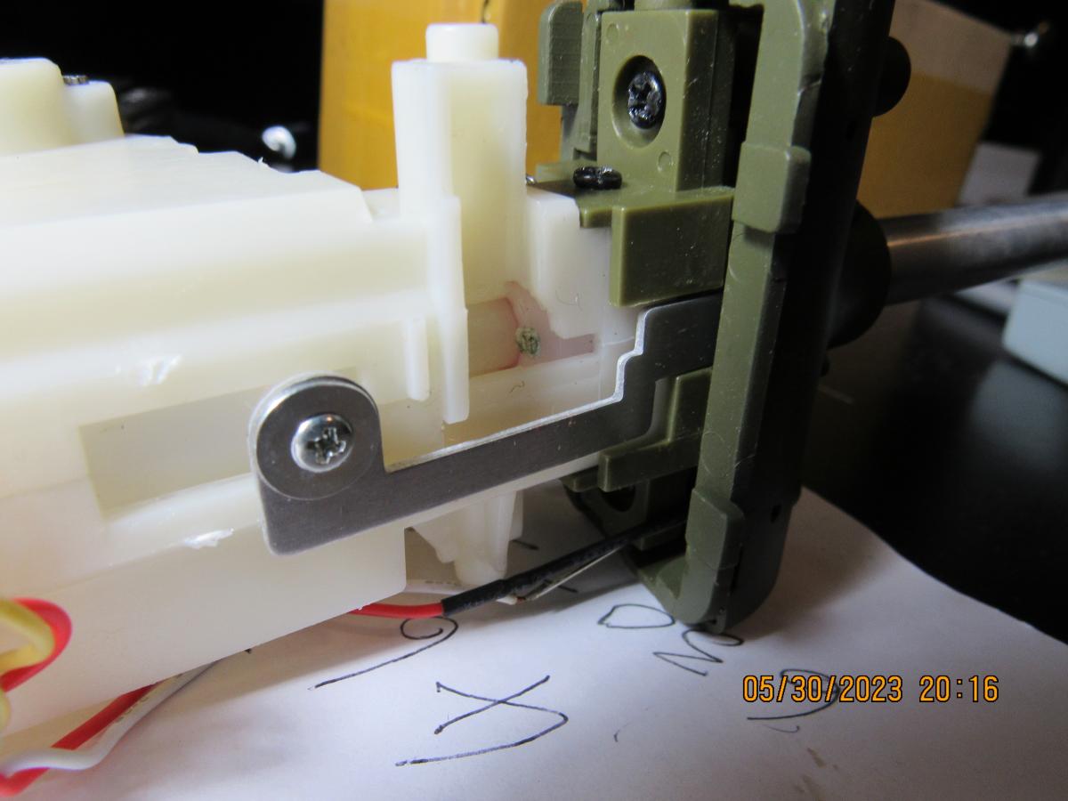

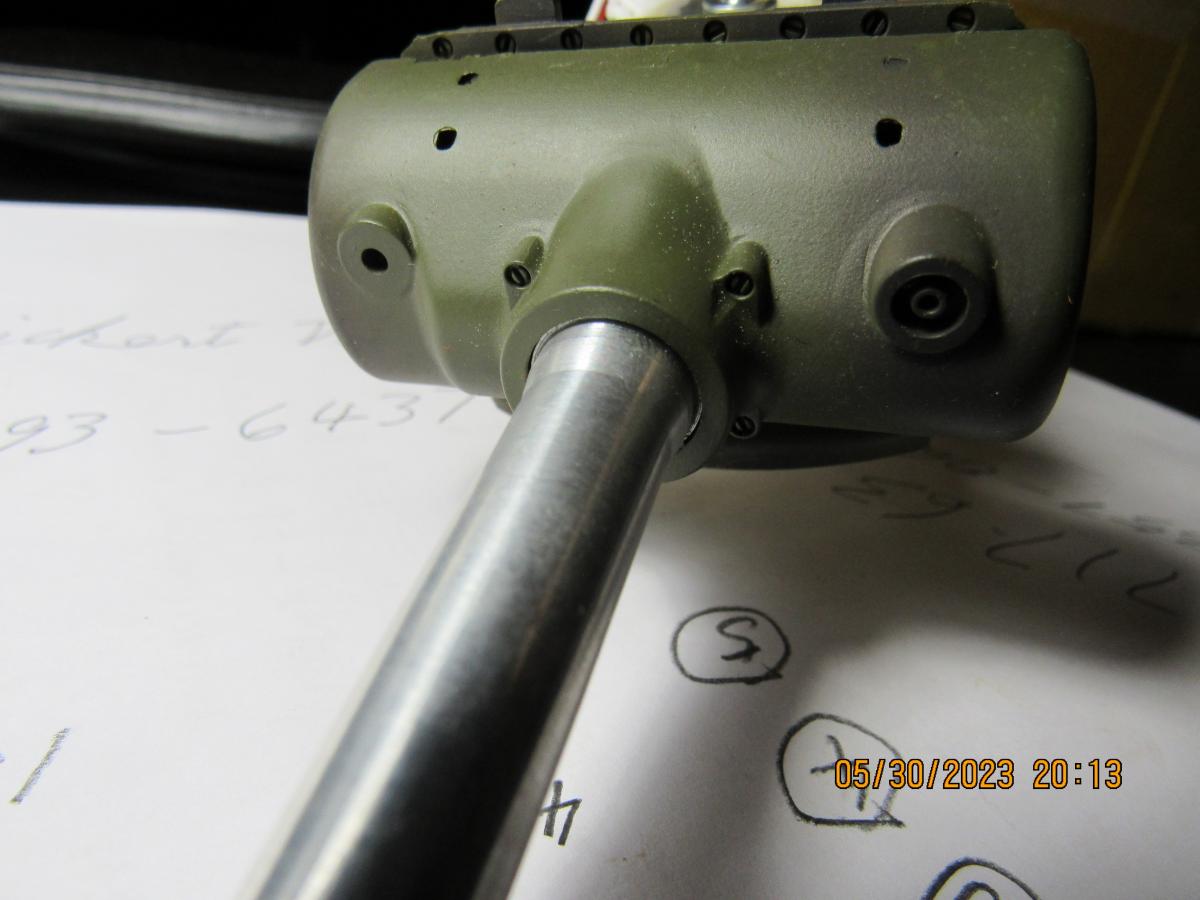

                        I went to bed after I tested fit the new cannon/mantle. There is a small piece of the BB feeding tunnel that I could not get off the old BB unit. It appears to be glued in place using some clear acrylic. Next morning, I tried to ply this piece off without breaking it.
                        Click image for larger version  Name:	IMG_5186.jpg Views:	0 Size:	79.9 KB ID:	378675Click image for larger version  Name:	IMG_5187.jpg Views:	0 Size:	83.7 KB ID:	378676
                        I took the new BB unit out of the turret which takes about 3 minutes. It's much easier once you learned how the interlock work. I broke half of the locating ring when I removed the small piece of the BB feeding tunnel which does not affect the functionality. I used a few small drops of RTV to fix the piece in place. Mechanical assembly of the turret is done. But electrical connections and functionality test should be next. Hope to complete before dinner time.
                        Click image for larger version  Name:	IMG_5184.jpg Views:	0 Size:	107.6 KB ID:	378677

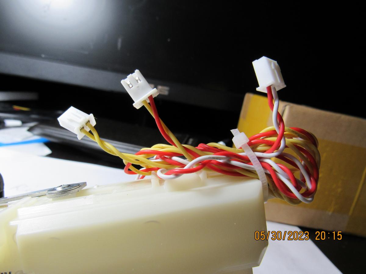

                          The Sherman is back together, everything work as they should EXCEPT the barrel recoil!!! The recoil BB unit was tested on another tank. I push the barrel in to verify there is no obstruction of movement. Was the trigger signal at CN6 turned off? is it possible? Do I get a faulty TK-7.0 main board? Any suggestion is appreciated.
                          Recoil is the only upgrade this time and the only function not working!
                          • keilau
                            • Mar 2021
                            • 1841
                            • Windy City
                            Thank you to @SoCalBobS, his suggestion gave inspiration to try different function switches on the transmitter. The "G + B" function swith works for me. Now, the Sherman is barrel recoiling as it should.
                            Click image for larger version  Name:	image.png Views:	0 Size:	70.5 KB ID:	378747​​Why this function was turned off originally is beyond me.
