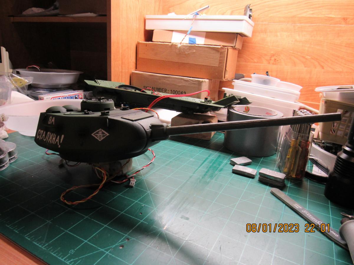

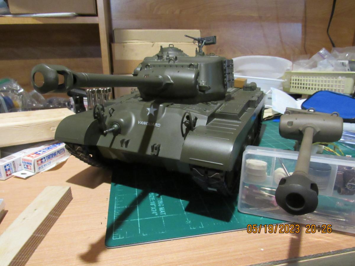

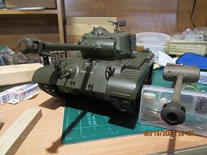

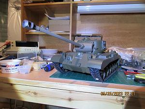

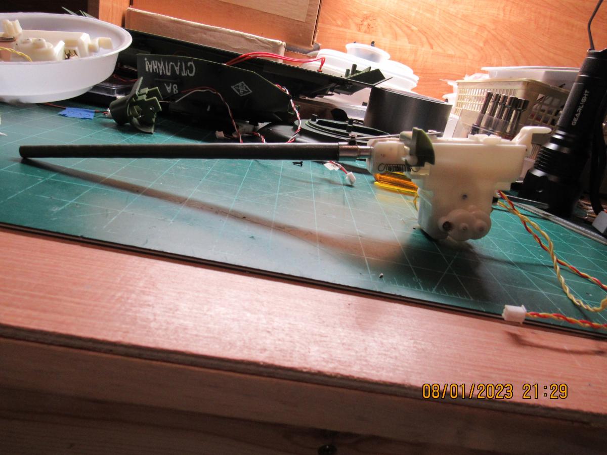

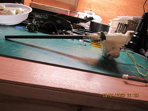

              I took a 2 months break from my RC tank recoil project. I resumed the activity in late July with the HL T-34/85 using a HL generic BB shooting recoil unit that I got for $10 from one of the Toucon sellers. The pictures show the parts, the finished metal recoil BB unit and the reassembled turret. I will detail the challenges in the next few days. It is not a difficult project, but does need some elbow grease.
ID:	383317Click image for larger version
ID:	383318Click image for larger version
              The T-34/85 looks like before, but with a recoil barrel.

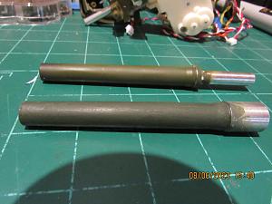

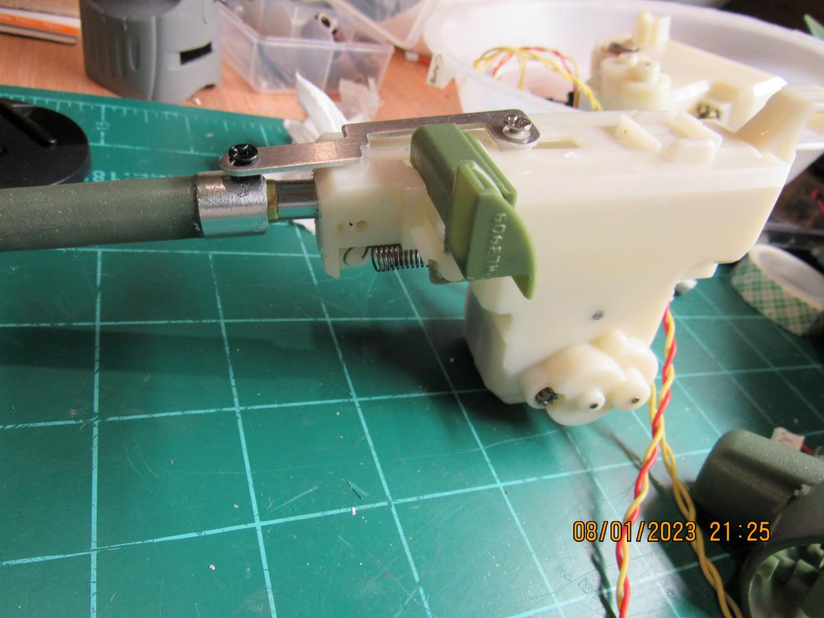

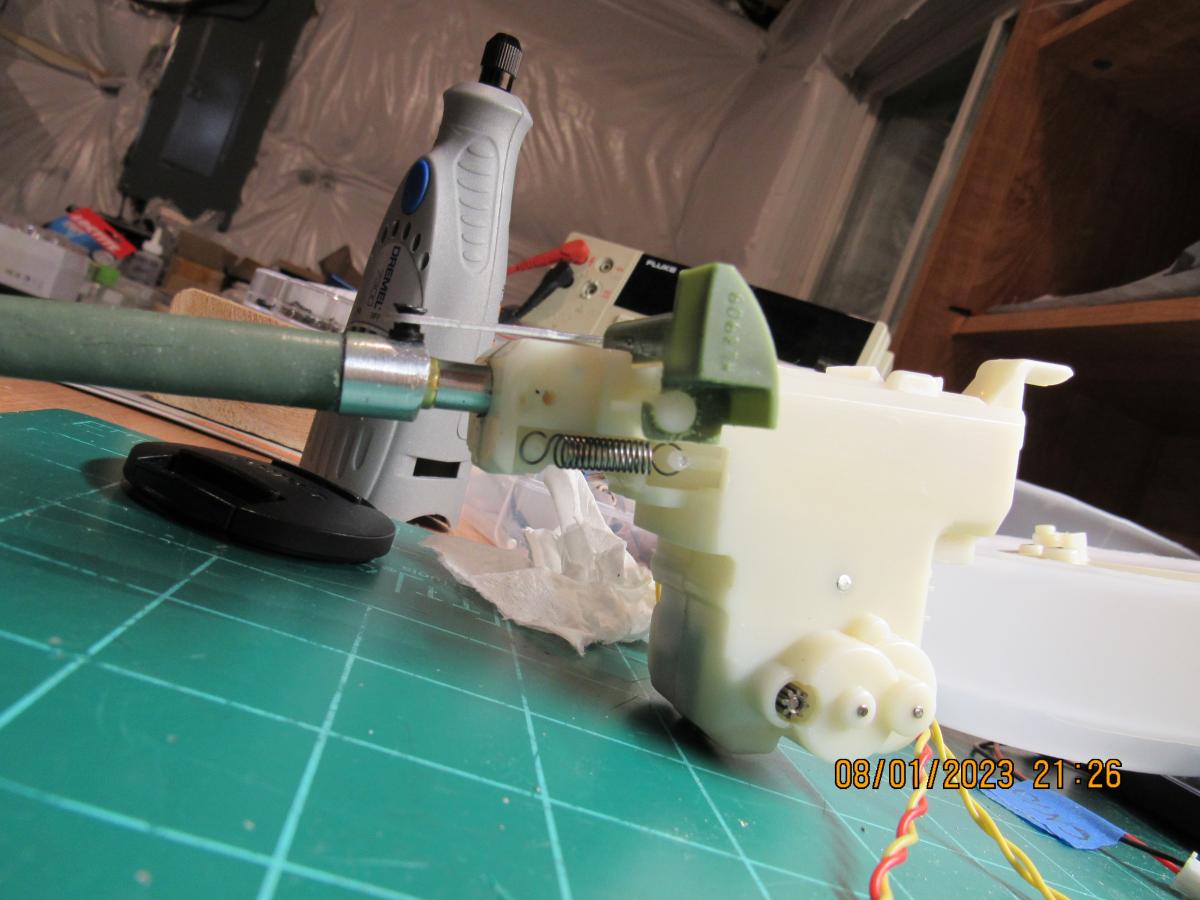

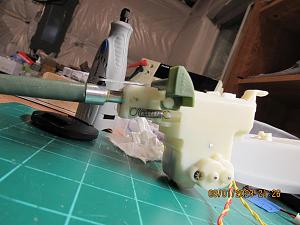

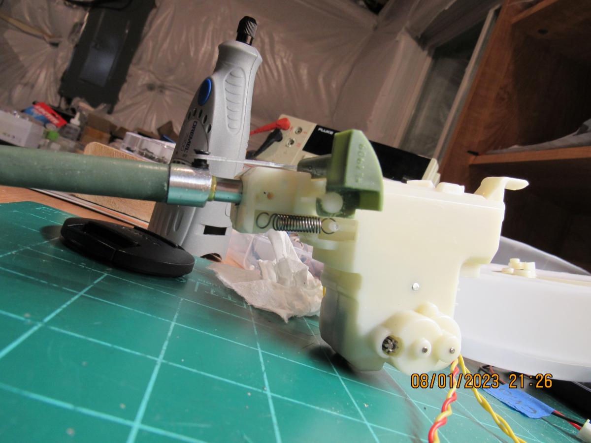

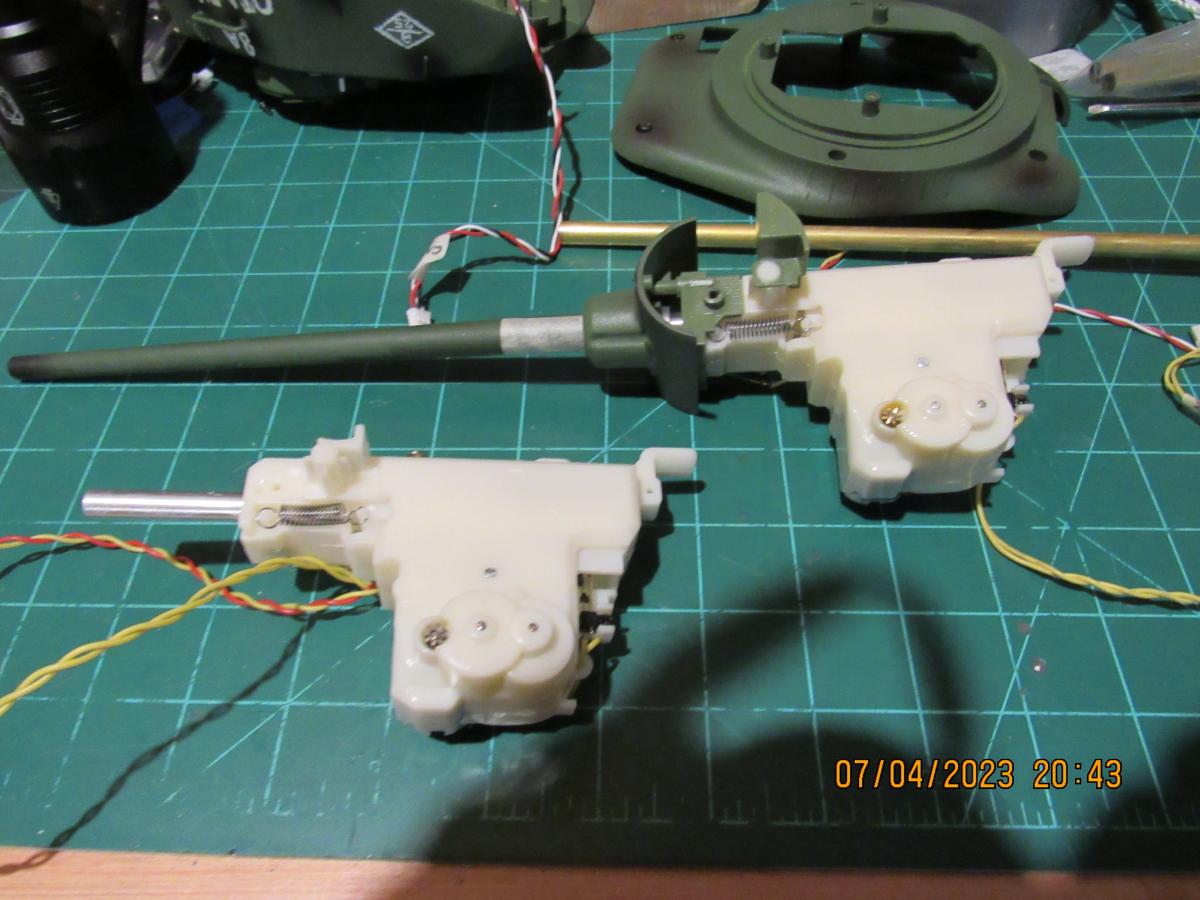

                The original non-recoil BB shooting unit has a stationary barrel. In earlier HL tank, it is a long aluminum tube with a plastic sleeve. In later tanks, HL makes one piece aluminum barrel. For recoil, a telescopic tube is needed.
                Click image for larger version  Name:	IMG_5177.jpg Views:	0 Size:	123.7 KB ID:	383322Click image for larger version  Name:	IMG_5195.jpg Views:	0 Size:	92.0 KB ID:	383323Click image for larger version  Name:	IMG_5202.jpg Views:	0 Size:	94.6 KB ID:	383324
                The BB tube inner diameter was scaled for the 6mm BB's, making it too small to ride on the recoil tube. The one piece barrel has lots of wall material. I chose the T-34/85 barrel as my experimental subject, I removed 2cm from the barrel to allow room for recoil. The ID of the barrel will be enlarged to ride on the recoil tube which is a 7.6mm OD tube. I used a step drill bit to start before switching to a 5/16" drill bit. Drilling out the inner diameter of the tube is not easy even with aluminum. I used top brand new tintanium bit. Drilling the first half inch is easy. As I went deeper, the aluminum barrel heated up quickly causing the bit to bind. I stopped, let the barrel to cool before I drilled again. It took a total of 3 days to get the 4.7mm length I wanted.
ID:	383332Click image for larger version

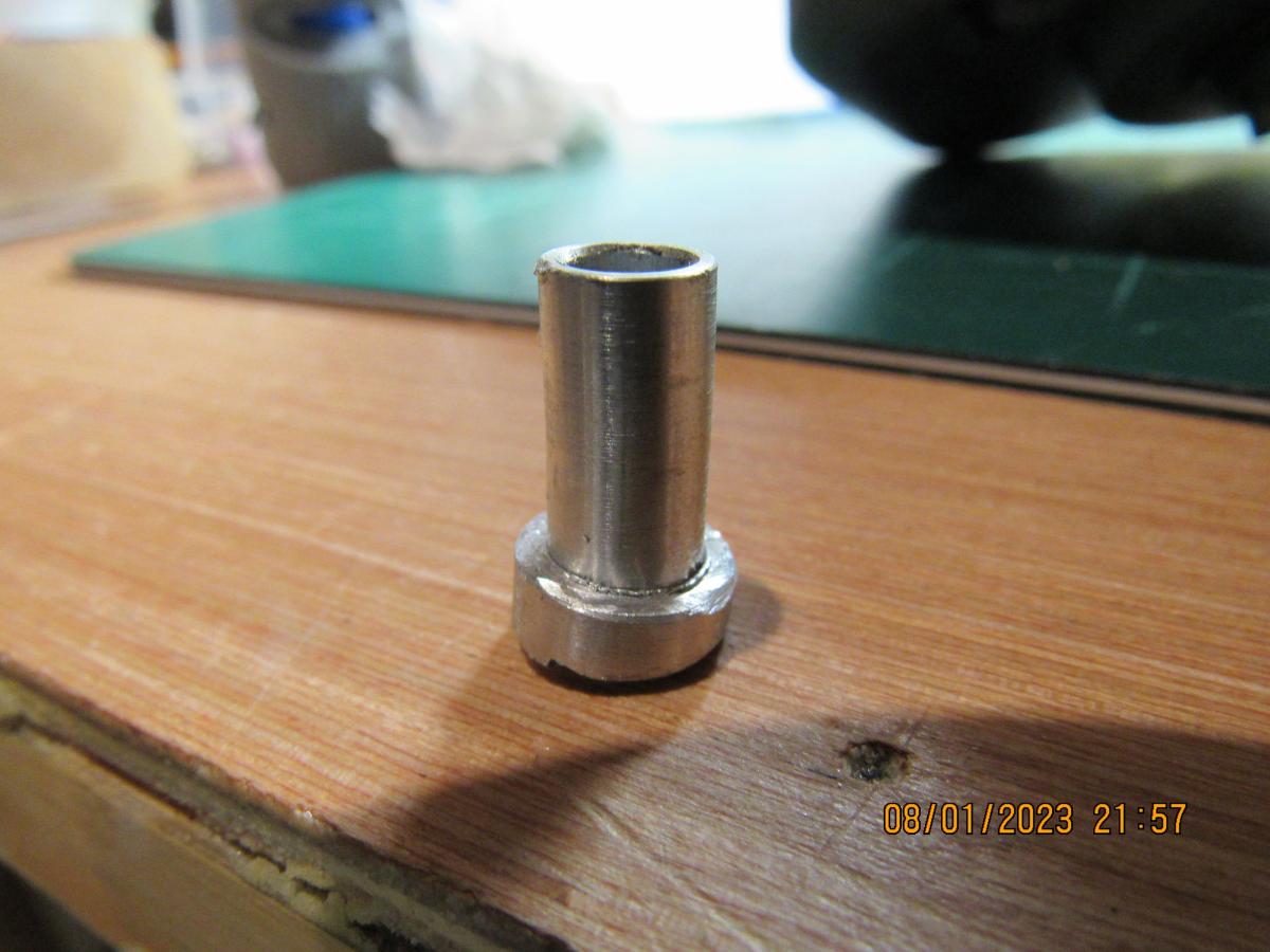

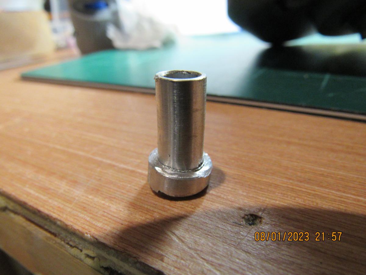

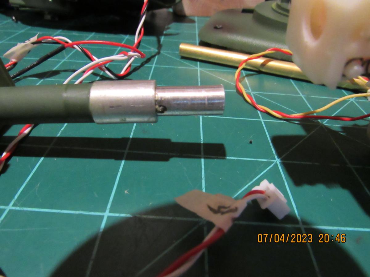

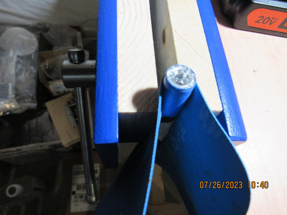

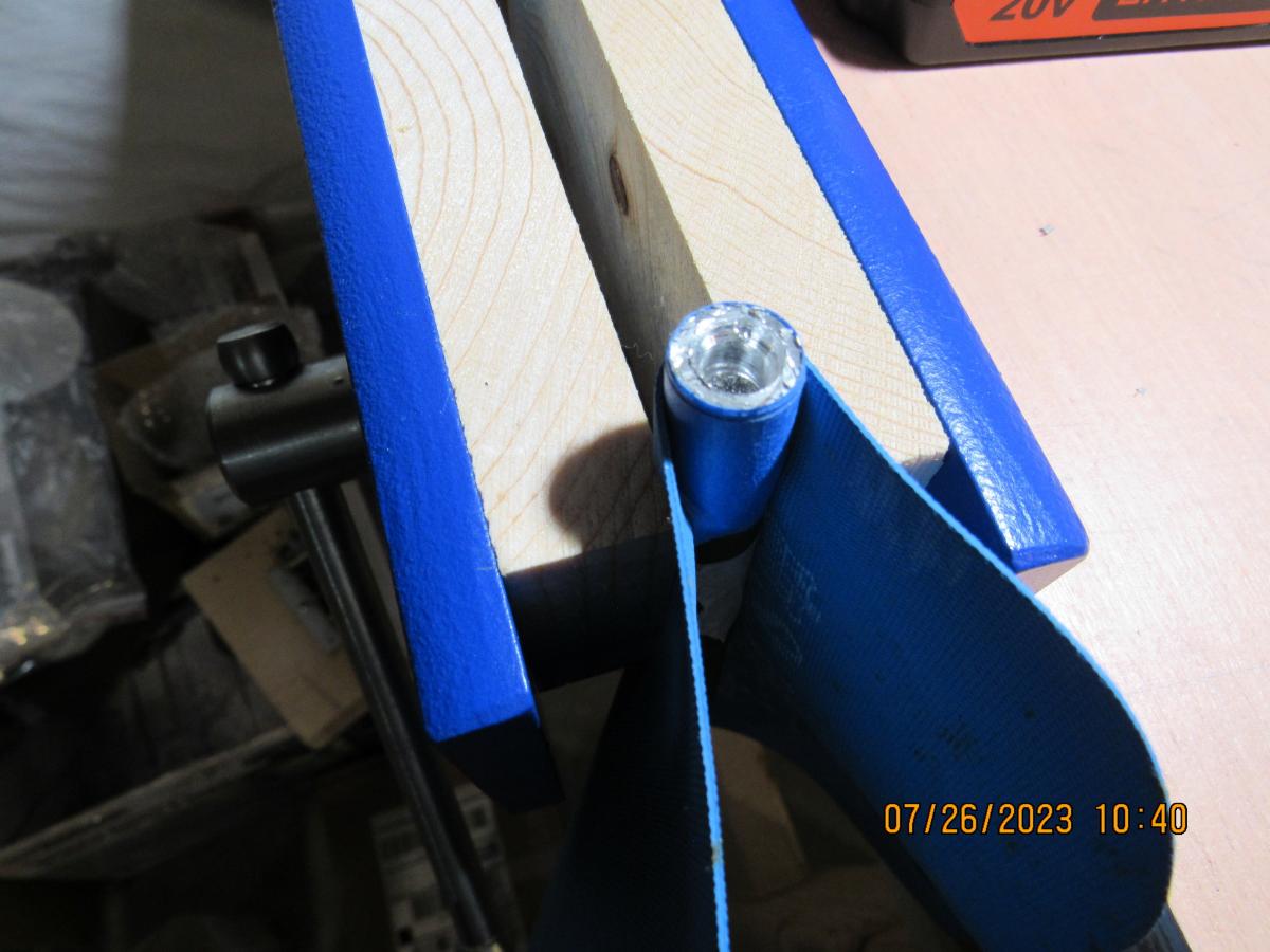

                Another unpleasant task is to transfer the BB feeding housing to the new unit. The housing was glued down to the old unit making it difficult to remove without breaking it.
                After drilling out the barrel, I inserted an 8mm thin wall brass tube into it as liner. It makes a perfect fit and avoid aluminum sliding on aluminum. The brass liner also presents a positive stop for the mounting screw, not to intrude into the BB path.
                Click image for larger version  Name:	IMG_5199.jpg Views:	0 Size:	96.4 KB ID:	383327Click image for larger version  Name:	IMG_5200.jpg Views:	0 Size:	95.5 KB ID:	383325Click image for larger version  Name:	IMG_5201.jpg Views:	0 Size:	124.4 KB ID:	383326
                This custom made metal recoil BB shooting unit is a drop in fit to the HL T-34/85 turret. It recoils smoothly. (Don't forget to use the G+B buttom to turn on the BB unit for the recoil to work.)

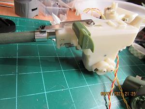

                      Originally posted by keilau
                      I took the new BB unit out of the turret which takes about 3 minutes. It's much easier once you learned how the interlock work. I broke half of the locating ring when I removed the small piece of the BB feeding tunnel which does not affect the functionality. I used a few small drops of RTV to fix the piece in place. Mechanical assembly of the turret is done. But electrical connections and functionality test should be next. Hope to complete before dinner time.

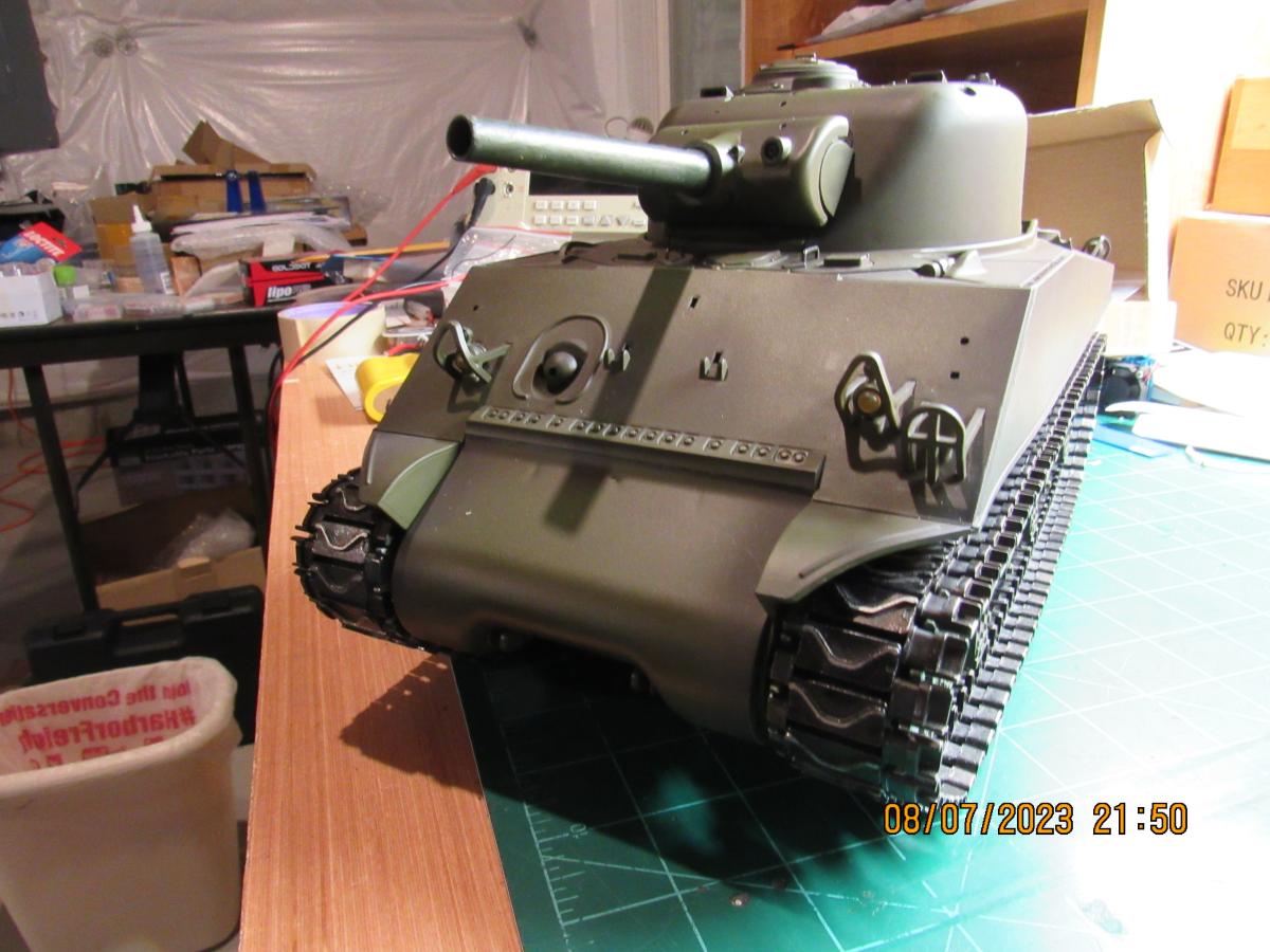

                      Click image for larger version Name:	IMG_5184.jpg Views:	0 Size:	107.6 KB ID:	378677

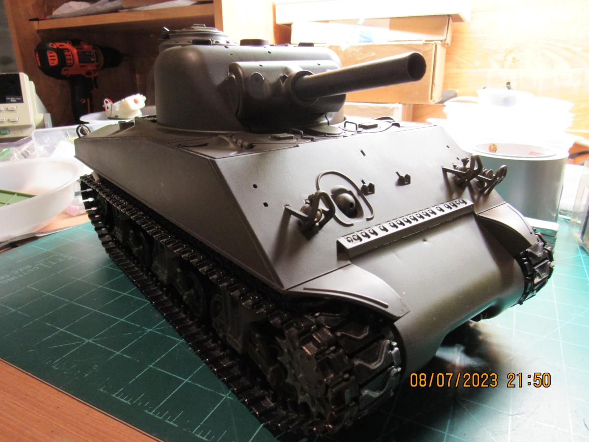

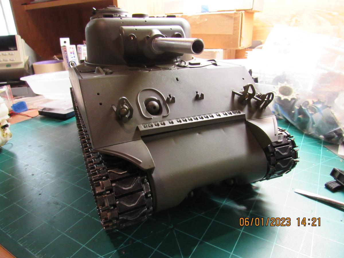

                      After the T-34/85 was back together and functioning properly, I went back to the Sherman to complete some unfinished business, namely, painting the 105mm gun barrel. I applied 3 coats of Kryton Colormaxx Italian Olive. Don't apply model paint to aluminum directly because of poor adhesion. Then, I brushed on a layer of Tamiya Xf-58 Olive Green. It is still more greenish than I would like, but the flat finish is much more flat than the Kryton spray paint. Thus, a better match to the HL color.
                      Click image for larger version  Name:	IMG_5208.jpg Views:	0 Size:	118.5 KB ID:	383622Click image for larger version  Name:	IMG_5209.jpg Views:	0 Size:	118.3 KB ID:	383623

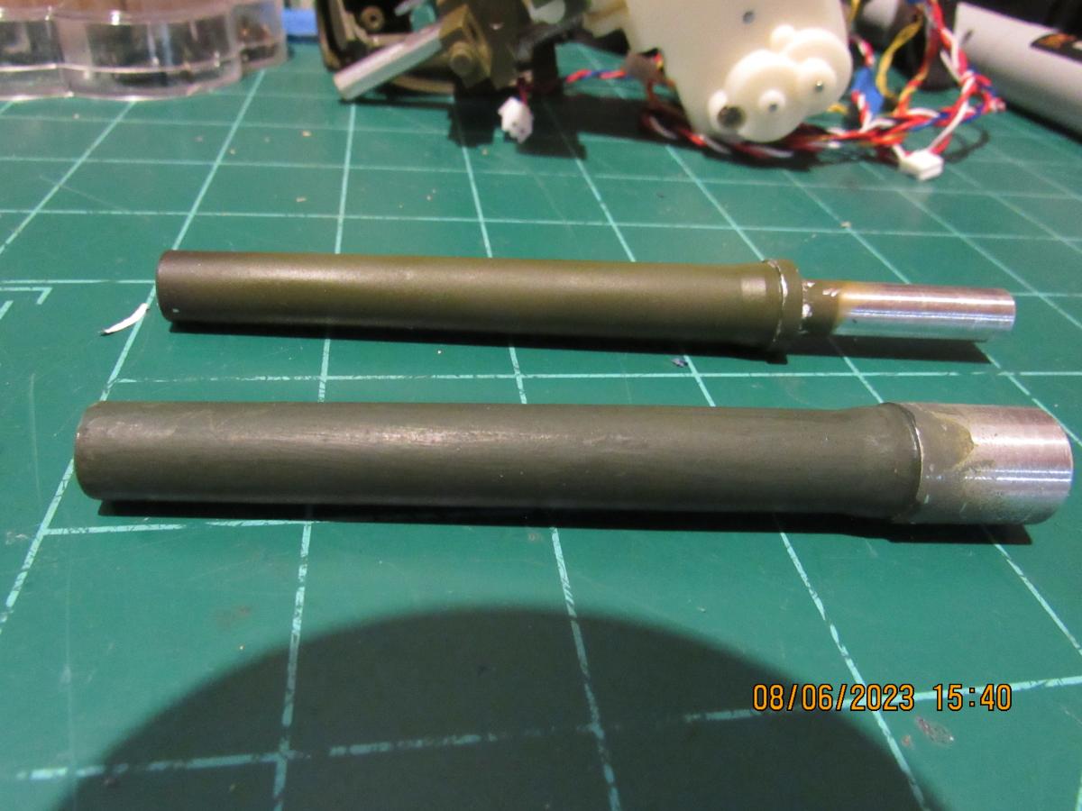

                      While I had the recoil unit apart, I cannot resist a minor upgrade. I insert a brass liner into the Sherman recoil barrel. The 8mm OD brass tube is a perfect fit. I brush on a little liquid CA glue to fix the liner in place. The 2mm thin wall brass tube eliminates the barrell and recoil stub gap while making the slip smoother.
                      Click image for larger version  Name:	IMG_5205.jpg Views:	0 Size:	98.5 KB ID:	383621
                      The original barrel (in back) wall is too thin for modification.

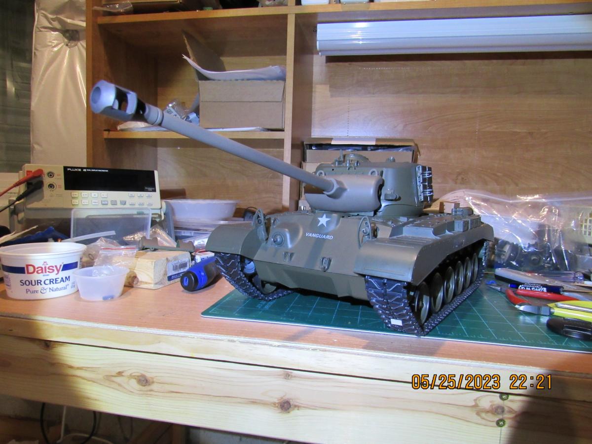

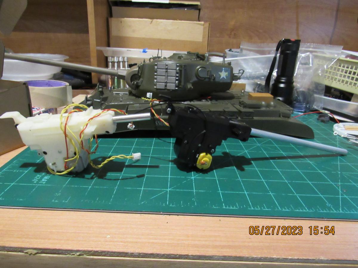

                        A few days ago, I posted on a Heng Long Metal Barrel Recoil BB shooting unit for 3838 Pershing upgrade kit that I purchased for my 2005 Snow Leopard. I said that over 18 years, HL changed the cannon mantle mounting plate enough that the kit does not fit my Pershing. I contact the Toucan seller (build-for-u) to request a return. They got back to me in a few days after talking to the HL technical team. They came up with the idea of swapping the old mounting plate to the new unit. It works, but it is not a simple direct drop-in replacement. It took me 2 days of careful griding and cutting. I will post more pictures to describe the process in the next few days.
                        The Metal Barrel Recoil BB shooting unit works with TK-6.0/7.0 without any electrical modification. Just connect the recoil motor to CN6. I have upgraded the Pershing with a TK-6.0S MB which works together very well.
                        The Metal Barrel Recoil BB shooting unit is bulkier than the old BB only unit. I will do more test tomorrow to see if there is any interference problem in turret movement. In the pictures below, Left is the Pershing with the old cannon where the barrel and mantle are molded as one piece. On the right is the Pershing with the recoil unit. You can see the longer barrel.
                        Click image for larger version Name:	IMG_5167.jpg Views:	0 Size:	111.1 KB ID:	378234Click image for larger version Name:	IMG_5176.jpg Views:	0 Size:	133.4 KB ID:	378235
                        I will like to mention that the seller, build-for-u, gave me the full refund and told me to keep the recoil unit. He asked for a positive feedback on ebay and that I keep them in mind for future business. I purchsed the Leopard 2A6 amd Sherman M4A3 from them the last 2 years. They have exceptional customer service.
