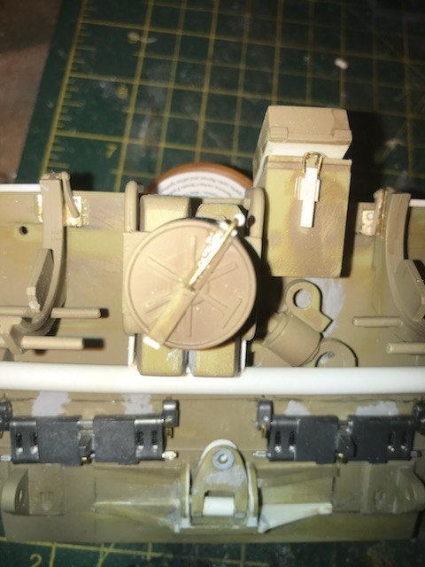

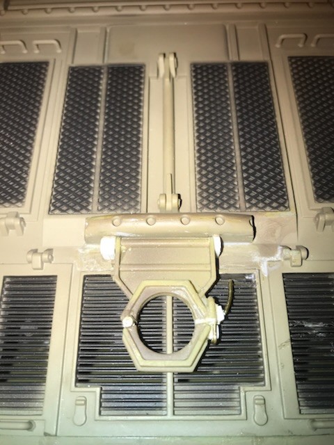

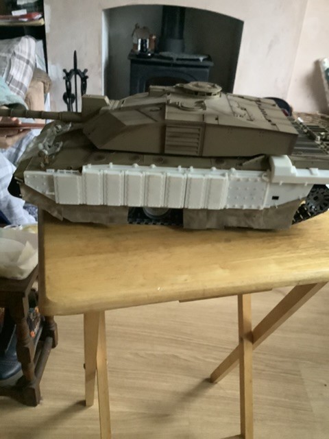

    As I have not been on here for a while, I thought there might be interest in my attempts to build a representation of a UK tank that served in Iraq on operation Telic. Call sign 32 of A Sqn Scots Dragoons. I bought this model about 3 years ago, and worked on it slowly in between changing jobs, building a house, and finally moving in. It helped with a stressful time at work, hence changing job. It was leave or hit the manager.
    Any way a start was made on the rear panel. Which ended up looking like this. Click image for larger version

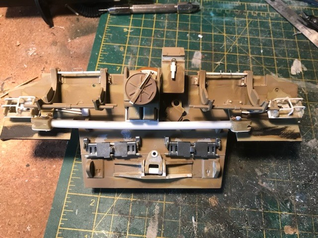

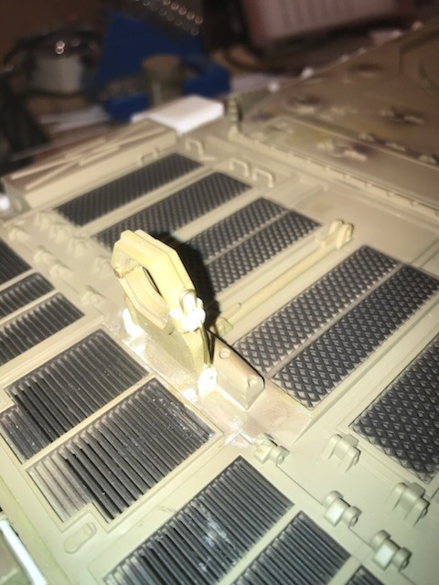

ID:	379607 The whole rear bulkhead was stripped and details studied and each part built slowly, from the lights to the first aid box and fuel tank carriers. Next was the replacement of the plastic wheels, with full metal wheels, with bearings, and metal tracks, and a start was made on the installation of the secondary appliqué armour
ID:	379608Click image for larger version
ID:	379609Click image for larger version
ID:	379610Click image for larger version

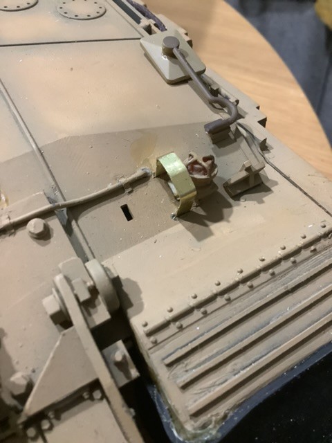

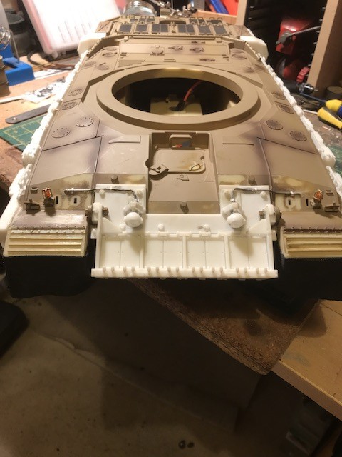

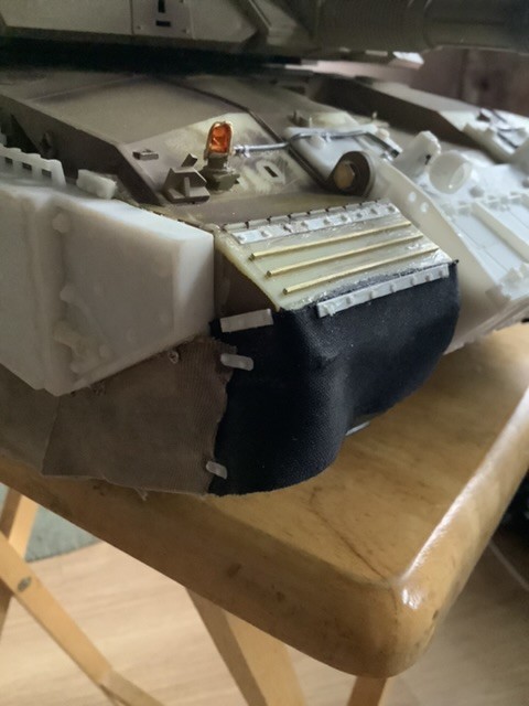

ID:	379611 Mudguards were made from nylon, but later changed to rubber from old inner tubes. Head lights were installed, along with working indicators, made from Lego. A representation of the conduits to the lights were made from solder and paper, with dust skirt fixtures made from plastic card. Nuts were made from various sizes of hexagonal plastic rod. Next up was the travel lock/support for the gun. This was made to work, however because I am a kack handed buffoon, I ended up gluing it up.🤬 Click image for larger version
ID:	379625Click image for larger version

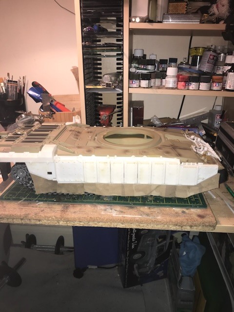

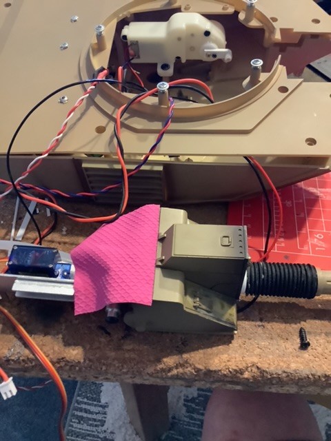

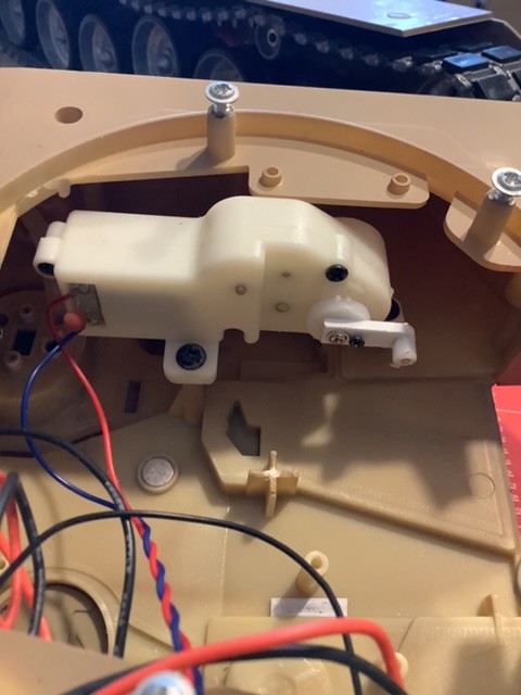

    Over time, the electronics were sorted. Working indicators, brake lights, head and tail lights were connected. A servo operated gun recoil was fitted, along with cannon smoke and flash. I tried to install gun elevation and depression, using a servo but failed, so resorted to school boy physics and made a slightly longer arm for the elevation motor. Click image for larger version
ID:	379615Click image for larger version
ID:	379616Click image for larger version

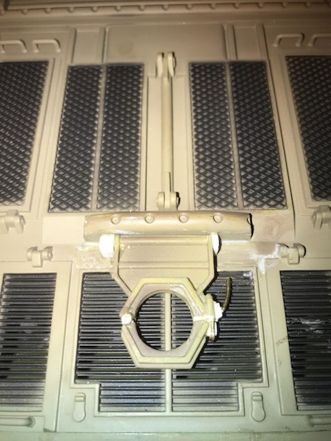

ID:	379617 Some smaller details were made in the area of the fire extinguishers, which also had a small amount of additional detail added. These were painted and covered with a cloth to represent the canvas covers as seen in photographs. Click image for larger version

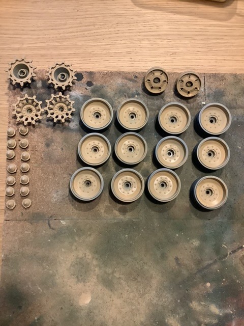

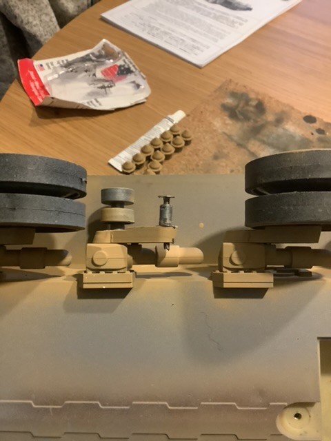

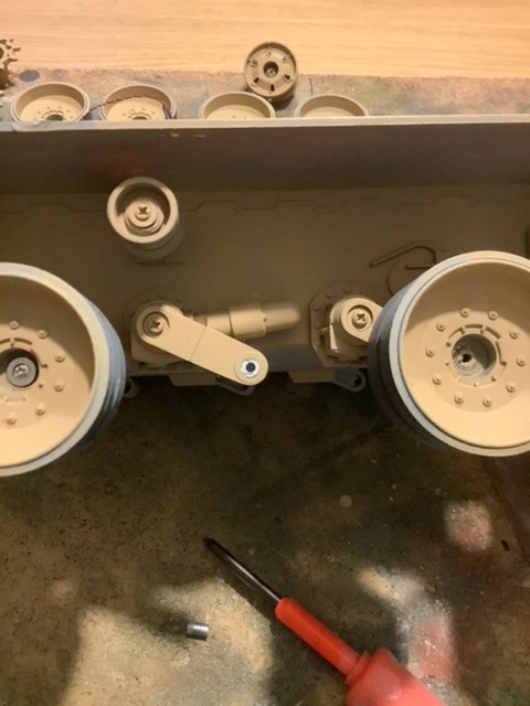

ID:	379618 Everything was painted, and on re-assembly of the chassis, one of the swing arms broke, which was repaired with brass rod and JB Weld. Click image for larger version
ID:	379619Click image for larger version
ID:	379620Click image for larger version
ID:	379621Click image for larger version

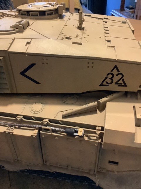

ID:	379622 The call sign, the Saltire 🏴󠁧󠁢󠁳󠁣󠁴󠁿 and coalition markings were a mixture of stencils, masking, and reflective tapeI still need to put the Desert Rat symbol on the door of the TISH. Click image for larger version

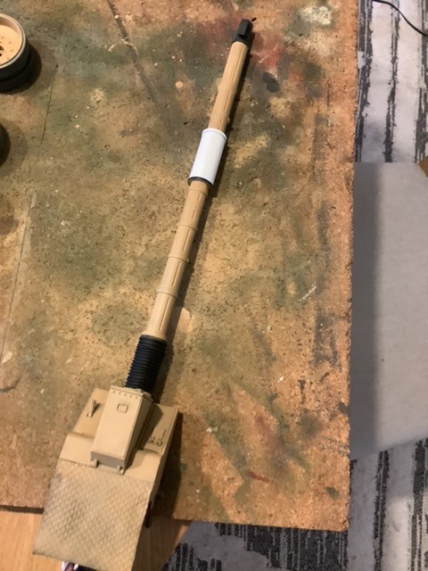

ID:	379623 Dust skirts were made from an old pair of trousers (pants for our colonial cousins). The loader’s 7.62mm machine gun was from a 3d printed kit, and aerials from small springs and wire. Sorry there are not more photographs but I did not really think about recording all the work as I did not think anyone would be particularly interested, especially given the quality of other people’s work, and my limited abilities. It is not 100% accurate, but it has give a lot of pleasure (which it what it is about) a few frustrations along the way and built on the skills and learning from the work carried out on my Abrams. Click image for larger version
ID:	379624 There is still a bit to do, like weathering and finishing some painting.
    Please feel free to critique
    Regards Ian

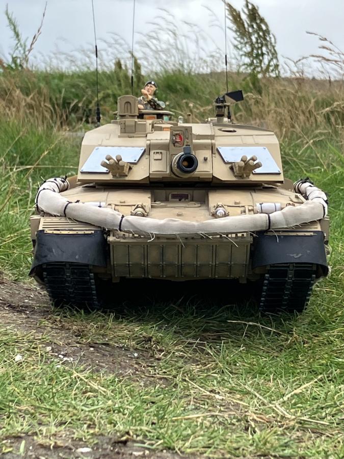

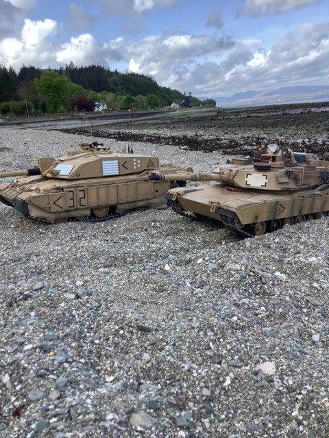

                Took out the Challenger over some difficult terrain this afternoon. Only started throwing the left track after an hour. It was run over sand, grass, mud, stones, and water. Now in for track tightening. I may have a faulty connection somewhere, possibly the main switch, as it exhibited a tendency to turn off in some instances on switching on. Click image for larger version
ID:	381263Please excuse the commander. He may have been drinking. He does look a bit under the influence, and he seems to be disobeying the uniform requirements.

                  Well that's some positive news. Glad to hear you got some good time in before any issues.
                  Nice pic too.
                  Care to share which battery or batteries you are using? Is it getting you a full hour of fun or are you switching out batteries?

                    [QUOTE=
                    Nice pic too.
                    Care to share which battery or batteries you are using? Is it getting you a full hour of fun or are you switching out batteries?[/QUOTE]
                    Thank you for the compliment, regarding the photograph.
                    I was using a 4000mAh LiPo. I do remove the exhaust smokers from my tanks, and no battery change.
                    Regards Ian
