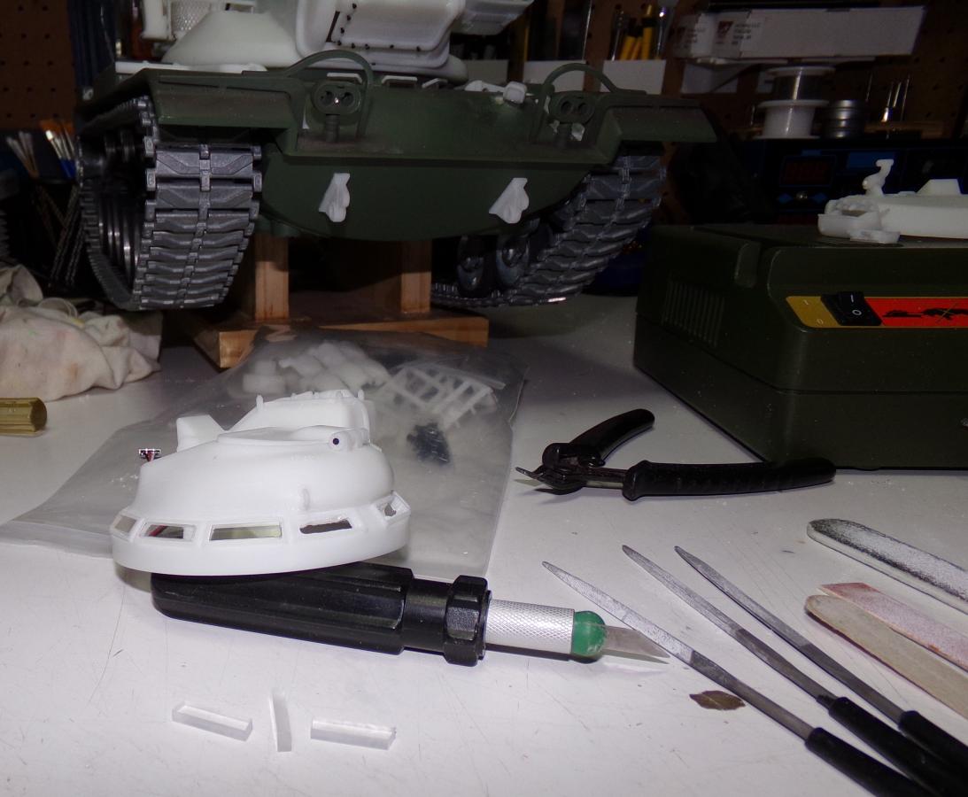

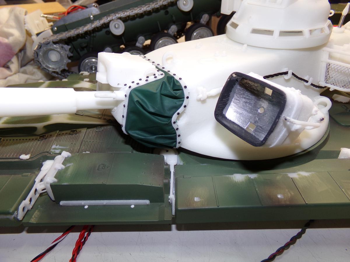

          It seems I'm a real glutton for punishment as I decided to cut out the resin vision blocks and replace them with something more realistic. Eleven of these suckers around the commander's cupola - seven down and four more to go.

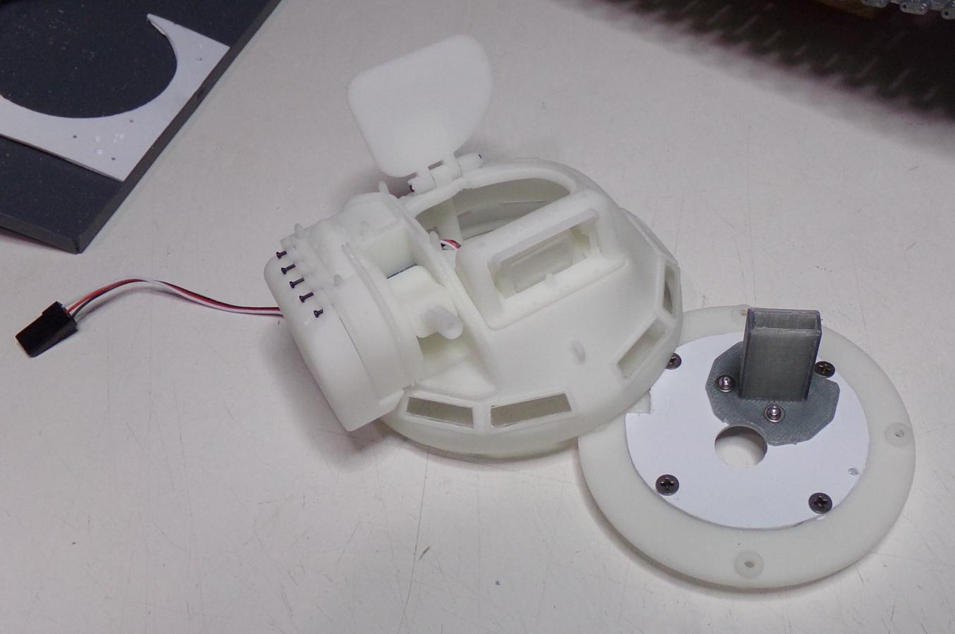

              Finished off the windows around the commander's cupola/periscope and added a 3D printed base that will work for either the Tamiya apple or the LegoDEI apple. Since some clubs only use one or the other it will work out well if I ever get to Danville to battle. I did have to cut out some of the hatch to allow for the Tamiya apple as the little screws on the side stick out a bit. The hatch can be closed completely hiding the battle system. The apple base will get the standard 5-pin wiring added. There are a few little tiny gaps around some of the windows, but those will be filled with clear canopy glue.

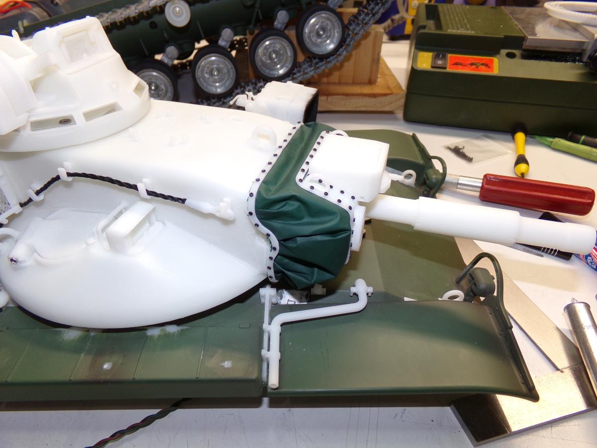

                Got some more fiddly work done. I added the fuel cap chains and pins. I also completed the dreaded mantlet cover. Man that was not really fun, but I think it turned out well. I did depress the gun and spun the turret all the way around and it didn't catch on anything, but I did lower the height of the tool box handles before building the mantlet cover.

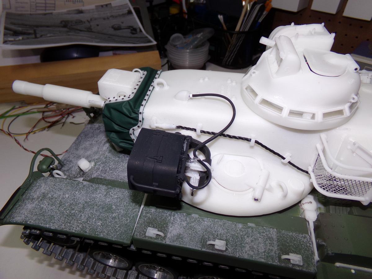

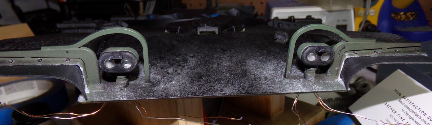

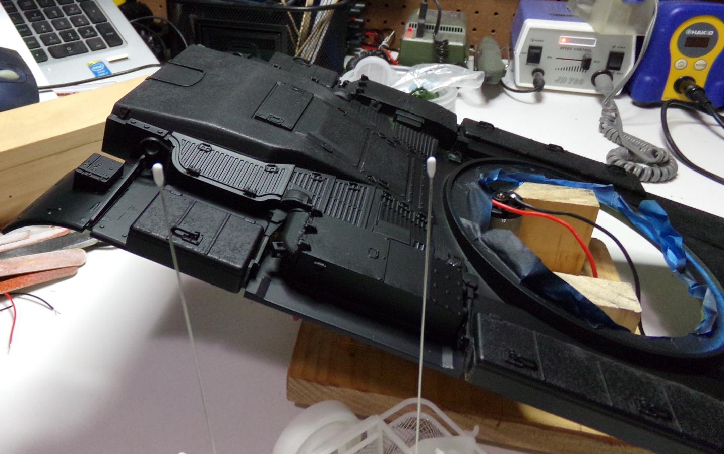

                      Getting closer to paint. I finished wiring up the LED in the spotlight, I added some anti-slip texture to the surfaces I could see from various references using Tamiya texture paint, and I replaced the plastic front mudguards with rubber ones. Still need to rewire the headlights, wire the tail lights, wire the IR LED, wire the IR battle system plug, finish the main wiring, and do a few little detail items before paint. I think I've settled on a gray desert MERDC camo...but that could still change.

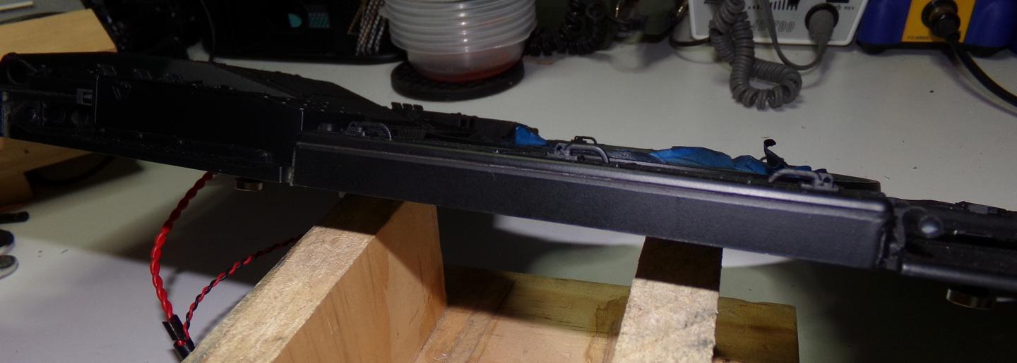

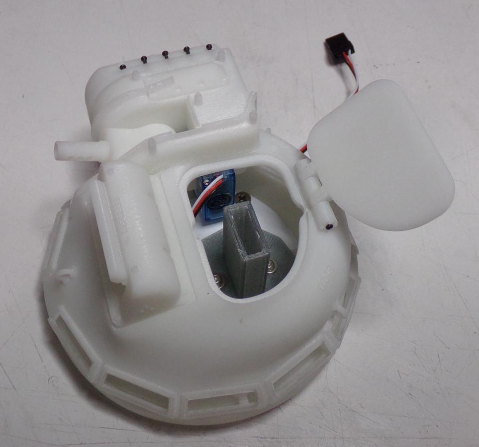

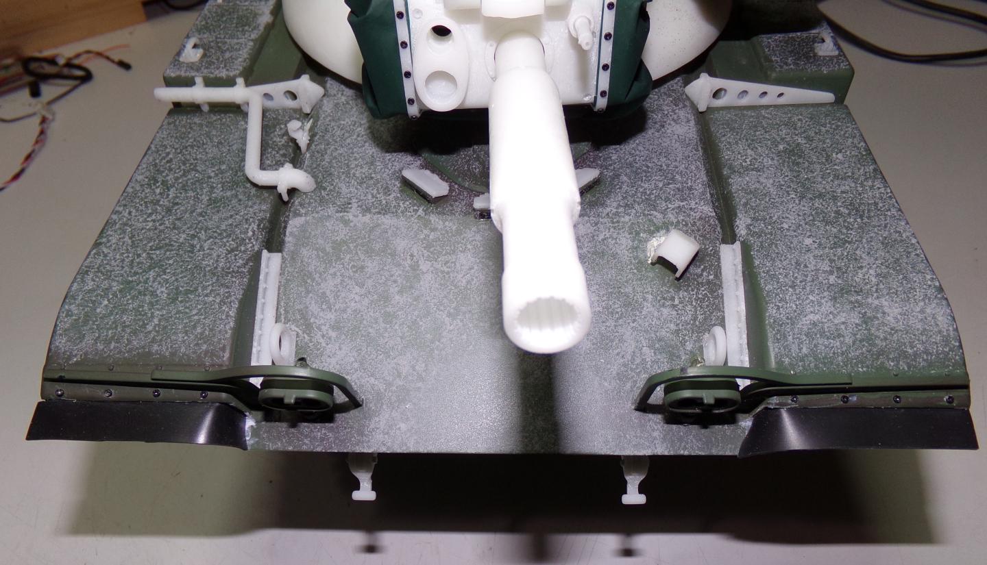

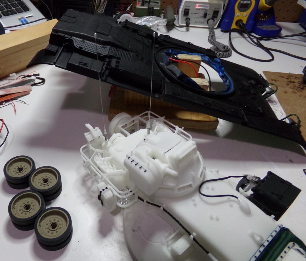

                          Got a few more little things flushed out. I think at this point all of the details I want to add besides stowage have been taken care of. I added some metal antennas and fashioned the little somewhat teardrop looking end protectors.
                          And a close up of the tips:

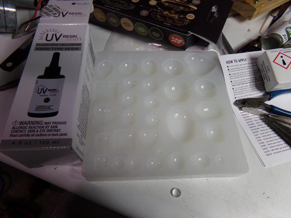

                          My significant other casts some resin stuff so I stole her little silicone mold and some UV resin hence the glitter I can't get to wash off. I fashioned some lenses for the front headlights and installed them.
ID:	381186Click image for larger version
                          Then I tackled fixing the detail on the brush guards. I may add a few bolt heads, but other than that I think I like the way they turned out.
ID:	381184Click image for larger version

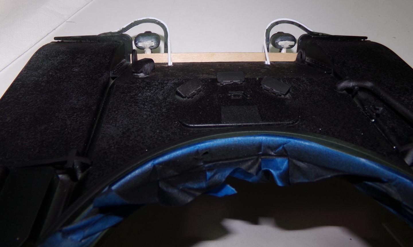

                          Right before priming I scored some lines in all four of the storage boxes to give the boxes the look of actually having lids and not just being one solid piece. I scored the initial line and then angled it away as it on the real thing.
                          I've been trying to get the camo started on the lower hull and the wheels, but as I stated in another thread my airbrush is giving me fits. I will be picking up an Iwata Eclipse tomorrow so I can finish paining it.
                          After that it will be just a matter of finishing up the wiring and installing some blue motors which I need to order.
                          Derek

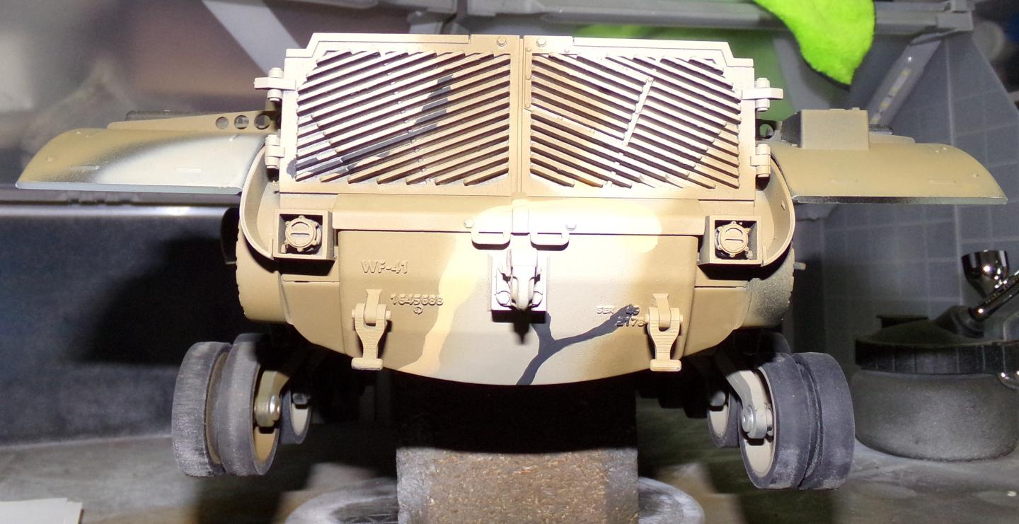

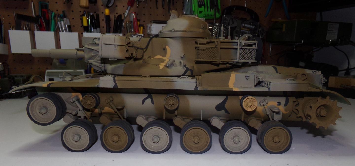

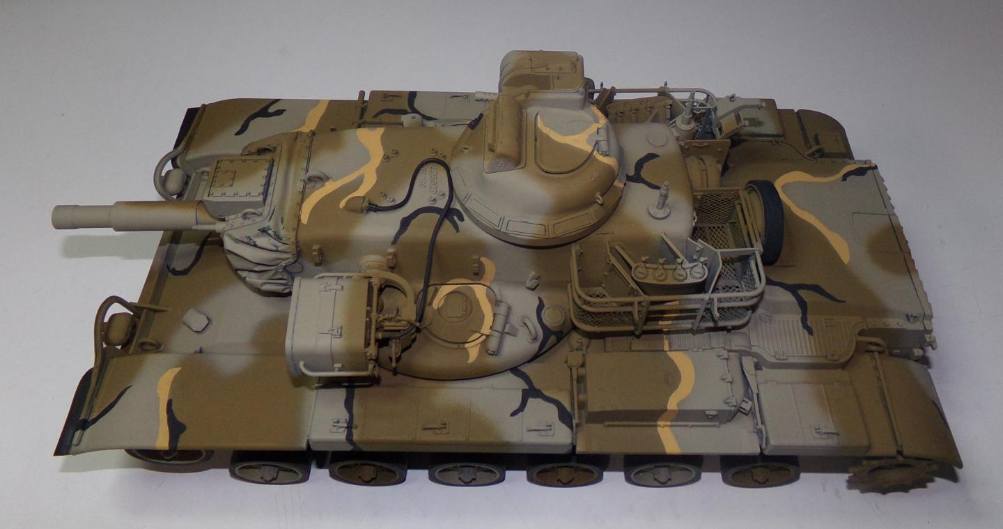

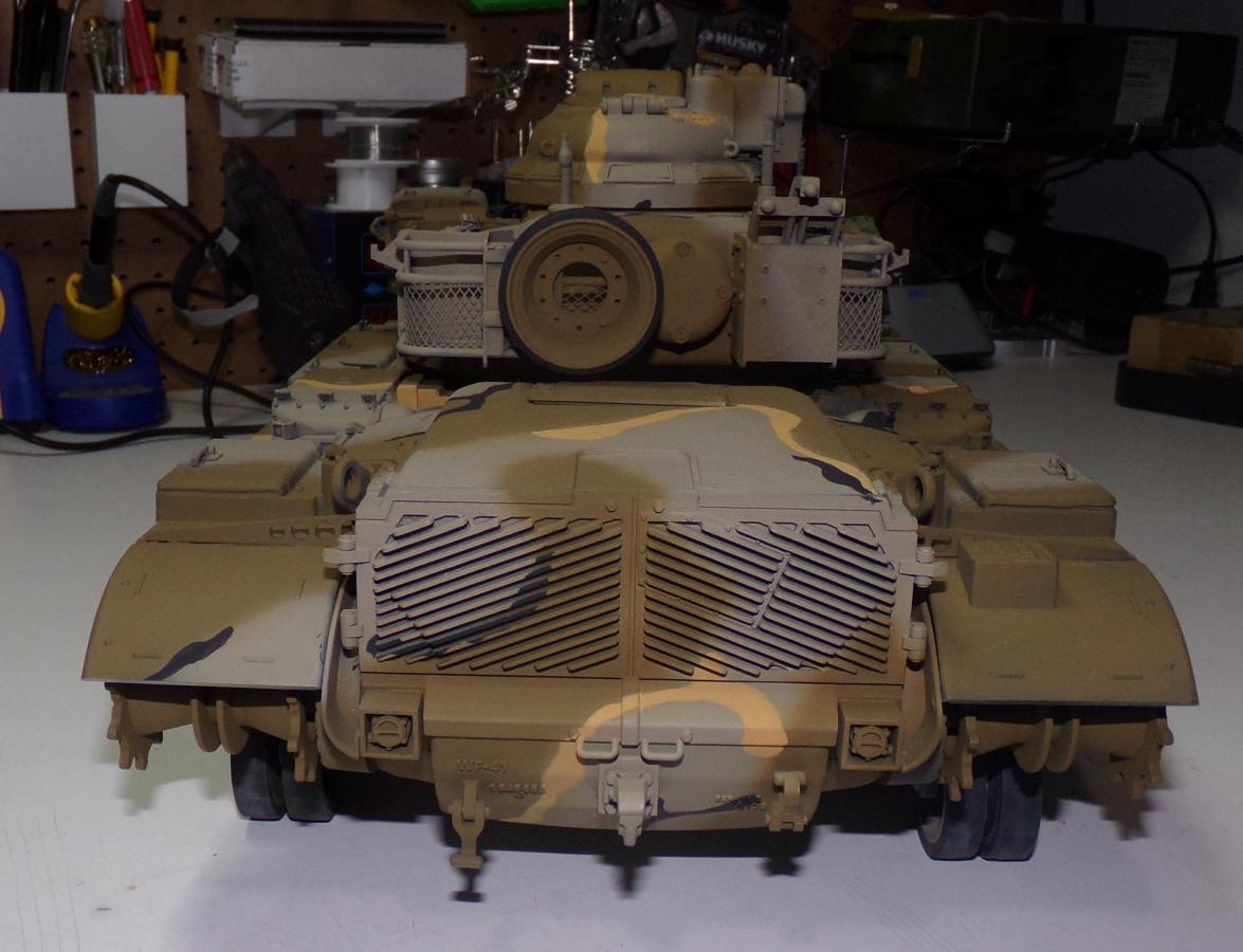

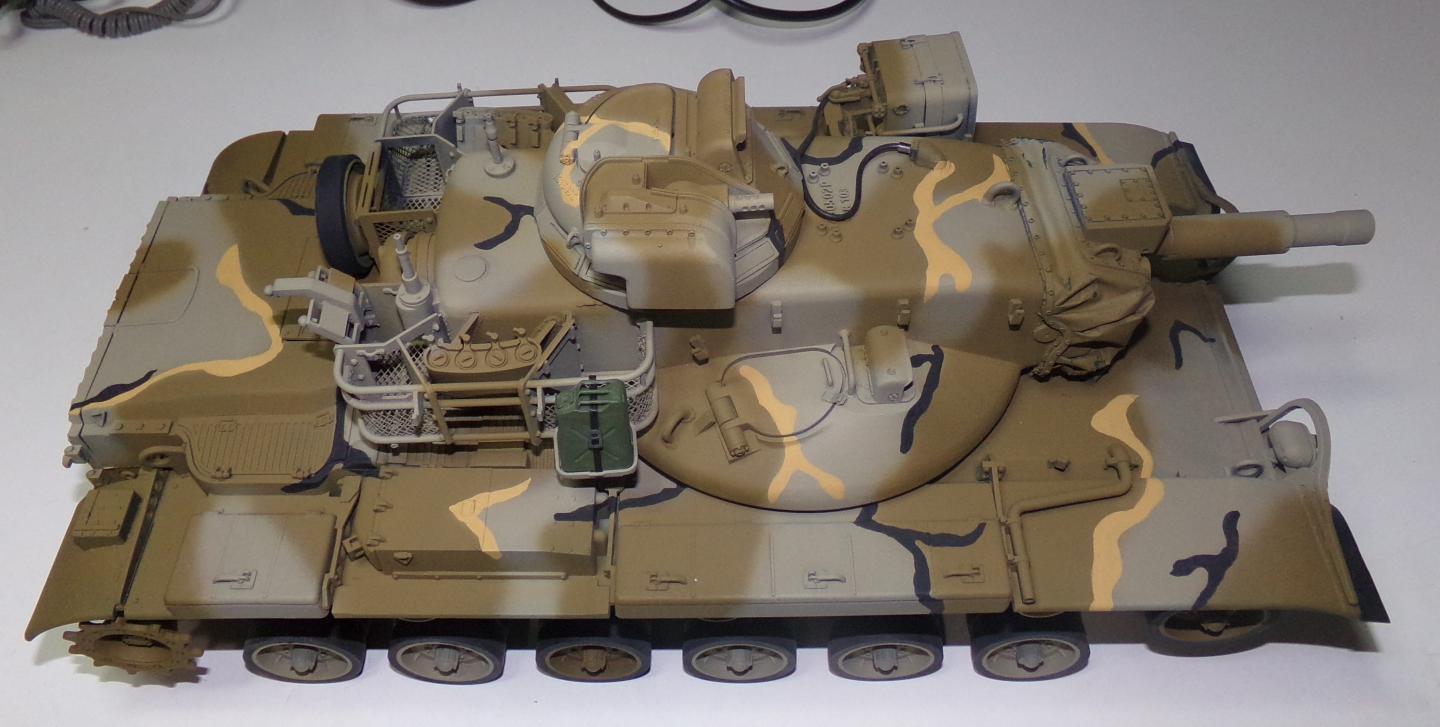

                                    Camo complete...need to add markings and seal. Main camo patter sprayed with airbrush and the "crows feet" were all hand painted. No masking used as I wanted the edges soft on this one.

                                    • MrChef
                                      • Jan 2023
                                      • 501
                                      • New York, Not the city
                                      #19
                                      I do like that camo scheme.
                                      When you handpainted did you thin the paint? And which brand paints did you use?
                                      Nice job. Keep it up!
                                      • RichJohnson
                                        • 1276
                                        #20
                                        Just use a flat or dull coat don’t dare get a sheen on that beautiful paint job.
                                        I have the US Army TM for painting vehicles and for Merdec they have a fade allowance for the color lines if not masked. It’s very tight, and your paint job looks very clean and tight. Your lines are nearly crisp. I just love it.
