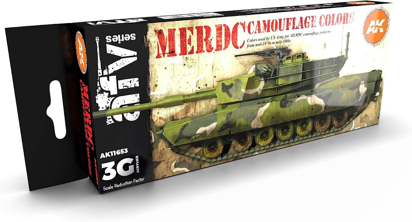

    Paint used was the 3rd gen AK MERDC set that has an entire paint set to do all the different MERDC schemes. I find AK paints to just be...OK. I actually much prefer Tamiya, but sometimes it's harder to find the Tamiya paints that match and frankly I hate mixing paint to get a match especially when I'm laying down a lot of it. Mixing a little to match a small paint repair is fine. I saved some paint by not spraying one down as a base coat. I just primed it and rough sprayed the sand color in approximately the locations it needed to be. I cleaned up the lines with the field drab. I may have 1/4 bottle left in the sand and field drab colors. The camo does take a long time and care to get looking right. The NATO 3-color is a little more forgiving and on the M60, the lower hull is just solid green so I think when I build the M60A3, it will get a NATO camo. ;) I do have most of the parts printed to do an M60 Slick and that will probably get the standard one color olive paint similar to the other M60 build seen here on Hobby Squawk (think it's Rich's).

      It took me a lot of trial and error to get ak to spray well. My solution was to use laquer thinner to reduce it with for spraying. Right from the bulk can from Home Depot, though I use AZ products not CA stuff.

        I had some Tamiya acrylic thinner I used with this gen3 stuff and it seemed to spray better than using my homebrew reducer. I may try switching over to lacquer paints to see if they wear better.
