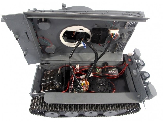

          @steve_196442​, Is this a good representation of your Mato Tiger 1?
          It is the newest all metal infrared version. Because of the torsion bar suspension, the battery is left inside the tank and charged with a wall power brick with some LED indicators.

            Affirmative on correct representation for my MATO Tiger 1. Here is a photo of the battery and charger. It seems like a pretty simple set up with few things to go wrong - little options for trouble shooting other than to buy a new battery and/or charger.
            • #7
