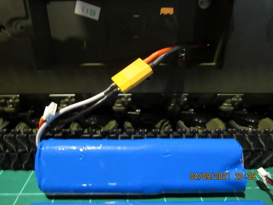

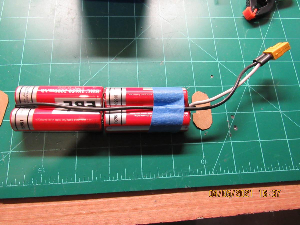

                        But these packs will not fit the HL battery compartment. For the HL tank, the cells need to be arranged as this:

                        When I built these in early 2021, I paid $10 for 4 of the EBL cells and got a 6000 mAh pack. Now, similar single cell is more than $10 EACH. The parallel charge plug is for use with a B6 parallel charger.
                            I don't care that they don't fit in the stock battery box as I normally cut the battery box out and pour resin in the bottom of my chassis to stiffen it up after removing the battery box. I then use velcro on the battery and on the bottom of the tank to hold them in place.
                                Confused! Do you mean you Velcro the battery under the bottom of the tank? I cannot see enough ground clearance there. If the battery is inside the tank, how do you recharge it?
                                      Nope. Velcro'd to the bottom of the tank on the inside where ever I want since the battery box is gone. The tank top is connected using magnets. This is an example (my HL ZTZ-99) of a battery box removed resin poured bottom hull with magnets installed on the posts that hold the tank together and the battery mounted in the front to offset the weight in the back. The second pic shows where all the magnets were installed. I always remove batteries to recharge my tanks.
