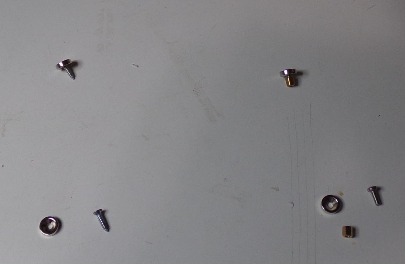

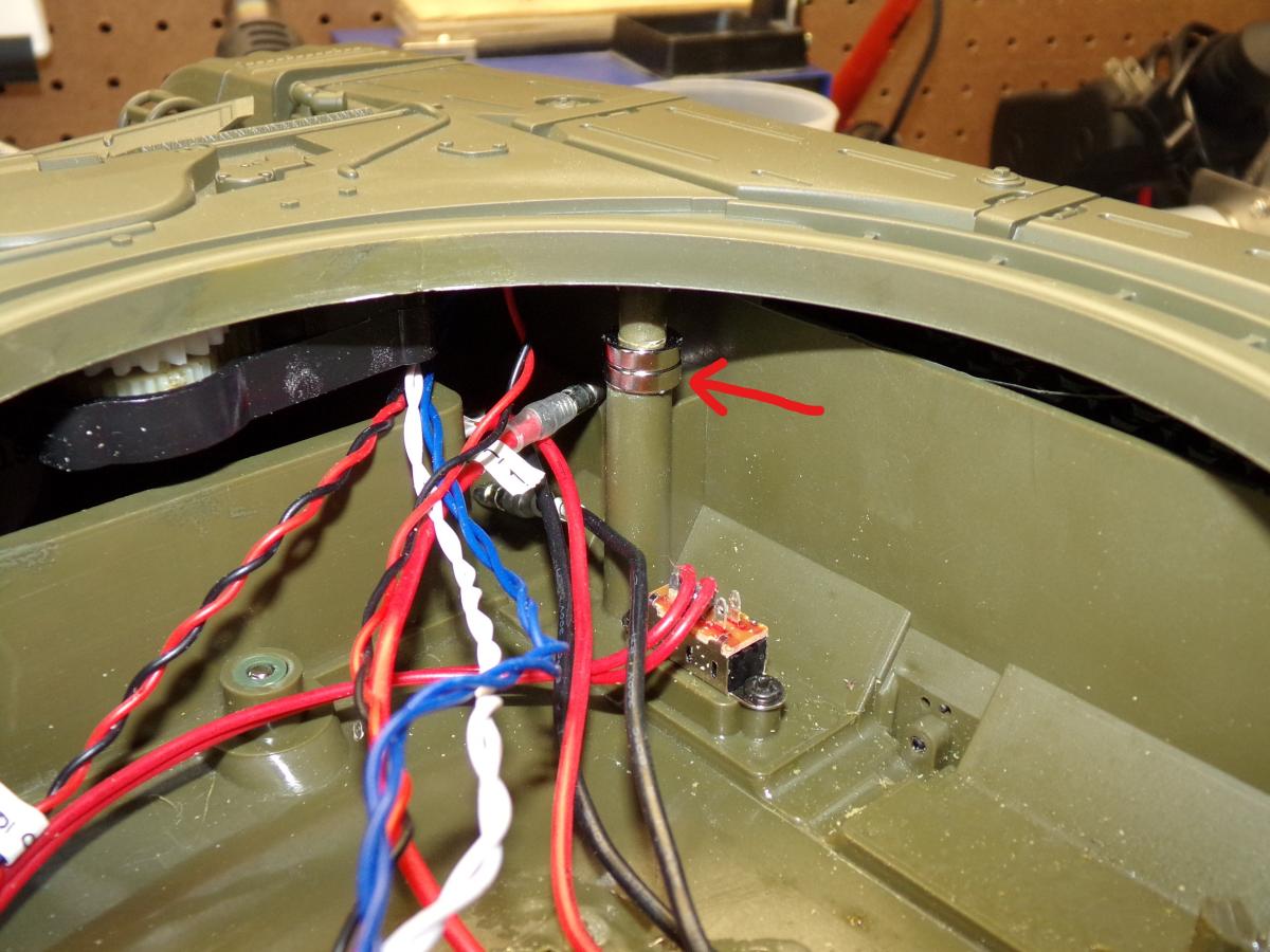

    I used N52 rated magnets which are very strong. In the pic below it shows the actual hardware used for my builds. The magnets are that far apart or else they will fly toward each other. Each magnet is 10mm in diameter by 3mm high with an M3 sized hole. Pan head screws (countersunk M3s would work better) are M3 type mated to an M3 brass 5mm standoff since it is smaller than an M3 nut and fits in the plastic screw channels where a regular M3 nut would not. The other countersunk wood screw is a #4x1/2" size. The top screw bosses have to be cut down to allow for the magnets. The bottoms don't, but I do remove the lip from the edge using a nippers.
    With all those 10mm N52 neodymium magnets holding the hull on, it only separates when I want it to. I do the same treatment to the turret. You can see from the turret bottom pic how the brass standoff is used as a nut. Since they are countersunk magnets you need to buy a north and a south type for them to stick together:

      Thank you for sharing. Very, very helpful information. I assume that the counter sink part will face each other so I need half in N pole and half in S pole. 25 pieces of each kind are $30 total with free shipping. Can you confirm that. (The polarity part.)

        Yes to half N half S. I got mine from Amazon and they work perfectly. BUT... they were supposed to be half N and half S and they gave me more of one than the other...

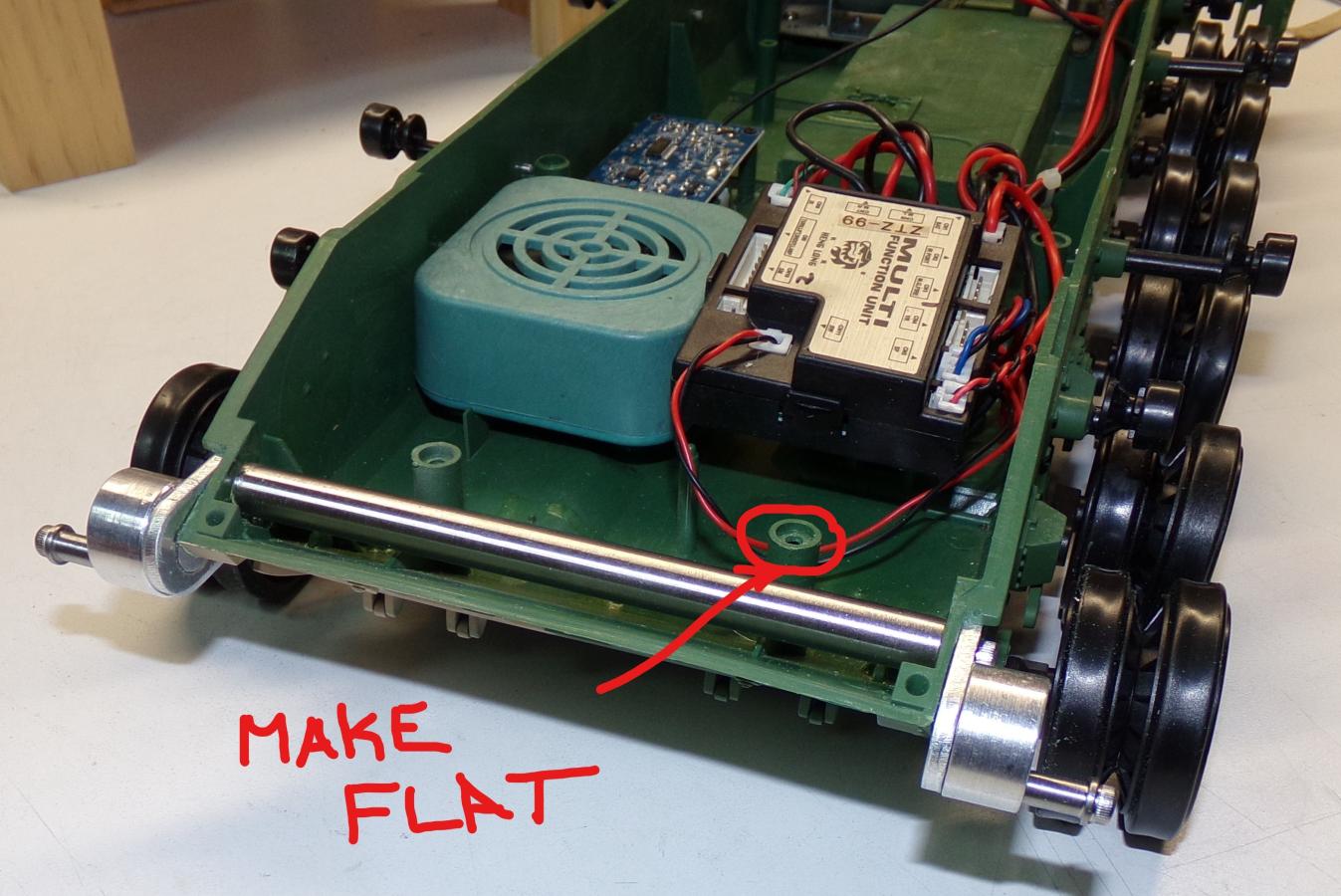

                  As others have said, yes the countersunk heads of the screws then mate up with each other. I bought mine from JC in bulk (like 50 of each pole north and south) because they get cheaper the more you buy and I knew I would use them on a bunch of tanks. That purchase has magnetized the Bulldog (body and turret), Pershing (body and turret), IS-2 (turret only), T34/85 turret, Hooben ZTZ-99A (body and turret), HL ZTZ-99 (body and turret), and the T-72 turret so far. I still have some left. Can you get away with using less magnets than I do? I'm sure you could, but I like to make sure I have solid connections. Most of my tanks are pretty heavy and I can lift the tank by the magnetized upper hull without them separating. The closer and flatter the magnets fit together, the stronger they hold. I like connecting them with screws rather than CA glue or epoxy so that I can remove them if one breaks and they don't come off during use. I have some other magnets that are epoxied or used CA and it seems there are a few of them I'm always having to reattach. I only shorten the upper screw boss and the great thing is that if you accidentally cut off too much, you can install a washer under the magnet to fix it.
                  You can see from the pic mine are completely flush fitting with each other once installed. In the second pic it shows the lip on the bottom that gets removed (says "make flat").

                    It sounds like that you do not remove any material of the top post. The magnets total 6 mm can flush fit with each other when the bottom post is made flat?

                      I only removed the "rim" from the bottom post. The top post was shortened to make room for both magnets.

                        I have been looking at my Pershing for 3 days and still couldn't figure out a good way to attach the magnet to the lower post except using CA glue. The hole on the magnet is for M3 screw which is too small for the pre-drilled hole on the bottom post. The long bottom post also exclude the use of machine screw and nut. Your tip on this?

                          I had a small cylindrical piece of plastic I shoved up the post from the bottom that the screw from the top bit into. They were made from model airplane push rods.

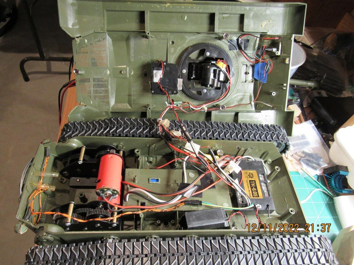

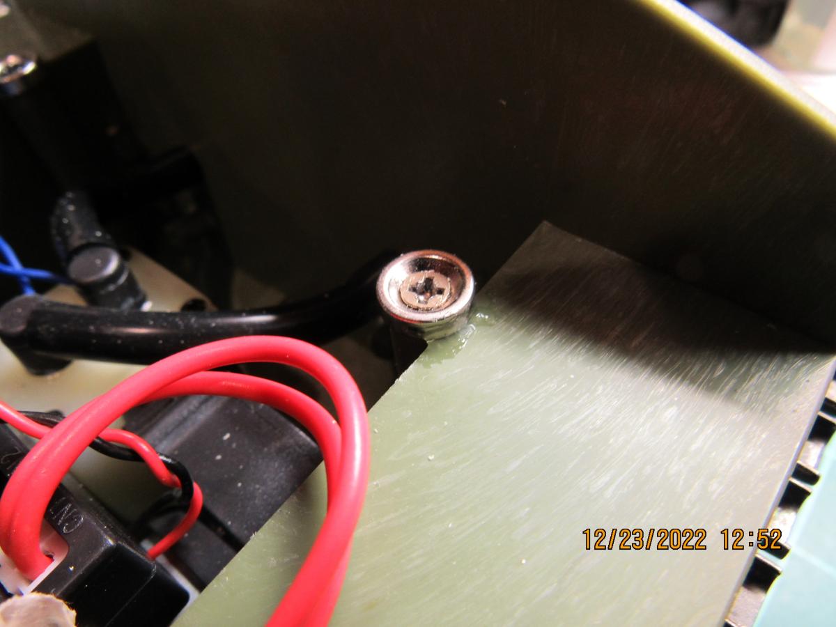

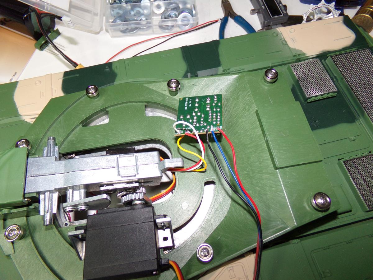

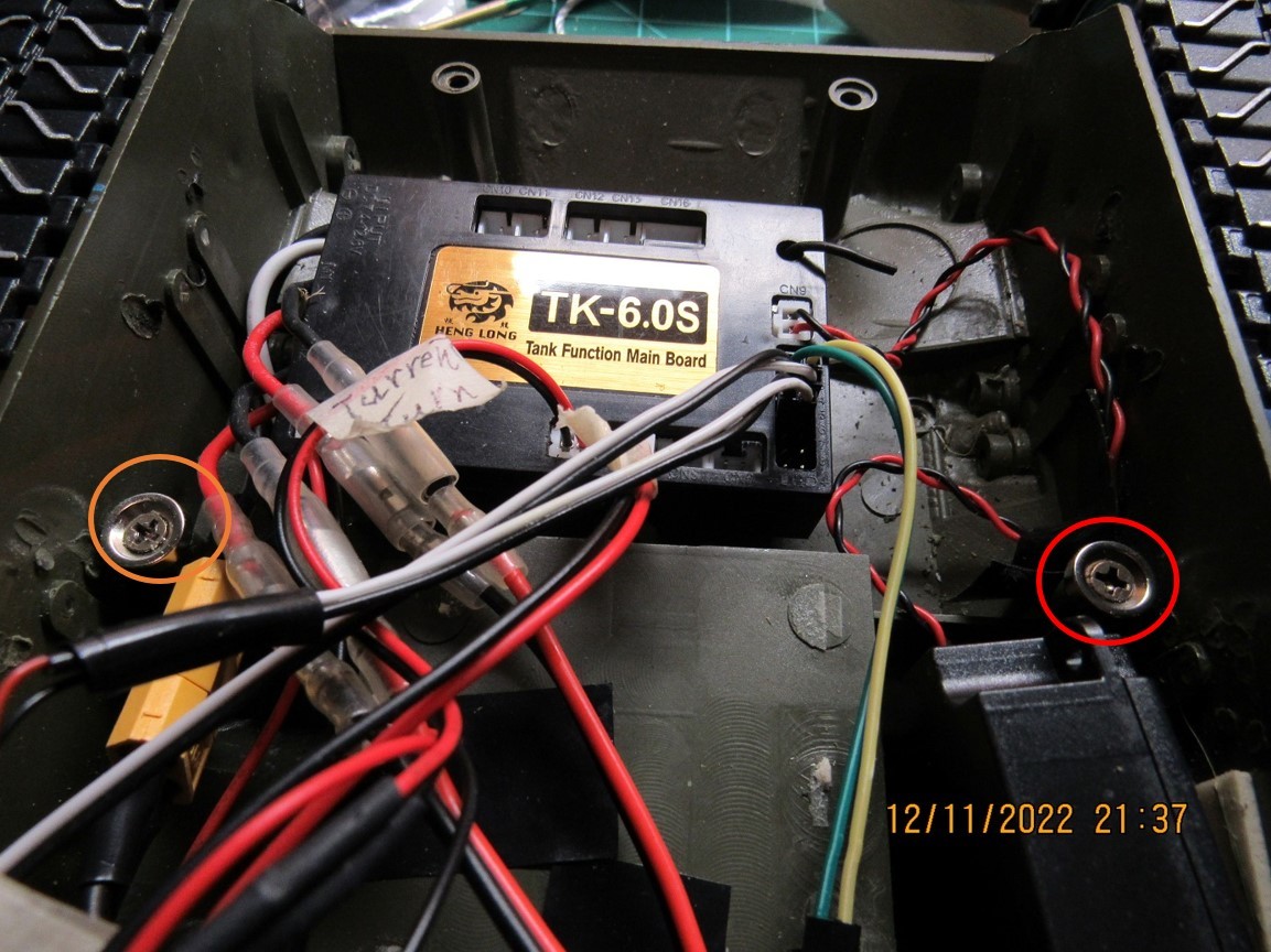

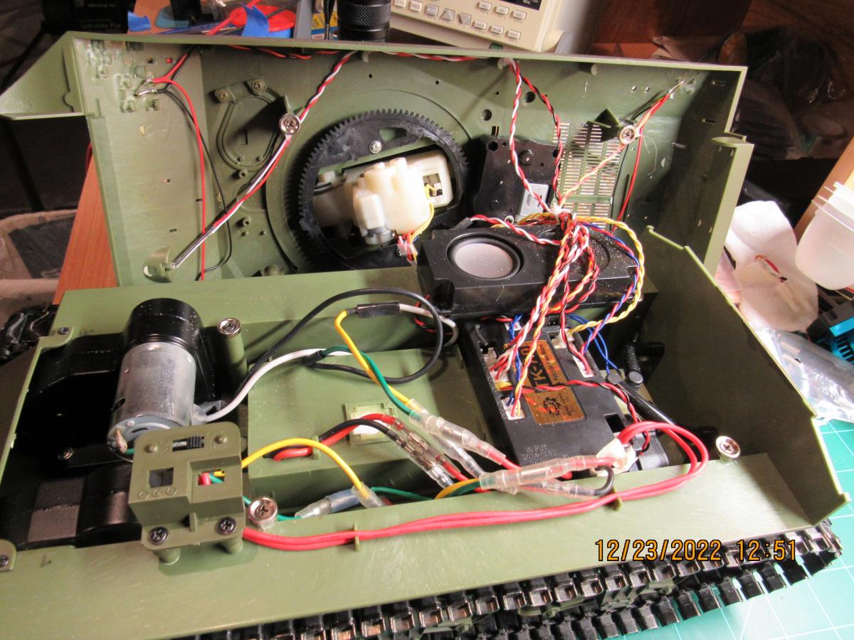

                              My first magnetization project for the HL tank is a complete failure. I picked the Pershing as my first experiment because it had 7 attachment points. I choose the rear center and 2 middle forward for initial installation. Mechanically, it worked perfectly. The tank closed tight with perfect alignment. When I turned it on, I first noticed the engine sound to be strange. It fired up (RC link) ok. Then, the head light started flashing. When I ran the tank, it moved slowly and the turns were intermittent. Something is NOT right. And I have a suspect.
                              Click image for larger version  Name:	magnet1.jpg Views:	0 Size:	233.4 KB ID:	363585
                              The right magnet is very close to the speaker. Both magnets are too close to the 6.0S MFU.
                              I removed both of these magnets (upper and lower), but left the rear center one in place. I close the tank and it runs normally. I am greatly relieved. No permanent magnetization of the MFU!
                              Some of you may remember that this 2005 HL Pershing has undergone a series of upgrades. I removed the original speaker to make room for the MFU at the tank front. A new smaller speaker was put to the middle side.
                              Click image for larger version  Name:	IMG_5130.jpg Views:	0 Size:	192.5 KB ID:	363586
                              Now, feeling confident about installing the magnets, I plan to do it on the Leopard 2A6, T34 and Sherman where I do not expect the same problem as the Pershing.

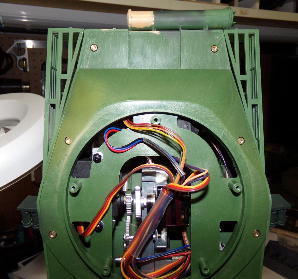

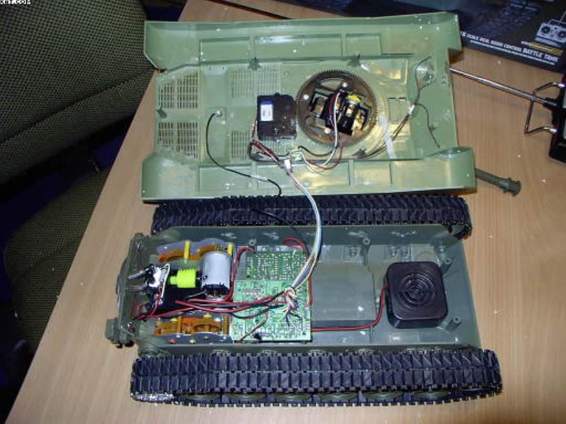

                                      The second magnetization project for the HL Sherman tank (3898-1) is a reasonable success. It is a late HL production with XT-60 connector. It has only 4 connecting poles, but has the best upper and lower chassis fit among 5 Heng Long tanks that I have.
                                      Click image for larger version  Name:	IMG_5132.jpg Views:	0 Size:	161.1 KB ID:	364830Click image for larger version  Name:	IMG_5133.jpg Views:	0 Size:	81.4 KB ID:	364829
                                      The Sherman chassis is relatively small so the lower posts are part of the lower chassis wheel well wall. I cannot remove the fence ring on the lower post. I have to remove 7.5 mm from the upper post, compared to 5.5 mm on other tank. I added a dope of CA glue to the lower magnet base for insurance. I am very happy with the overall result. Thank you, tank_me and evan D.
                                      Originally, I wanted to use the cut-off piece of the upper post for the lower post push rod. It does not work. The lower post well is tapper down to 3/16" which is smaller than the upper post. Drilling the pilot hole for the screw on the push rod is difficult. I drilled out a 3/16" hole on a 2x4 as the push rod holder. Any easy trick?

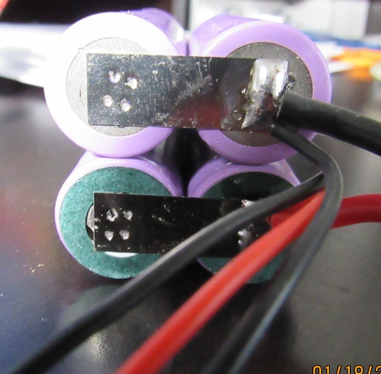

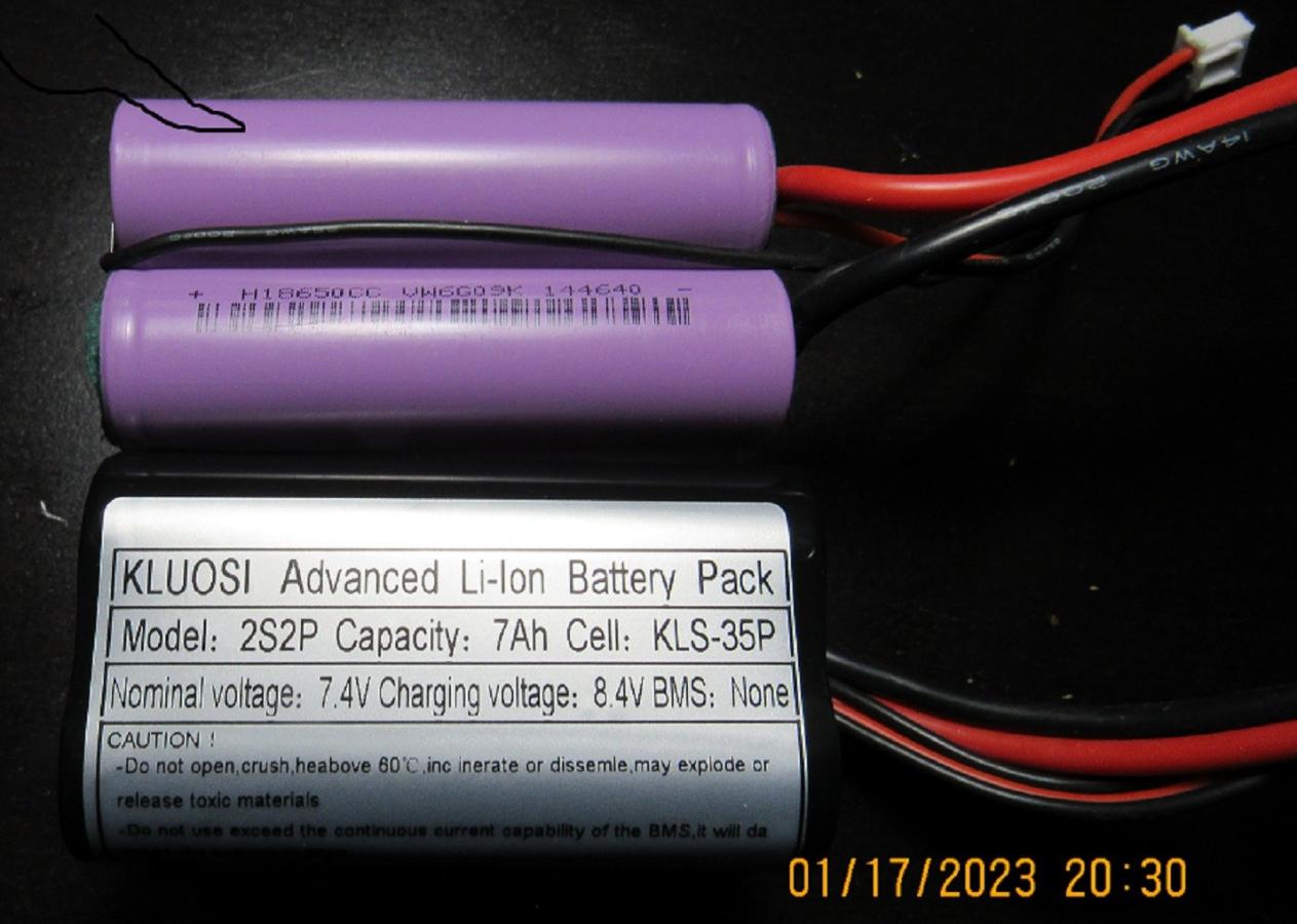

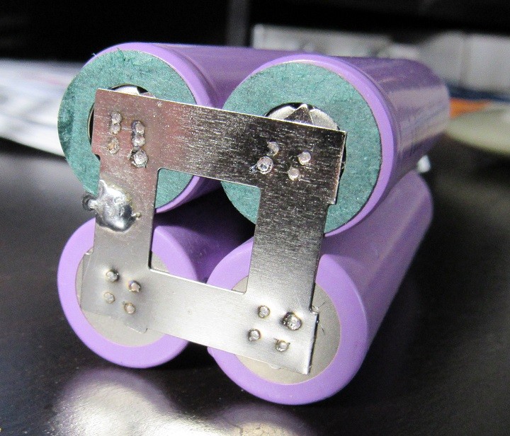

                                        I ordered 3 of this KLUOSI 2S2P Lithium Ion battery pack just before Christmas. I received the package yesterday in a thick foam box wrapped in plastic bag. The package is good and shipping took less than 4 weeks. I paid US $46.43 including free shipping. The drawback is that it doesn't fit the Heng Long battery compartment as is.
                                        The packs arrived fully charged as indicated by the 8.14 volts after unpacking. I discharged it to 6.2 volts and let them sit at room temperature overnight. The discharge took more than 6 hours at 0.7A. A good sign that the capacity is good. I cannot verify that the individual cells were NCR18650GA. You can see the marking on the cell purple cover on the picture above. I weighted each cell at 46 grams which is another very good sign. (Cheap, low capacity Li-Ion cell usually weights less than 41 grams.) I guess that these are higher quality home grown Li-Ion cells of 2200 mAh from China. My better imported Li-Ion usually weight 47-51 grams.
                                        This morning, I started charging the fully depleted Li-Ion pack. It charged to 3640 mAh at 8.2 volts and 3984 mAh at 8.4 volts. It is an honest 4 Ah pack, but not 7 Ah as claimed. At its price, it is an excellent buy.
                                        Next, I will try to rearrange it to the HL pack configuration. If successful, each of this pack can last a full battle day.
ID:	367465Click image for larger version
                                        I need to separate the upper 2 cells from the lower 2 cells and add an extension wire to the negative pole. I need to be careful not to damage the sleeves of the individual cell batteries. Folding them to make a long pack and rewrap should be easy. Please, stay tune.
