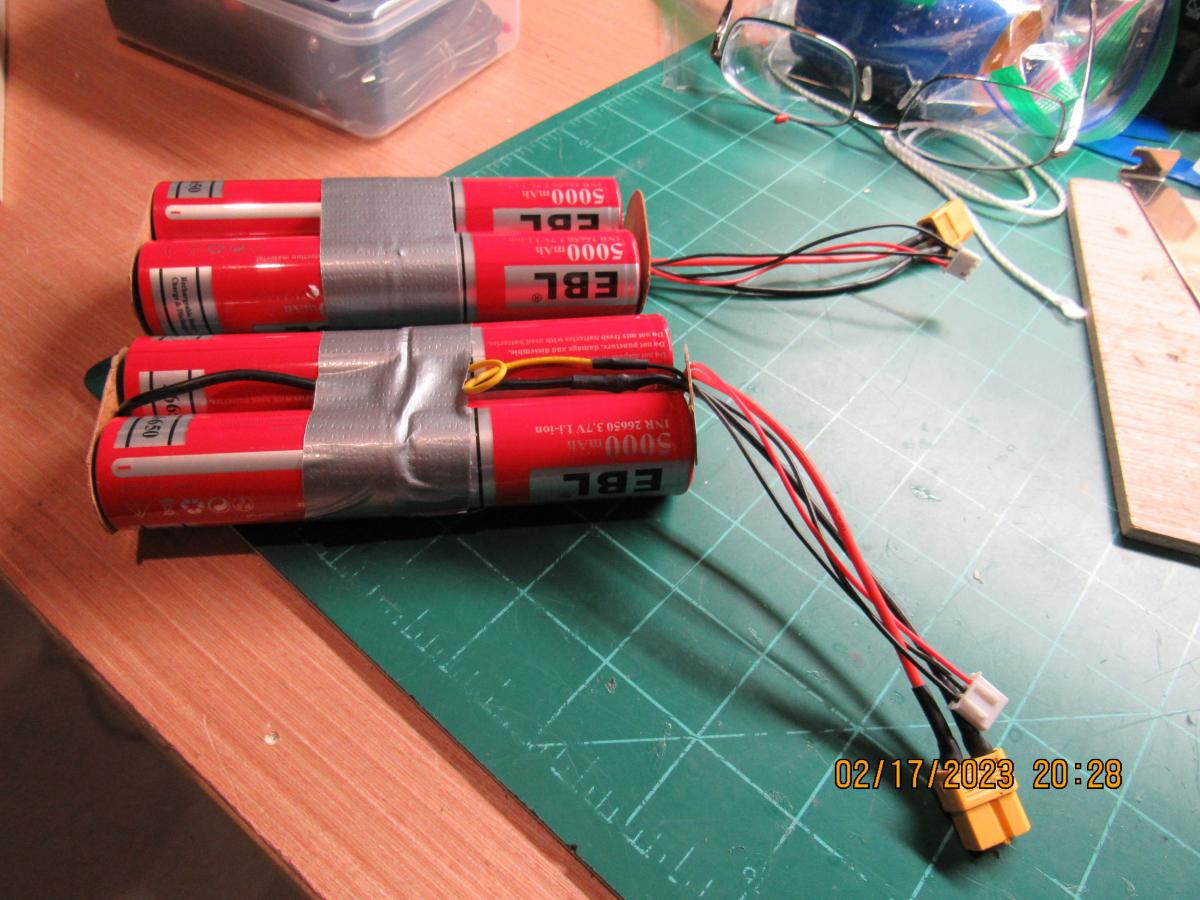

                        What I liked about the EBL 3.7V 26650 Battery 5000mAh Li-Ion batteries I acquired is that they are internally protected. Assembly of the battery packs was simple and quite easy to do. Thanks to the battery circuit diagram that 'keilau' had posted in a different thread. The hardest part of assembly I had was getting the PVC shrink wrap to cover the battery packs. That took some practice and patience to get it right.

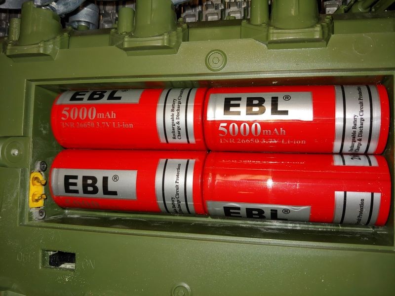

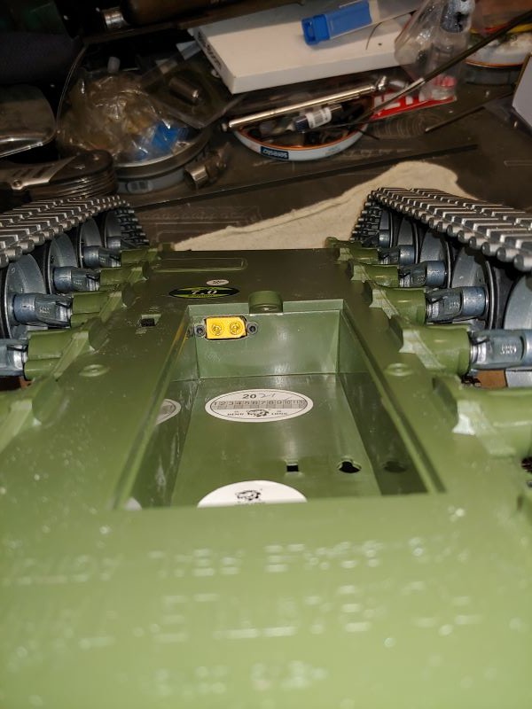

                            It was of coarse a snug fit for the new 2S EBL26650 long battery pack in the compartment of my Leopard 2A6. So much, I had to modify the compartment to relocate the male battery connector. You can see what I did in the following photos. You can see how much room was taken up even before I put the wrap on the battery pack.

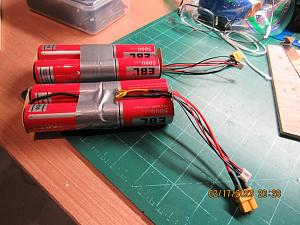

                              The 2S pack built with EBL26650 is the best money value for RC tank today. The material cost is less than $20. It works very well for driving HL tanks in difficult terrain including glass lawn. But I always have this lingering concern whether the low drain spec battery is a handicap for hard maneuver battle condition.

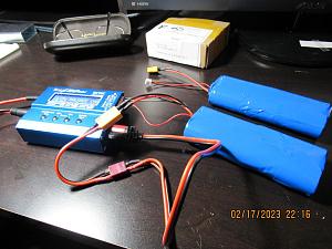

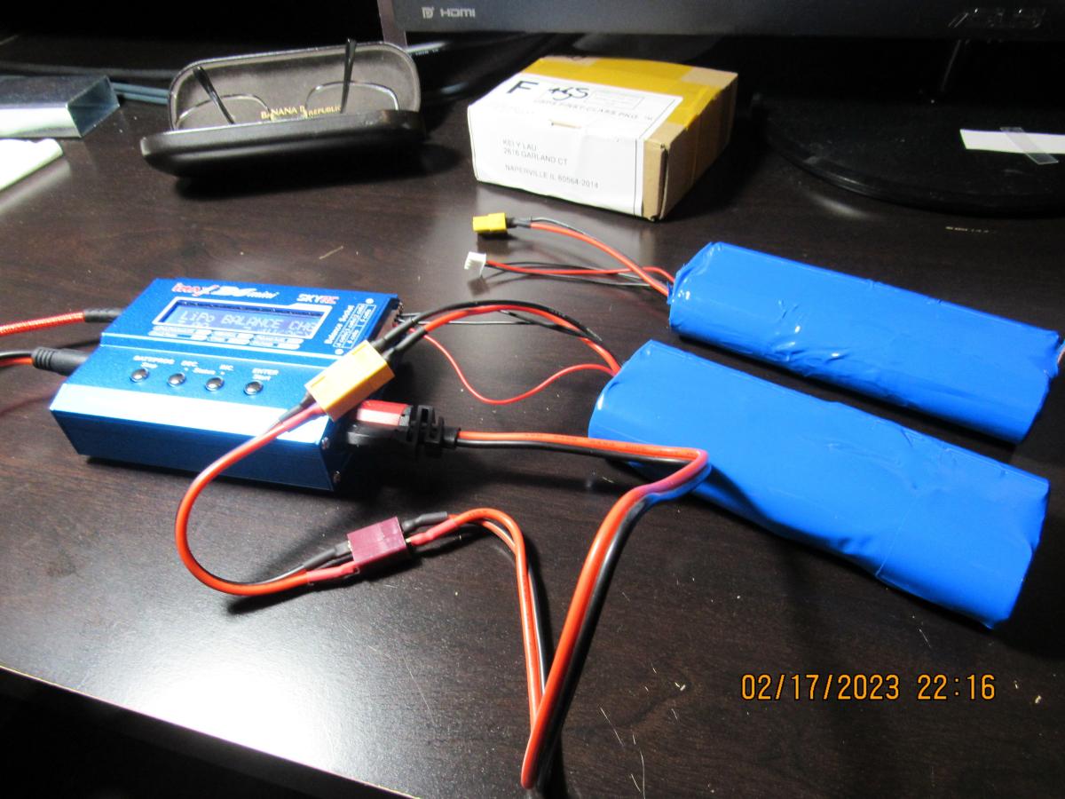

                              3 months ago, I was tricked into building 2x2S2P EBL26650 packs for a forum member. He lied to me to get me build them for his son's robotic project. The son promptly drained the packs completely with his robot. He ended up with 2 dead battery door stops. I was extremely unhappy for being lied to and wasting my time.
ID:	378056Click image for larger version
