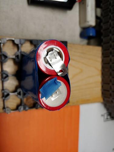

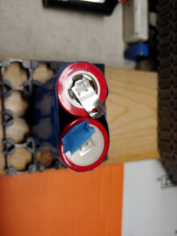

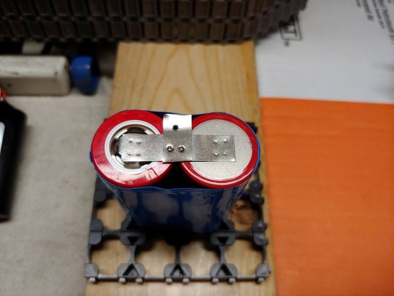

            I need to separate the upper 2 cells from the lower 2 cells and add an extension wire to the negative pole. I need to be careful not to damage the sleeves of the individual cell batteries. Folding them to make a long pack and rewrap should be easy. Please, stay tune.
            I will discourage others trying what I did.
            I successfully separated the cells in 2 of the packs. The glue used are strong enough to tear the individual cell plastic sleeve open and exposed the bare metal cell surfaces. On the third pack, I allowed the bare metal skin of 2 adjacent cell to touch and create a shortcircuit. It burnt holes on 2 of the metal skin. I blew out the fire immediately. No smell or burn mark left on the bench. I cannot emphasize enough how dangerous this is when the protective plastic sleeve of a lithium battery cell is torn open.
            My idea of rearranging this battery pack doesn't work.

              yeah the bottom of an 18650 cell and the sides are all the negative terminal of the cell and its only the little button at the top that is the positive. so if you rip that plastic sleeve you pretty much just make a second negative terminal.
              use to use them to make battery packs for electric longboards.
              i would also suggest those that dont know what their doing to not mess with these batteries. if what you got doesn't work dont modify them to work.

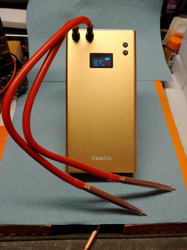

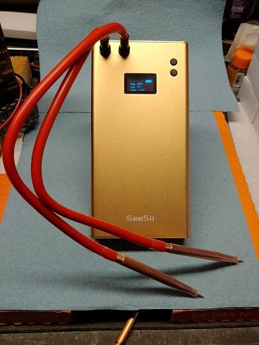

                      Here is what I purchased. BatteryStore.com I bought the 15C 18650 pink cover batteries. $5.99 each All were fresh and held a 7h discharge. I also bought the spot welder and it helps to have a helper to fire the spot weld while you hold it. The level I set was almost 13 to spot weld the 1.5mm nickle I bought.

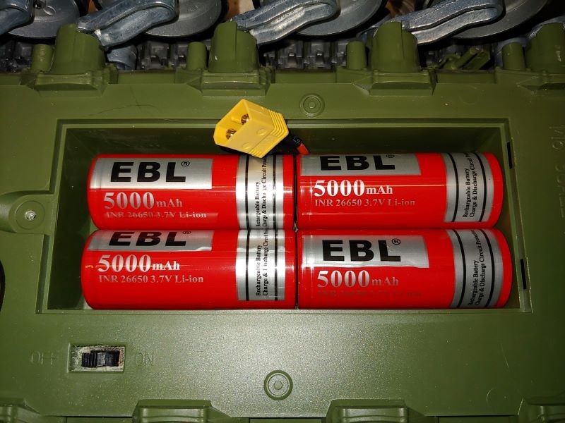

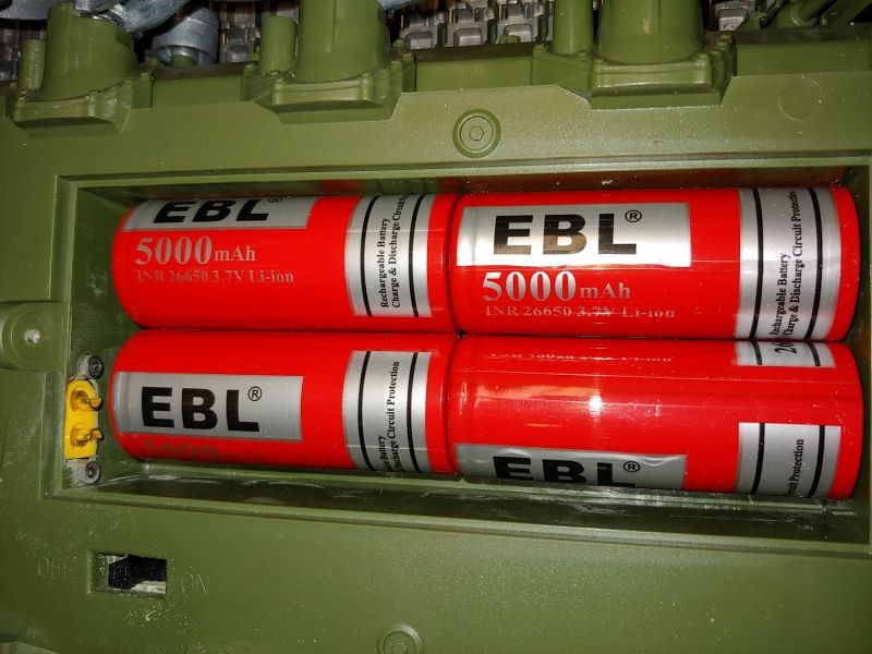

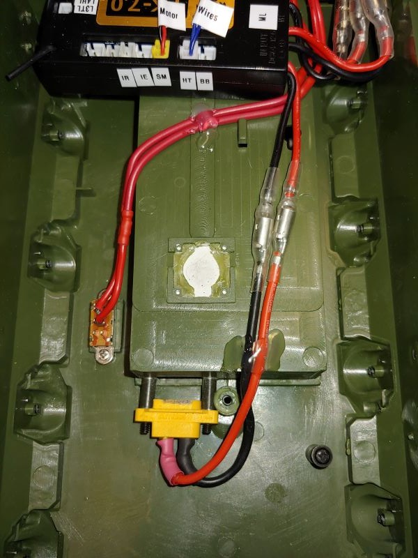

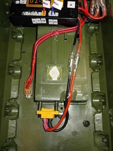

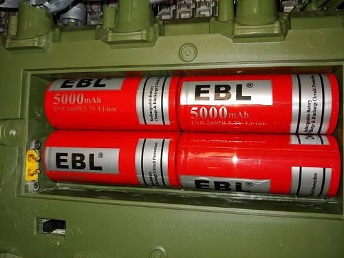

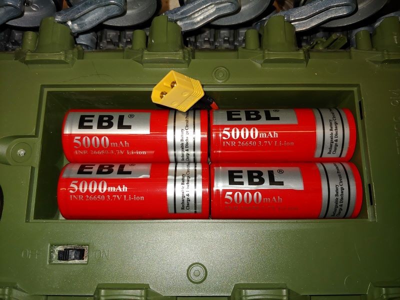

                        With those larger EBL 5Ah batteries in the Leopard 2A6 battery bay it took a bit of imagination to come about on how to manage the battery plugs since room was quite compromised. Decided to make a through hole in the battery bay for the female battery plug to mate into the male power plug inside the tank body. Still accessible to plug into and remove the battery pack without having to open the tank up. I did purchase a Seesii 11000mAh Battery Spot Welder with LCD Screen on Ebay for $60 shipped and it worked very well on setting No.6 for welding the nickel strips to the EBL battery pack for my T90. Waiting on wiring to complete the assembly of the battery packs.
                        Click image for larger version  Name:	0121231003.jpg Views:	0 Size:	106.3 KB ID:	367889Click image for larger version  Name:	0121231019.jpg Views:	0 Size:	75.5 KB ID:	367890Click image for larger version  Name:	0121231042.jpg Views:	0 Size:	109.6 KB ID:	367891Click image for larger version  Name:	0122230857.jpg Views:	0 Size:	61.6 KB ID:	367892Click image for larger version  Name:	0122230857a.jpg Views:	0 Size:	55.9 KB ID:	367893Click image for larger version  Name:	0122230902a_HDR.jpg Views:	0 Size:	96.5 KB ID:	367894

                          Your spot welder is more then double the power of mine. But twice the price too.

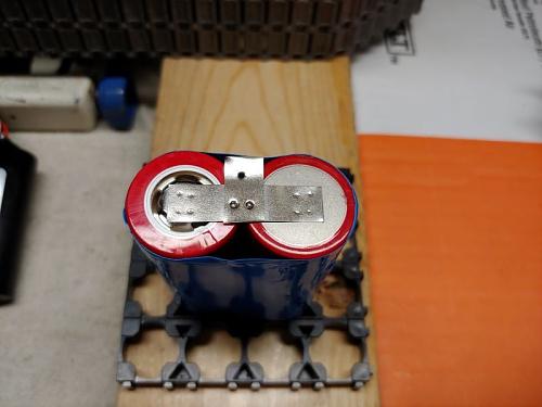

                                  • #57
                                    Got my long and short battery packs ready for when my wires for completing them get delivered.

                                      Very professional look. My silver soldered packs are not as neat. I have a spot welder on the way. It should make my building process easier.
