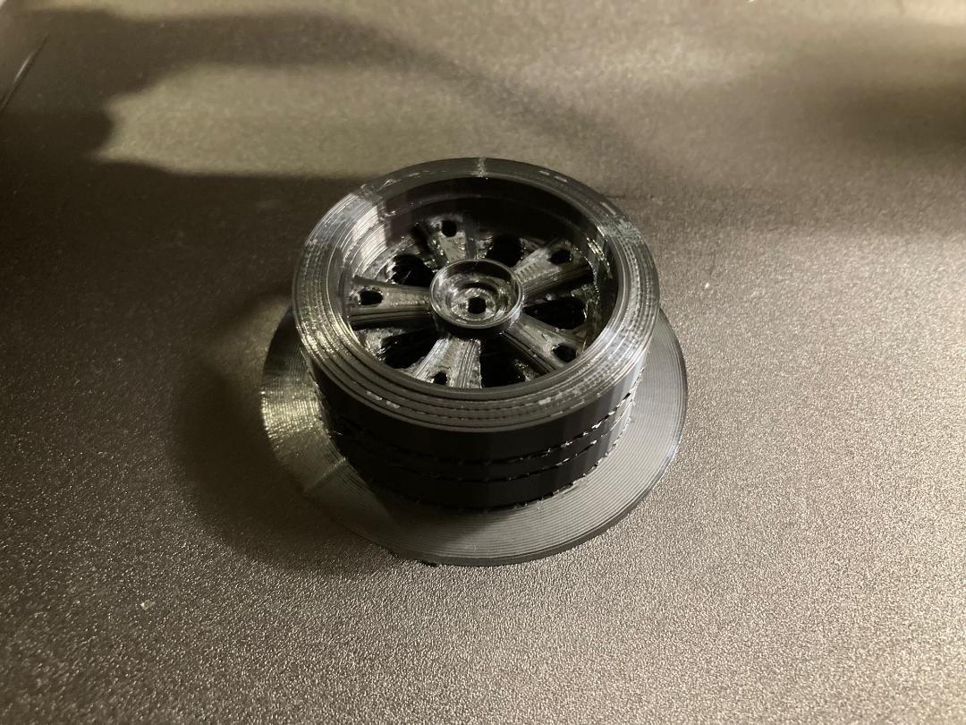

    I decided to try out printing a wheel, which is still in progress as I type this. It takes a whopping three hours for one wheel! Is this normal?

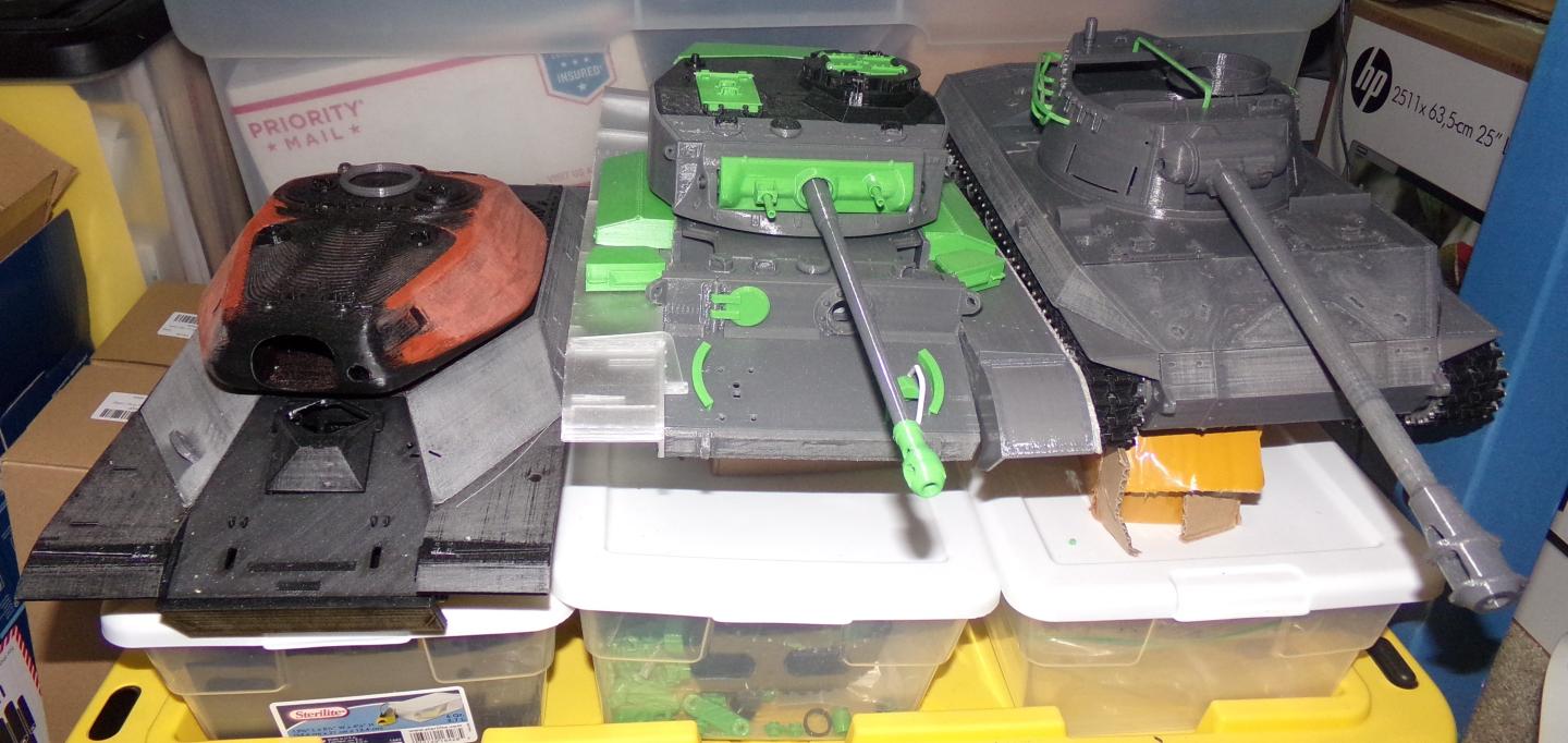

        I've built quite a few of Inkor's tanks. Inkor is the designer at RC 3D Tanks. On a slow printer, yeah things can take a long time. FDM printers take longer the more items you put on the bed. Resin printers print just as fast with one thing on the bed, or the whole bed covered. Luckily I have a fast Bambu printer or I would've given up on printing tanks a long time ago. I also have a resin printer, but I haven't even taken it out of the box yet. I have also downloaded the T-54, but it will be a long time before I start it. When starting out FDM printing you need to look at a lot of factors that will affect print time. Infill is one of the big ones. I think most of the parts from Inkor's tanks can handle as little as 30%. Some parts will require a higher one, but if you were like me in the beginning FDM printing I though 100% infill was needed on a lot of things and it really wasn't. For larger parts you can actually increase the line width some which will save time. On a 0.4mm nozzle I usually print a 0.5mm line width.
        I've printed the majority of the Hellcat and actually have it running, but it seems I don't have any good pics of it at the moment.

          I have started a second wheel now. This time using Prusa Slicer rather than the Creality program which is somewhat limited in features. Using the "organic" supports which are pretty cool looking. Makes the print look like some sort of alien tree LOL.
          It will likely be better to print the wheels and tires separate though. My first attempt look OK but the supports between the tires is fused to the tires and difficult to remove.

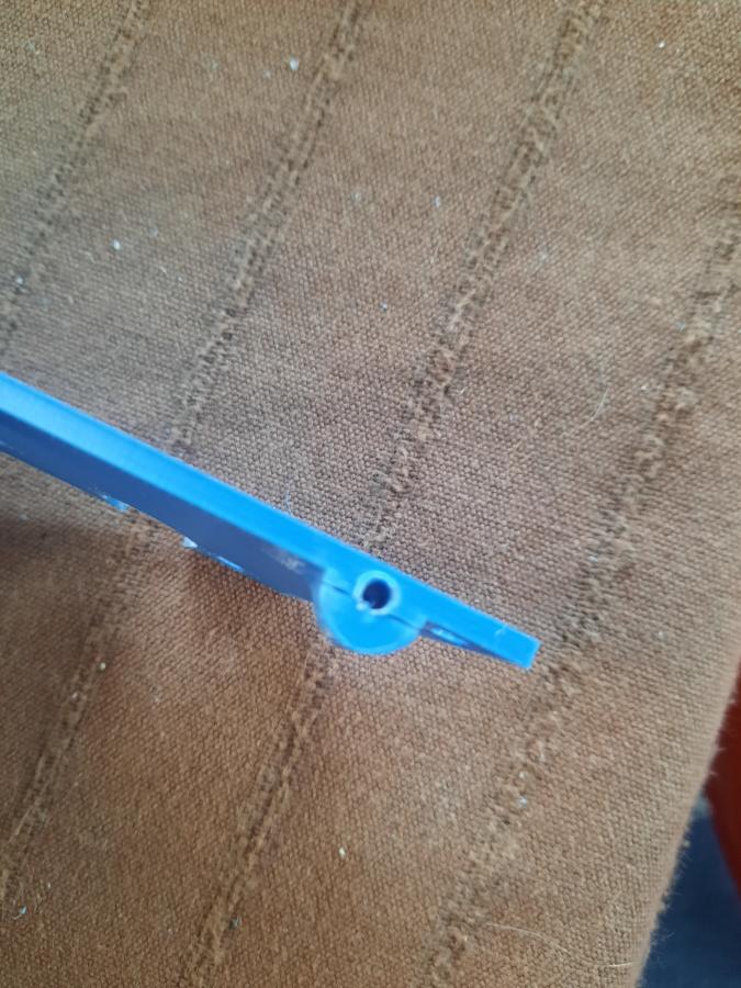

                        • Sappo
                          • Feb 2020
                          • 346
                          One of several broken attachments, but thankfully repairable Click image for larger version
                          • Barmonkey
                            • May 2021
                            • 54
                            • USA
                            Thanks for pointing that out! I was wondering if there would be issues using the wood screws.
                            I was thinking about using a nut and bolt where I can.
                            • Barmonkey
                              • May 2021
                              • 54
                              • USA
                              I have a similar nub on the front part of the hull side. Seems like that should have been beefed up a little.
