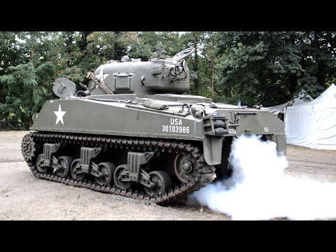

          I removed all the smoke generators from all my 1:16 scale RC tanks. Engine does not generate white smoke.

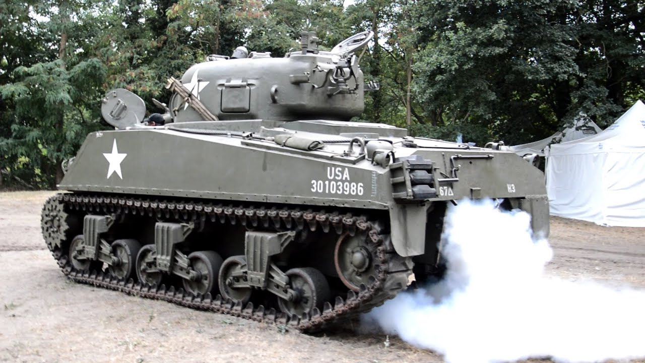

              That's why I preface my tanks don't smoke statement with smoke on startup or running badly. Some will smoke at wide open throttle like the M60. That Sherman sounds like it's using the 9 cylinder radial engine. You can damage the engine from starting it without cranking it by hand to even out the oil in the cylinders as it drains to the lower jugs. The smoking also subsided a lot after it was running for a bit which probably means it was burning the oil off from sitting.
