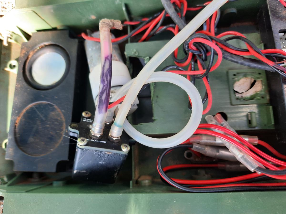

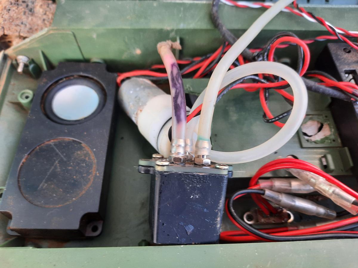

      Thanks a lot for replying HDMM. I have 2 pictures, one of the tank opened, and one of where I think the smoker goes, I have bought new smoke pipes.
      If you need anymore photos you can ask.

        OK, I see now you’re trying to fit the smoker in the lower hull, I think It actually mounts to the upper half of the hull so that it can can to the elbows. Yes it’s a little weird but that’s how mine was that I has a few years ago. Although I think that was before they came out with the fan smoke unit. If it won’t screw into that spot between the gearbox I think maybe the tubes just kinda keep it in place. Sorry I’m not much help. I don’t think I have an opened up a henglong T 34 with a fan smoker in probably two years the last time I worked on one for somebody.

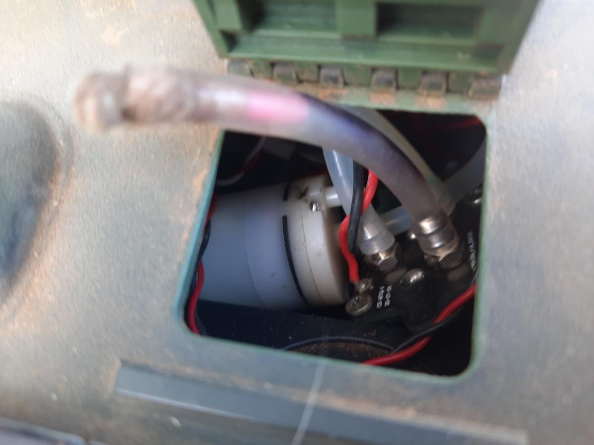

            Smoker in the T34 mounts on the upper hull but is not secured by anything.. (Just the tube connections, IIRC).

              When I try to place it in it fits, but once I try to fit back the upper hull it gets stuck, I believe its obstructed by the motors. Another question, would it be worth trying out the metal small smoker from Heng Long?

                Jarlath is right, it is not mounted to the lower hull.
                You'll need to put the upper hull on by starting it back a little then moving it forward to match up with the lower, so that the smoker motor which is on the upper hull slides under the motors.

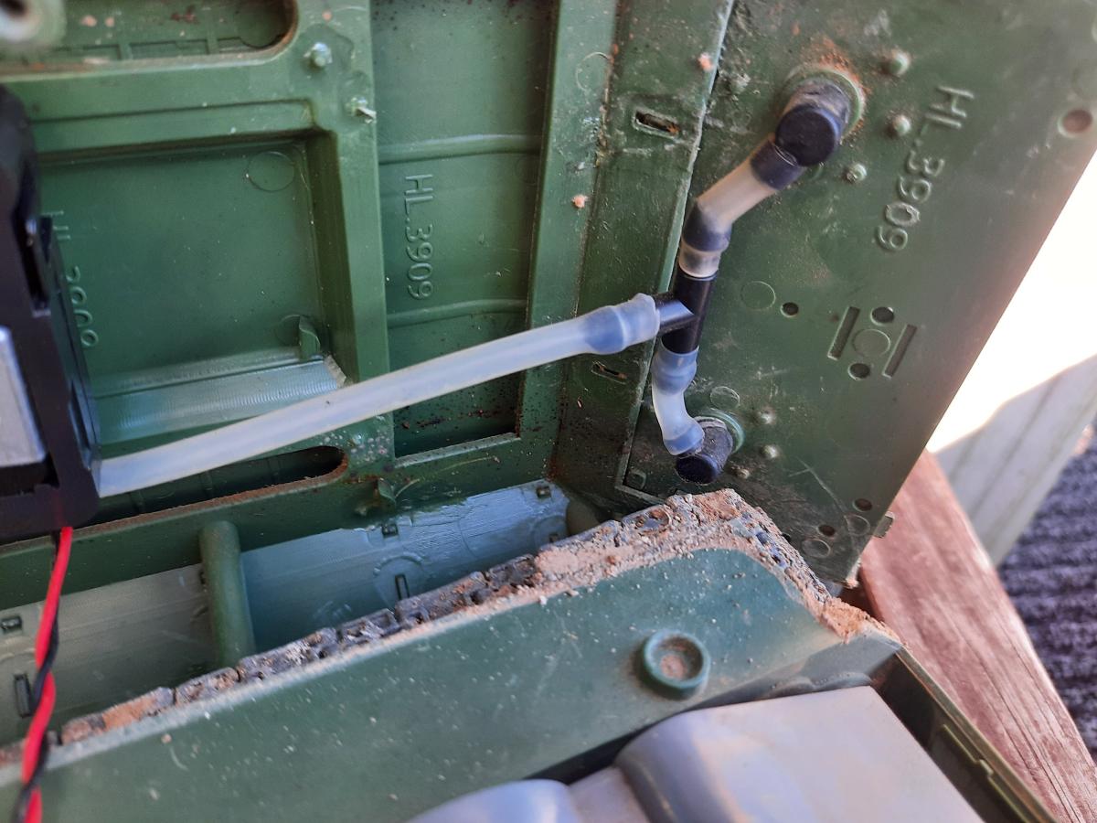

                      What I did was to move the smoker to the front of the hull ,connected the exhausts with a T joint from a aquarium pump and ran a long hose back to the smoke unit. I then attached a short hose to the other outlet and fill it through the drivers hatch

                          Sorry it took so long to get back with the pictures of the t34 smoker,,as you can see there is a T joint at the back connecting the twin exhausts with a long hose coming forward to connect with the unit. Very easy to do. Excuse the Q tip plug in the filler hose, was all I had at the time and have never changed it
