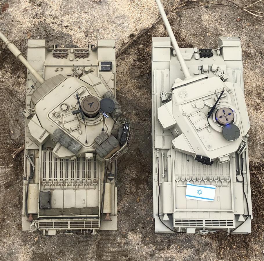

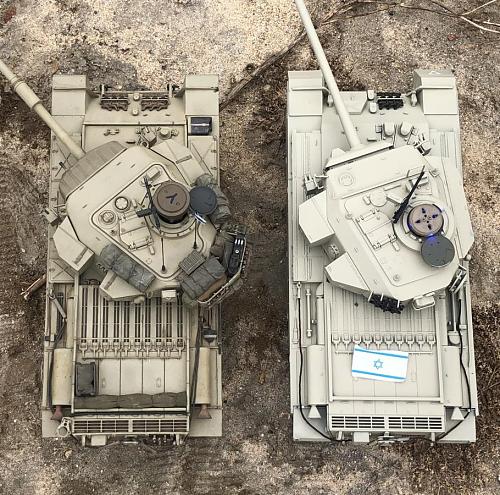

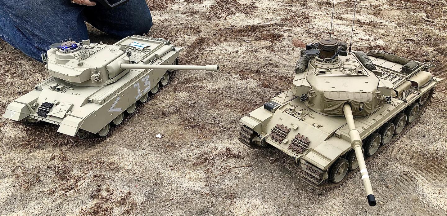

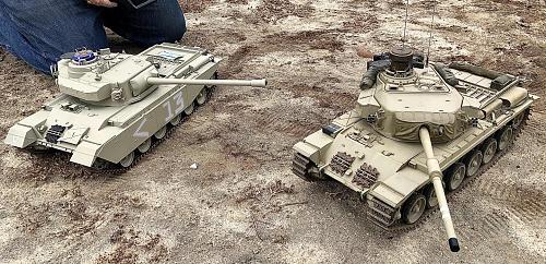

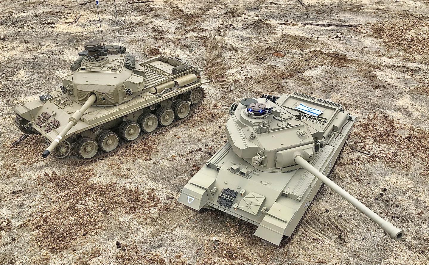

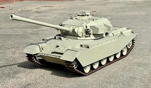

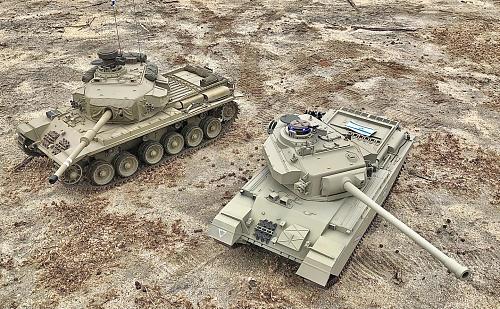

      Some side by side photos of the TD Centurion(lighter tan) and Tamiya Centurion. Overall there are areas of modeling where the Tamiya is better, but also areas where the TD is. Definitely looks worth the $500 price tag and SoCalbob has not even weathered it yet.
      Click image for larger version  Name:	98EF9B8A-759F-475C-BDF6-C03FABCEDD24.jpg Views:	0 Size:	209.4 KB ID:	386736 Click image for larger version  Name:	0AA2B8A2-C6A0-4C25-B8AC-F87D4AB281A8.jpg Views:	0 Size:	503.1 KB ID:	386737 Click image for larger version  Name:	CF80526F-0613-493A-83B7-48E6C35768CB.jpg Views:	0 Size:	390.2 KB ID:	386738

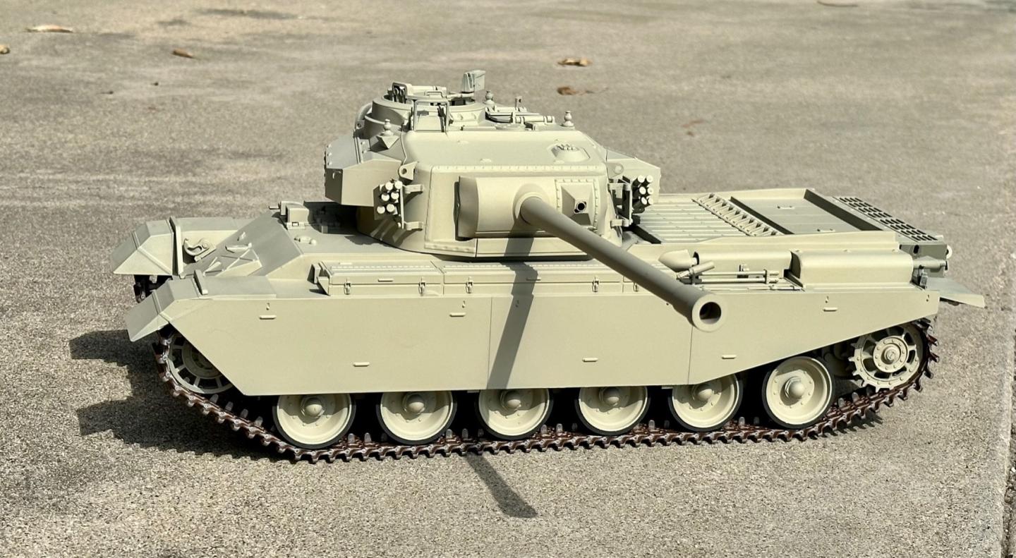

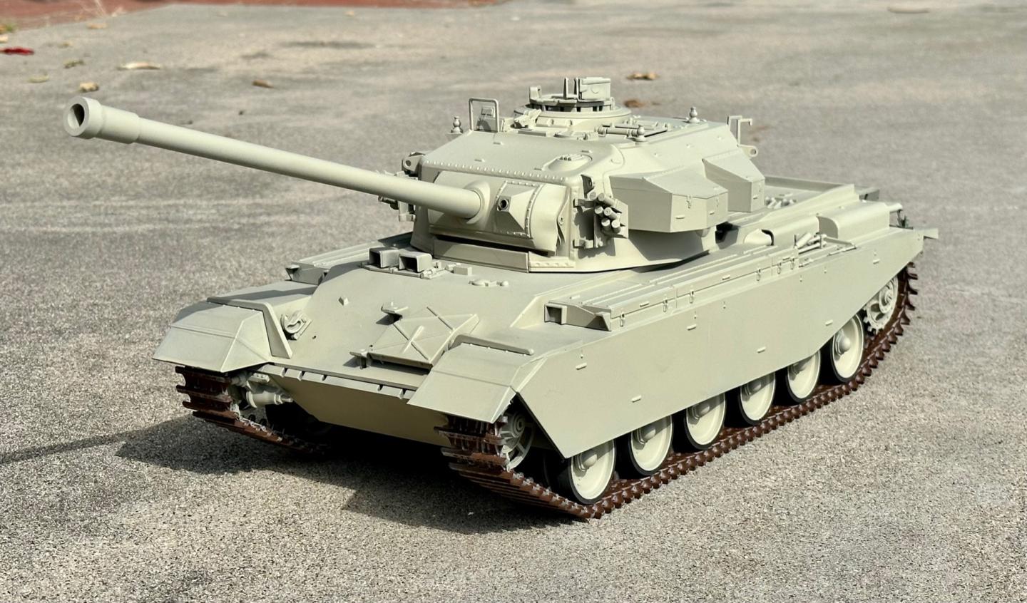

        • #24

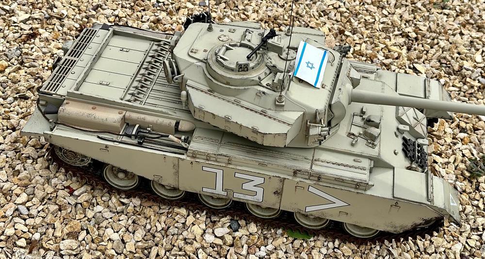

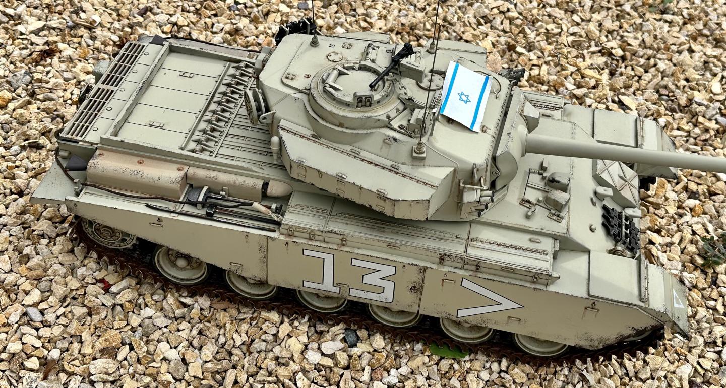

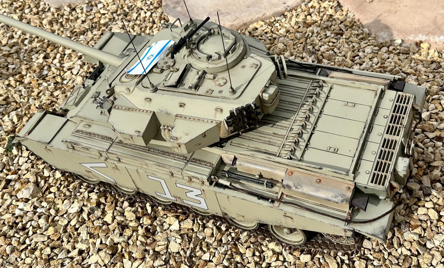

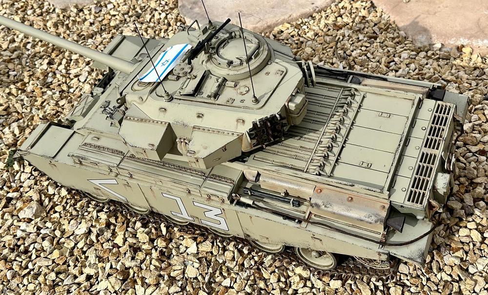

          Finale: Pretty much done, ready to accumulate real world dirt on our battlefields.

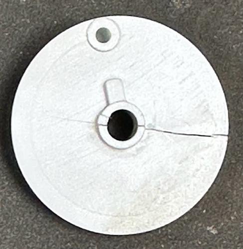

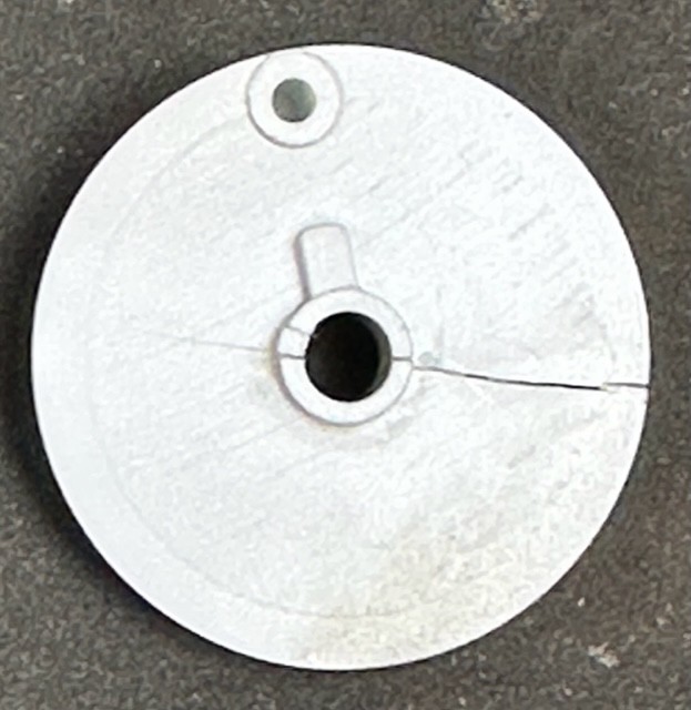

            So some bad news, good news about the Centurion. Recently the elevation function began to malfunction. I could hear the motor running, but the gun only up and down a little bit and I could hear slipping inside. That's the bad. The good news is that it is fixable.
            TD has put a larger wheel than HL on the motor module. This wheel rotates pushing the gun breech up and down. The larger wheel yields a greater range of elevation. However, this also causes mare torque stress on the wheel hub, and it eventually caused a crack. I glued, reinforced and lock washer it and it works ok. It is a failure point that I'm sure others will experience.
            In working on this, I've observed that the TD motor mechanism is dimensionally the same as HL's. HL just has a smaller cam wheel; stronger but with less range of motion. It's a fallback solution of the TD wheel completly breaks.
            Here's the wheel I'm talking about.
            Click image for larger version  Name:	IMG_0347.jpg Views:	0 Size:	72.3 KB ID:	388184

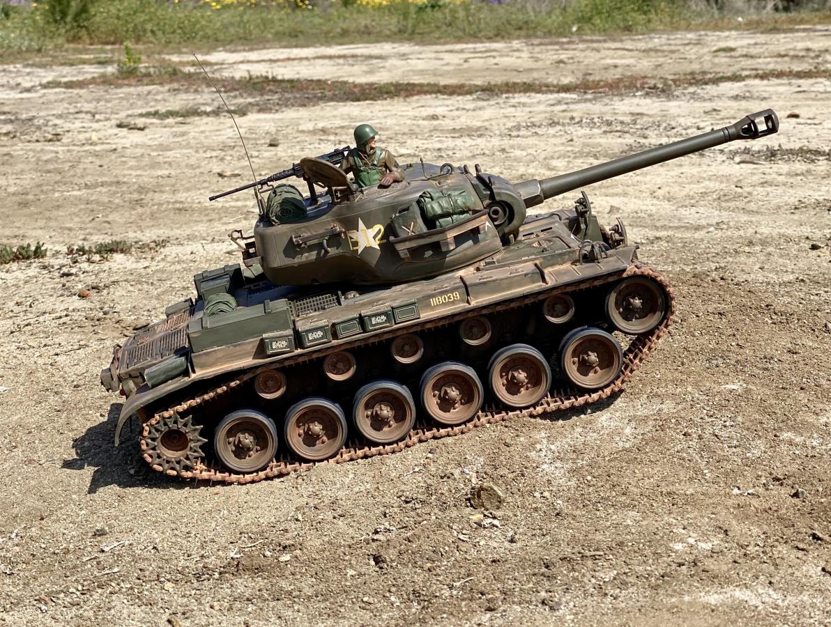

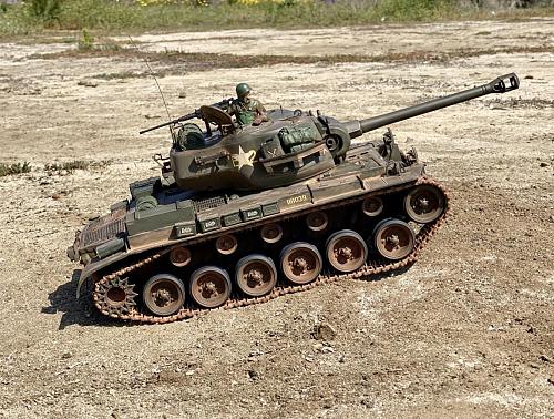

                    I guess it could cause damage, but it never has for me. Usually "detracking" just means the track links aren't fitting onto the sprocket teeth. That's a minor displacement and doesn't usually hit the skirt. I did have an Abrams once that the tracks began rubbing the skirt inside and I eventually saw some plastic shavings. The other major displacement is when a pebble or dirt clogs the idler and throws the track completely off. Panzer 3's and 4's have this happen a lot.
                    The worst consequence of having to reseat track on a tank with skirts is having to remove the top hull. I cut the skirts off my Pershing because of this. It makes it look meaner too!

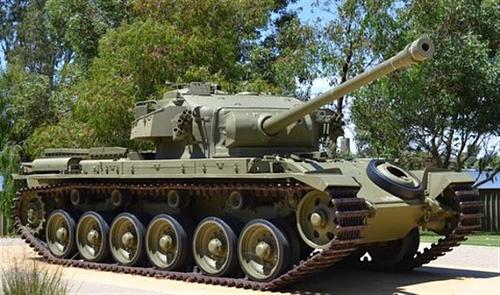

                          The markings are of a Korean War USMC Pershing. It's posed cannon up as they were used as artillery at times then.
                          Centurions were used by ANZAC in Vietnam. They removed the skirts, I'm sure because of the sloggy ground they encountered there.
