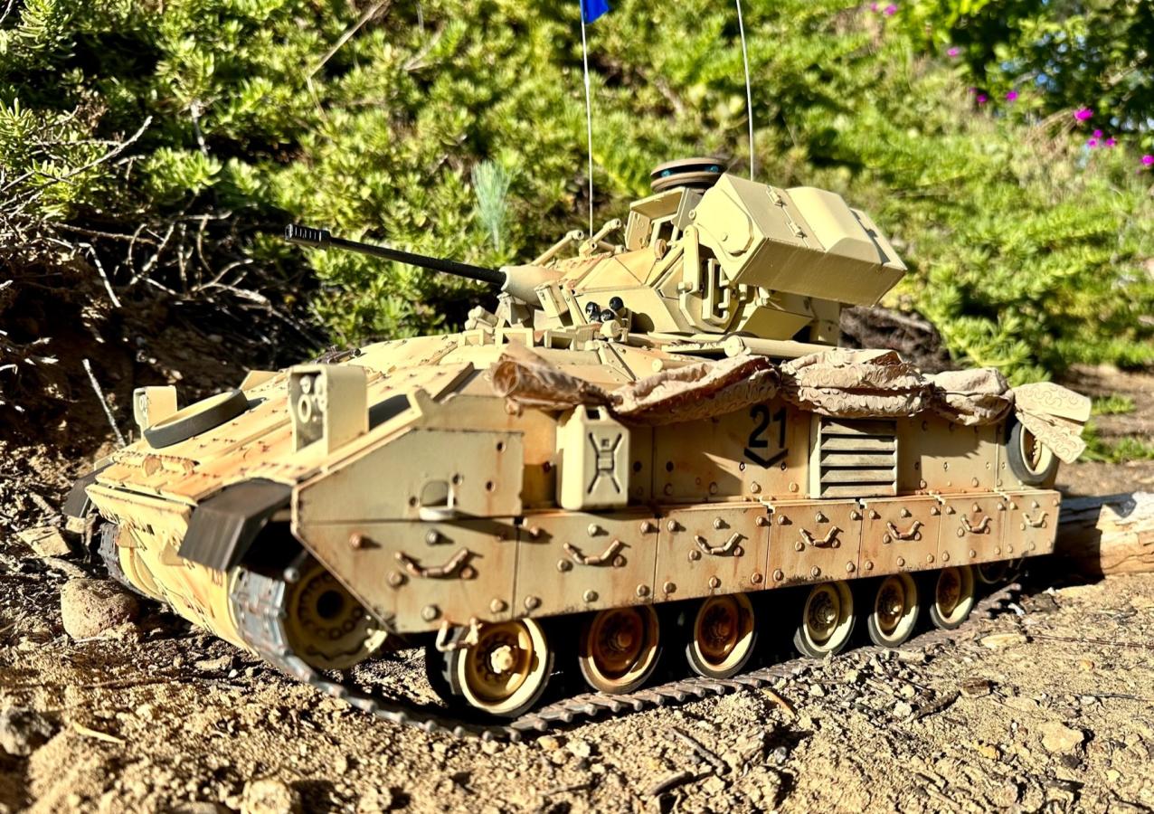

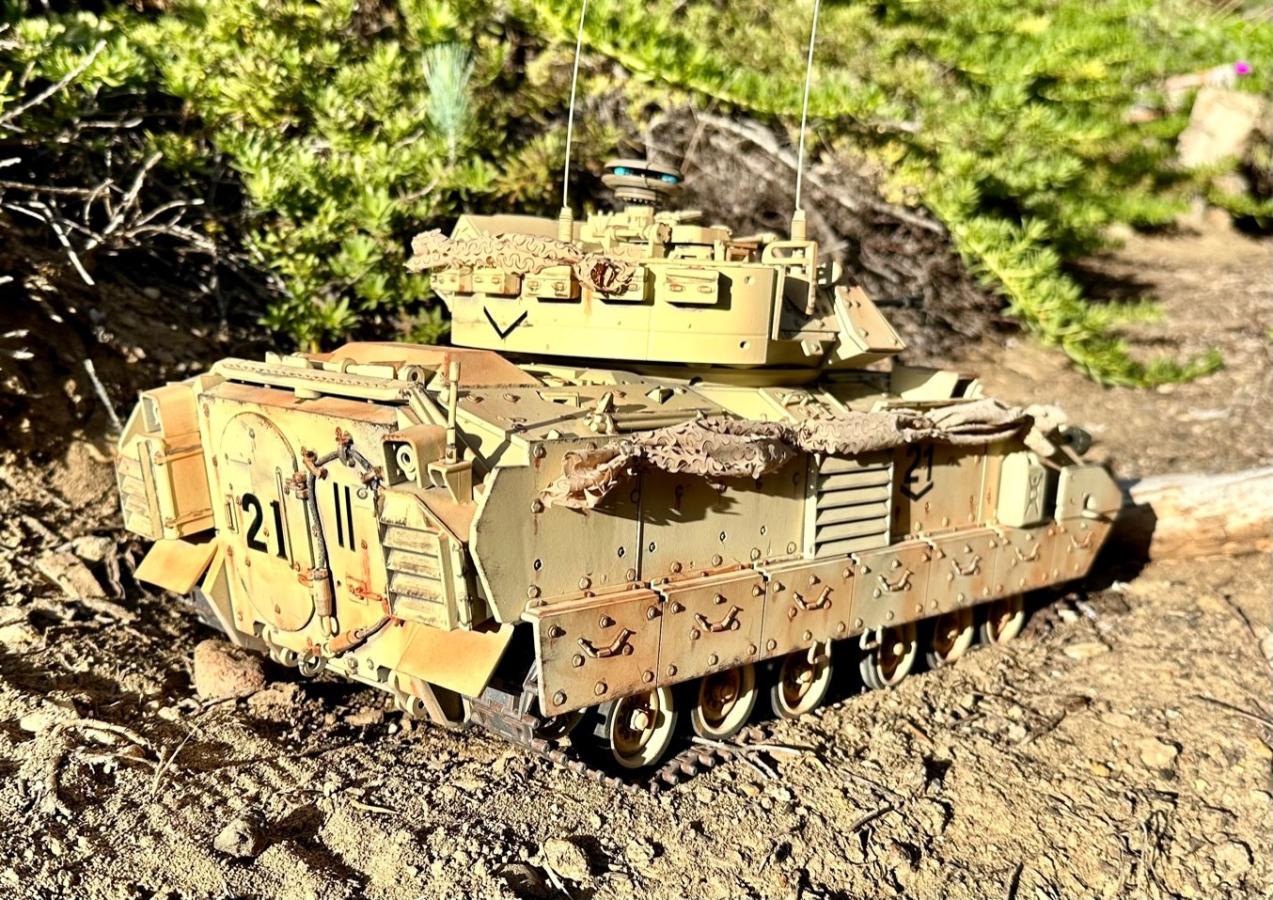

    Pretty much done, ready to roll. The IR seems to be working ok with a new TD board.

            I have to say that is a very impressive looking vehicle. It’s now got me in a tis. I wanted a Leopard. Now I want a Bradley and a Merkava as well.

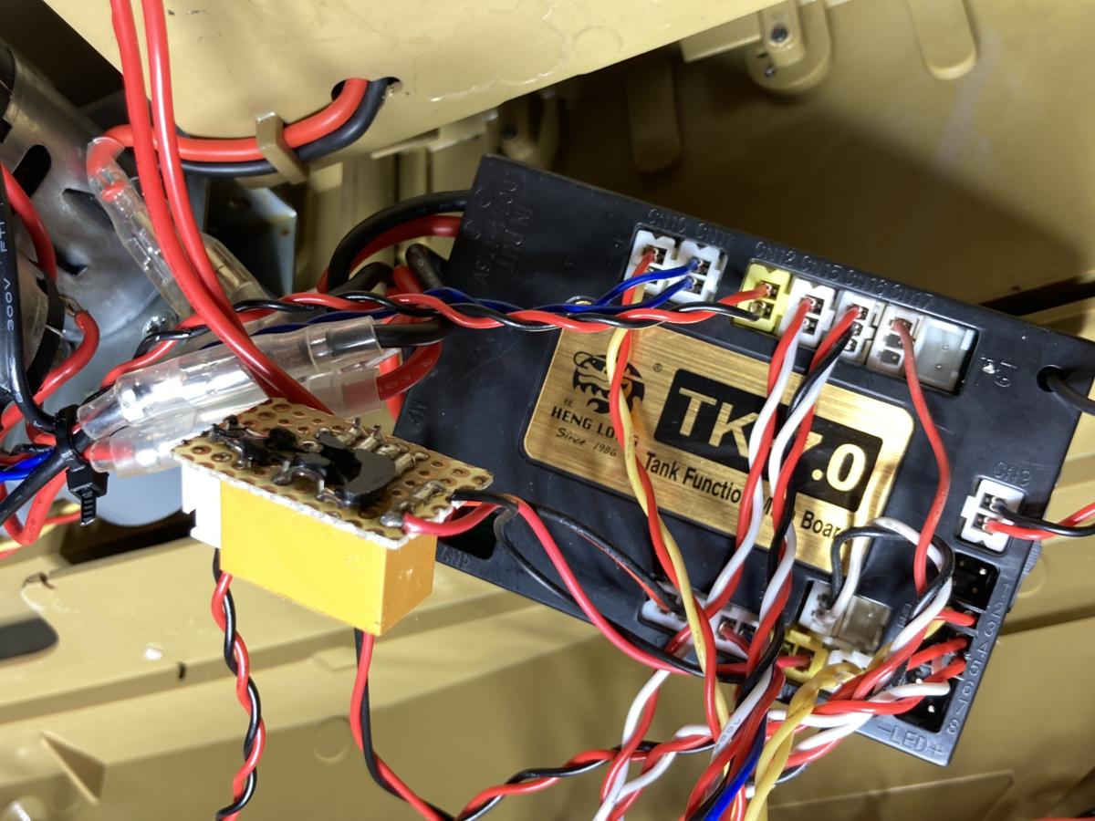

                                    David N has an Abrams with two extra functions, a hatch and a periscope. David, what are the two commands for them?
                                    • #58
                                      Press "G and S" switches the turret rotation to periscope panoramic rotation. "K and stick 2 down" opens the hatch.
                                      • #59
                                        Thanks! What channels were the periscope and hatch plugger into?
                                        • #60

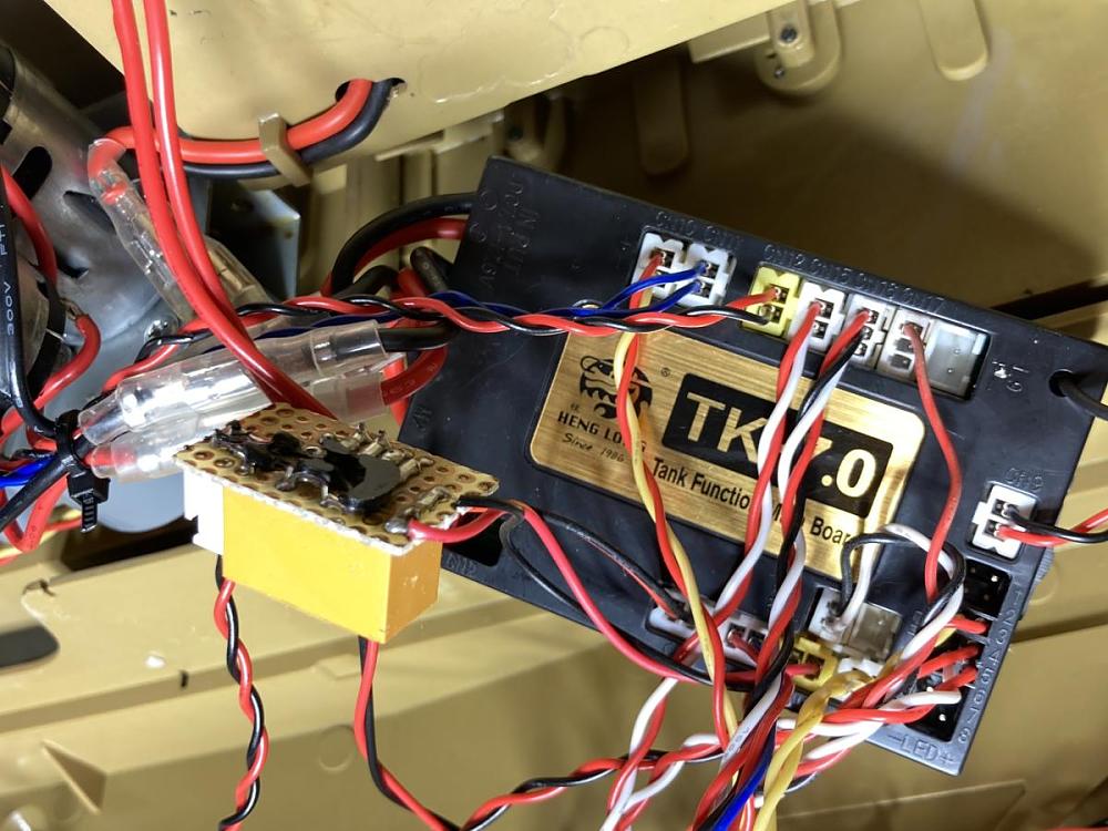

                                          For the periscope, they have this board (the one that has the yellow box) where the 2 sets of wires from the turret rotation and the periscope go in. The 2 sets of wires coming out from the board go to CN3 and CN5.
