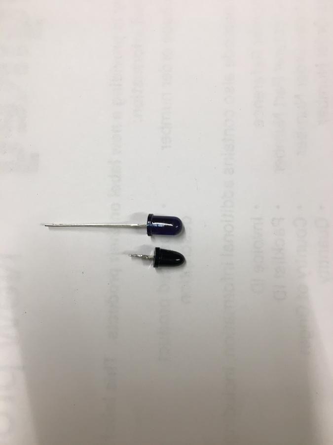

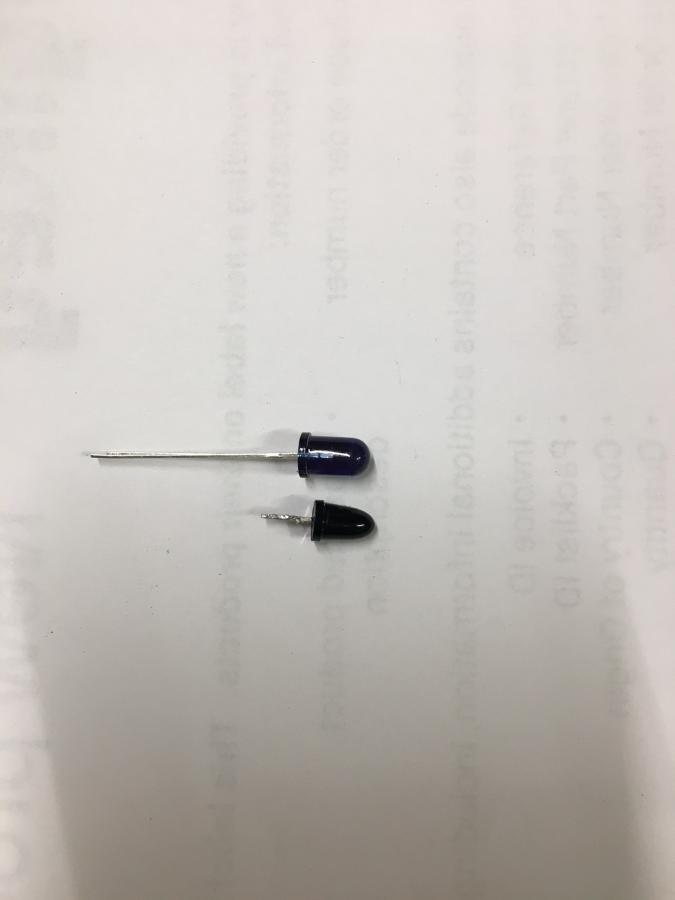

ID:	391897thanks Tang. I found out that David was right. I wired it the other way and the bulbs work. I was always taught that the longer lead in the LED was positive and the shorter was negative. Apparently, these LED don't follow the rule. I received my 6100 and 6200 bulbs today and they are slightly bigger. On the Panzer IV the machine gun barrel is small so the 475 SFH 4545 fit better. It is a Torro metal turret so I don't want to drill the hole any bigger. I should be ready for the next LA Tanks with my new ride.

                  here is a comparison of the two LED Click image for larger version
Name:	IR Bulb comparison.jpg
ID:	391904 6100 series on top and the 475 on the bottom

                    I don't know why the makers are so inconsistent about it. I always end up testing them for emitter signal before soldering so I don't use a bad one or waste time with a reverse wired LED lol.
