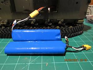

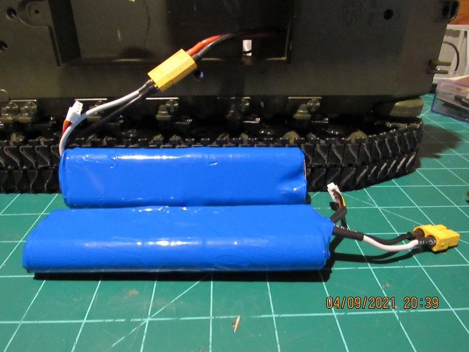

      The Heng Long OEM Li-Ion battery claims 1800mAh. I have 4 of them which measured from 800 to 1200mAh in capacity. You do the right thing to upgrade it.
      Size wise, both admiral 3500 and 7000mah should fit any plastic chassis (basic, upgrade, pro) version HL King Tiger battery compartment, but NOT the all metal chassis version. Newer HL tank uses XT60 connector and older HL uses Tamiya connector for battery connection. MotionRC is inconsistent with the connector for their battery. Make sure you get the correct connector or a convector to match them.

        Inside every Heng Long full size battery case is a li-ion pack half its size. The capacity is 1800mah. Motion sells an Admiral li-ion pack that is the same size but with 3500mah capacity. If you were to remove the Heng Long case, the pack would be the same as the3500 pack. Motion also sells a full size li-ion pack that is 7200mah, fully four times the capacity over stock. If you are unfamiliar with battery characteristics, I recommend you stay with li-Ions. Whatever battery type you use, get a charger that has a balance tap function. This minimizes danger of combustion during charging.
