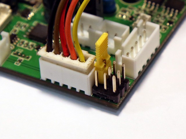

        STEP 1: Turn power off, Turn power off, Turn power off,
        STEP 2: Plug programming line/TBU through TBU/HBU base into CN2 Infrared Port ,
        STEP 3: Install a jumper to J2 as shown below, Turn power on,

        STEP 4:Refer to function table listed below, point IR configuration remote to TBU/HBU/Programming line receiver, and press the button of setting that you want to change, "*" sign in function table means the default setting that is programmed in factory
        STEP 5: Indicator on TBU/HBU flashes according to new setting value.
        STEP 6: turn power off, remove jumper on J2, then turn power on and TK board runs with new settings.

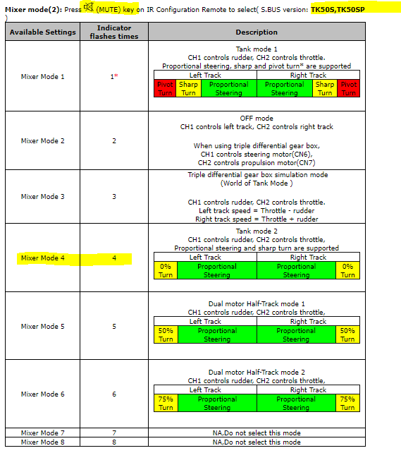

        The setting you are looking for is probably Mixer 4:

          Thanks for the reply and info, I tried this and has negligible impact, I'm thinking the tank is just too heavy, I removed the upper hull and turret to test the mixers and it moved amazingly just on the 1st default setting. When fuly assembled and put on the #4 mix setting it still has hard time turning and almost will never turn with just one track or turning at low speed. Runs pretty good going straight though.

                      • #12
