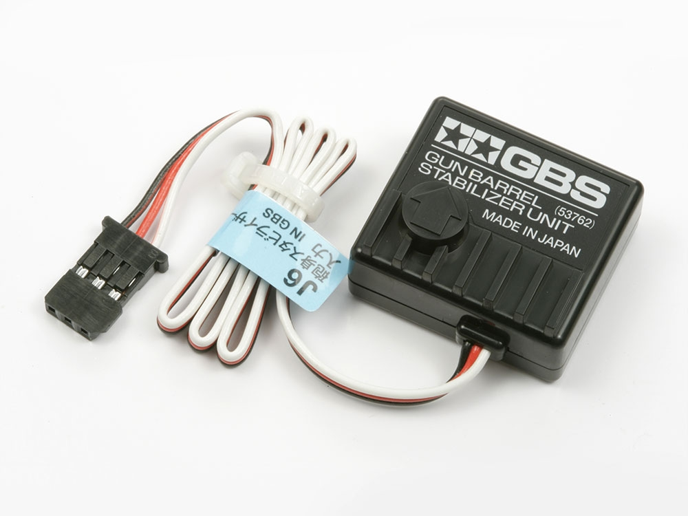

Will this from Tamiya work with the HL TK-7.1 motherboard:
★This unit was developed for use with the Tamiya range of super-realistic 1/16 scale R/C AFV models. ★Fitting it keeps the gun barrel stabilized at a certain elevation regardless of how the model orientation changes.
*Compatible DMD: DMD T-07 (Leopard 2 A6) only
No it does not work with anything but the Tamiya T07Originally posted by cmdrcody View PostWill this from Tamiya work with the HL TK-7.1 motherboard:
https://www.tamiyausa.com/shop/116-t...r/116-leopard/
SGS-Electronic TVC-GSU12 ( unlike the Tamiya Leopard 2A6 specific TVC-GSU11 ) supposedly work with any Tank though I'd suggest contacting them first.
