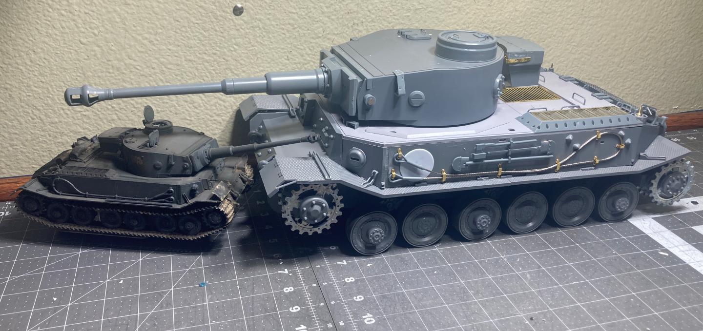

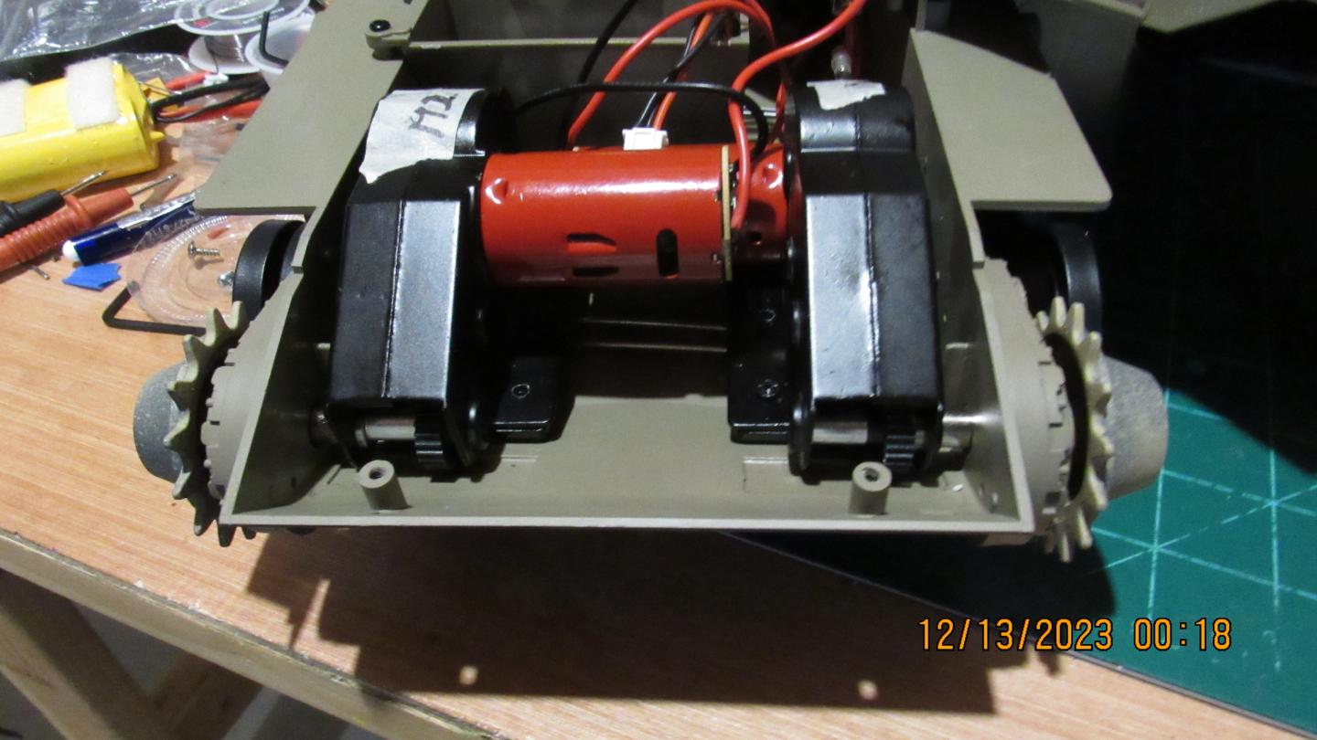

I only ordered the kits for $265. It does not come with the remote control radio, board, speaker, or smoke unit. I haven't decided which type of board is best for it yet. I will try different types and see which will be suitable for it. It does have the nice gearboxes, 2 motor units for turret rotation and barrel elevation.Originally posted by keilau View PostThe spec looks wonderful. Can you describe the radio and other components you ordered with the tank kit? Can't wait to see your test report.

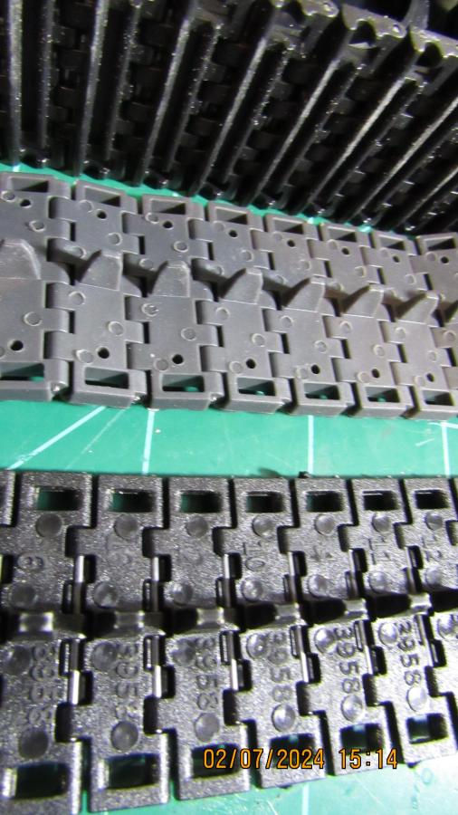

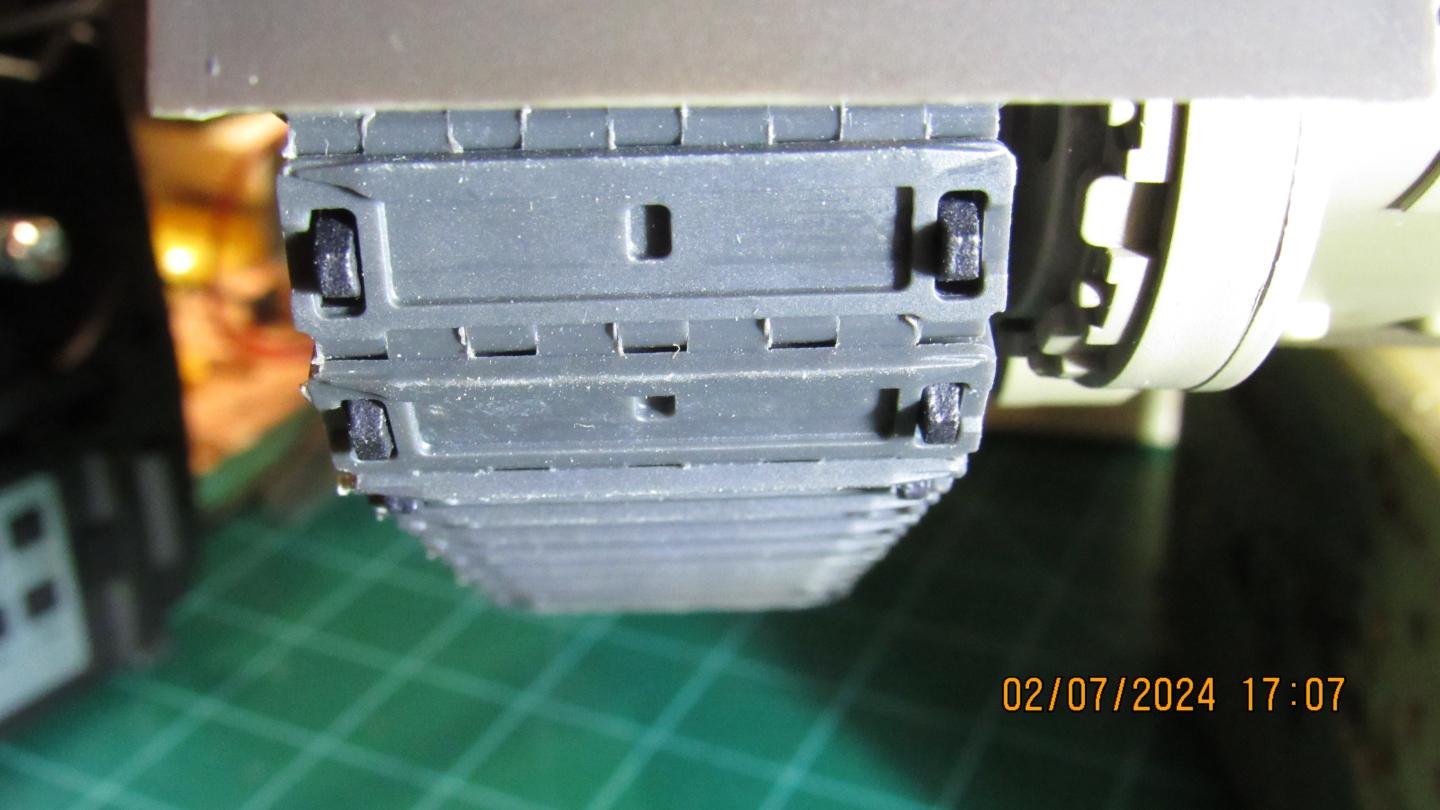

My only Hooben experience is a pair of nylon tracks and sprocket that I use on a Heng Long IDF Merkava. It looks better and works much better than the HL metal track system. The Hooben track is a double pin with totally enclosed pin design.

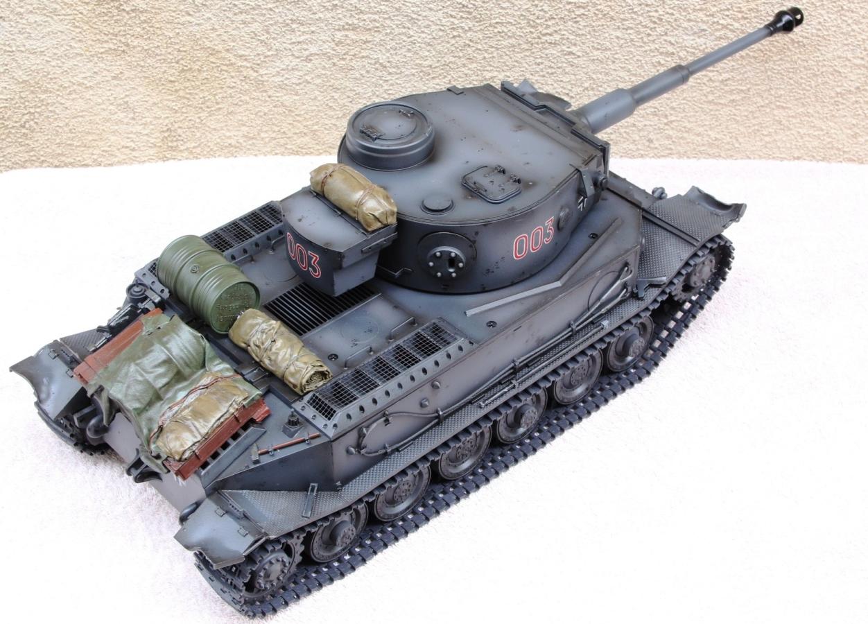

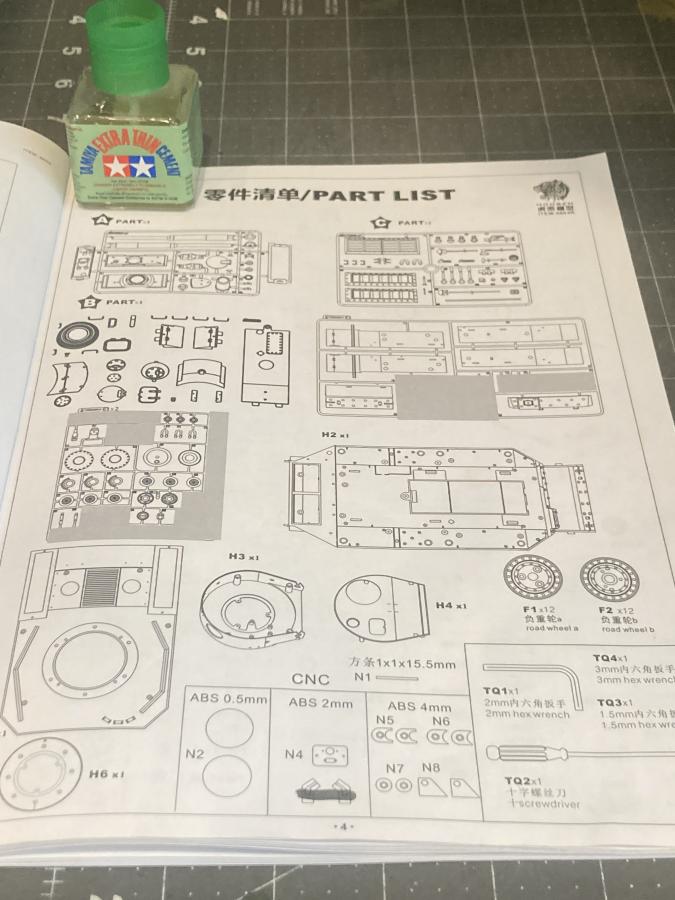

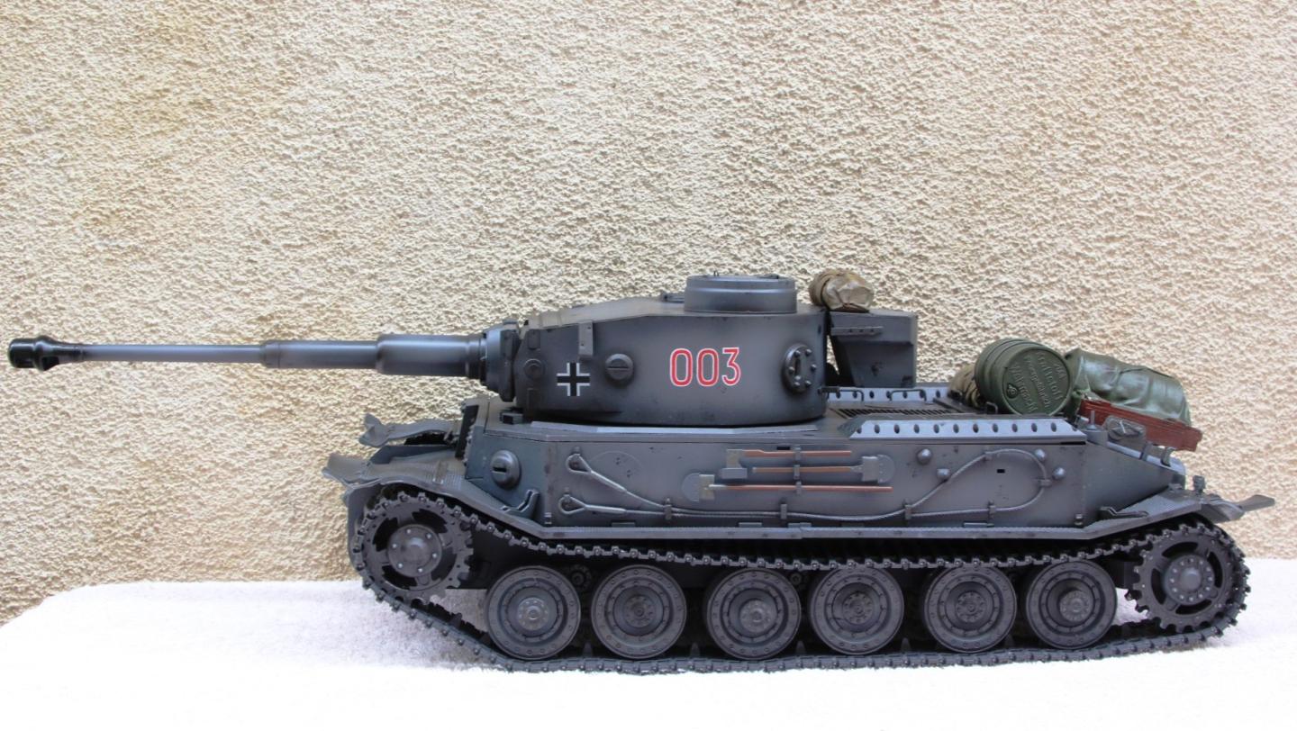

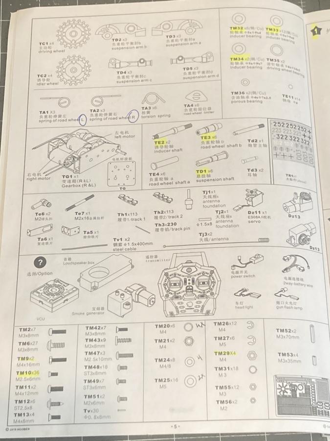

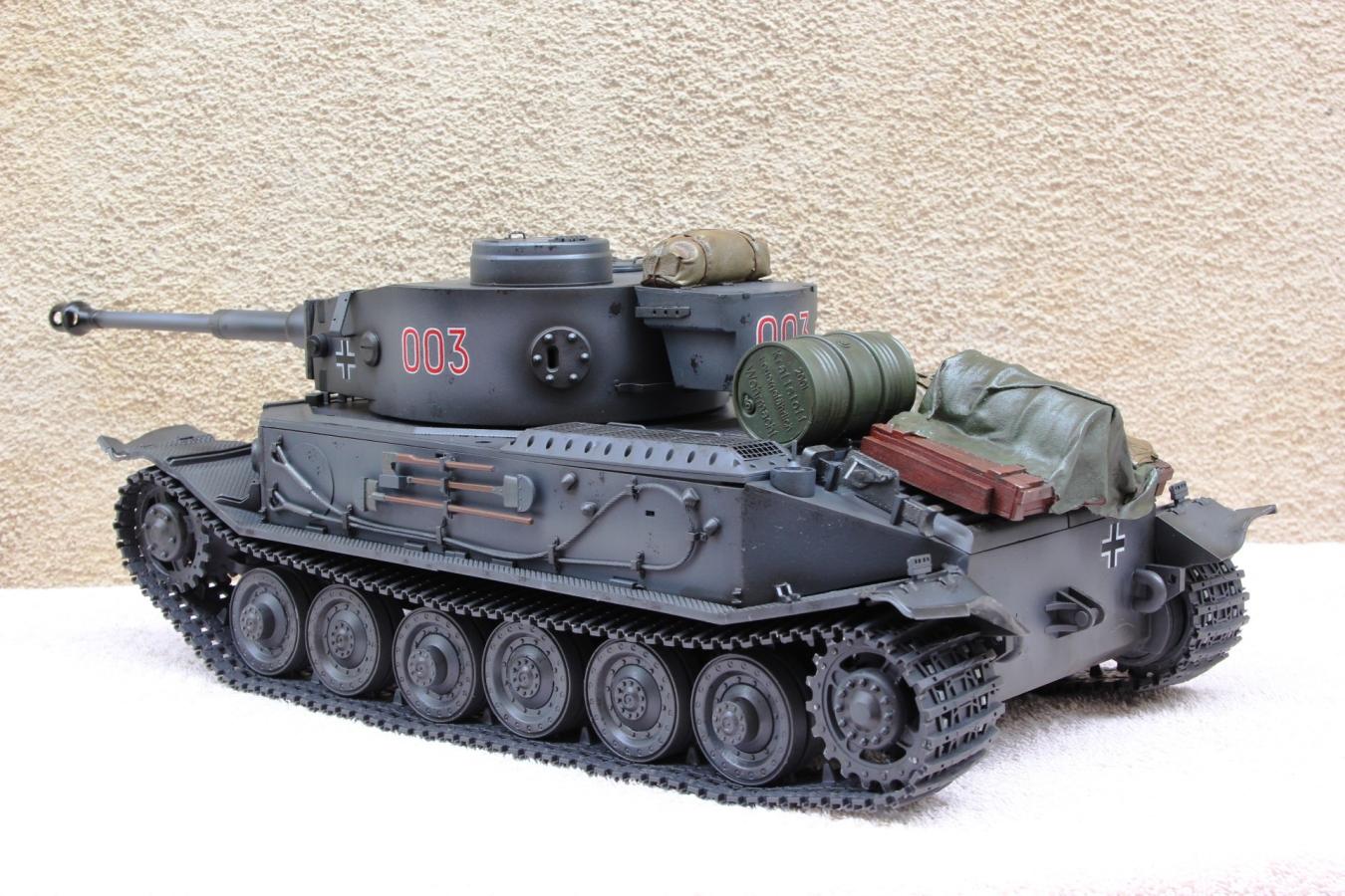

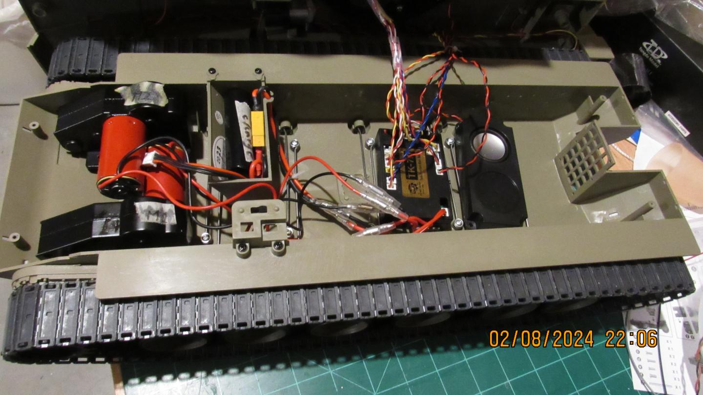

This Porsche Tiger kit is mostly plastic. It is similar to a Tamiya kit with lower quality mold and poor instruction. It had many nuts, bolts and screws for the running gears similar to Tamiya. I use plastic cement to attach parts together. I put the TK26 board inside. It runs fine today. The testing video clip was loaded in our SoCal RC Tank Club page on FB.
