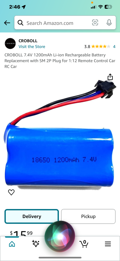

        https://www.ebay.com/itm/22595251129...3ABFBM-qSH2e9j

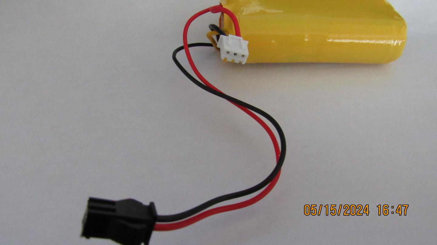

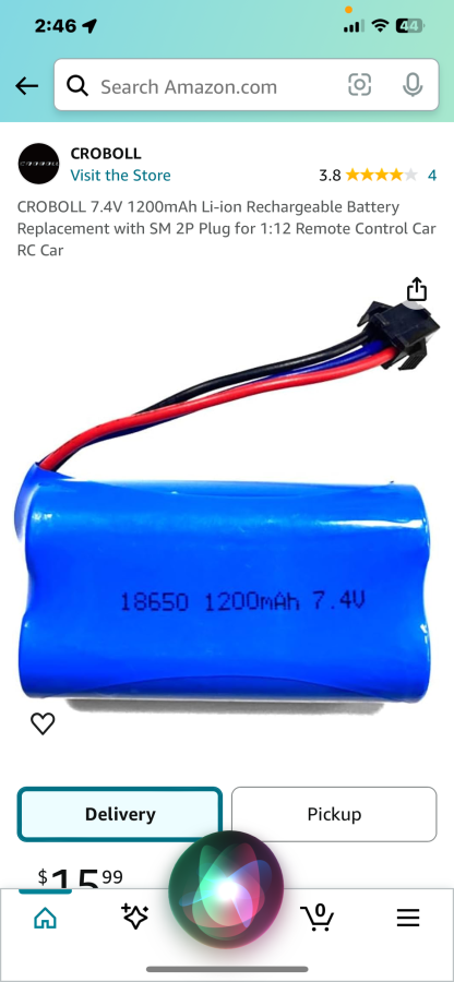

                • texasarmor
                  • Apr 2024
                  • 5
                  That is the exact battery that came with it

                    Originally posted by texasarmor
                    Click image for larger version  Name:	IMG_1106.png Views:	15 Size:	193.7 KB ID:	403739
                    The battery pack is done incorrectly. The 3-pin JST-SM connector is probably done to save cost, but it prevents the use of any better quality balance charger. The 1200 mAh 18650 cells are a sign of cheap battery. Typical 18650 capacity should be 3000 mAh such as the Admiral pack sold by MotionRC.com.
                    Buy Admiral 3500mAh 2S 7.4V Li-ion Battery with XT60 Connector online at Motion RC. Order online with fast delivery.
                    Changing the 2P power connector on the Admiral battery pack is not difficult. The easiest way is to cut off the wires and patch the Stuart tank battery wire to it. You need only the red (+) and black (-) wire for the power connection. The blue wire is neutral and needed for balance charge only.

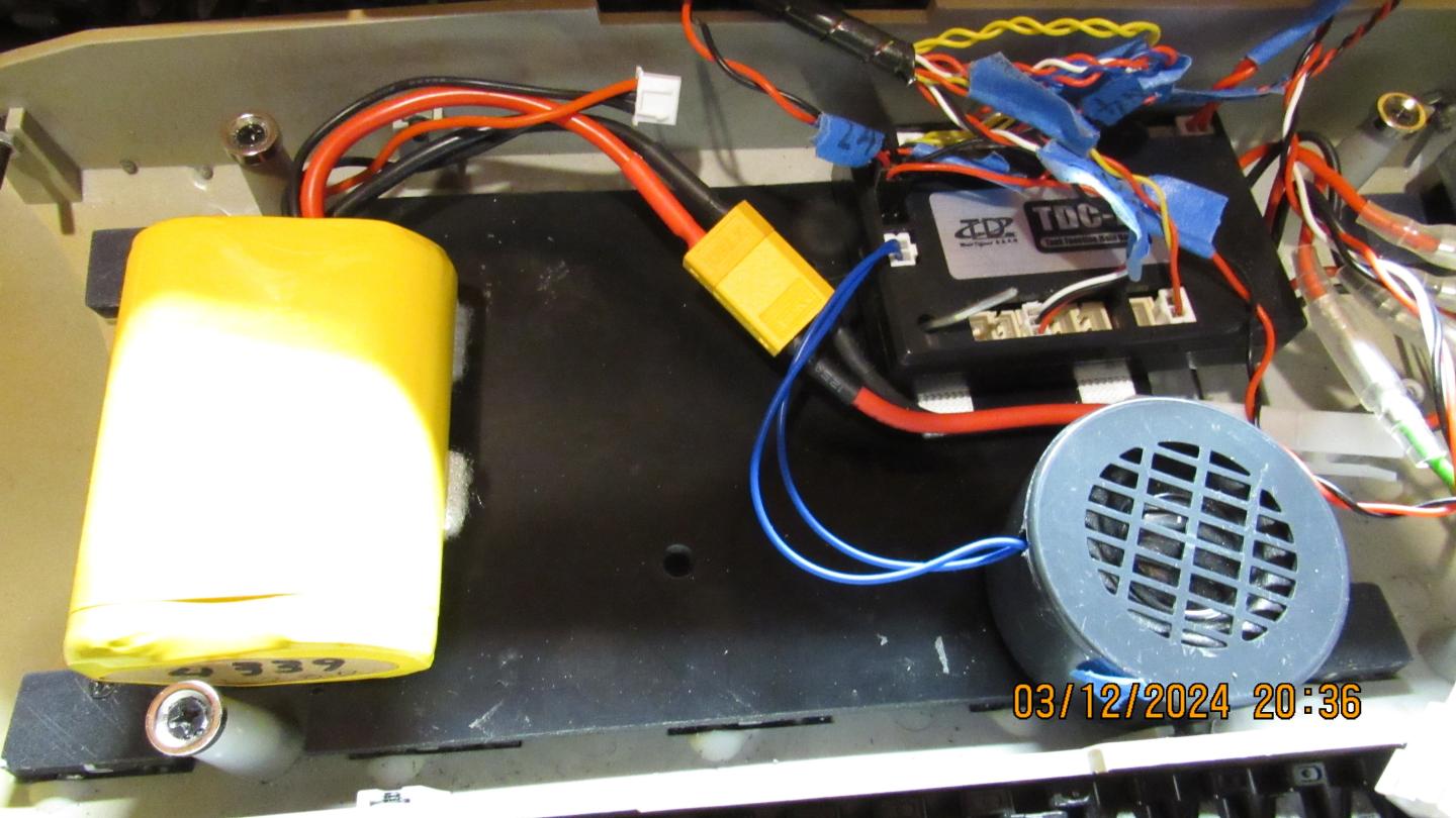

                    To do it properly, I will replace the power connector on the Stuart tank side and replace it with a XT-60 and get the Admiral battery or equivalent linked above. (Example from my HL Merkava)
