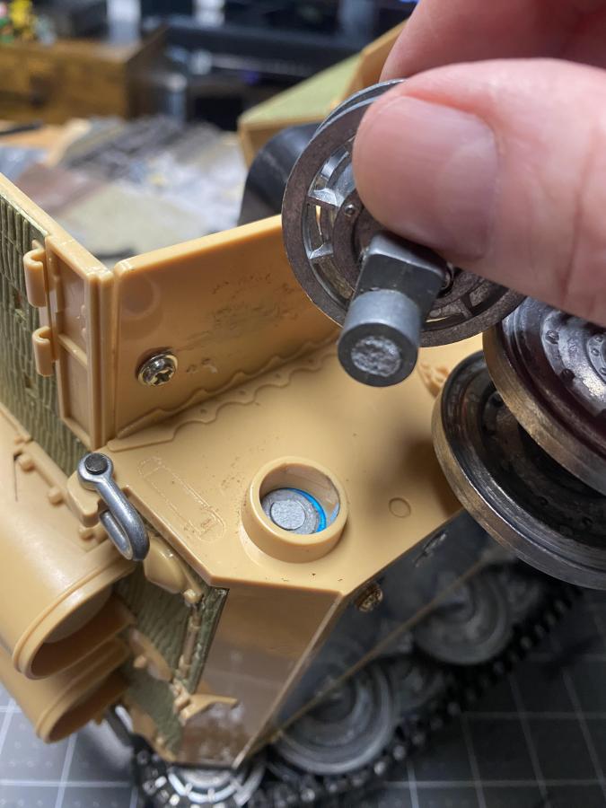

    Well first dry run and I notice something not right on the right side, took a closer look and wow!, Now did this happen in shipping? could have as I was only driving on a flat service.
    My question is can I fix this?, I used super glue, but how to get the tracks back on when there so tight??

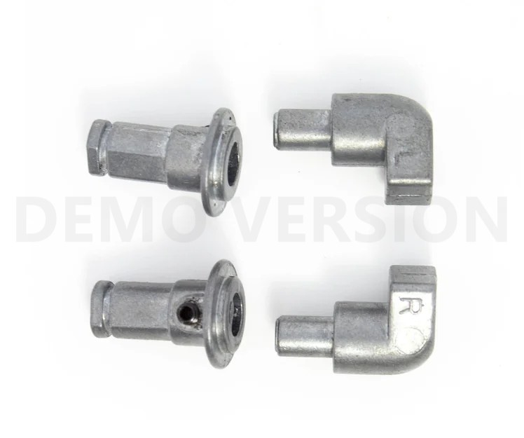

    Don't think super glue will cut it, if you look at the inside towards the back, there is a sectional metal "axle" running widthwise for the idlers, the piece that broke off is "L" shape coming out from the hull secured by Allen screw, and the idler wheel shaft is attached to it. These come in L & R, try to get the correct piece from Motion to fix it properly. There will be too much tension if the piece has been broken and patched (That rear assembly actually acts as a tensioner).

      Glue of any kind will not fix that. It will just break again. The idler is under A LOT of stress. Best thing is to have Motion send you the parts and you fix it.

        If motion RC can't fix you up I just might have one of those tiger tensioning axles laying around here somewhere. Let me know if you need it and I'll see if I can dig it out. You won't have to pay me anything for the unit, just pay the postage, if you end up needing it.
        As for putting the tracks back on, you can just pull one pin and that will separate the tracks, and then you thread them into place so that the meeting ends are on the sprocket and then just reinsert the pin. I think they have a video on how to do that at the Taigen tanks website. And remember, Torro tanks and taigen tanks are the same thing.

              If you don't want to un-pin the track in order to put it back, you could always keep the tension on the right idler loose after replacing the "L" shape piece, loop the track back, and then re-tension the idler. I would probably take this route since you would have to re-adjust the tension after replacement of that arm.

                  Update: You guys were right I ran it for awhile but it eventually snapped off again. Motion RC does not have the part, I will try John at Taigen, If that doesn't work maybe you can find that extra part for me Max-U52? Thanks for the help!!

                        OP, Taigen has listed the parts, best to reach out and ask https://www.taigentanks.com/collecti...ler-wheel-arms

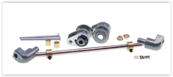

                        Have also seen some beefier ones that are 1mm larger but shipping would probably kill the deal https://www.rctank.de/Tiger-I-spare-...ll-5mm-version
