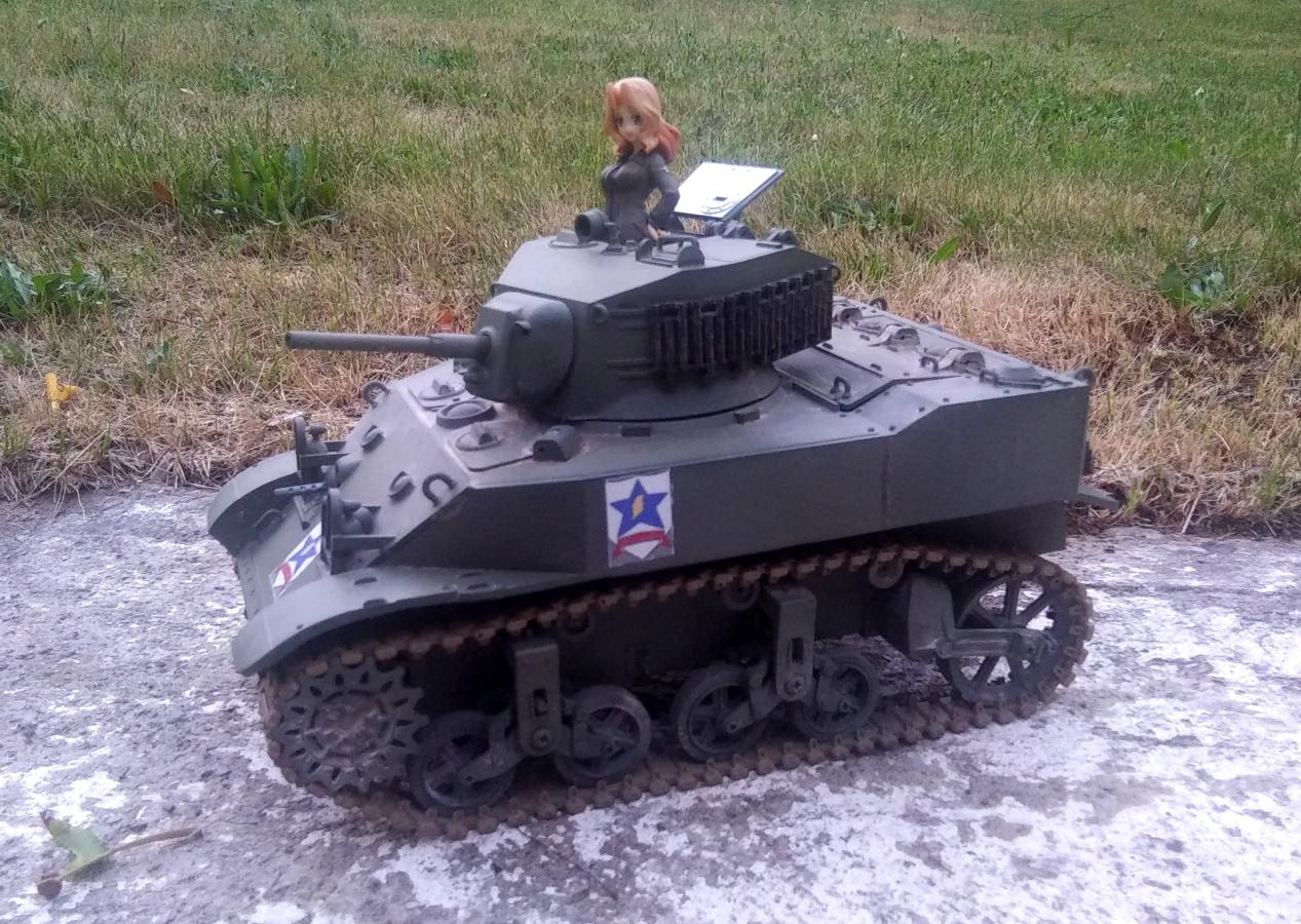

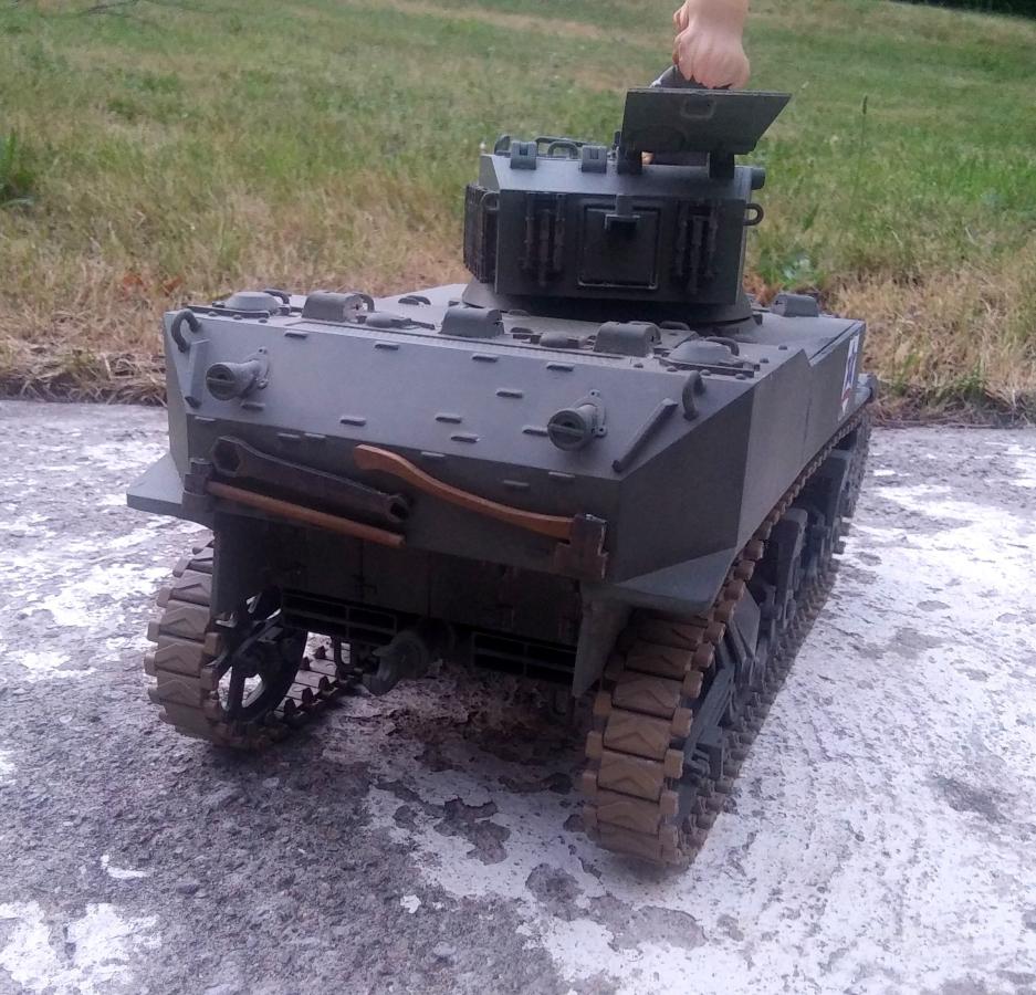

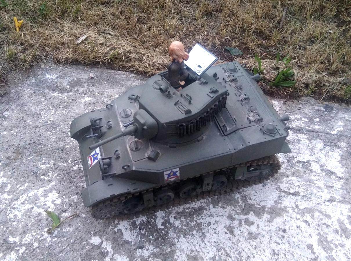

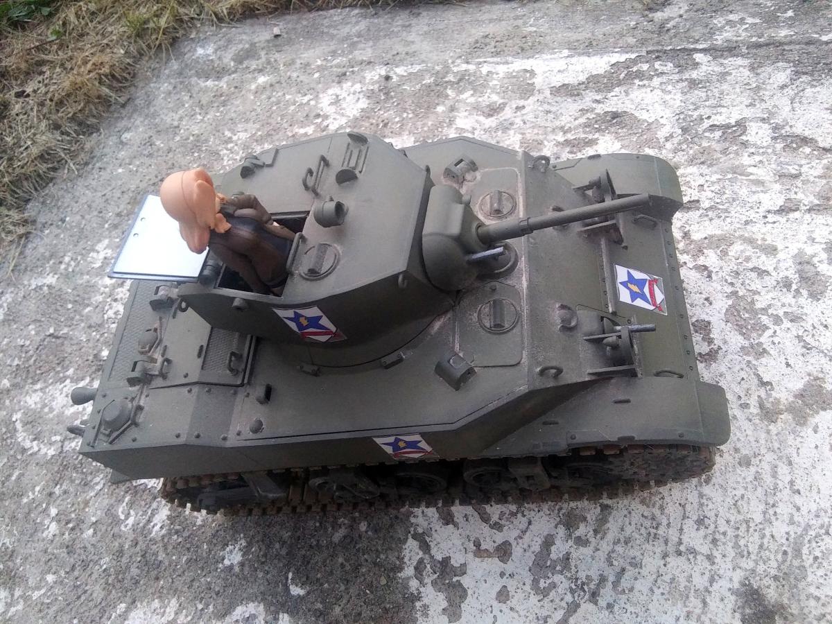

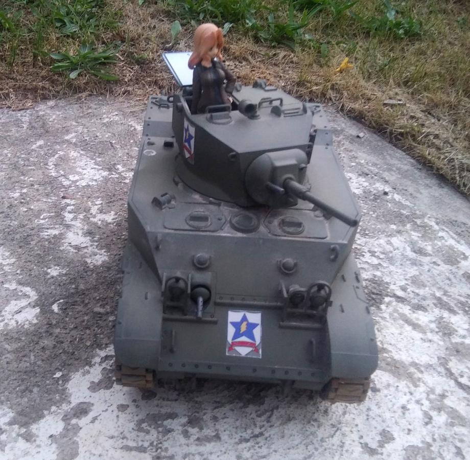

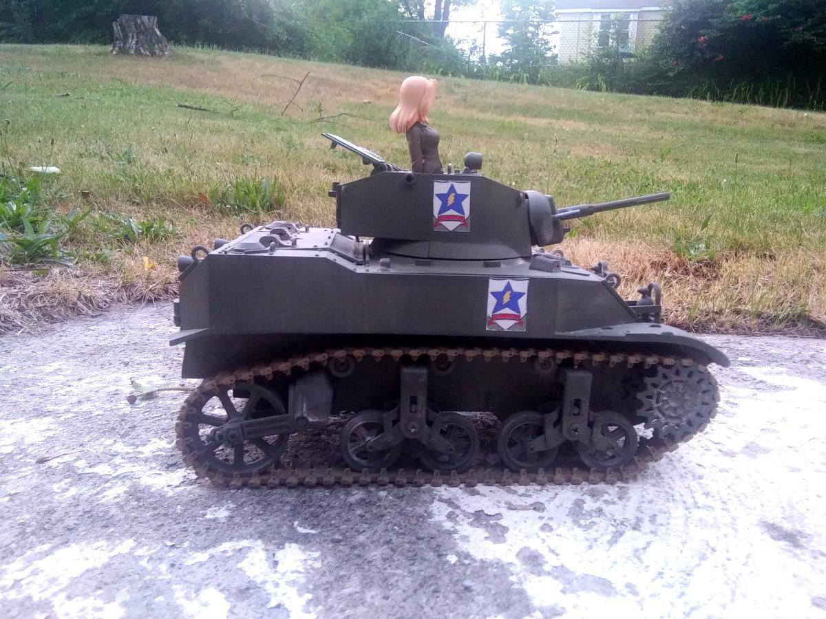

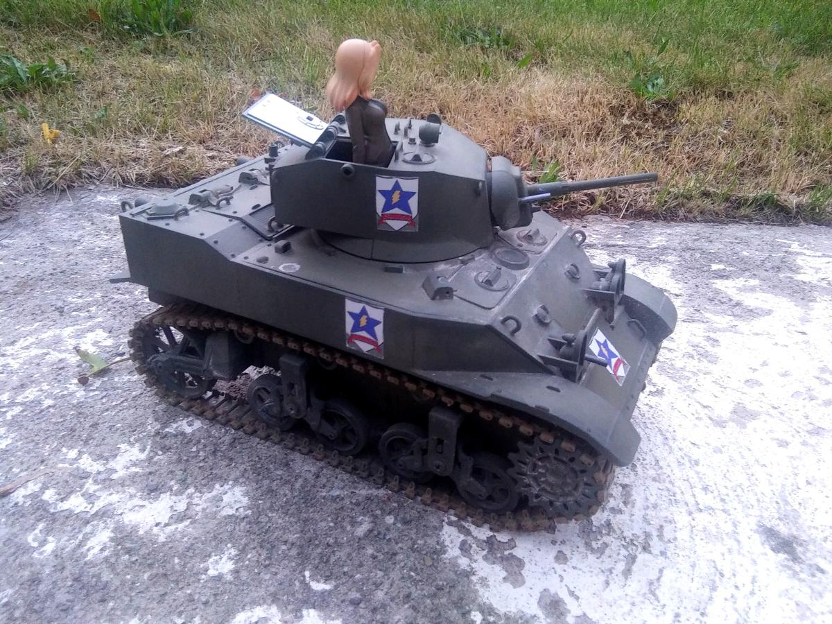

    Here is my M5 Stuart from Cool bank. I did some major mods to it.

    Tell us about your mods!

      I removed the side skirts with a Dremel, and removed the 50 cal. stowage bin on the turret side. Then I filled the holes and sanded it all down. Did the same with the residual plastic from the side skirts. Once that was done, the repaint and weathering commenced. I also removed one track link from each tread. Then, made the decals, weathered it some more, and added Commander Kay from the Saunders Academy. I'm so happy that an RC Stuart was made in 1/16 scale.

        What bit did you use in your Dremmel? That was some careful cutting! Nice job.

          Just the standard cutting wheel, then the round sand paper attachment. Thank you, It was scary, but I went for it. I really didn't like the skirts.

              Thanks bro. , even with inferior tools, if you leave enough extra plastic so you can sand down it can improve your results.

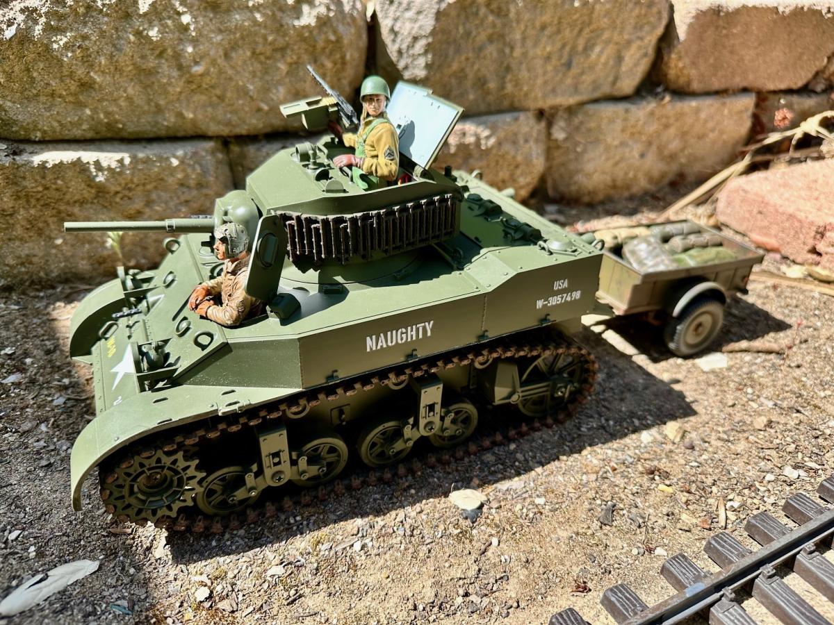

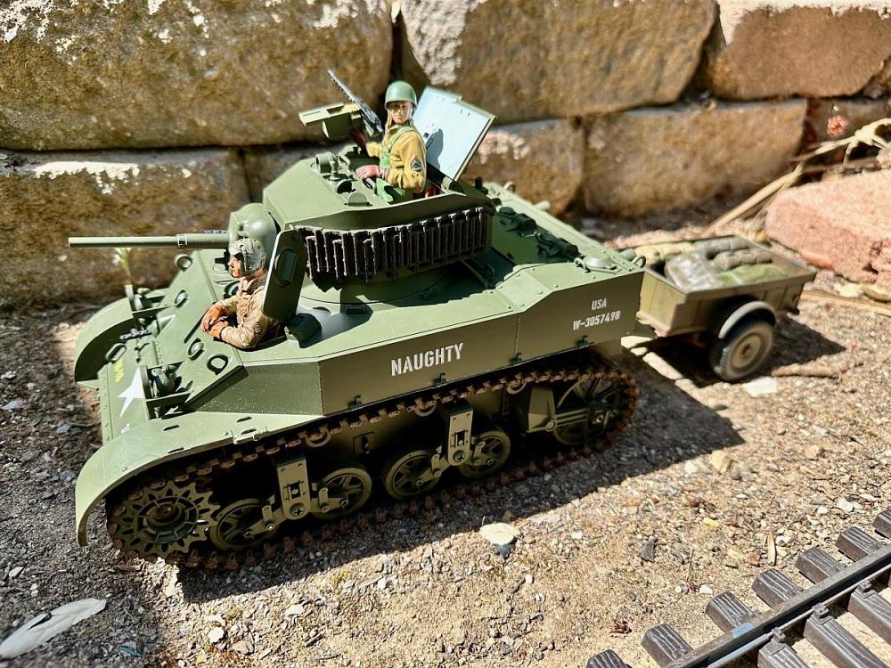

                      Well, everybody is doing it, so....
                      Click image for larger version  Name:	IMG_1226.jpg Views:	0 Size:	241.9 KB ID:	405976
                      I removed my skirts with a "dremel on steroids" a Ryobi rotary cutter. With a plastic cutting wheel and a sanding drum, it took all of 50 minutes, including some hand sanding at the end. Oh yeah, she looks naughty all right without her skirts!

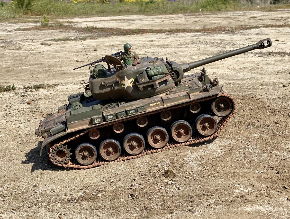

                            Keilau, the plastic on these tanks is much strongger than, say, a display model, and a lot thicker. Scoring with a blade will take forever. Is it worth removing the M26 skirts? You judge:

                              Holy cow that looks 10x better.

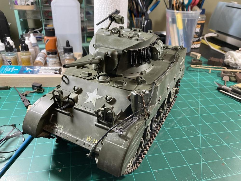

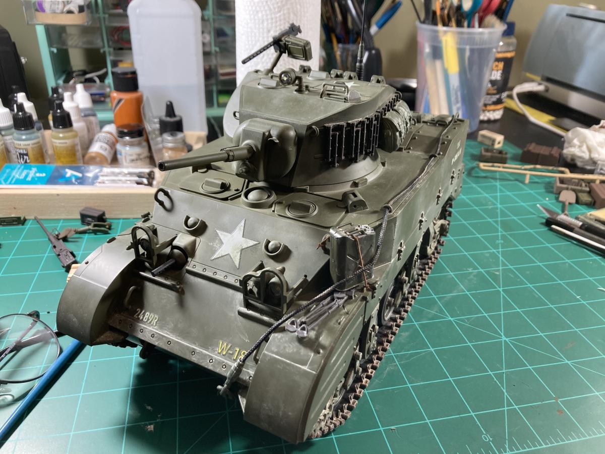

                                My Stuart is a fun evening project. I don't know if I have the nerve yet to get out the knife, though I agree it does look great without the skirts. Im debating whether to go full-on crates and junk or leave it simple.

                                  I like it!

                                    Well done with the details.

                                      The skirt less is so much better. You can see the cool track layout that makes the Stuart such a beautiful looking tank.
