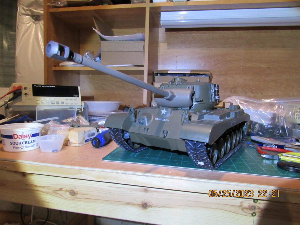

        Yes, I like the look of your Pershing without the skirt and want to do the same. No, I am not sure I am ready to do it after your comment. I treasure my 2005 HL Snow Leopard to Pershing RC tank with many upgrades and want to keep it look good for many years to come.
ID:	406022 Click image for larger version
ID:	406020 Click image for larger version
ID:	406019 Click image for larger version
        I have noticed that Heng Long use thicker and harder plastic than Tongde since I got the M60A1. It seems that the Stuart plastic is the same. I would like to hear from tank_me on using scoring on the Pershing or other HL tank before I try.
        I like the way that tank_me braced up his TD M60. I have been thinking about a easy way to copy him on the M60 but have not tried yet. Your work on RC tank upgrade gave me many inspiration too. It is fun.

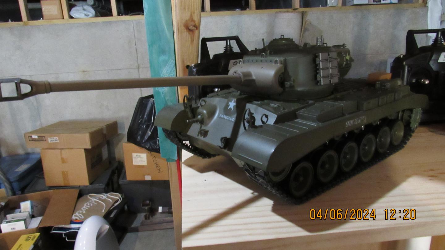

                  Believe it or not I happen to have a Pershing I'm considering cutting the skirts off of...
                  • keilau
                    • Mar 2021
                    • 1844
                    • Windy City
                    #29
                    It must be my lucky day. I do not remember reading how @SoCalBobS​ cut off the skirt from his Pershing. But I really love how his Pershing look and want to duplicate it. Your write-up will be a good guidance for me for sure. It might give me the courage to try it.
                    The Heng Long Pershing skirt plastic is too thick for the modeling plastic clipper. I bought the most expensive modeling plastic clipper that remains sharp after many years of use. But it has its limitation in cutting thickness. I consider using a thermal plastic cutter but decided against it.

                      I was planning on using a straight edge hobby saw, to cut off the skirts in a series of pieces, then sanding to refine the cuts.
                          You may need to remove the top of the tank from the chassis to use a saw.
