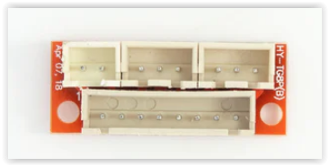

          MrChef, what is this daughterboard you speak of?

            That's the board inside the turret, which is then hooked up to the MFU, more a jumper block. It's strange that there were multiple units, but the description of the damages showed no difference.

                Correct. I got it from Taigen for $4.99 and a turret slip ring since Motion doesn't stock that stuff.

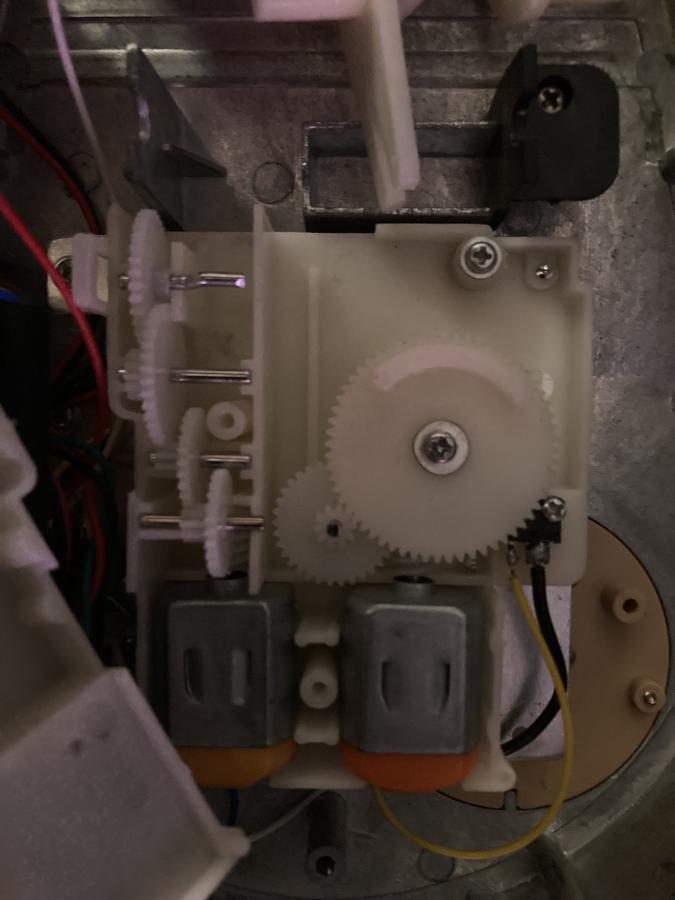

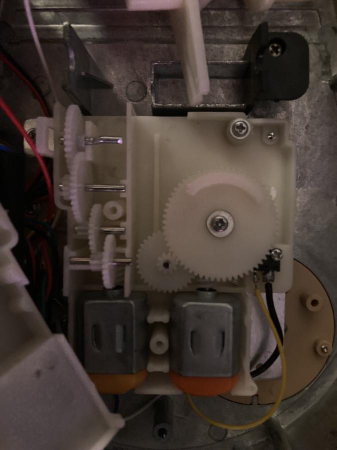

                                  Here is the inside of the barrel elevation/recoil unit Click image for larger version

                                    The bottom gear on the left was the culprit. The pin must have slid out and was probably hitting the gear for the recoil on the right. For some reason that pin is not captured like the other three and probably worked it's way loose during shipping and handling.
                                    There is also a pin for the smaller gear for the recoil. Mine stayed with the other half of the case when I separated them. These pins are a loose fit to the gears, so again, be careful when taking it apart.
                                    Do the operation on a good work table and don't be like me and do it sitting on a couch. I had a tough time finding the pin for the elevation gear
