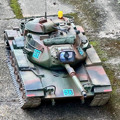

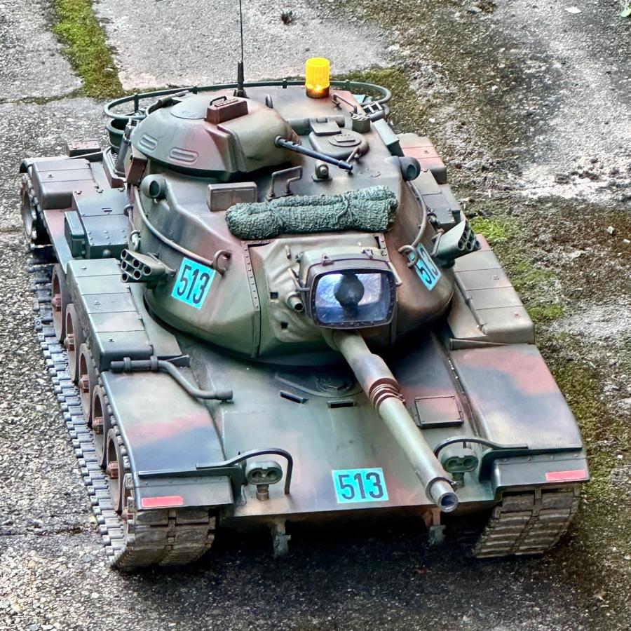

    Get some 6V LED's, 6mm, from Evan Designs online. If you change the MFU to a Heng Long, connect it to either the WiFi circuit (switchable on/off) or if you don't use smoke, the smoke motor circuit, also switchable. If you use the Tongde MFU, check and try whatever equivalent circuit they have. Some in their manual are listed but not actually live.
    In the case below, the searchlight is on the smoke circuit and the beacon is on the wifi circuit.
    Click image for larger version  Name:	M60A3 10.jpg Views:	0 Size:	198.0 KB ID:	408496
