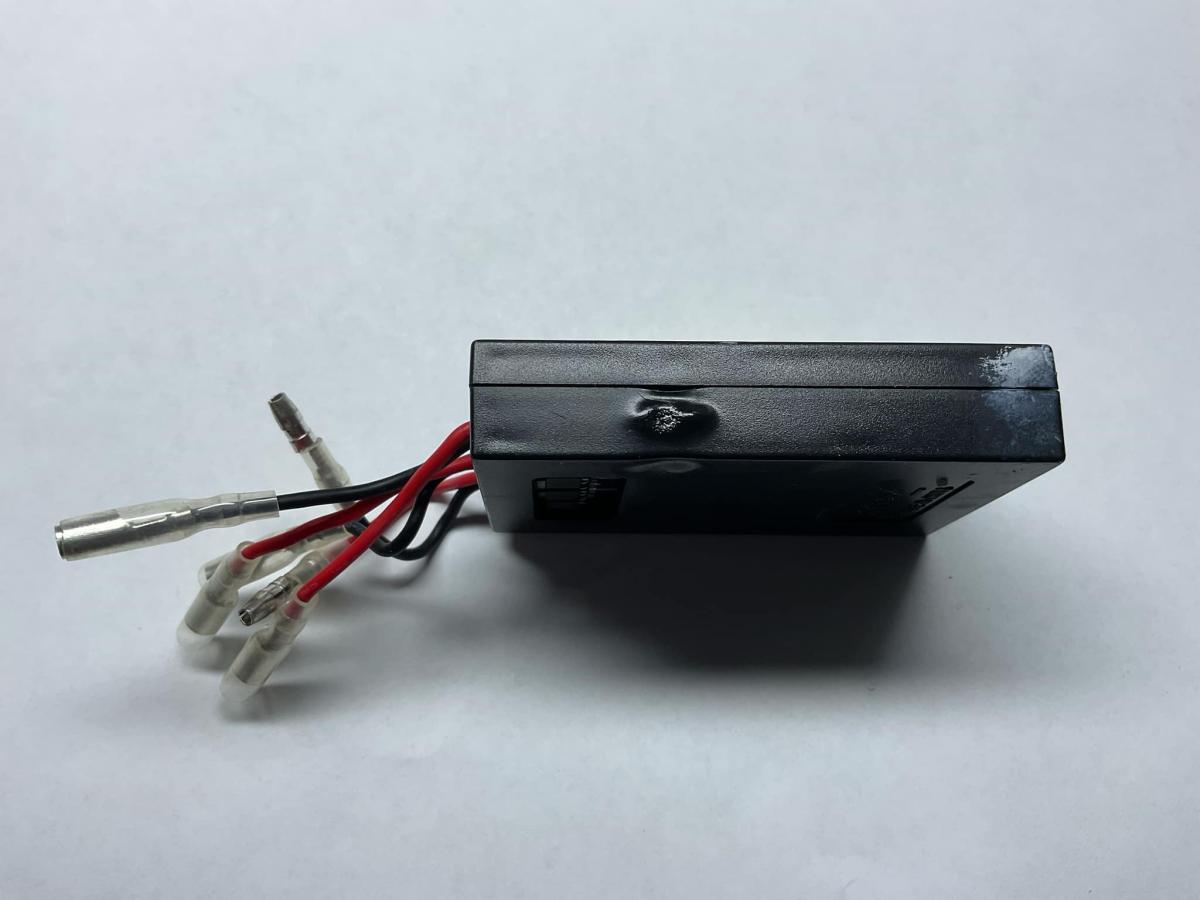

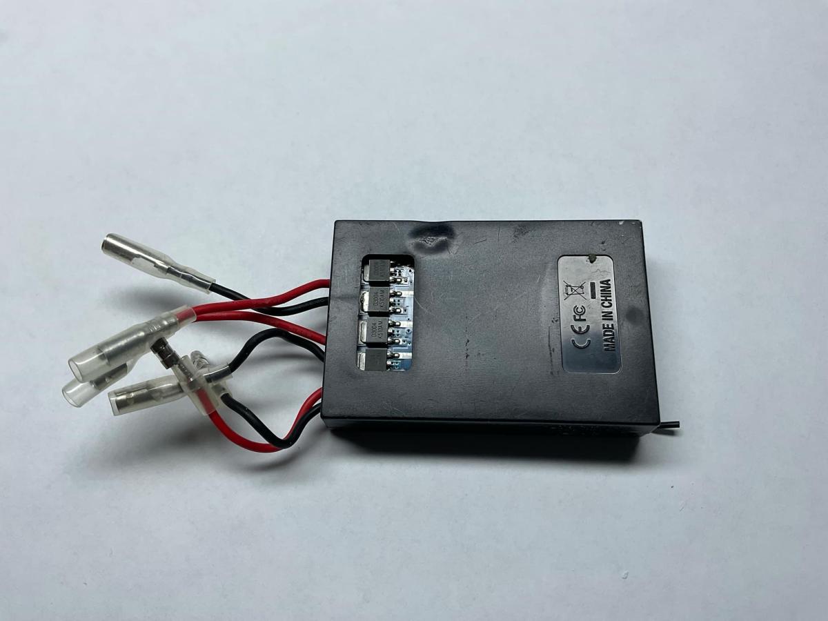

                What do you guys think the reason for the board to burn? I replaced with new 6.0s board. Is it safe to drive? Dai
                • RichJohnson
                  • 1276
                  They usually burn up from an internal or external short.
                  if external, any other board will either detect it and shut down if it’s downstream of protection circuits or it will burn up.
                  try the other 6.0 for a little. It and see if it run ok. The most common external short from the mfu on a tank is the turret motor wires. Following that is the smoker shorting out and then rarely a motor problem, but any of these would only smoke an mfu if you engaged them , like Turing the turret or turning on smoke.
                  if the mfu is smoking just being turned on, it’s internal, and it happens more than it should with 6.0s. 7.1 units are light years ahead, with metal cases too.

                    After I turn the tank on, it shuts down after one second. I kept turming it back on and on the third time the tank smokes heavily,. I then replaced with the new board and it ran fine although I only ran for 3 seconds fearing it will burn up again. How do turret wires cause a short in the MFU board? Shall I get new turret moitor? I already ordered two 7.0 boards. I wonder if there were any reports of tanks buring up with 6.0S board. You can see the flame/heat strong enough to melt the plastic casing! Dai

                          It was shutting down as it is designed to. This keeps it from melting down as it did. When you restarted it over and over it finally shorted out...and poof.

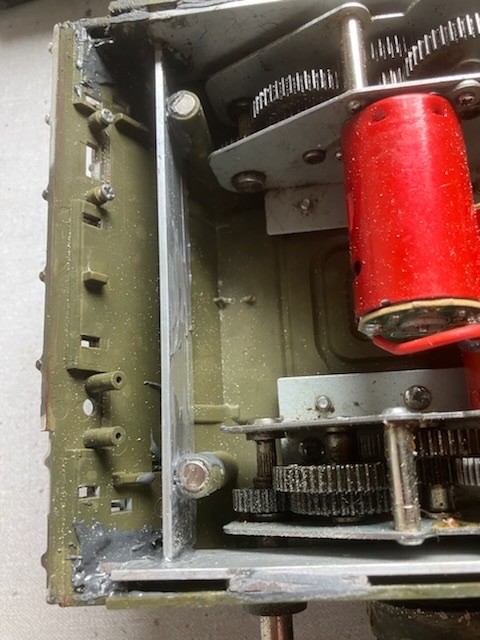

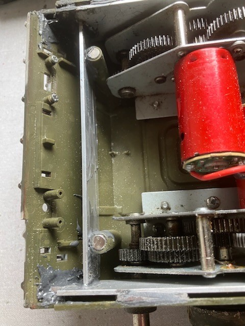

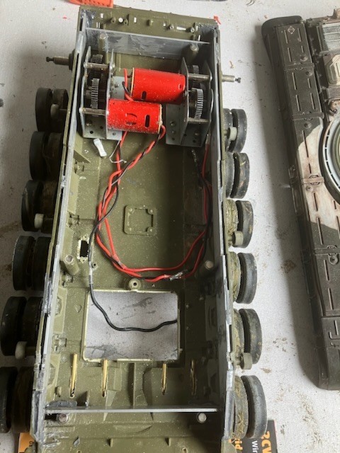

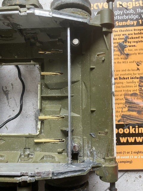

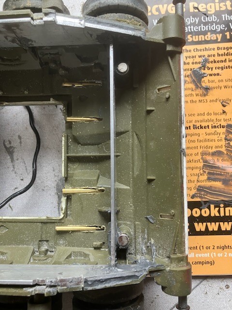

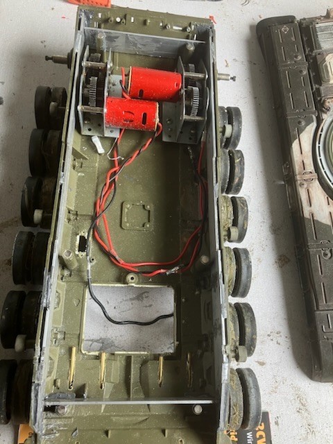

                              This is the internal bracing I did for my T72. Made from 25mm angle, and 25mm flat bar. Note that the upper hull is held on with magnets. Fixed in with 4mm bolts and JB Weld.

                                So you glue the bar via epoxy to prevent from spreading? Dai
                                • Meter Rat
                                  • 504
                                  • Argyll and Bute, Scotland
                                  #17
                                  Yes. All installed with JB Weld, a two part resin/epoxy type glue which can be filed, drilled, sanded and tapped to receive a thread. There are now four bolts holding the side pieces in place. I may look to further reinforce the front mounting where the idlers attach.

                                        Is it possible to see how you re-inforce this area? I do not have the machine to cut out the metal plates like Meter Rat. Dai
