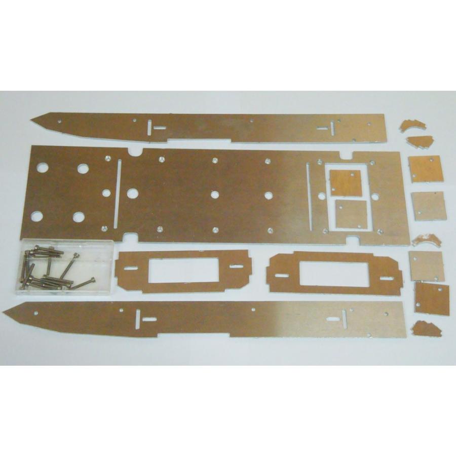

A while back, a model shop in Singapore marketed a reinforcement kit for the TD M60, but it is long out of production. You can use the pictures below to cut your reinforcement pieces in plastic. Let's face it, Heng Long and Tongde RTR tanks are inexpensive toys, but a good platform for mechanical upgrade. The real fun is the buildup project. Besides Tamiya, a few manufacturer in China make expensive 1/16 scale RTR metal tanks. If interested, search for Matomark, Hooben, Taigen, Torro on the net.

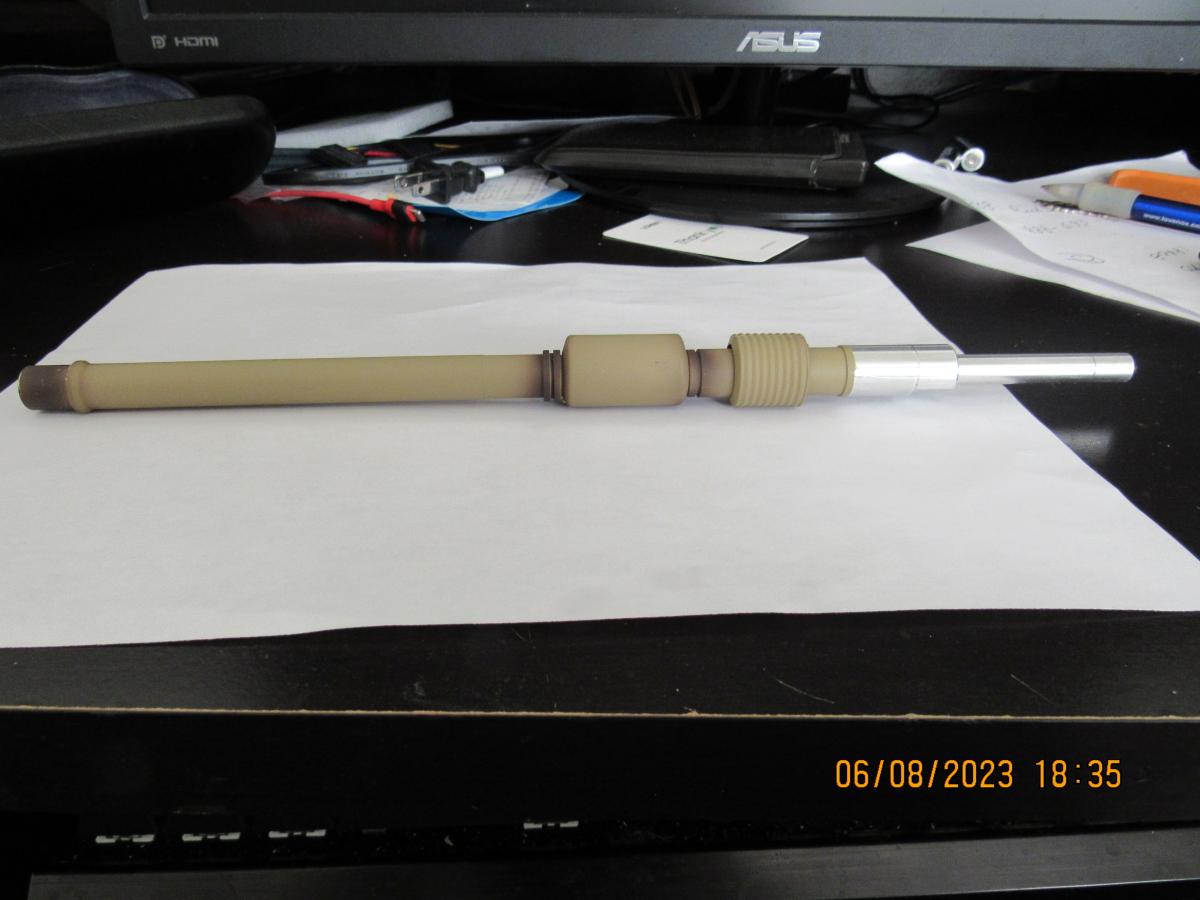

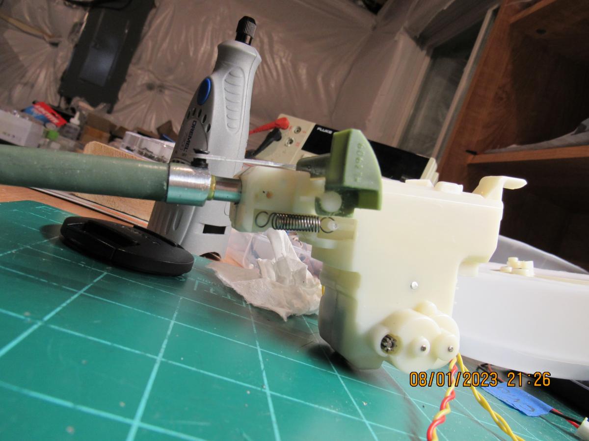

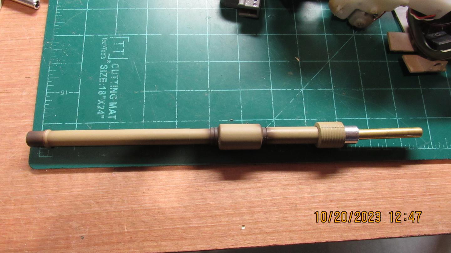

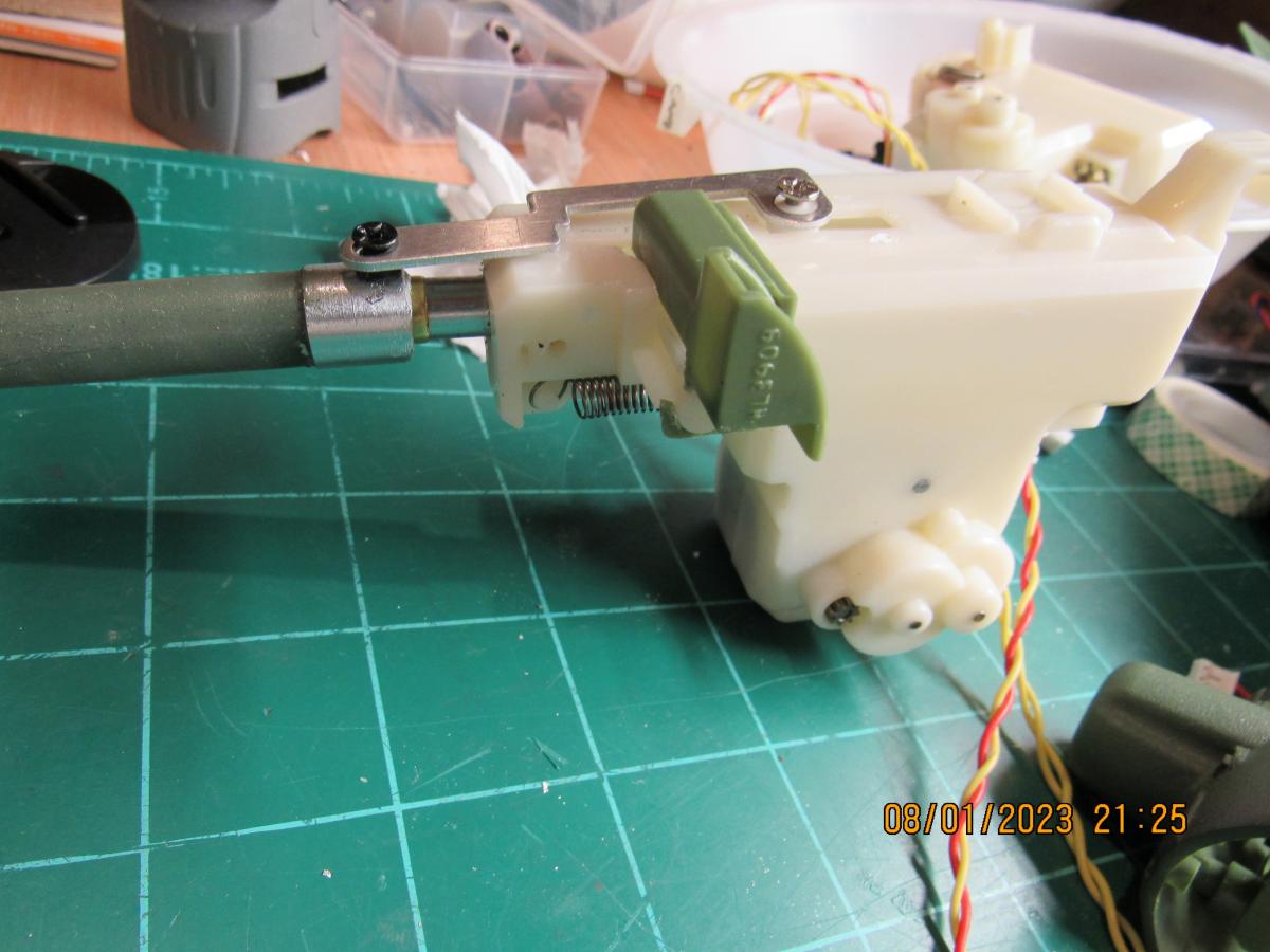

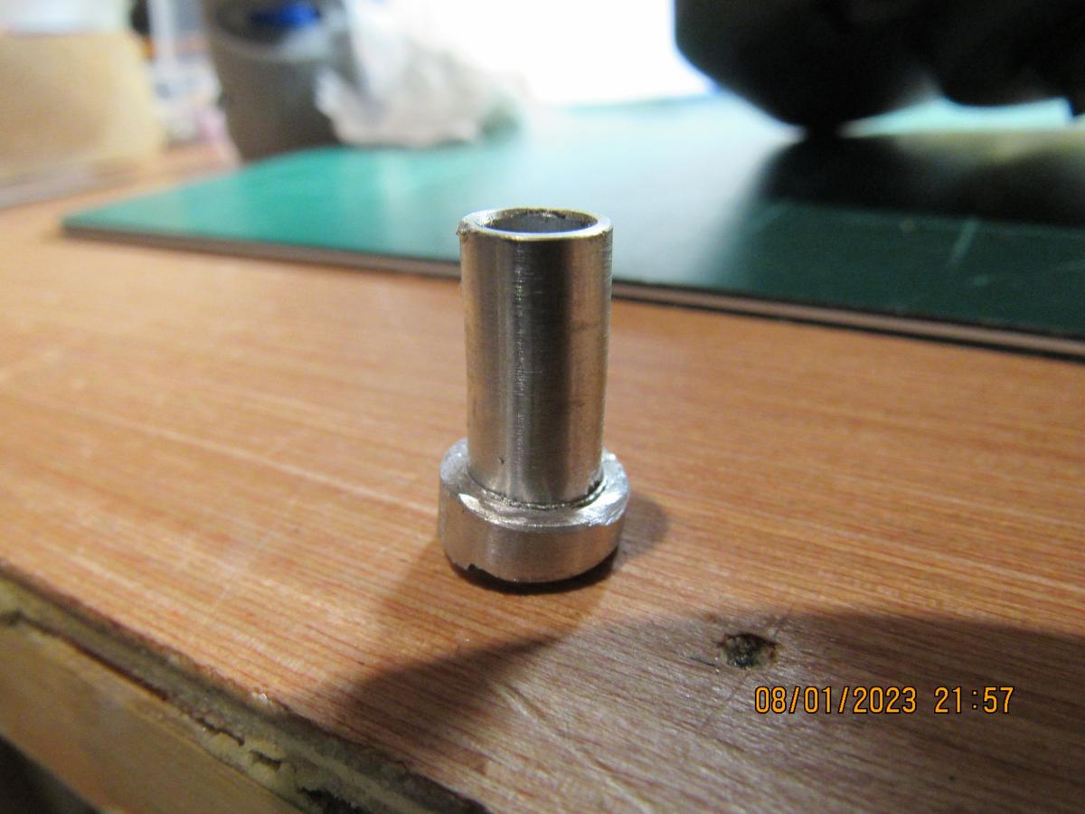

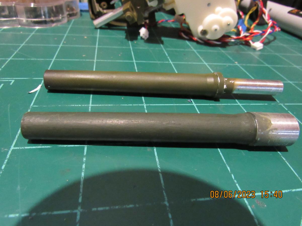

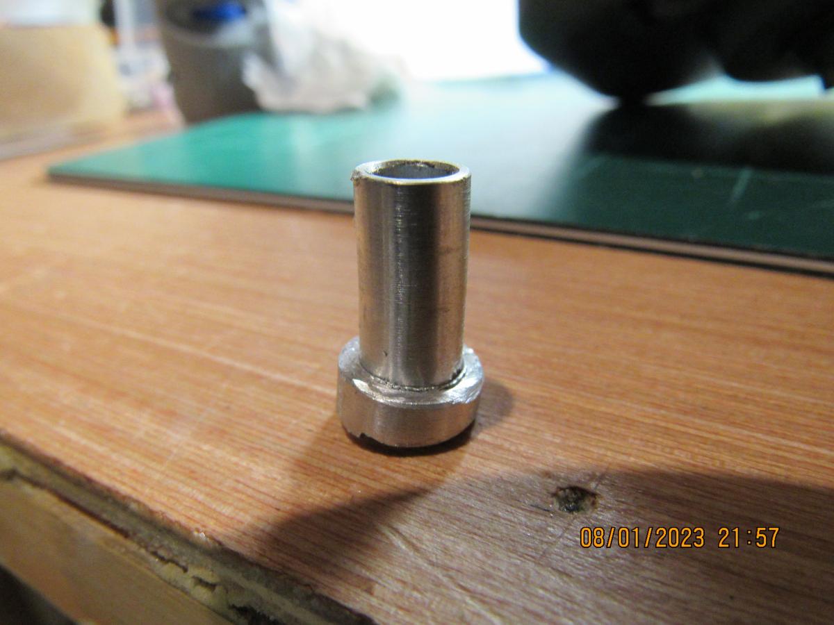

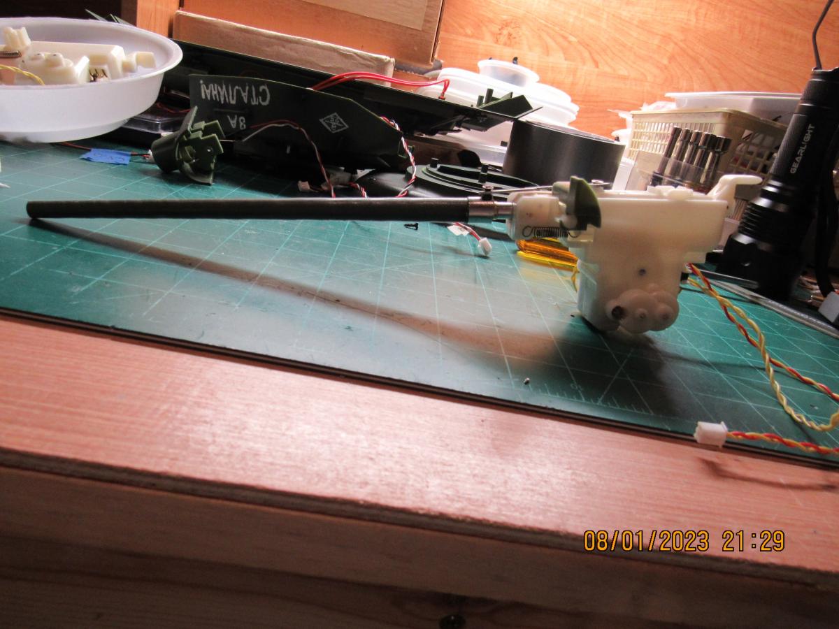

For many years, I had 2 Dremel tools. The AC Dremel tool runs at up to 15000rpm. It is powerful, but vibrates too much to hold steady for modeling job. I got a Dremel pet nail grooming kit for modeling job, but they do not last. 2 years ago, I found some made-in-China rechargeable rotary tools. I got a 4volt one for plastic and an 8volt one for metal, both together for less than half the price of a Dremel. They are now essential to my RC tank project. One recent project is to modify the M60 barrel. I cut off the thick aluminum end section and replaced it with a thin wall brass tube to facilitate barrel recoil. The TD barrel is still way oversized, but it can recoil.

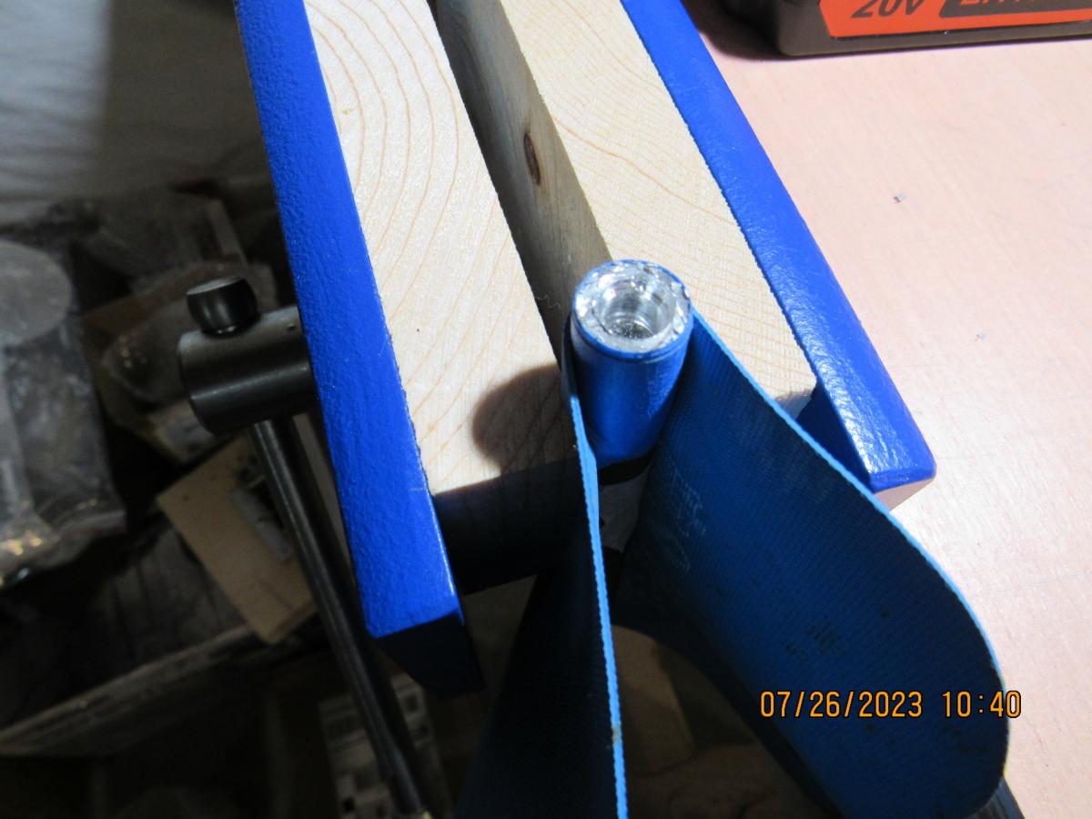

I have done the same process to HL T-34/85 and Sherman successfully. The $20 8V rotary tool is powerful. I clamp down the part to be cut securely on an attached vise for cutting.

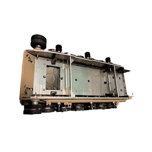

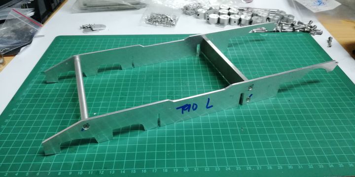

dai phan. You could just purchase a ready made kit.

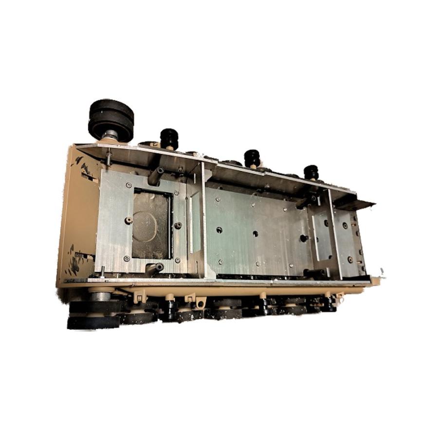

https://www.rctanklegion.com/products/rc-tank-legion-t90-lower-hull-stiffening-aluminium-brace-kit-1Our very own developed product for the HL T90! Made from precision laser-cut and machined aluminium, this is the hull stiffening aluminium brace (HSAB) kit for the T90 and this makes a world of a difference when your lower hull is stiff and stronger
I already bought that kit but was advised from another member years ago that will not solve the issue of cracking in the front hull. Daikeilau. Thank you for the link to the rotary tools. I may invest in one, one day. For now, I am happy using hand tools.
