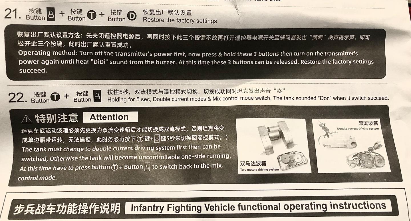

I intend to use a HL dual current system on the TD M60A1. Without a manual, the connection is an easy part. How to change the setting on the transmitter to enable the "dual current" gearbox is another matter since the my early version TD manual did not mention the dual current system.Originally posted by tank_me View PostI wouldn't complain either as the metal one is much more expensive than the plastic one... :) The big 550 motor should be M1. The smaller motor should be connected to M2. M1 is responsible for the track movement. M2 is responsible for turning. You do have to change the setting on the transmitter to enable the "dual current" gearbox. Dual current is a poor translation for dual differential as far as I can tell. I haven't really seen any definitive install docs. I haven't searched YouTube as I've installed a half-dozen of these at this point so I don't really need a manual.
Are you using a henglong 7 series or TongDe 3 series control system?Originally posted by keilau View Post

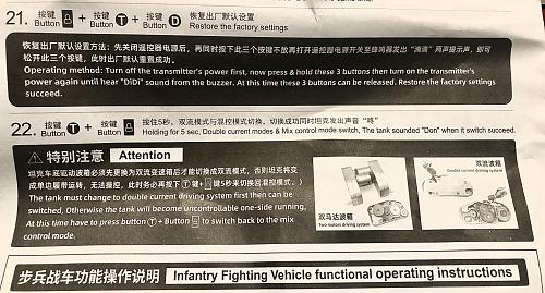

I don't run any TD 3 series systems so I can't say how well it will work compared to the HL 7 series when used with a dual current drive. But I still have the manuals so her is the section you need from the TD manual.
From the TD version 3 manual.
You sent me exactly what I am looking for. I have only the TD 2 series radio which may or may not support dual current. But I also upgrade to the TD servo barrel recoil. I have only surplus TK70 MFU which does not have servo input. If the TD 2 series radio does not support dual current, I will have to purchase another TK71,Originally posted by Rubicon99 View Post
Since dual current drive system has been around more than 7 years and HL supports it since TK60, all TD radio should have supported it. But it is Tongde whose management is very short sighted.

The TD 2.0 most likely does support it. The biggest changes in the 2 vs 3 was in driving dynamics.Originally posted by keilau View PostYou sent me exactly what I am looking for. I have only the TD 2 series radio which may or may not support dual current. But I also upgrade to the TD servo barrel recoil. I have only surplus TK70 MFU which does not have servo input. If the TD 2 series radio does not support dual current, I will have to purchase another TK71,
