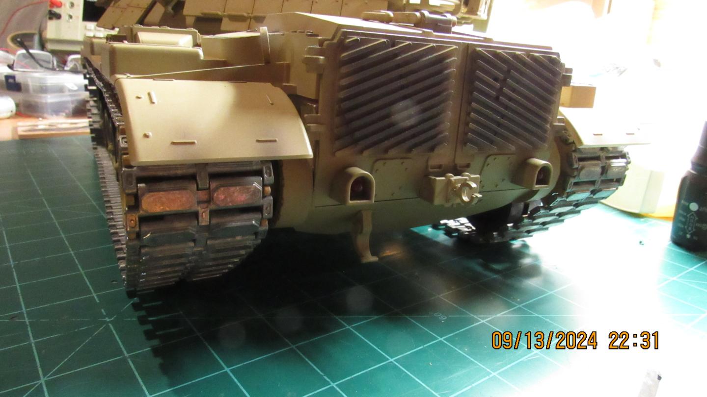

    My left hand neighbor and I both have 1/3 arca lots. The builder made our open space adjacent to each other creating a good space for tank running. The lawn has fairly uneven terrain. The lawn is well manicured and kept to 2" high. The lawn is too slippery for tank battle or sharp turning of the tank, but ideal for buggy type running. M60 with 380 motor with TD plastic track drives well on hard packed dirt road of RC tank battlefield. 390 motor with TD metal track drives well on slightly soft and slippery grass lawn.

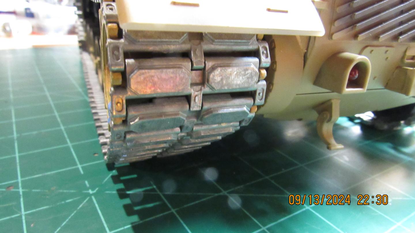

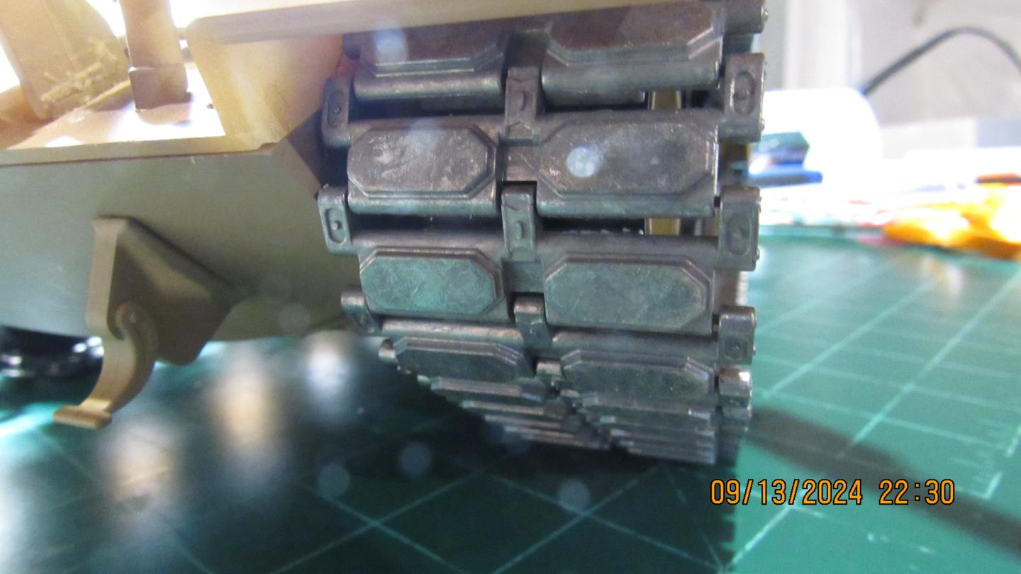

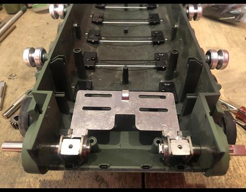

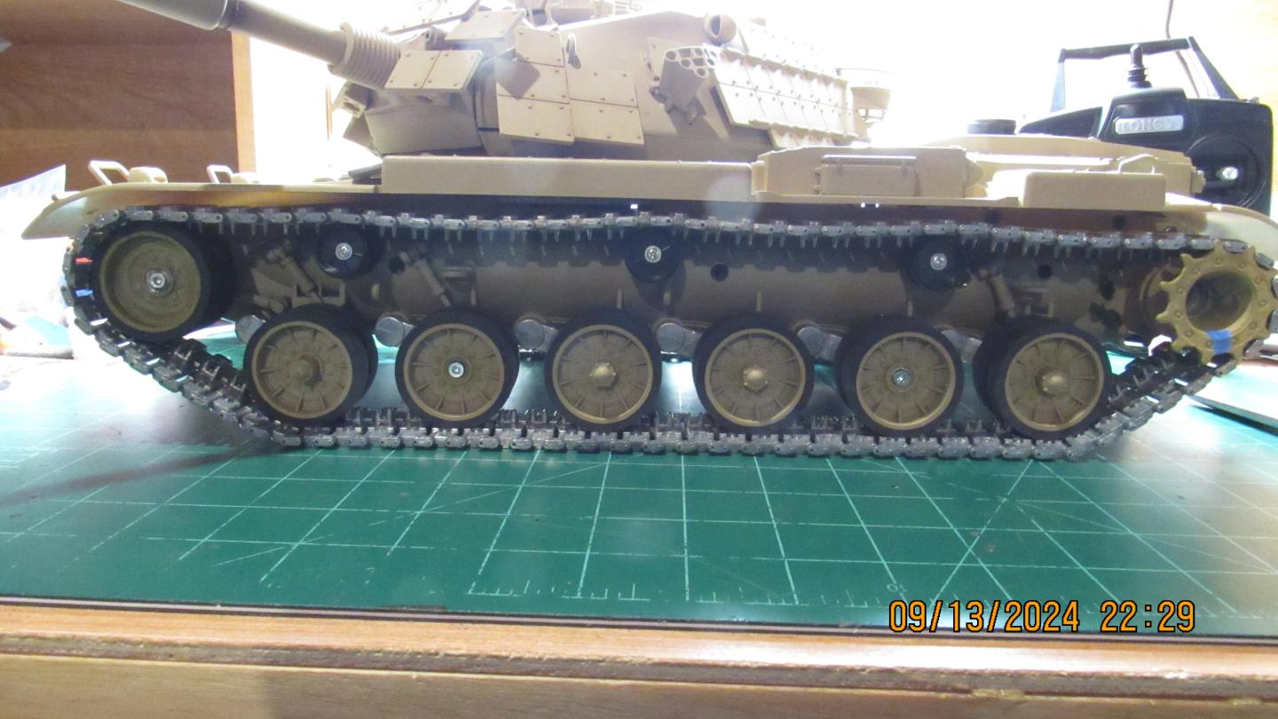

    The 390 motor and metal track upgrade works very well on grass lawn. The TD metal track feels much heavier than similar HL metal track because of its all solid construction (no hollowed out back side). The upgraded M60A1 weights 11# 2.4oz. It is the heaviest tank in my collection. Despite its weight, the torsion bar suspension works well as is too. It is most important that the M60 levels evenly and it does.

    More detail of my upgrade can be found in my M60 metal upgrade posts.

    Originally posted by MaverickTank
    I drive my M60 on dirt, concrete, and grass. The metal tracks were far too heavy and dug into the grass badly. They also put an undue strain on the drivetrain and suspension. (When I state grass, I mean grass that is 3" tall and full of weeds)
    In my opinion, you are better off with the plastic tracks. I was enjoying driving my M60 around the yard yesterday evening. With the plastic tracks, the tank performs better in grass than any of my other tank models, with no sign of binding or riding up the cog teeth or idlers.
    After a year of driving the Tongde M60A1 on metal tracks, I finally comprehended the warning and advice from MaverickTank. But it is not until after I burnt 2 390 motors and 3 sets of HL TK motherboards.
    It took several months of testing for me to figure out a hypothesis on the failure mechanism. The Tongde Metal tracks, at over 4 pounds is too heavy for the 390 motors running at 25000 rpm. It runs beautifully in my backyard lawn, After extended run (~20 minutes or more), the 390 motor overheat and jam. It caused the motherboard to send a huge stalled current to the motor which burnt both the motor and the motherboard. It happened to one side of the tank first and the other side would continue to run.
    I removed the Tongde metal tracks and put back the TD plastic tracks. I kept the 390 motors because it do not overheat with the plastic tracks. I prefer the 390 motor with plastic track over 380 motor with metal track. ​
    I am contradicting myself of the original thread title. On the Tongde M60, the 390 motor and TD metal track is a disastrous combo.

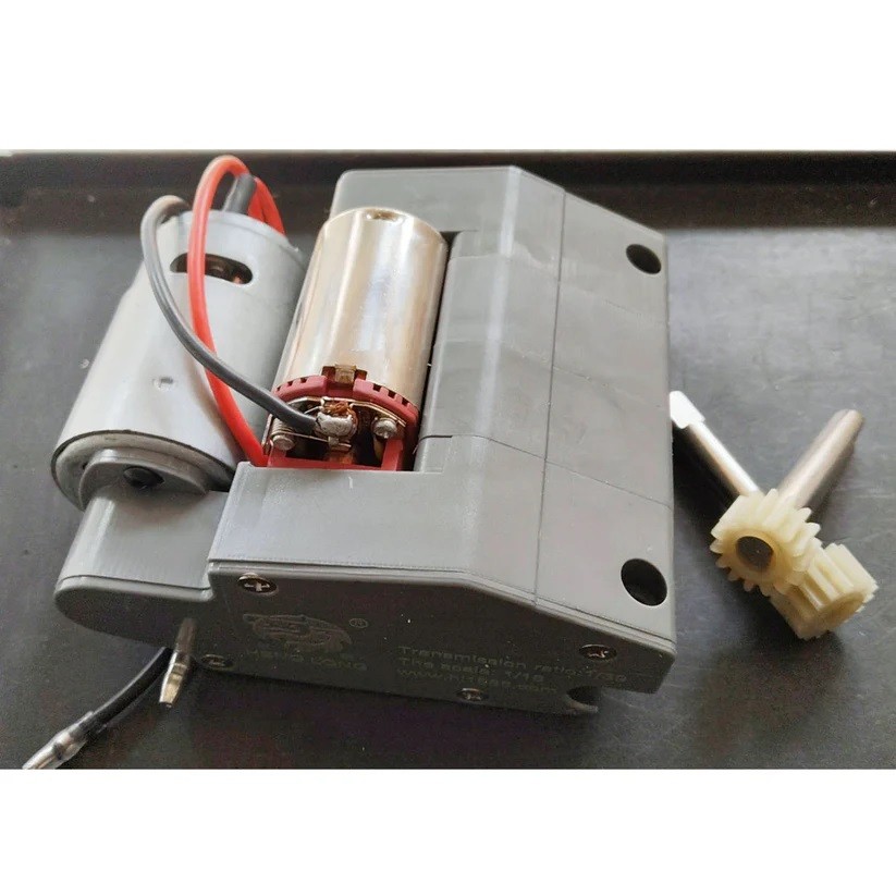

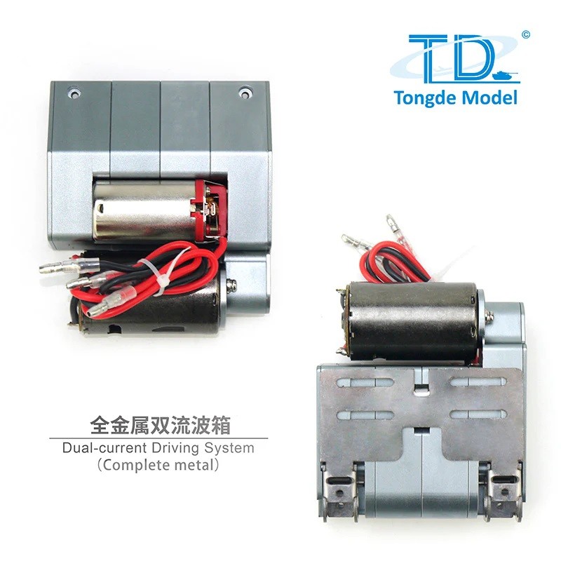

            Does anyone have any technical information on this expensive "Dual-current Driving System for Tongde 1/16 M60A3 M60A1 M60W RC Tanks" and how well it works with the TD metal tracks?
            There are many sellers of this dual-current gearbox on ebay, but no one gives any meaningful information.
              Click image for larger version  Name:	Dual-current Driving System.jpg Views:	0 Size:	95.9 KB ID:	439982

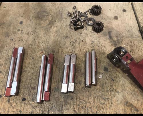

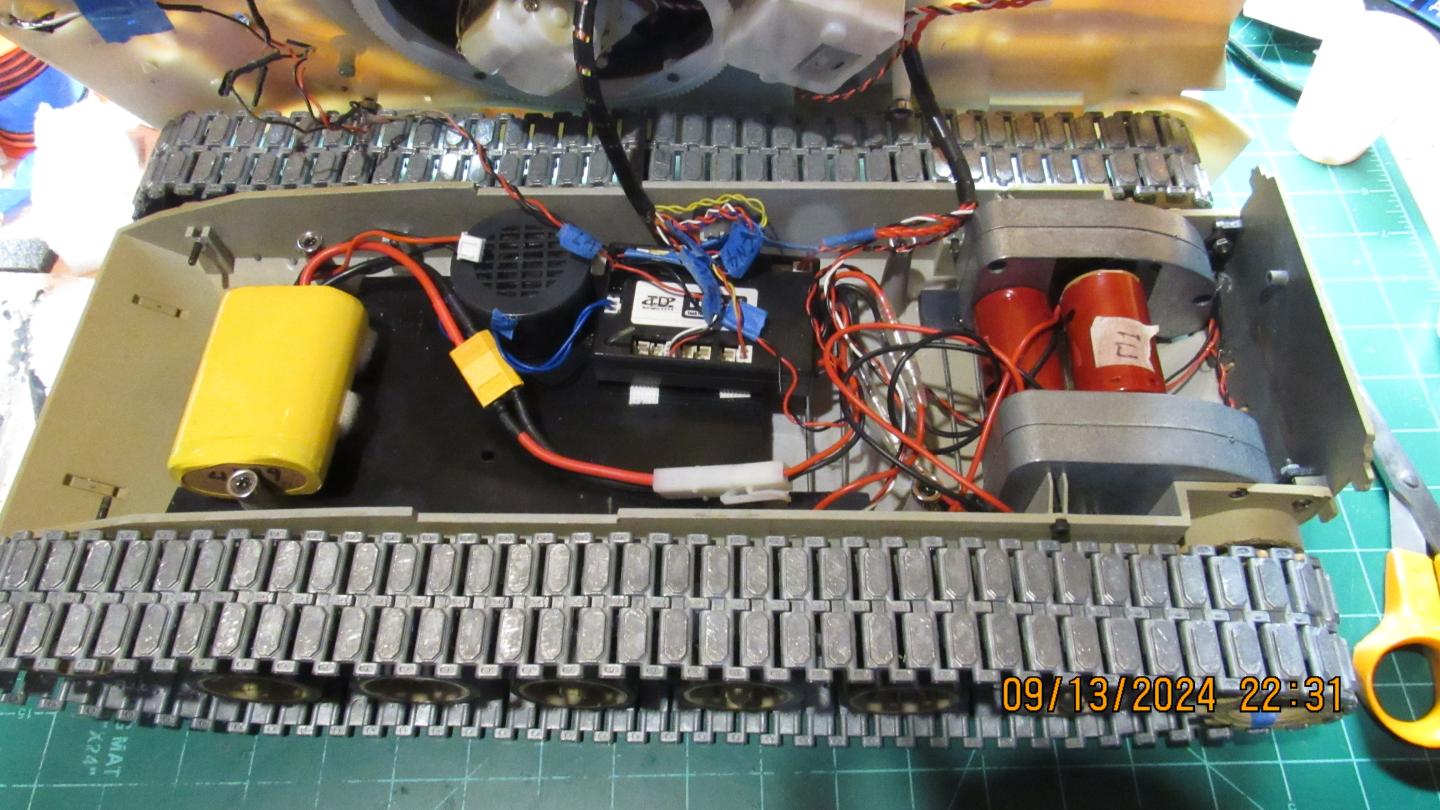

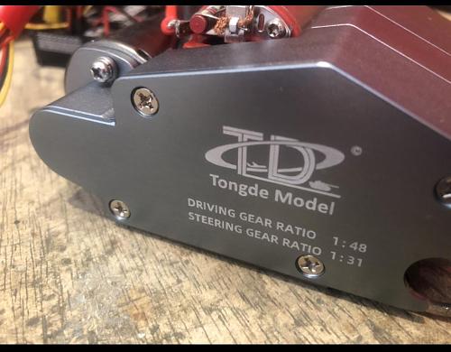

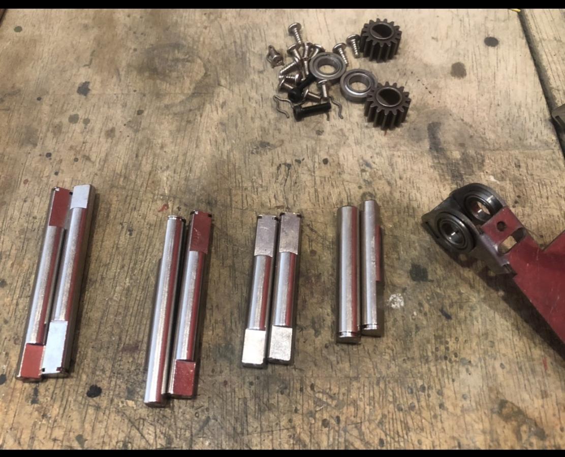

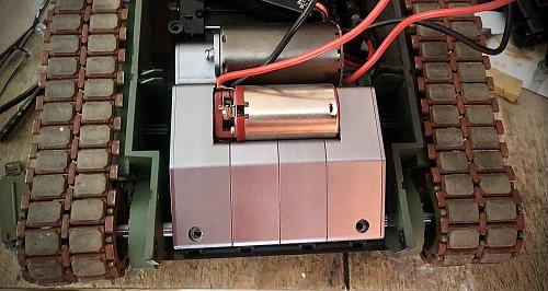

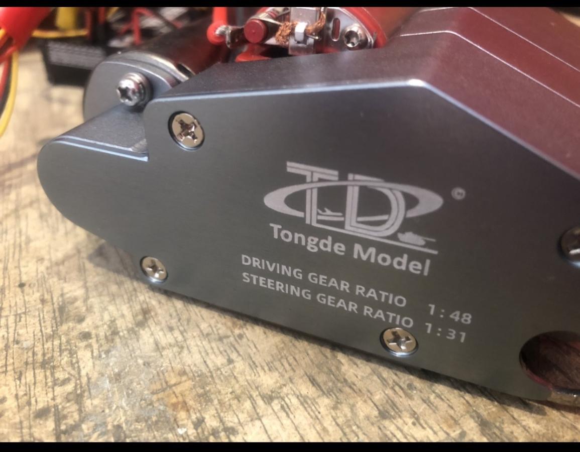

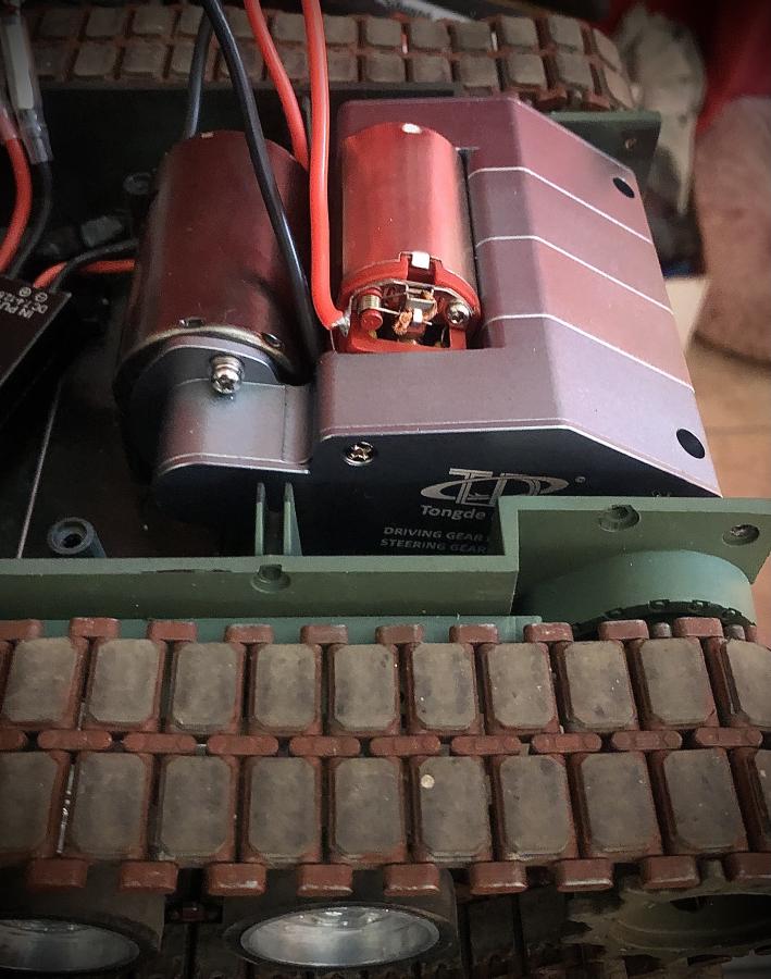

              Been running one of the TD (48:1)DCD and one from DKLM (36:1) in two of my M60s for well over a year now. Those are the ones with the Tamiya tracks.
              Neither is a direct drop in you will have to make it fit which is easier than it sounds. In fact it is ridiculously easy if you can be open minded and not go down a rabbit hole trying to make it complicated. It also requires no permanent modifications to the tank and is easily reversible.
              Performance of the TD CDC is excellent and driving dynamics are smooth and predictable. It's not as fast as the stock motors (at 7.2-8.4v) and nowhere as fast as your M60 with 390 motors, but the CDC uses a 540 motors coupled with its low gear ratio which provides the M60 with nearly unstoppable torque. Now IF you use the higher voltage LiPoly in the 11.1 range then you will see top speeds similar to what have now.
              I run my TD CDC at ~7.2-8.4v and this is near perfect for everything except making speed dashes across large open areas during an IR battle.
              This is the with the TD CDC. There are a bunch of videos of it running on my Instagram @ Fsttanks

                  • Windy City
                  Heng Long market 3 versions of the dual-current drive system which look very similar to the Tongde one. The versions are plastic gear in plastic case, steel gear in plastic case and steel gear in metal case. The HL steel gear in plastic case version is half the price of the TD. I am very tempted, but need information on the configuration and length of motor drive axle.
                  • Rubicon99
                    • 3316
                    The two companies use very different internal set ups. TD uses 100% steel gears and HL uses a combination of drive belts and steel gears. The HL has a spotty reputation for reliability something I can attest to with the two I owned prior.
                    The TD is a very high quality transmission in fact it seems even higher quality than the CDC I have from DKLM. Yes the TD is expensive but for good reasons.

                      • 1197

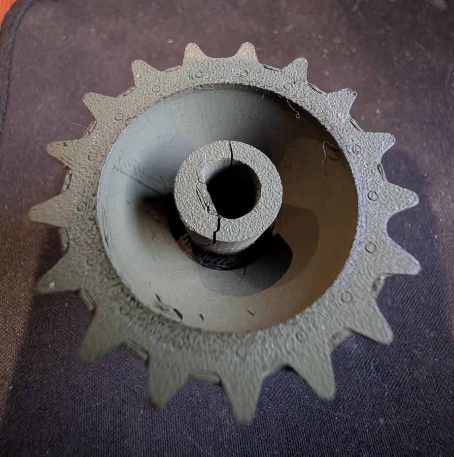

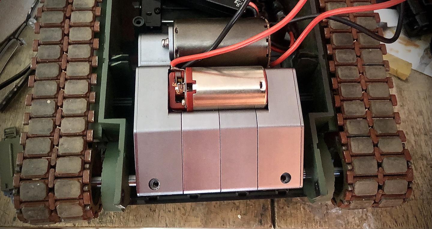

                      I have the Heng Long plastic version (which I heard nothing but bad things about) installed in my 3D printed Kranvagn. I paid around $65 for it and had very low expectations. The Kranvagn isn't extremely light, but it is light for it's size. The tracks are long and about the width of a King Tiger, but they are made from a semi-flexible resin. The plastic gearbox has performed flawlessly so far, but I also added bearings in the plastic Kranvagn hull as close to the sprocket as possible to provide extra support for the drive shafts. Everyone comments how smooth the Kranvagn runs when I bring it out to battle. I actually cracked the hub of a sprocket before having any issues with the transmission. I actually glued the hub back together with MEK and filled the area around it with a hard two part epoxy resin which ensures the hub is fully supported now.

                          Just keep in mind this tank isn't all that heavy and it's basically on plastic tracks, but I don't baby it. I've run it around the field at full speed quite a bit.

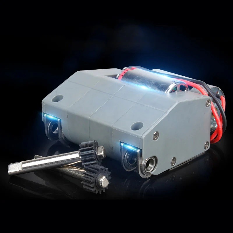

                              The dual currency system gearbox arrived today with no instructions. The old video posted by tank_me is my only guide.
                              Since we were hijacking the T34 thread I moved this discussion to this thread. That is called the "Dual Current" gearbox in the 6.x and 7.x manual. They have been around for a few years now starting with DKLM offering them as the PDSGB (Propulsion Dynamics Gear Box), but the PDSGB version went unavailable for a
                              I have no prior experience with pdsgb gearbox. I will work slowly and delibrately. When I open the package, the gearbox feels very heavy. I ordered the all plastic version, but the case looks metallic.

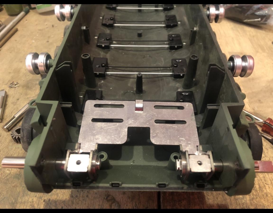

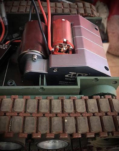

                                  #17
                                  Originally posted by tank_me
                                  If the case is metallic, it has metal gears. The only one that has plastic gears is the one with the plastic outer shell. If the gears that slide over the outdrives are metal, then all the gears are metal. The plastic version has off white colored nylon gears on the outdrive shafts.
                                  Yes, the gears that slide over the outdrives are black in color, not the white colored nylon gears that I expect. And the whole gearbox is heavy. I have not find time to open the case yet.

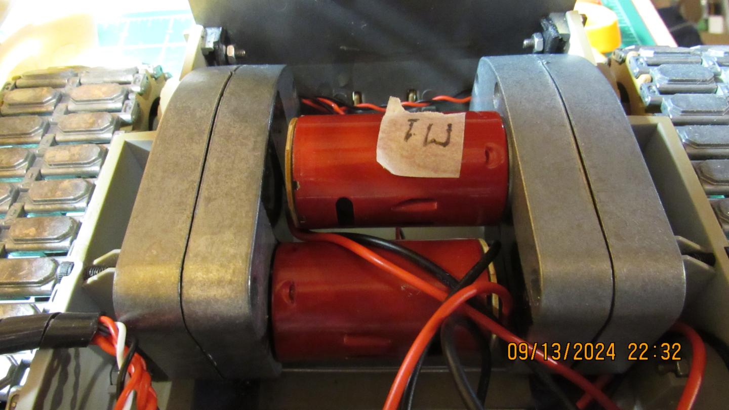

                                  I expect picture #1 Click image for larger version
ID:	441103 and got picture #2 instead Click image for larger version
ID:	441102 I am very happy, not complaining.
                                  Did DKLMRC publish an instruction for their pdsgb gearbox?
