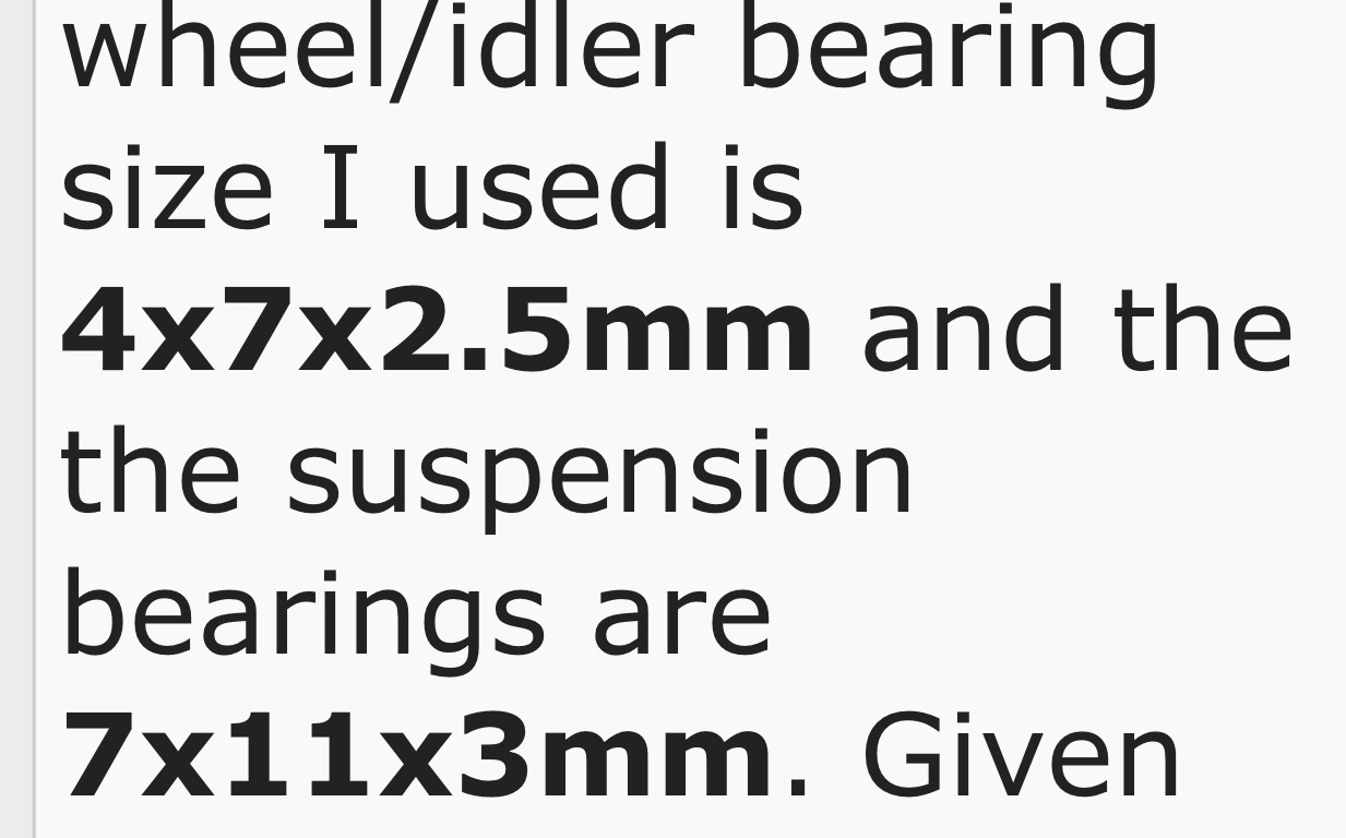

          I have been considering the ball bearing for the road wheels. With 4 bearings per road wheel, it is quite expensive. I have been carefully evaluating the dimension. I think that 7mmx4mmx2.5mm for the axle and 11mmx7mmx3mm for the torsion arm are the cloest fit. Can you confirm that?

                The bearing sizes I used. This is on my review posted on RCUniverse.com. I got the bearings through Amazon. They were shipped fast but not cheap given the numbers needed. The cost is one reason I recommend just going straight to the "metal" optioned tank.

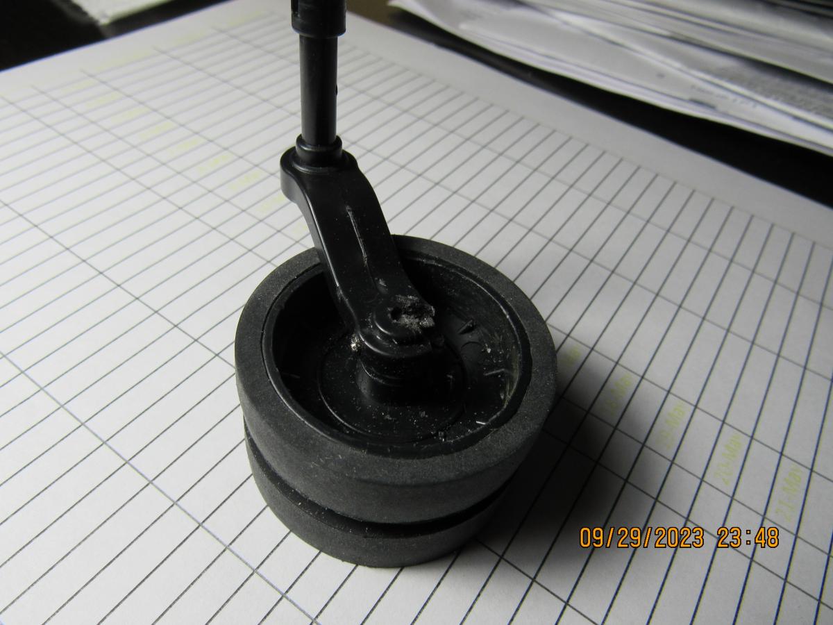

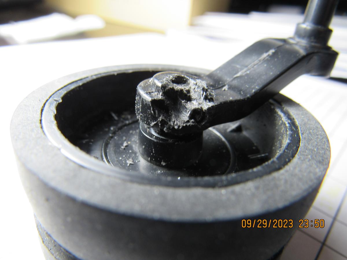

                      I am making some progress assembling the metal swing arms. The thread on the axle pin is a M3 thread, but it was machined so roughly that I kept measuring its major diameter as 3.6 to 3.7mm. I took a 400 grid sand paper to clean the threads on the axle pin carefully, I finally mic a consistent major diameter of 3.30mm, the standard diameter of a M3 screw. It is very important to use extra fine grid sand paper so that you only clean up the roughness of the screw without removing material from the thread.
                      After determining the screw size, I re-tap the hole on the arm to smooth out the thread. But the screw still would not go onto the arm smoothly. Close examination reveal that the screwtip has a concave shape. After I grinded off the sharp edge on the screwtip, the pin goes in smoothly and at a perpendicular angle.

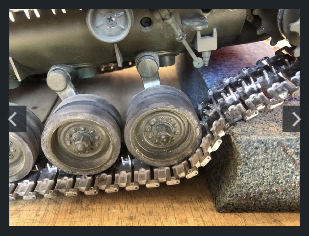

                                    Why RichJohnson and myself recommended ordering the "metal" edition from the start. It's a lot of time and expensive to add the upgrades later.
                                    Before you re-assemble the #5 & 6 suspension arms (on both sides of the tank) back onto the hull consider also adding "down travel" stops to ensure you do not have a situation that causes those arms to over rotate down and forward causing them damage to the torsion bars and associates components.

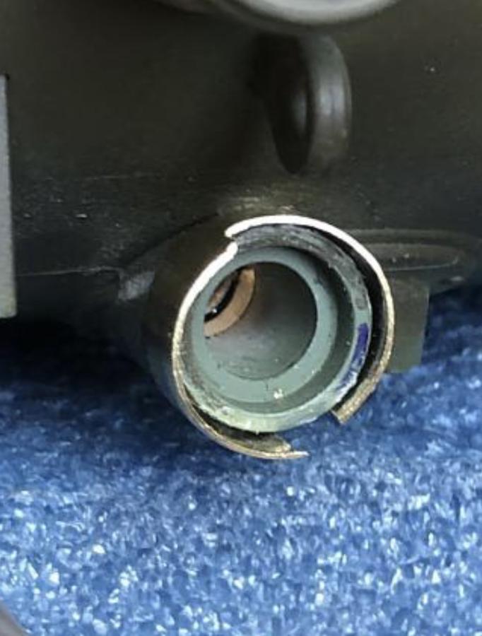

                                      Do you mind to show me the design of your "down travel" stopper? Thank you in advance.

                                        I made a simple brass ring that slips over the hull extension as shown. It is held in place with epoxy resin (not yet addded in this photo).
                                        Click image for larger version  Name:	B9C1AFE7-420F-441A-800A-5998F2FCE877.jpg Views:	0 Size:	59.5 KB ID:	387649
                                        Note: the open section on the bottom of the brass ring actually goes at the top. This was a photo taken of the opposite side ring as a basic illustration.
                                        Click image for larger version  Name:	47ED2B0C-5C4E-443E-958C-A125F3BE7D0A.jpg Views:	0 Size:	138.4 KB ID:	387650Adding the travel stop ring prevents this from happening. If I had backed up any further I would have broken a few internal parts.
                                        Click image for larger version  Name:	841CE40E-5BC3-407F-8760-DBEA83ABEA82.jpg Views:	0 Size:	154.0 KB ID:	387652
