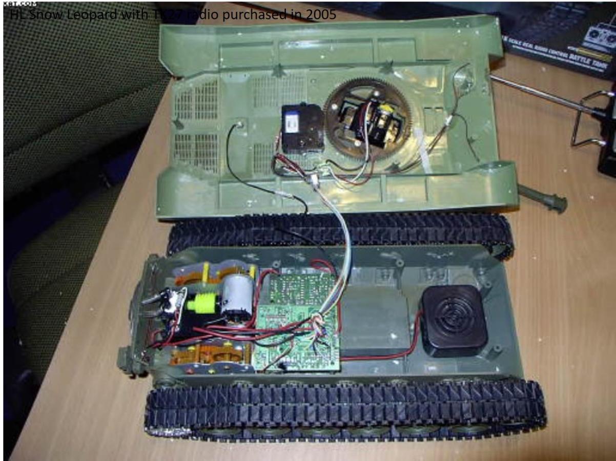

          mdz , Your older radio is likely a HL TK27 system from the pre 2.4GHz era. It may look like my 2005 HL Snow Leopard (Pershing):
          Click image for larger version  Name:	HLpershing_TK27inside.jpg Views:	0 Size:	131.7 KB ID:	415562
          You can get the HL TK7.0 MFU at $40 ($62 with transmitter) or even cheaper. Its driving quality is far superior to the TK5.3. There is no reason to keep the older radio. (The TK6.0 MFU works well too and pairs with only 6.0 transmitter. It is out of production now.)

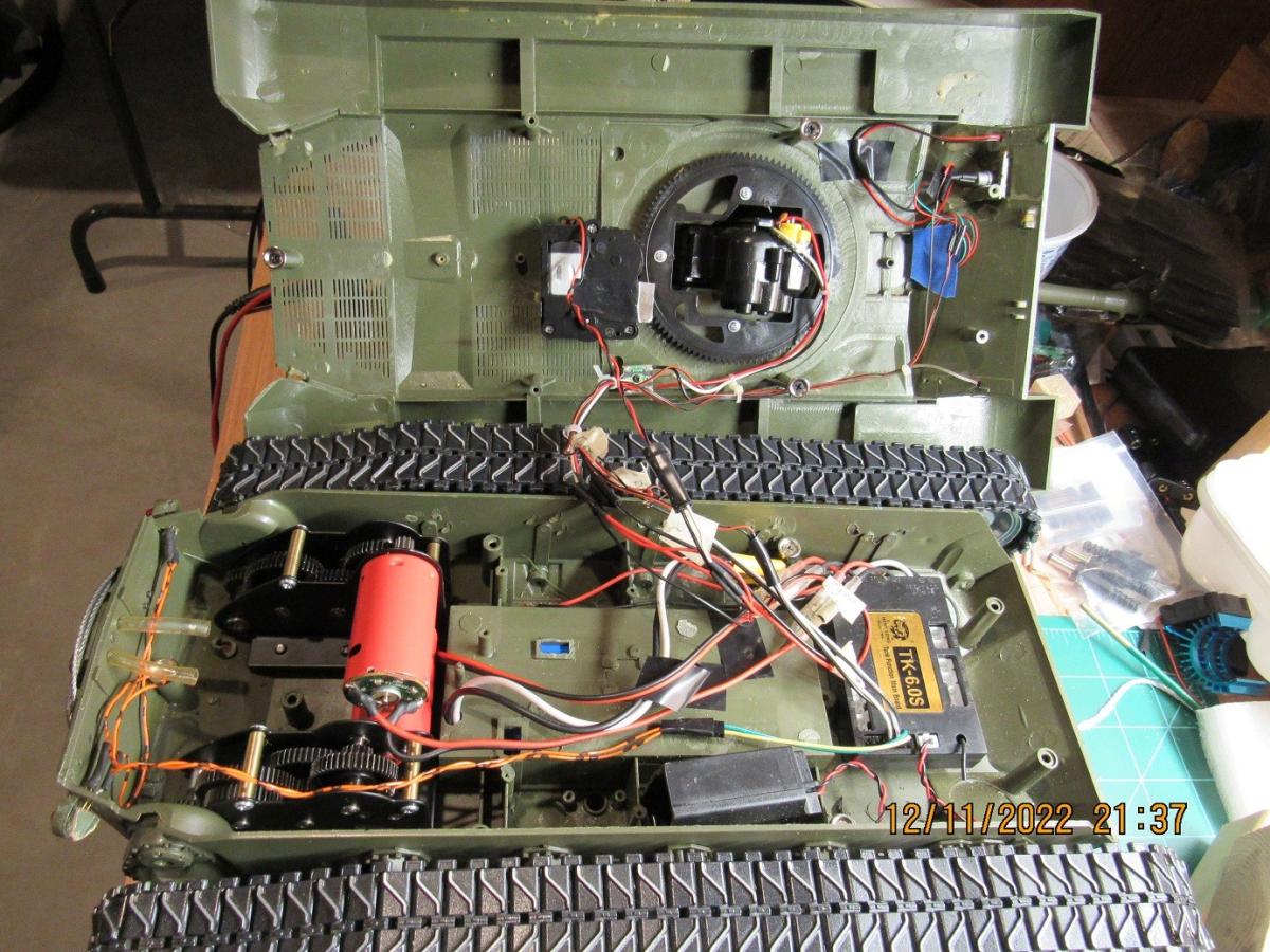

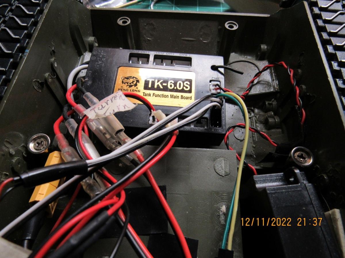

            Thank you very much for the help and explanation. I’m a newbe but I’m learning (albeit slowly). I kind of figured the direction to go is to replace the multifunction board as you suggested. But I have one tank with a 6.0 board in it but it will not sync when I try to power it up, any suggestions? Also, in the one photo there is a blue circuit board, what is that? Do You mind if I pick your brain about questions I have? Thank you for your help. ​ ​ ​

              It sounds like your 6.0 may not be bound. Watch the video to find out how to do it.

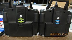

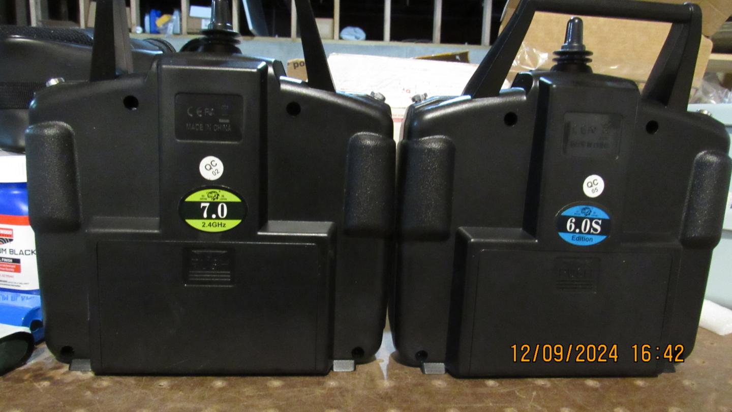

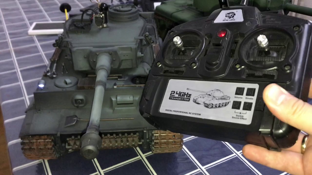

                The TK6.0 MFU works well and bonds with only 6.0 transmitter. Similarly, The TK7.0 MFU bonds with only 7.0 transmitter. Usually, the Heng Long transmitter has a small round stick to identify the transmitter model, but the front look similar.
