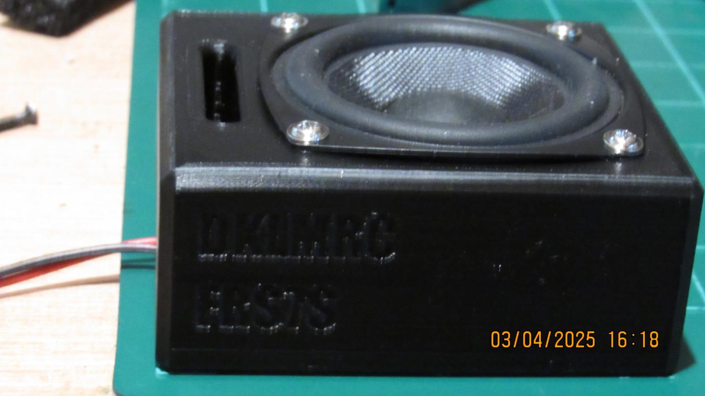

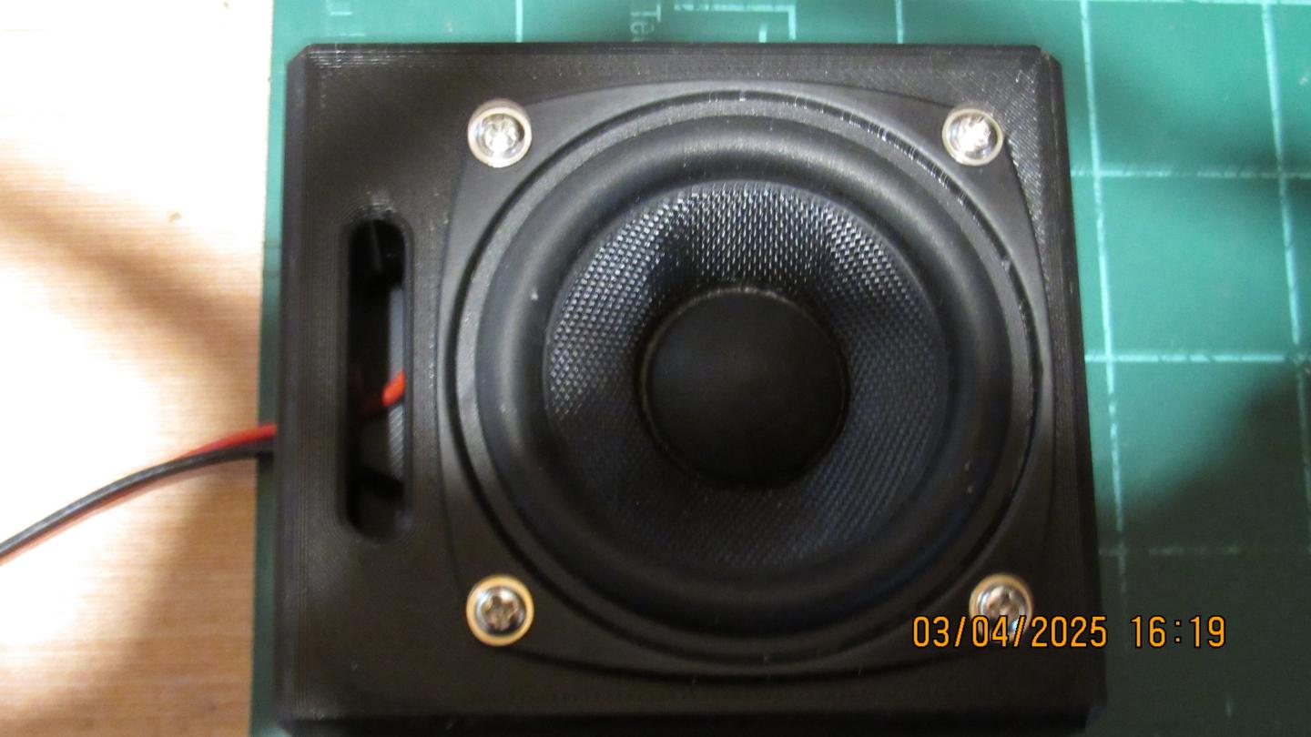

          I received the speaker enclosure package today. The shipping speed is reasonable and the package arrived in very good condition. I have the Dayton Audio PC68-4 driver which is beefier than the Visaton FRS7 that DKLM use. It extends the bass another octave lower. I can mount the Dayton driver from outside (not inside) because it is 8mm deeper than the Visaton. I'll find out how it sounds in a few days.
          In addition to the bigger magnet and lower cutoff frequency, I chose the Dayton driver for its vented enclosure parameters.

            I finished assemble the DKLM enclosure with the Dayton Audio 2.5" drive. It looks large and is heavy at 11.9 oz.
            Click image for larger version  Name:	IMG_5481.jpg Views:	0 Size:	98.3 KB ID:	421140 Click image for larger version  Name:	IMG_5480.jpg Views:	0 Size:	85.3 KB ID:	421141

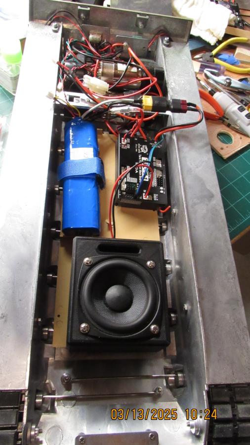

            I use M3 machine screws and nuts to mount the driver. Space is very tight. I start having doubt about using the Dayton Audio driver. The speaker magnet is so strong making it difficult to install the nuts. Can I locate the speaker far enough from the MFU to avoid interference?
            I will not recommend the Dayton PC68 driver for the DKLM enclosure. The magnet is too big and the speaker depth is too deep for the enclosure. It barely fits inside the DKLM enclosure with very little room to spare. Stick with the Visaton FRS7 that DKLM use. Just to be safe.

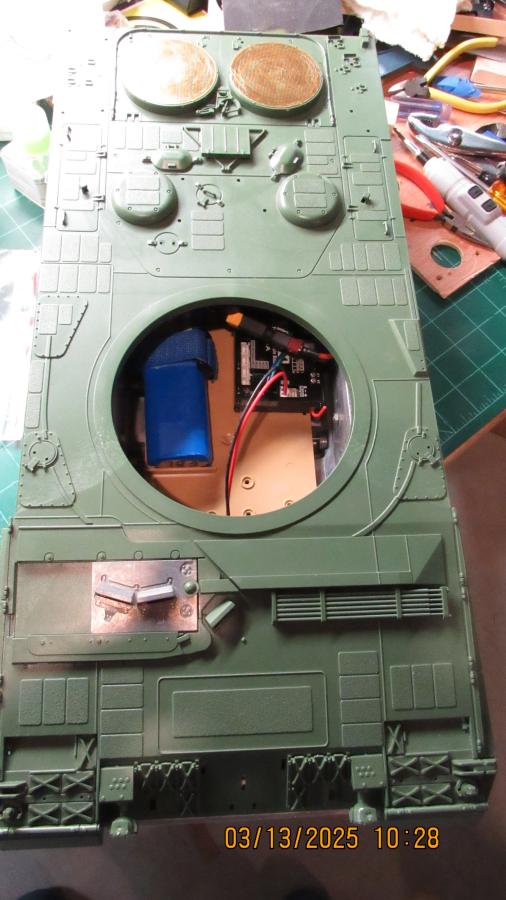

            I will test this new Dayton/DKLM speaker in the IDF Merkava and the German Leo2a6 to find a location that can avoid RMI with the MFU.

                    I won big with the Dayton Audio PC68-4 driver gamble. There is NO RMI interference and the tank drives smoothly with the HL TK-7.1S. The engine sound for the Leo and Abrams are both excellent, a many times improvement over the HL speakers. The DKLM enclosure is a good physical match for the Leo2a6 chassis with room to spare.
                    The big magnet of the Dayton driver makes it more efficient than the tiny HL speaker so I have to turn down the volume. No other adjustment is needed. The sound fidelity is more obvious with the Abrams gas turbine engine due to the driver's more extended high end. The extended bass makes the diesel engine sound of the Leo more realistic too.
