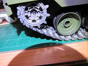

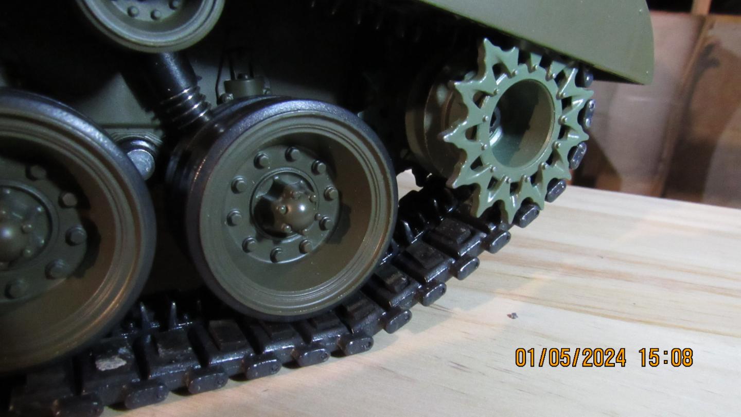

      Both metal and plastic track should run fine indoor on smooth surface. If you enjoy running your tank outdoor, you need better tracks.

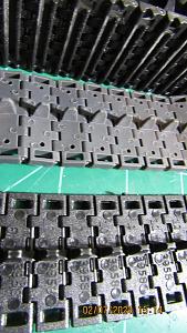

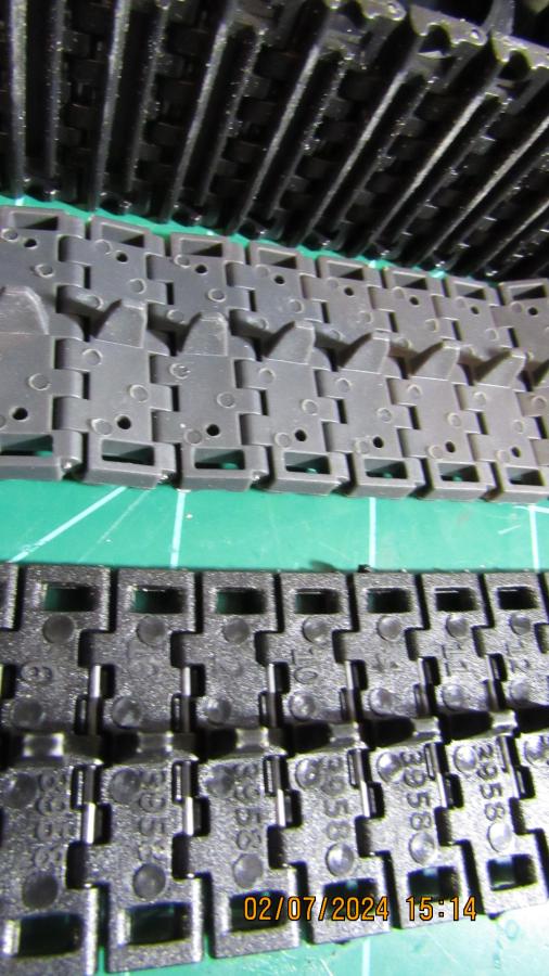

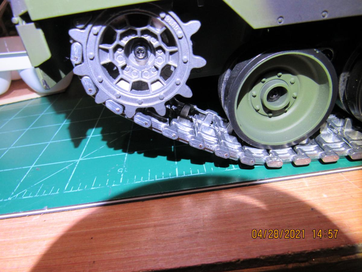

      I am not a fan of the Heng Long metal track. The HL metal track design has single pin, open pin and hollow back side which runs and looks unrealistically. I have hybrid or metal tracks on all my other Heng Long tanks. The metal track are either Tamiya, Hooben, Mato or Torro. More expensive but well worth the extra cost.

      The left picture is the Heng Long Pershing metal track with hollow back side. You can CA glue 1/8" rubber block to fill the hollow as in the middle picture. The right picture compares the open pin HL plastic track with the close pin Hooben nylon track for the Merkava.

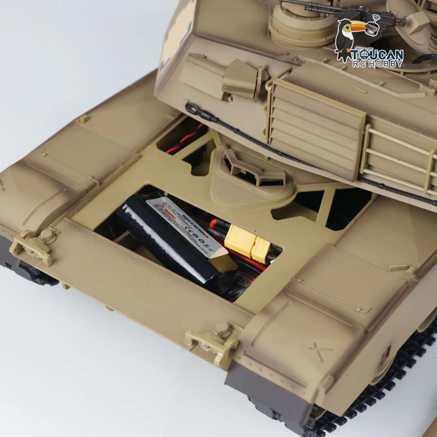

                  3 questions.
                  1- I just ordered the 390 motors from motion. What are the bearing sizes I need?
                  2- what’s the largest battery that will fit in the new battery compartment?
                  3- is the Abrams battery compartment the same? My friend is receiving his soon and would like to know.

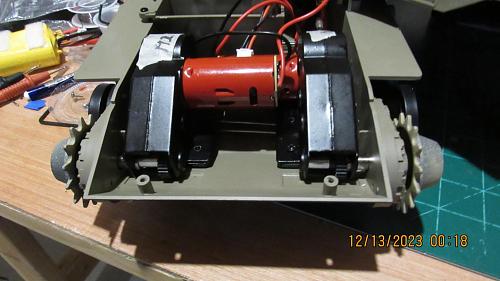

                    • 5392

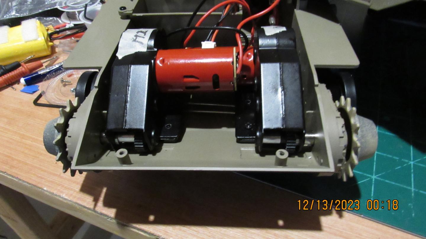

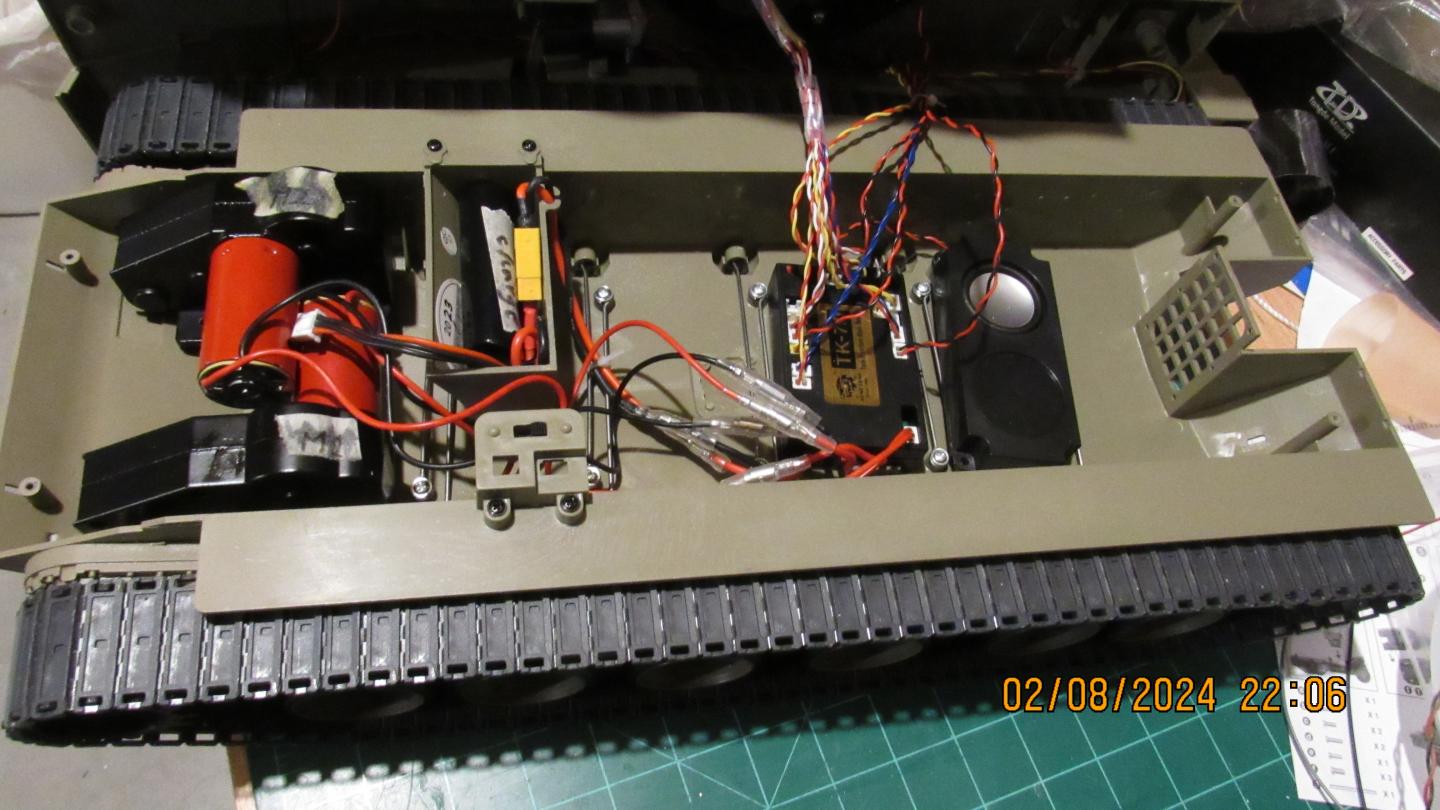

                    The bearings are for the output shaft of the gearbox. I forget the size on the Merkava. I have a 2s 3000 LiPo I use and I took out the “battery box” and just lay it is there. The opening is small. My Abrams had the large underside battery opening.

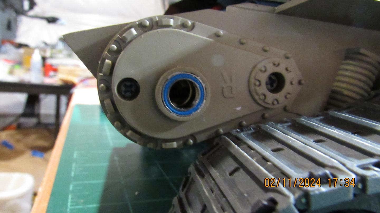

                      1. On bearing, go to this thread:
                      Updating my Heng long Panther G 3879 with Mato metal tracks, sprocket and idler. Has anyone used driveshaft bearings. They look like they would stop a lot wobble and add some support to the driveshaft. The reviews on the plastic ones said they arrived cracked and the seller said it’s normal, so the all metal looks interesting.
                      You cannot change the sleeve bearing to ball bearing on the gearbox. You need a new gearbox with ball bearings.

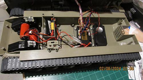

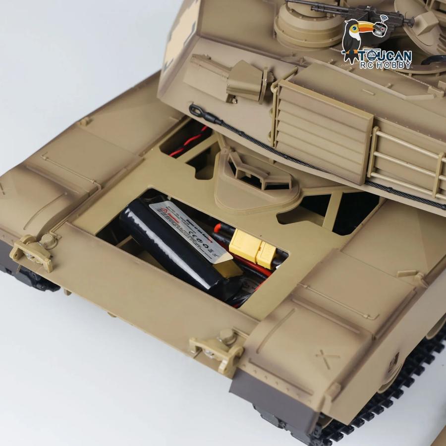

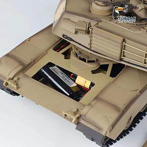

                      2. The Merkava is limited to 2S18650 LiIon with built-in protection circuit. I recommend the Admiral battery pack from MotionRC. Avoid LiPo battery which is much cheaper, but lack protection circuit.
                      3. There is 2 different designs of the Henglong Abrams. The newer version uses the same size battery as the Merkava.
ID:	427830 Click image for larger version
                      The older Abrams uses 2S2P18650 or 6 cells NiMH. It can be identified by the long battery cover access from the tank bottom.

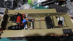

                        • 5392
                        There are a few that are afraid of LiPo's. I'm not. I have about a hundred that I use in my airplanes, helos, car and tanks. If you know how to treat them they are great in the tank. In the tanks that have the large under side battery compartment I use 5200mAh 2S LiPo's that I have a dozen of for my 8S airplanes. They fit perfect and one lasts all day. The Merkava and newer Abrahms use a smaller battery box. I took the box out of mine and these fit perfectly. 3000mAh get s me a full afternoon of running. Note I also use different connectors. I had bought a tube of the bearings and I think the thread linked above has what I used in the Merkava.

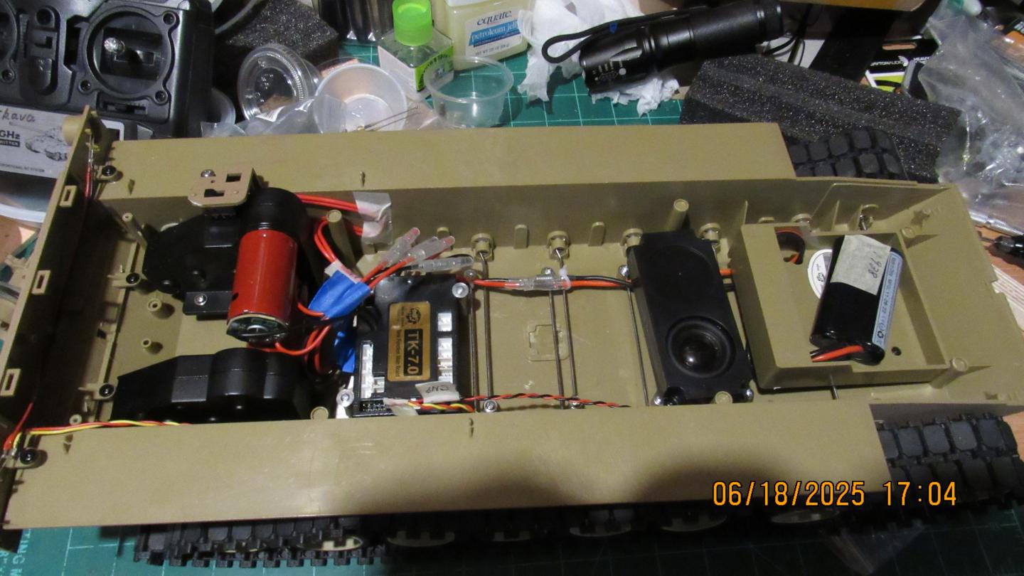

                            Motion RC sells a full size 7200mah li-ion pack that fits in the underside battery compartment. It also fits in most large tanks that are now designed with torsion bar suspension, requiring access from the main compartment. Heng Long tanks have a low voltage cutoff, which eliminates over-draining the battery.

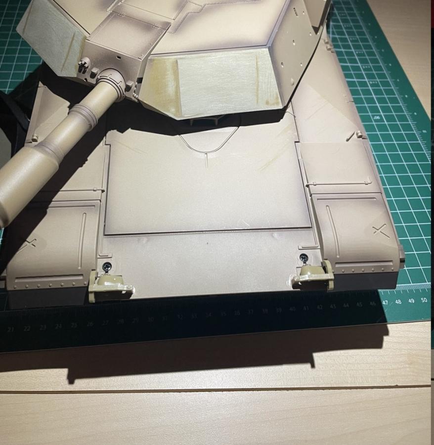

                                He received his abrams and loves it but doesn’t know how to access the battery. He suspects it’s from the front but doesn’t know how to open it. The manual shows the old version.
                                update: he figured it out. There’s a button near the seam by the “glacis” plate.

                                  It sounds like he received the newer version Abrams. There is a small latch at the middle junction of the front end. Move it to the right and the cover will popup.
Name:	frontscrew - Copy.jpg
ID:	427844 Click image for larger version
ID:	427843 Click image for larger version
Name:	S5558b51edc78459bab2bd823930dd545V - Copy.jpg
                                  He can get the 2S LiIon battery pack from MotionRC:
                                  Buy Admiral 3500mAh 2S 7.4V Li-ion Battery with XT60 Connector online at Motion RC. Order online with fast delivery.

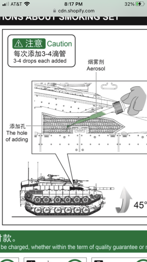

                                  • Woohoo\o/

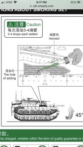

                                    How does one fill the smoke oil? I haven’t figured it out on my merkerva and he has no clue on his Abrams.
                                    he found his but I seem to be having trouble finding this in my manual.

                                      #19
                                      You put the included small funnel onto the end of the eyedropper, turn yourn tank onto its side with the exhuast port tube upright and add a couple of drops of the exhuast fluid into the exhuast tube. Let the tank stay in that position for about five minutes to be sure the exhuast fluid has gone all the way into the smoker unit.

                                        #20
ID:	427852 Pg 13 of the instructions.
