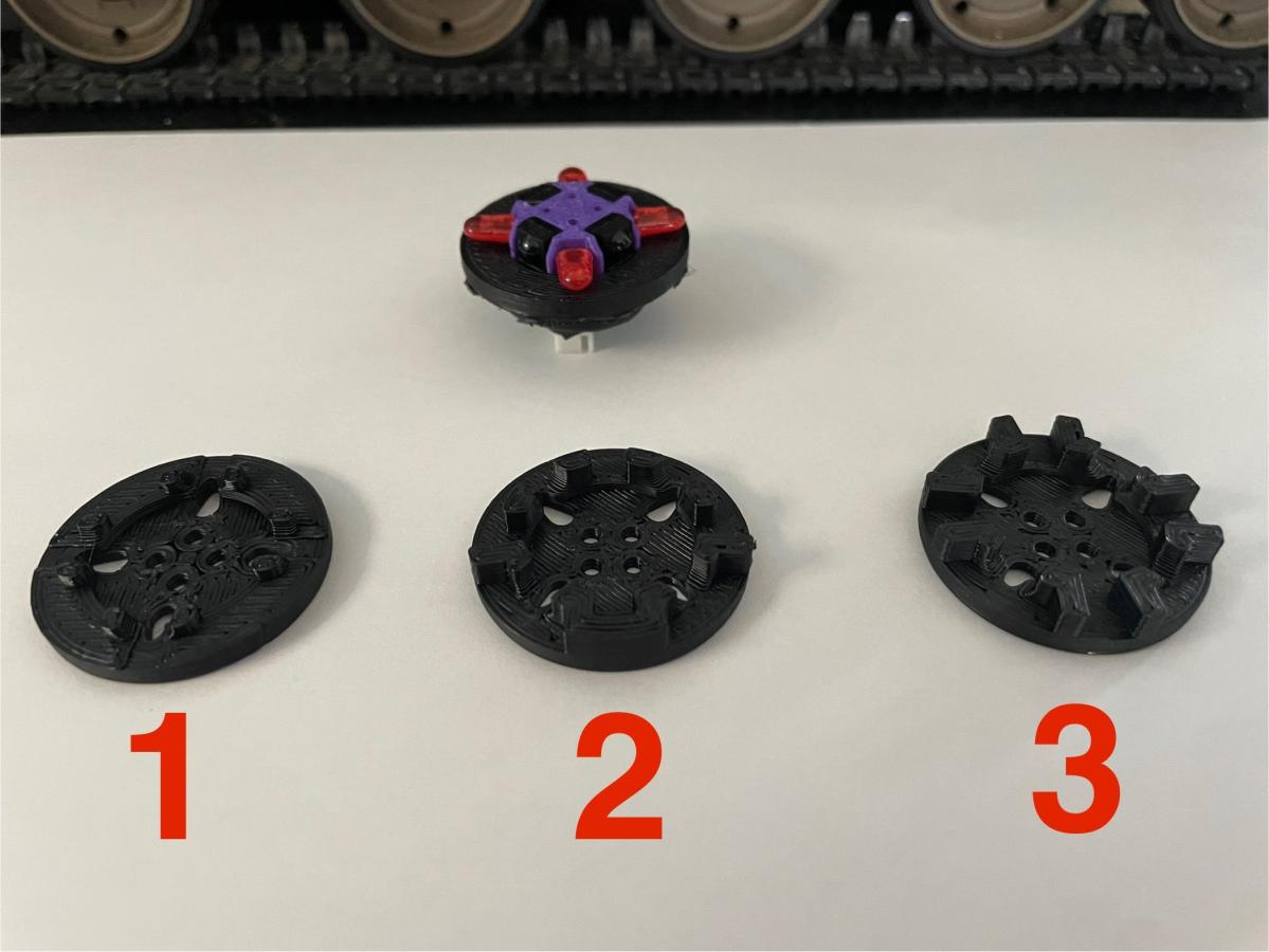

                  Since no one mentioned it. Make sure you are using the 360 degree sunshade on your V2 not the 45 degree sunshade that also comes with it. The 45 will greatly reduce angles at which a tank can be hit at when past about 10-15 ft.
                  V2 when using a 360 sun shade can be placed in any orientation when using a 360 degree shade. Just make sure it is not obstructed by any accessory parts and there is a clear line of sight at tank level to the receiver.
                  If you have a V3 just remove it and buy a V2. Save yourself the headaches.
                  Most of the clubs that have experience with the V2 and V3 do not allow the V3 receivers. There is a reason for this.
                  Forgive my ignorance but which one is the 360 shade?
                  • RichJohnson
                    • 1276
                    Number one is the 360 number two is a blocked front don’t ever use that we don’t allow that at most clubs number three is a 45° and makes the tank very hard to hit past 10 to 15 feet
                      100% this ^^^^^^
